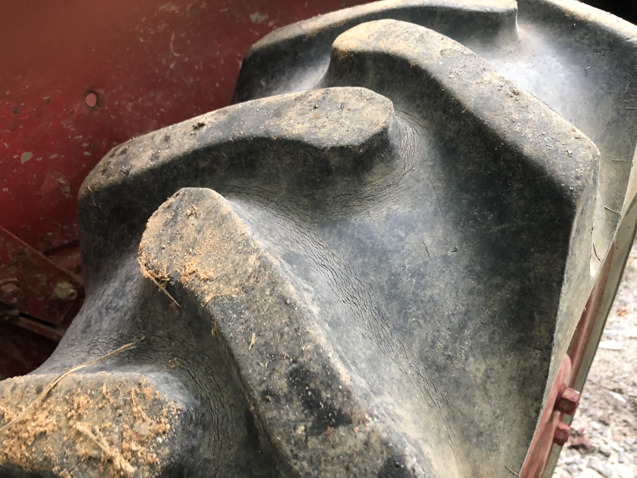

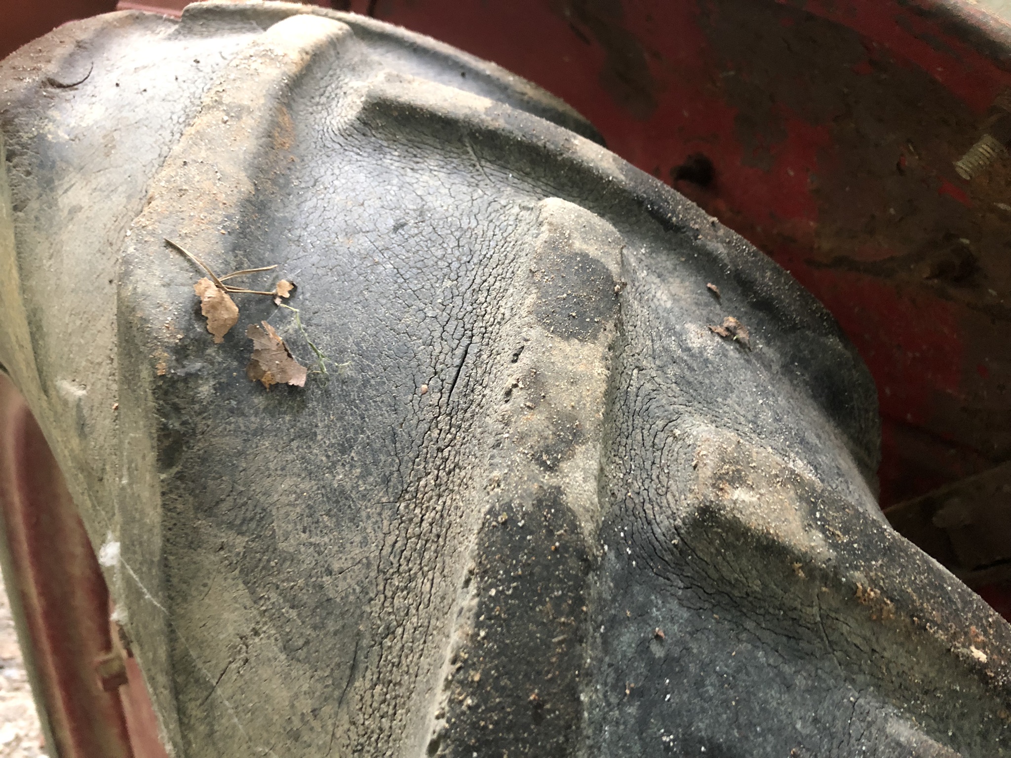

D2Cat Wrote:
'Cut a coupe of grooves in the bars of the rears and call it good. Cut them 1/4" wide and 3/8" or so deep. You have nothing to loose.'
Naw, not going to try to modify/improve what I have on there now, they are just too far gone for my purposes. Its time for new tires. Not really wanting to walk a mile back to the house in 105°F heat like last summer (95% humidity). Not that I couldn't use the exercise, just don't need the inconvenience.
Of course...I am fully aware you can stick a tractor with ANY tire....but I wouldn't have been buried to the frame in this case....had I gone ahead and replaced the rear tires last summer.
'Those deep lug tires were designed for rice paddies. You run them on anything but mud they'll bounce your gizzard out.'
Not sure I still have a 'gizzard' anyway.....but 'bounce' owing to wide tread lug distance is a consideration. The rudimentary seat on my tractor pretty much insures I feel every bump, hole or rough spot I go over as it is.

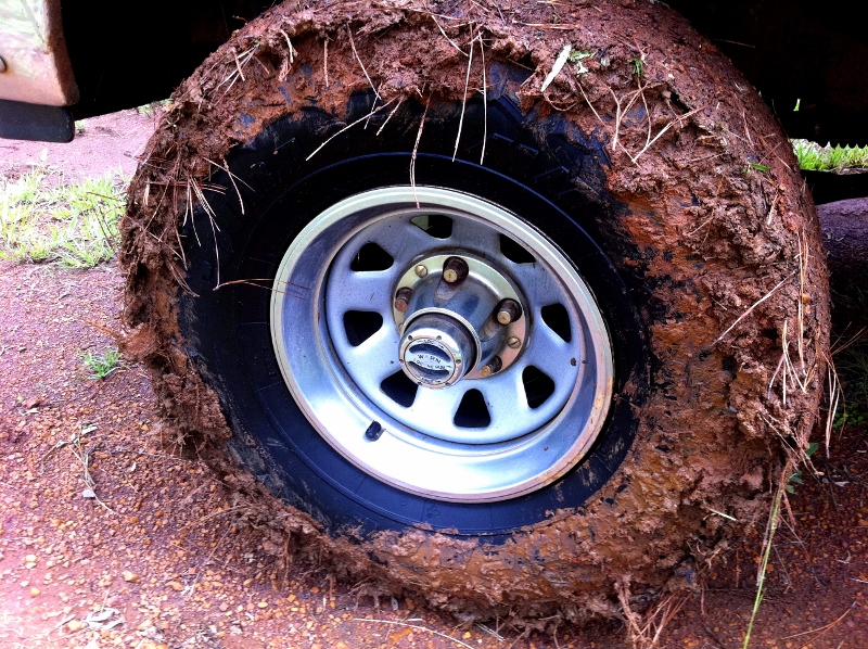

Here is an example after having driven only 75 feet on one of the old logging roads (in an old Bronco) I just turned around knowing full well it would only get worse.
Naturally, there are times when its just best to let things dry out, but sometimes I have places to go on the property that are wet and something to do that can't wait. So the conundrum is how to balance my needs. There is no perfect tire for all the conditions I will experience.

The clay on the other hand depends on consistency. When really wet it is slick but clears the tire treads fairly well. When it starts to dry out....it gets 'sticky' and will 'ball up' on the tires (quickly filling close treads).

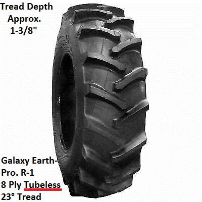

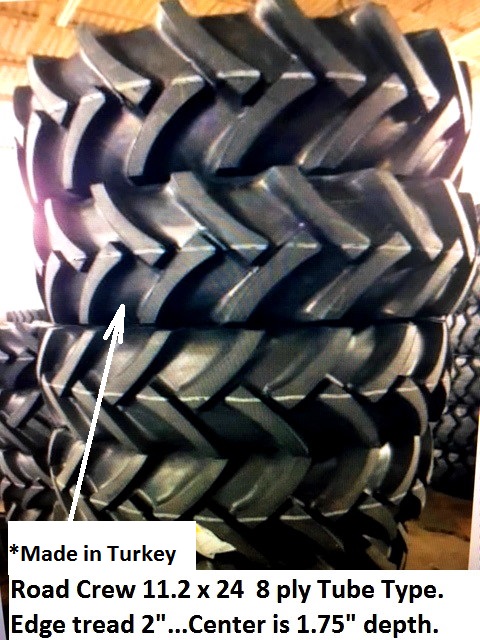

OK guys, last minute opinions on a couple of tires.
I've pretty much settled on one or the other of the following:
_______________________________________________________________________________________
Some clear differences are the tread angles (45° and 23°).
Another distinction is the Tube Type Tire vs. Tubeless. My preference is Tubeless for tire repair, but a Tube Type would allow me to run a lower tire pressure with less chance of breaking the bead on the rim. Lower tire pressure can be helpful in some situations. Thoughts?
The spacing of the treads on each tire is markedly different as well. The 'Turkey Tread' provides much more rubber for the same amount of contact patch. Better for dry conditions....but maybe not as good in mud.
Then we have tread depth. The 'Turkey Tread' is deeper than the Earth-Pro and this might help prevent thorns or other sharp objects from reaching the 'casing' as easily. I also feel a deeper tread can be an advantage in mud, but tread pattern and ability to 'clean' is important too and the Earth-Pro looks better there.
What do you think guys?" Its time to purchase 'something' and move along.
Thanks again.
Flint.

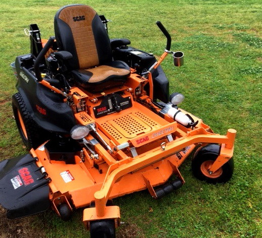

I have a locust thorn puncture issue with my ZT tubeless front tires.
Much as I hate to use it, "Slime" does work, ....but oh what a mess, if later tire replacement/removal becomes necessary.
I probably should just have those two front tires foam filled.
I have solid front tires on mine for just that reason. We have a lot of Honey Locust here and while I don't normally mow with my ZT where those are....I do use my ZT to mow along some areas of fence line that have it. I know....I know, remove the Locust Trees. :rolleyes:
