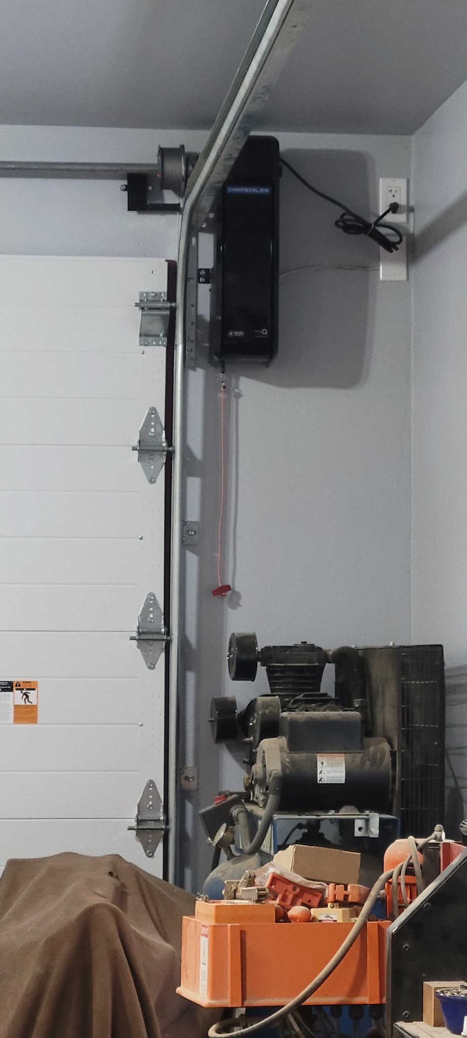

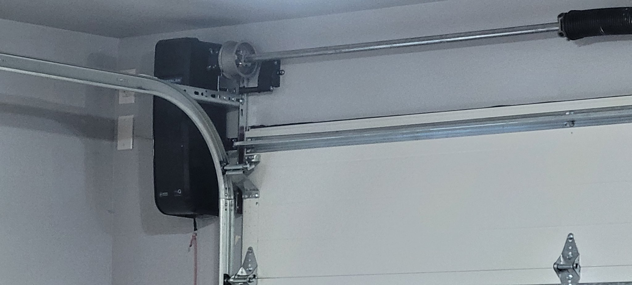

I've finally installed both of mine.
They work like a charm, fast reliable and super quiet.
We have a generator, but they also have battery backup.
16 foot x 9 foot 2 1/2' thick R18 insulated door
12 foot x 9 foot 2 1/2" thick R18 insulated door

@North Idaho Wolfman, so it appears that the opener and door spring work in conjunction? Did your opener come with the opener spring system, or was that spring system a left-over from the old opener?
Looks like a great setup!

The wall mount units are a far better design, faster and quieter than an old style overhead opener.
They also work with the new insulated heavy doors.
one other plus is it can't bend the top of the door.
There is also a electrical dead bolt on them, so no opening the door without the opener working it or manually overriding it.
You can actually add a CO2 sensor to them if you want.
They are on the network so I can remotely operate or monitor them.
real handy when working around the yard and you need to open the door to get that quick something... like a cool drink out of the garage fridge!
Like GreensvilleJay said the springs are stock with the door, they balance the weight of the door.
These doors have heavier than normal springs because they are thick heavy insulated doors.
I keep the garage heated to 60's so the insulated doors are super important.
