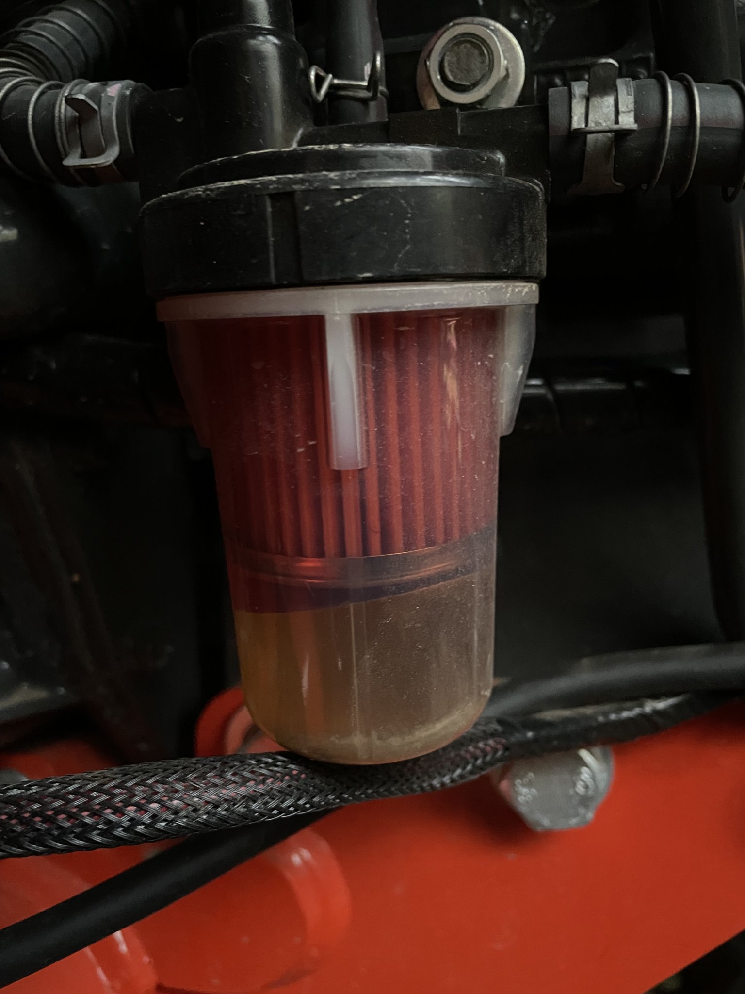

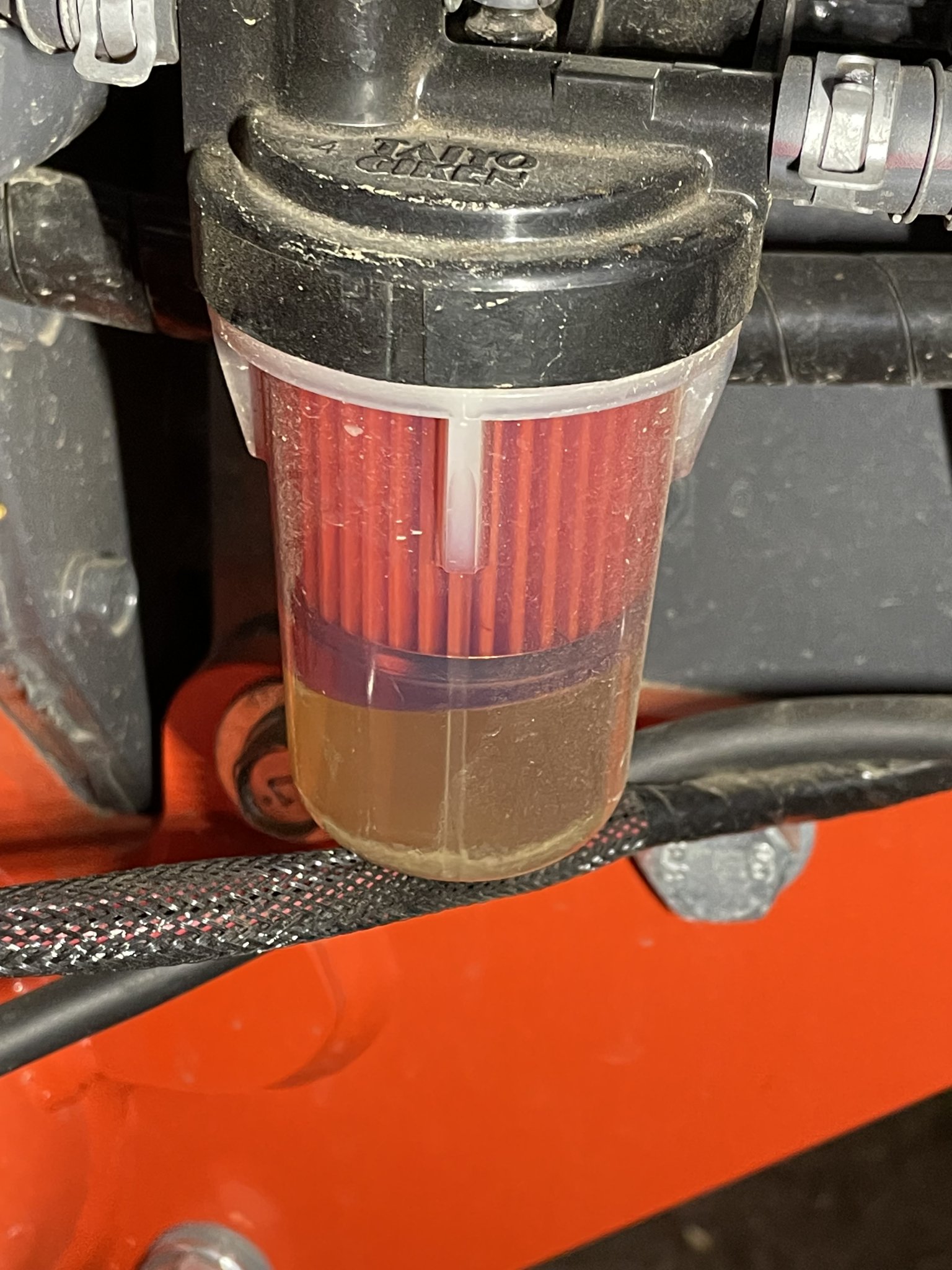

Hello,
I'm super new to my kubota and the forums. I have a B2601 with only 6 hours on it. I haven't even added fuel yet; still running on the tank it came with.
Today after a week on vacation, and significant cooling temperatures, I went out to look for the QR code to add it to the kubota app and I noticed this in the fuel filter (attached pics). Last time I ran it it was solid red, but not there is clearly something else. They say "red or yellow, never clear" and this looks yellow, but I know it's not diesel. What is this? Is it water? But it also looks like some kind of sediment at the bottom. I assume something needs to be done before I run my tractor? Thanks in advance for any advice.
View attachment 88798 View attachment 88799
If this were my tractor, I would not run the tractor until I drained the fuel filter of all that crap and corruption. Collect it in a clear container and I'll be willing to bet it's condensed water from sitting around with a partially filled fuel tank. Drain the filter and refill it by opening the tank valve and let it settle to see if you have more water. Continue doing this until you have no sign of water. The only difference between "road diesel" and off- road diesel is the color (red for off road non-taxed and straw colored for road diesel which is taxed). They are totally miscible i.e. they mix together.
Keep you tank full and treat it with diesel fuel treatment and keep a close eye on that filter to make sure that you don't have water collecting again.

I have three 275 gallon fuel oil tanks, one in a heated basement, one in an unheated basement and one outdoors on the north side of a building. I have never seen so much as a drop of water in any of them. The fuel level varies considerably according to use and price, no effort is made to keep them full. I replace the fuel filters about every three years and there is no water in them. For those that may not know, fuel oil and diesel is the same and it is dyed red as well. I also have a diesel pickup that I drain the water separator as required, never seen a drop of water in the drained fuel. My opinion is that the condensation theory is way overblown. The crap that the OP is seeing came from the dealers tank. He cannot allow that dealer to mess with his tractor because the dealer is useless.

Red diesel doesn't mix with green.....now I've heard it all. 😂
Drain the tank. Like Jay said, take no chances. Keep that Mason jar and take it to the dealer. Light it on fire and see what's left. (In the jar, not left of the dealer. Lol)

I’m really glad I didn’t just take the dealers word that everything is ok. After draining the filter cup, it’s obviously water. And the fact that it is SOOOO dirty also concerns me. While it might be overkill, I think I’ll drain the tank just to be safe. $20 worth of diesel and some time learning more about my new toy is nothing in comparison to the damage shitty fuel could cause.
the fact that he assured me there was nothing to worry about makes me start questioning the quality of this dealer. I was planning to take it in fir the 50 hour maintenance just to get some professional eyes on everything. Now I’ll do it myself or take it to a different dealer for that to make sure there isn’t anything else weird.

Just talked with the dealer. I emailed him a pic. He says it’s not clear so I don’t need to be worried. They may have added road diesel (yellow) that didn’t mix with the ag diesel (red).
Tell him I’ll gladly pay for his vasectomy……

Anyway, I ran it today for a few hours trying to dig out a couple stumps and flatten what was our overgrown previous garden. It ran well and I don't see any more gunk in the filter. So, that's good. i did top it up before putting it away for the night. I'll definitely make a habit of that going forward.
Thanks again for all the advice. I'm definitely glad I emptied out that gunk before running it.

I see nothing 'sinister'.... just water-separator doing its thing (it is clear for a reason)
There should be MULTIPLE fuel filters on your tractor. I would change ALL of them. As other folks have said, you DO NOT want crud finding its way into the injection system. This is the reason for all the fuel-filters.
That 'filter' you see in the water-separator is simply to aid in separating the water.... it is NOT the main fuel-filter.

The fuel bowl filter is the only fuel filter on the B2601. Also was the only one on both the JD 4010 (like a 2019E if made today) and the JD 2025R gen. 1.
