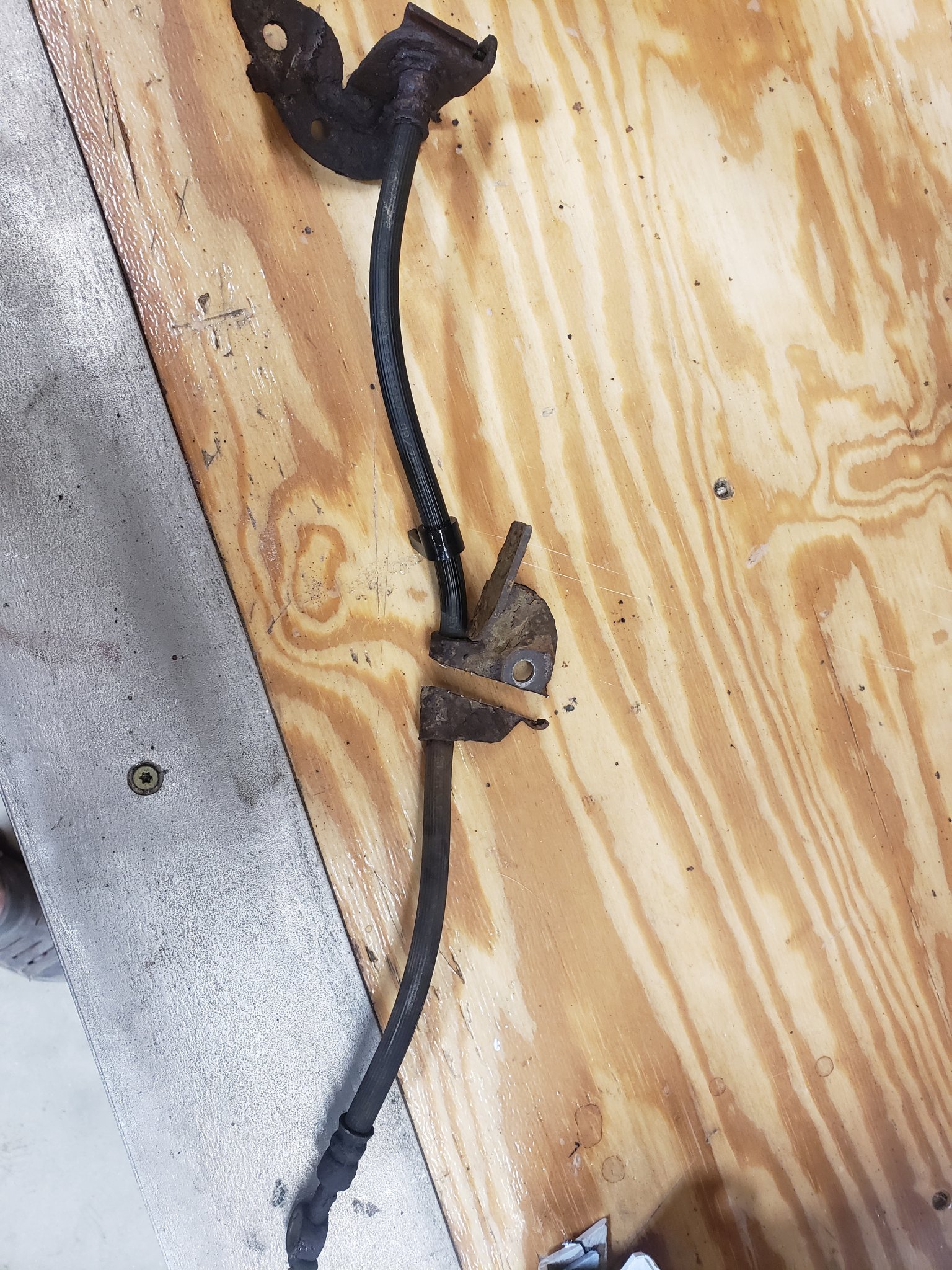

Get off the highway the other day in my 2012 f150 and smell brakes. Hoping it was the car in front of me it wasnt. Driver front wheel was smoking.
Figured it was a stuck caliper again so i changed it out. That wasnt the problem. Turns out the rubber brake line was restricted by rust jacking. What piss poor design. a little paint would have prevented a major brake problem.

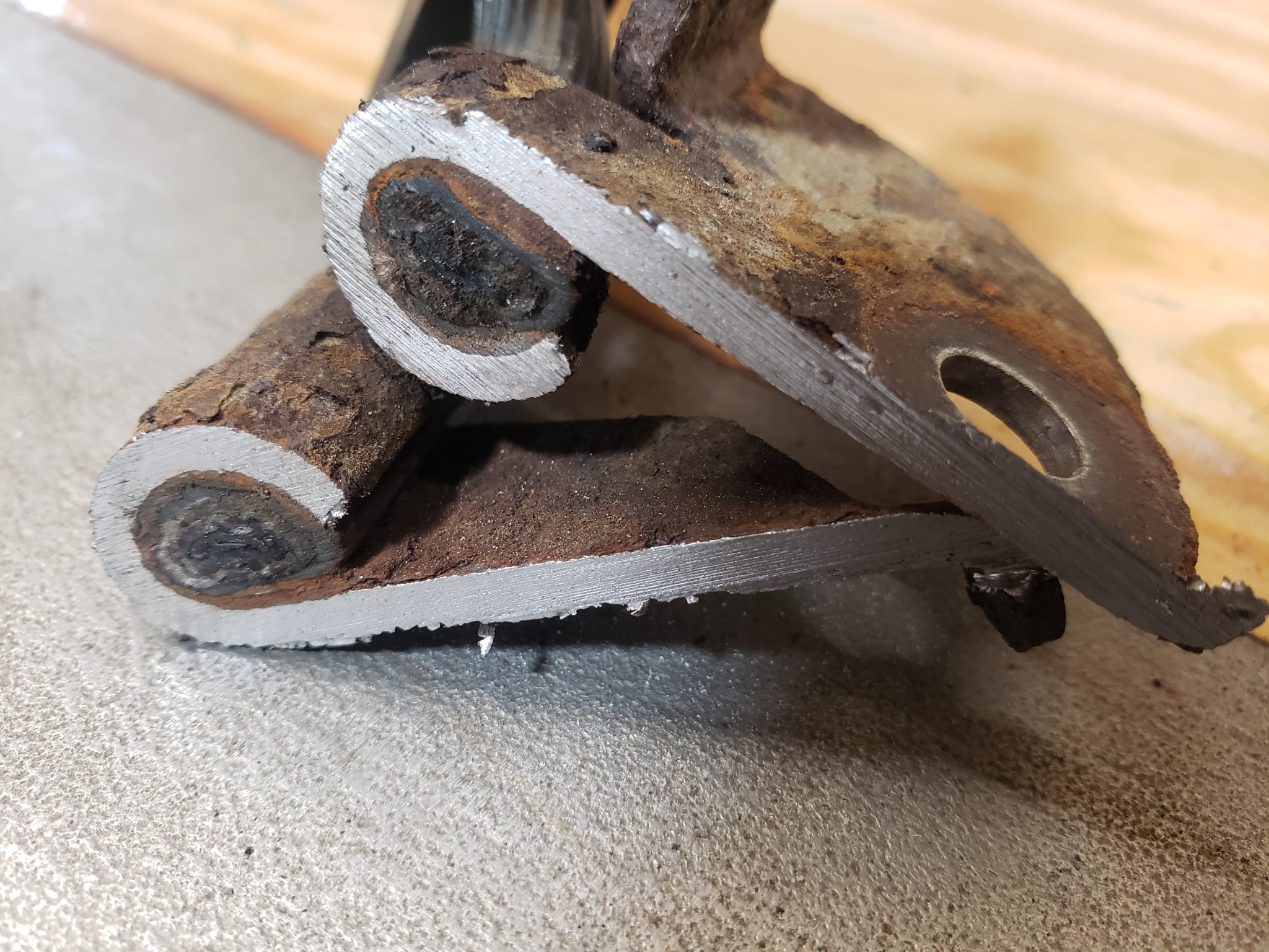

The rubber line has metal brackets pressed onto it. rust grew between the brake line and bracket, the bracket won.
What a PIA. changed out the line all is good now.

Nice find! I’ve had lines swell up internally and cause similar problems.

Had the same thing happen years ago on my Dads old Chevy S-10 Blazer. People just beg for more and more salt on the road. Nothing like safety, we need salt and don't need no stinkin' brakes.
10,051
4,139
so.. did you change ALL the lines, or just the one that failed ?
BTW paint would only have delayed the rusting as salt ALWAYS wins.
Ideally replace with SS lines AND clamps, both must be SAME grade of SS though....
Actually i think this is probably the biggest contributor to the issue. Swelling happened inside and the outside got pinched. Important parts that have to do with stopping and safety should be engineered better i think though.

It’s a road salt issue…I’ve lived/worked in both areas, that does not happen down here (coastal areas see it somewhat, but not near as bad where they throw it on the roads)

That truck is 10 years old, and most likely has more than 100,000 miles on it. If the salt did that to the bracket, how long do you think it will be before you start having the steel brake line failures. I would be thinking of installing all new lines and rubber hoses if I were you. The day that you make that one panic stop by stomping hard on the brakes, is the day that the line is going to blow out and your brakes are going to fail. I live in New England, and I had it happen to me once. I was able to avoid an accident, and I replace all the brake lines and hoses. To me, tires, steering components, and brakes are the 3 items that you can't afford to gamble with. A bad engine or transmission will leave you at the side of the road, but steering and stopping failures will leave you in a ditch, tree, or someplace worse.
