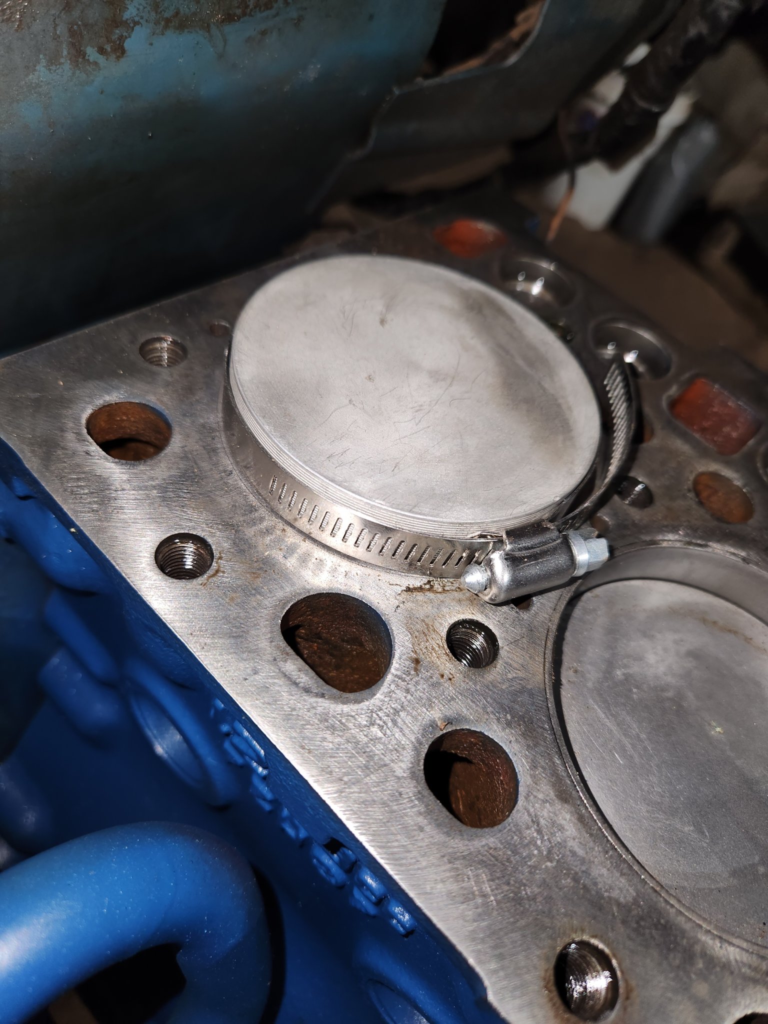

Joe, since you like to make do with what you have, I wonder if you could use a hose clamp rather than the proper tool to get the rings compressed into the piston so you can insert the piston?
You might have to use multiple hose clamps, but it might work…
" tool to get the rings compressed into the piston so you can insert the piston "
Or you could use the method my Mother witnessed in the milk room in 1935 as my Grandfather Rufus Norton put new rings in a Ford Model T engine:
Piston inserted with rings sitting on top of block. My Grandmother Jane Norton took a strong string and carefully fitted it around one ring, wrapped the ends around her hands, pulled strongly as my Grandfather tapped the piston down one ring. Repeated for each ring.
Joe, you just need a strong woman.

Hay I LOVE the 'new use for a gear clamp' !!!!
Thinking outside the box, use what you got, seeing stuff 'differently' than others
Not everyone can afford $10,000 worth of tools to rebuild one engine,once so it's GREAT to see low tech, low cost SOLUTIONS.

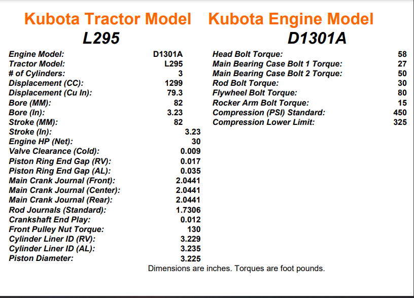

And.......just what is that spec.?
Most diesels show 300 - 500 psi as recommended.
Joe's 300 psi. would seem to be the absolute minimum.
Hard to say what the actual true compression is for certain.
Looks like the test meter is a set from Harbor freight or equivalent. Who knows what the true PSI value actually is? Need a trusted, calibrated meter to be sure.
At least it shows equal compression in all three cylinders, as of the last report.
New? We used them on Briggs & Stratton's 50 years ago - back when they were worth overhauling. You had to file the buckle a little to keep the burr edge from scratching the ring. :)

Spec sheet for d1301
Compression: 450 standard, 325 lower limit
At minimum yes, but within specification.
It seems to me that hugo knows about engines and has experience, so for him to say "within spec" means that it is fine in my language
My suspicion: with the starter spinning engine, it cannot produce the 450 psi
Once engine running, it should produce more psi than when starter turning it
Please someone critique this theory or give real data

sorry, "within spec" was based on the 300-500 psi mentioned. According to the manual it is outside the Kubota specification, but I would not get excited about it. Typically compression is measured with warm engine which you do not have at the moment. As somebody mentioned already compression is similar on all cylinders.

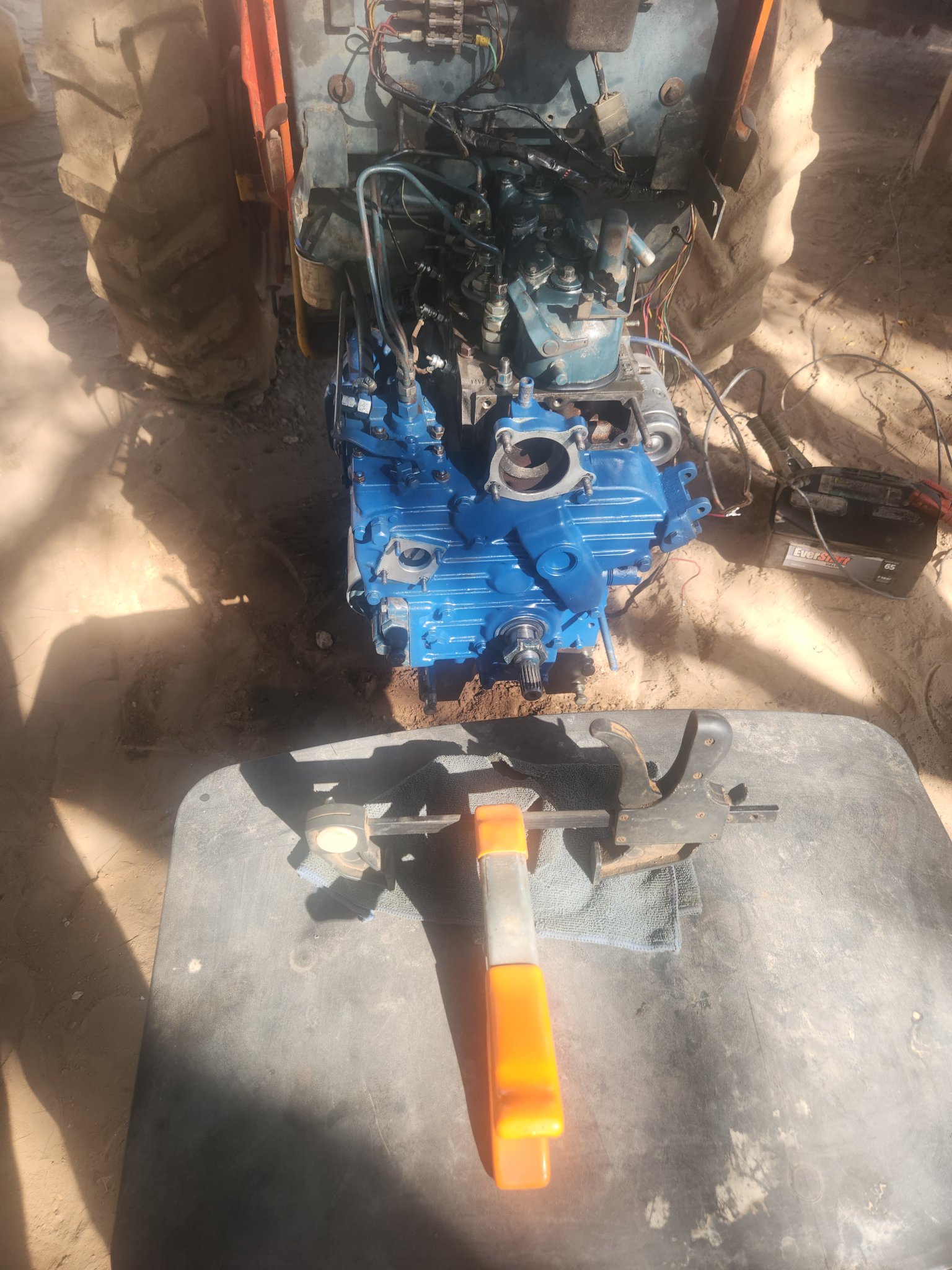

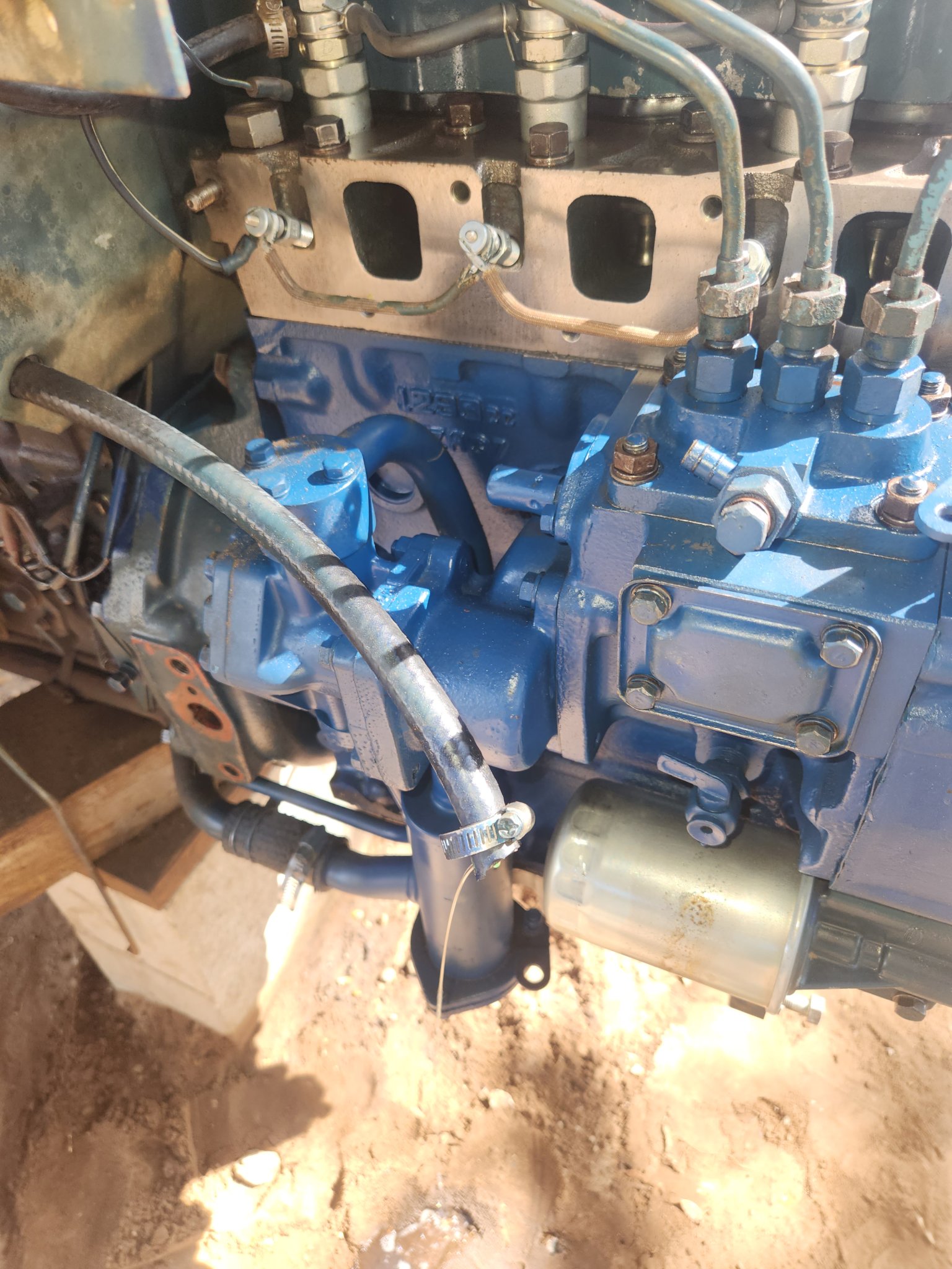

Rigged up for first test
Diesel to injection pump, check
Tripod setup for video
First attempt: primed lines, shot diesel out the injector
Let it cool, tighten injector, try again

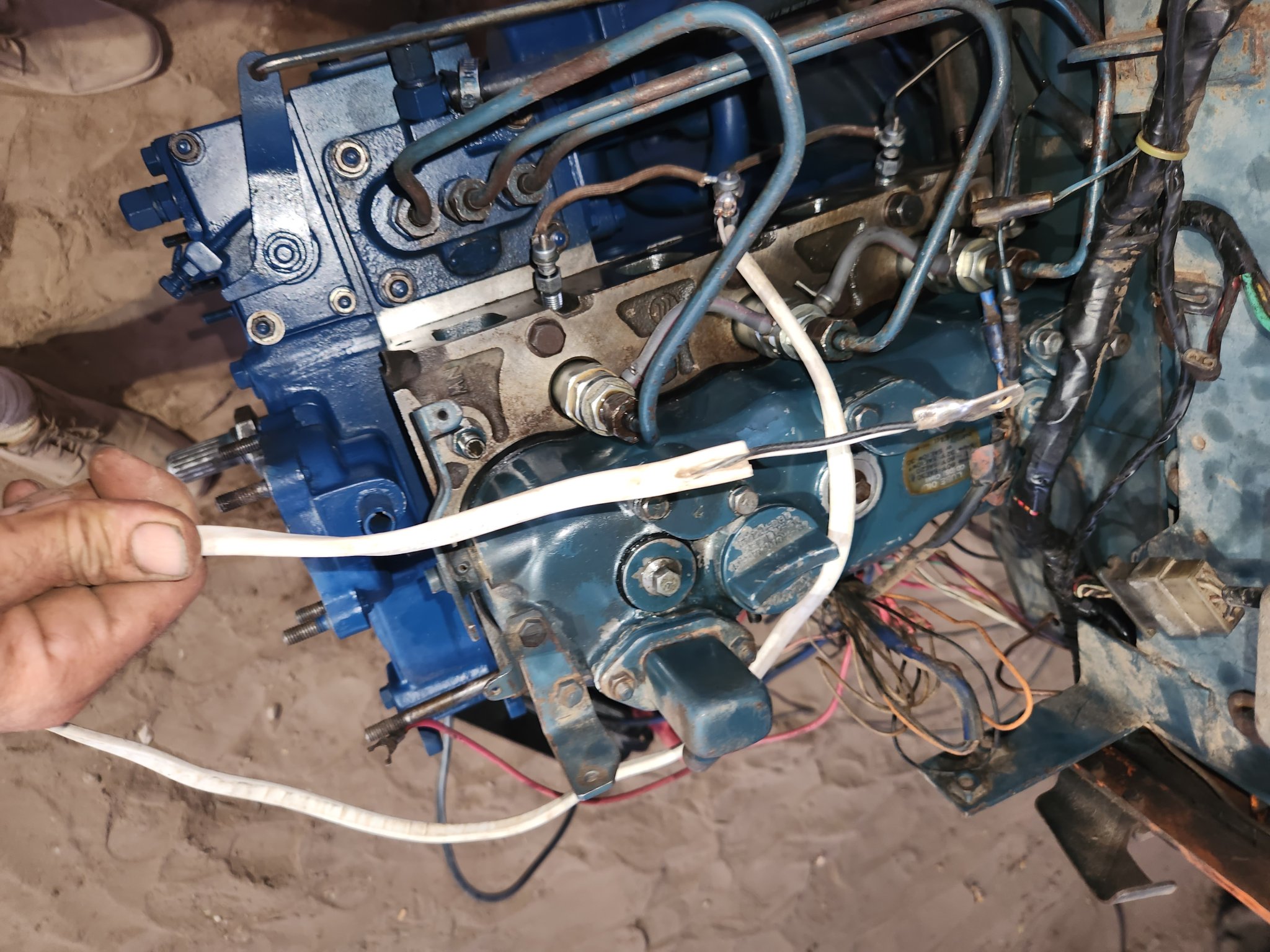

Tried again, won't start, needs power to glow plugs
Rig up power to the glow plugs
Either rig up factory key switch or make a switch and clamp it to 12 v
I'll rig up the factory system with new switch and make sure power going to glow plugs
Made a wire for power glow plugs
Heated glow plugs for long periods, everything hot, keeps cranking but no start
Am I forgetting something? I have it rigged up not using the key switch, running the starter directly to battery
The wiring is not put together, it has diesel going to injection pump, there is no leaks
Does the wiring have to be proper or can it run in the condition I have in?
I remembered, take out compression to let engine spin freely and prime all the lines
Does it sound ok?
Best way I found: spin fast without compression, then switch compression on
It sounds like it wants to start, give up for now until I find better plan
In the meantime, take all body panels off, clean entire tractor, get it ready for paint
While waiting to see next best step on engine start, make progress on paint goal

There is no choke on your engine @joesmith123!
The lever you were moving is a decompression lever. It did not appear to be working properly since there did not appear to be any difference in the speed the engine was spinning (In the video)
On my L185 it is pulled to the right (looking from the front of the engine) to provide zero compression and then when released there is a spring that pulls it back to the left and allows compression in all cylinders.
I have never looked into how it works under the valve cover but assumes it pushes down slightly on the exhaust valve. But not too much or the valve can come into contact with the piston.
I would assume that you need to look into that to get it working.
Further to that I think that your engine is spinning slowly and might not be able to fire off. There is no magic RPM for starting since I have gotten mine started on a nearly dead battery but yours seemed “slow”.
May need to charge the battery overnight or use two batteries to get it spinning faster?
