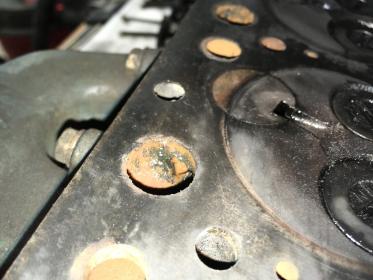

Today I thought since I am this far into it I should just pull the head and check
Inside. There was some carbon buildup on the perimeter of the pistons but the tops look good. There is no pitting. Im not a mechanic but from what little I know the cylinder walls look good. They are a little shiny and slick with just a few vertical streaks but nothing you can catch a fingernail on. The head unfortunately is going to have to be replaced. There must be a crack or pin hole in it. Looking through one of the water jackets there is and oily sludge inside.
Couple questions.
1. How would I determine if the cylinders need to be honed?
2. Since im in it this far should I just pull the pistons to inspect, if good replace the rings and hone?
3. After getting a price on a head from Messicks, are there any reputable aftermarket heads someone can suggest?

I don't see the issue that you think you have with the head????
Point to it.
The only issues that these heads have is they will crack between the valves and into the precombustion chamber.
I have never heard of one with pin holes or leaks into any other portion of the head.
The slime in the water jacket could be from a 100 different things.
Was there water in the oil before you pulled the head?
Is there oil in the radiator?
I think your just looking for something to be wrong with it, if you genuinely concerned take the head in and have it pressure tested, that will give you a complete answer.

Im defiantly not trying to find any more issues. I have just put a lot of time and money in it so far and just want to make sure im doing things in a correct order to cover all the basis before i start reassembling it.
I dont think it is oil now at this point. I think it is rust that is wet underneath and when poked with a pick crumbles and has an oily look to it.
I didnt even think about having it tested. I called a place here that builds engines and they said they could pressure check it for 150.00. I may just do it for piece of mind.
I have my new seals and gaskets on order so hopefully it wont be long now before i start getting it back together.

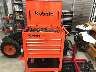

I got myself an early Christmas present. I have been wanting one of these for awhile.
Fish - look forward to your progress. I'm not much help, but have watched your project. Like 'Cat said, it is better to keep everything in one thread.
Great looking tool box! I have a set from Harbor Freight. Your Kubota tool cart looks remarkedly similar to mine from HF, which was the first I bought on sale.
Asked about the HF toolbox quality here on OTT before buying the bigger ones.. They got good reviews here, and I Love them!
I used to spend 20 minutes finding the tools I needed BEFORE starting work; now they're right there....
Best wishes for the rest of your project; I look forward to seeing it!

Looks great! I have a set from Harbor Freight. Your Kubota cart looks remarkedly similar to mine from HF.
I used to spend 20 minutes finding the tools I needed; now they're are right there....
It is actually a HF box. They were on sale this weekend so I got one. I just put some Kubota decals on it. I love it. Im really impressed with these new boxes there coming out with.
