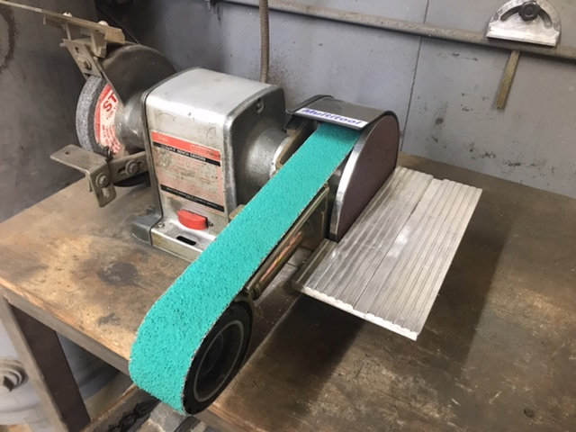

Check out this belt grinder from Trick-tools.com. An inexpensive way to get a belt grinder that is pretty versatile. The belts are super easy to change. I have used the course grit belts to sharpen rotary blades resting the blades on the top and tilting them backwards. The premium belts hold up the best. There are also scotch-brite and polishing belts available. On mine I added the side miter table. There are also a variety of other models to choose from. I adapted mine to an old Sears 1/2 HP bench grinder.

I have that exact Crsftsman grinder. Mine is almost 50 years old...
