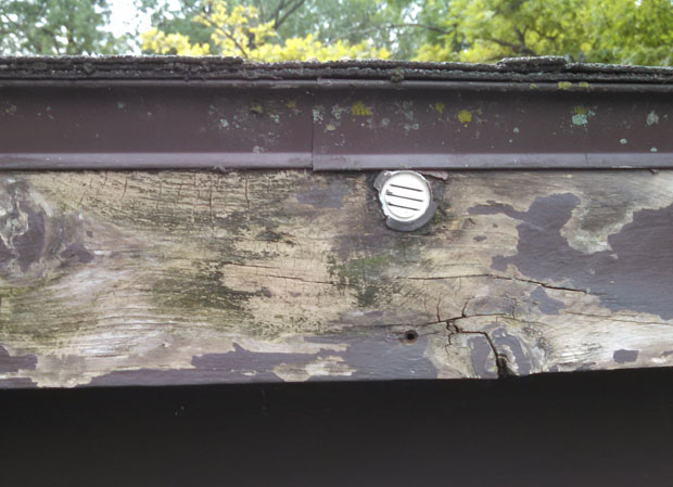

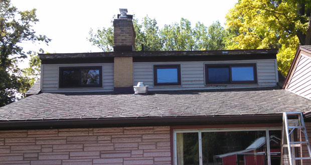

I know among the forum members are many professional and amateur house fixers, so I am asking for help.
I was just going to get up on the roof and slop some paint over this one strip of fascia board that is peeling and call it good, but it is so far rotted that my OCD has set in, and I would like to do it better. The root causes can't be fixed, flattish roof and maybe the drip edges on the most recent re-roofing job not installed correctly. The result is the fascia is nearly always wet. Some previous roofer thought vent holes should be drilled in this board, and they have collected the water and so the wood around them is rotted. I pulled one out, actually it fell out into my hand, and the result was quite the gaping hole. There are two "regular" full size vents in the soffit along this run, so I am not sure what these added ones are supposed to do. See photo. What I am thinking to do now, since glueing a patch into that hole is looking like an epic fail (I tried it), is pull that board off, or boards plural, and replace them, and then have my favorite eavestrough company cover this strip of fascia with aluminum, and then the water can drip over it all it wants. I have never done this before, and given that this house is really old and repaired, remodeled, and constructed by numerous relatively incompetent people, I am not sure what I will find if I go ripping these boards off. They look like they are held on by small nails into something. It looks like if I am careful I could slide the board out from under the drip edge and tuck another one back under. If I do this before the eavestroughs guys come I could prime and paint it first. They would do it, but probably using 1 x 6s, but this board is really 1 X 5, i.e 3/4 " by 4 1/2". I have found a source of 1 x 5s, Home Depot, which is good because I don't have a table saw to rip a 1 x 6.
My question is, there are 2 boards that are 10ft 1inch long, and 1 3ft 1 inch long to cover the span. I have no clue as to the spacing of any rafters or whatever that the fascia might be nailed to. I can only get 8 foot long boards so the spacing will be different. My intuition is that the ends of the fascia boards should be nailed to something and not hanging out in space, so I should cut them so the nails or screws go into half a rafter at the joins?
So basically my question is how should it have been done, and how can I best cope with the mess I have? And any guesses as to how it might have been done at least 50 years ago? Part of this house was the granary, hand hewn beams etc, then it was the hired man's house for lord knows how long, and then somewhere around 50 years ago it was remodeled extensively.
I get these why don't you have someone do this for you, why don't you just call a painter questions. One look at how the new siding, the way the roof is sagging should tell you. That corner of the house was taken down to the rafters for the last reroofing job, new windows, new flashing, new insulation, new house wrap, plenty of opportunity to square things up, and this was what I got. So I am going to try to fix this little thing myself. And no I shouldn't be up on the roof but it is really pretty safe. End of rant.
Thanks for any thoughts! Any knowledge I can gain before I start pulling boards off would be all to the good.

I would want to get those facias off and renew, if your joins don't meet on a rafter end, and you can't cut them to do that, then a simple noggin between the rafters and fixed between them will give you a fixing for the facia boards.
Some form of vent in or under the facia would be desirable to air the rafter voids, maybe treat the rafter ends with preservative while you have it stripped back.
You might be able to use a plastic or metal facia to good effect, and maybe get a light gutter under the roof drip by saving on facia thickness.

The drip edge and roofing shingles need to be extended, typically out 1 to 1.5" from the fascia edge. If wind or other conditions cause rain to 'splash back' against the fascia, consider using Vinyl or cover the board in aluminum.
Most roofs I've seen like your are the result of a roofer who has no idea what he is doing. I'm no roofer but I've seen similar to yours a few times.

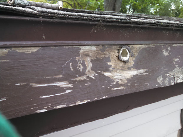

The small brown piece of flashing off the roof was not long enough to cover the upper portion of the plate (end beam). The water flowed down it and it appears some got behind the flashing and helped the end beam start rotting. Also looks like the paint has been gone in sections for awhile. I just went through rot issues on this place and I have similar damage in a much smaller area on a patio cover that I will fix this fall.
To replace the rotted end boards, you will need to work fast. Dimensional lumber comes wet from the mill (high water content). You will have barely a week to get the new ones primed, cut and installed before they start to twist or warp. Buy as straight a board as you can find but, expect movement after drying sets in. The sooner you pin them back up, the less of a hassle that presents. You may want to buy the new lumber after pulling off the old stuff.
Essentially, get some 10' or 12' 2x6 and see if you can find somebody nearby to trim them for you. You should have a lumber yard nearby that carries those. Home Depot stocks them so you may have to drive the nearest HD. Get one extra while you are at it, just in case. These will be wet lumber so they will be very heavy. Get help unloading them.
While at HD or wherever you find the lumber, get some exterior primer and your matching house paint. Prime these the day you get home or the day after. The faster you seal them, the slower the water will evaporate out of the wood, keeping them straighter longer. Priming and painting the straight lumber before its cut and installed gets a much better coat and makes touch-up painting when done a lot easier. Use a roller and get two good coats of each, with at least 8 hours between coats. If its sunny and dry, you can shorten that a little with a coat in the morning and one in the afternoon.
You are going to have to find some galvanized flashing that will slide under the brown metal flashing that is there and drip away from the wood as much as possible. Home improvement stores have some flashing material available. A piece that slides under an inch and then bends 45 degrees out about an inch (a shallow "V" viewed on end) will get the water away from that joint on the end plate. Or, some pieces look like a squared "S" viewed on end. The flashing nails up with galvanized 1" flashing nails, nailing right through the old brown flashing. Galvanized won't take paint for a couple of years unless you degrease it well.
As for getting those end plates off, I would suggest trying a 4lb sledge first. If you start at one end you might be able to pull them away. You should find the trusses in good shape. Rot does not always jump joints. Hopefully, the damage is contained at the end plate. I can't tell enough from the pictures to tell if the end plate is pinned by nails through your roof plywood. If it is, this project will be a lot harder as you will have to peel back your roofing to get the new plate nailed to the roof plywood. That may be a showstopper for you, just so you know. Those end plates are not only pinned into your trusses, they are likely pinned from above as well. Even if you have to have the job done by a carpenter, if you do the removal, you'll save a bunch of money by doing the demo and priming and painting the new wood. If you are out there with a paint brush, any scarf joints can be painted during assembly which will greatly minimize further rot.

How much snow and ice stays on your roof during winter? Your problem stems from the bad shingle roof job and, untill you address the roof, your facia will never be fixed properly.

Sheep farmer, you are right. Your first step is to remove those fascia boards. They are most likely only face nailed into the tails of the rafters. Slip new ones under the drip edge. Then find someone who has, or rent, an aluminum brake. Home Depot has aluminum trim coil stock in various colors. You will cut some strips of aluminum roughly six inches wide and as long as your brake will take, mine is an eight footer, so I can only do eight feet at a time, but if your renting you can get ten or twelve foot brakes. One side of the aluminum strip will go over your new fascia board, and slip up under the existing drip edge. The other side of the strip will be bent in the break to about a forty five degree bend out away from the fascia board. This will allow any water that comes down the drip edge to run down the aluminum fascia, and get ejected out and onto the roof below. You don't need those drain holes, they are too small to accomplish anything. If you like, I can bend up some small pieces and show you what it should look like. Feel free to PM me and I'll be glad to help.

Update on the fascia saga :eek:
Well I have some fascia boards lined up, all primed and painted, just have to pull the old ones off and put them up, got my new drill and driver ready with some screws, easy right?
Getting the old ones off without damaging the soffits is interesting. I am about halfway there. The brute force method does not work. Prying is risky. Either I or a previous person cracked the soffit board near the vent so I have that to fix, not sure exactly how, and the area around the chimney has a litle board whose nails I didn't see, is held only to the fascia by two nails, and the chimney by calk. Getting that back will be fun. Removing the fascia boards has required chiselling enough wood around each nail head so the I can get a grip on it and hoping the head doesn't fall off. They were mostly nailed to the rafters or to the soffitt edges. They did not end on rafters, it will be interesting to cut the new boards so that they do, and so that I don't have an end in the middle of the chimney section.
The structure underneath the roof is interesting. The soffitt vents probably only vent two of the bays, although there is a vent all along the top end, effectiveness unknown. The space for insulation between the rafters is about 4 or 5 inches tall, and the rafters are spaced irregularly 21 to 26 inches apart. There is some pink fiberglass like stuff up in there. So the ceiling in that bedroom is tongue and groove knotty pine, and there is nothing between the back side of those boards and this space that I can see. Would be hard to pull the pink stuff out from the end I am looking at, but I sure wish I could figure out how to get in a better layer of insulation, still leave an airspace, and not mess up the wiring that must be in there somewhere. I think impossible?
Hoping to get this finished off today or tomorrow before it rains....
