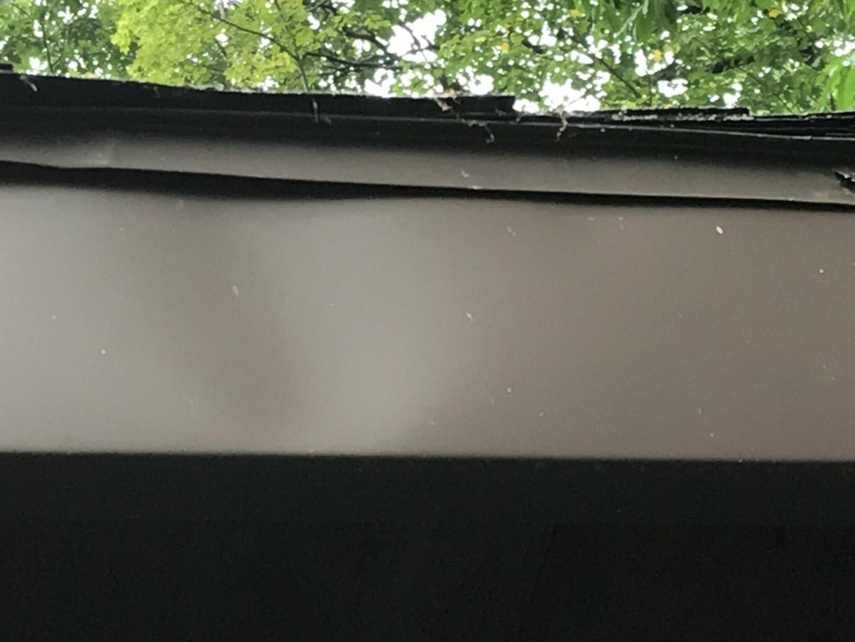

Ok, there might be a photo attached. One of the fascia boards that I covered in aluminum. Spell check changed it to fascists... Gotta love technology!
Since you're painting your new boards you won't have to worry about them for a while.
