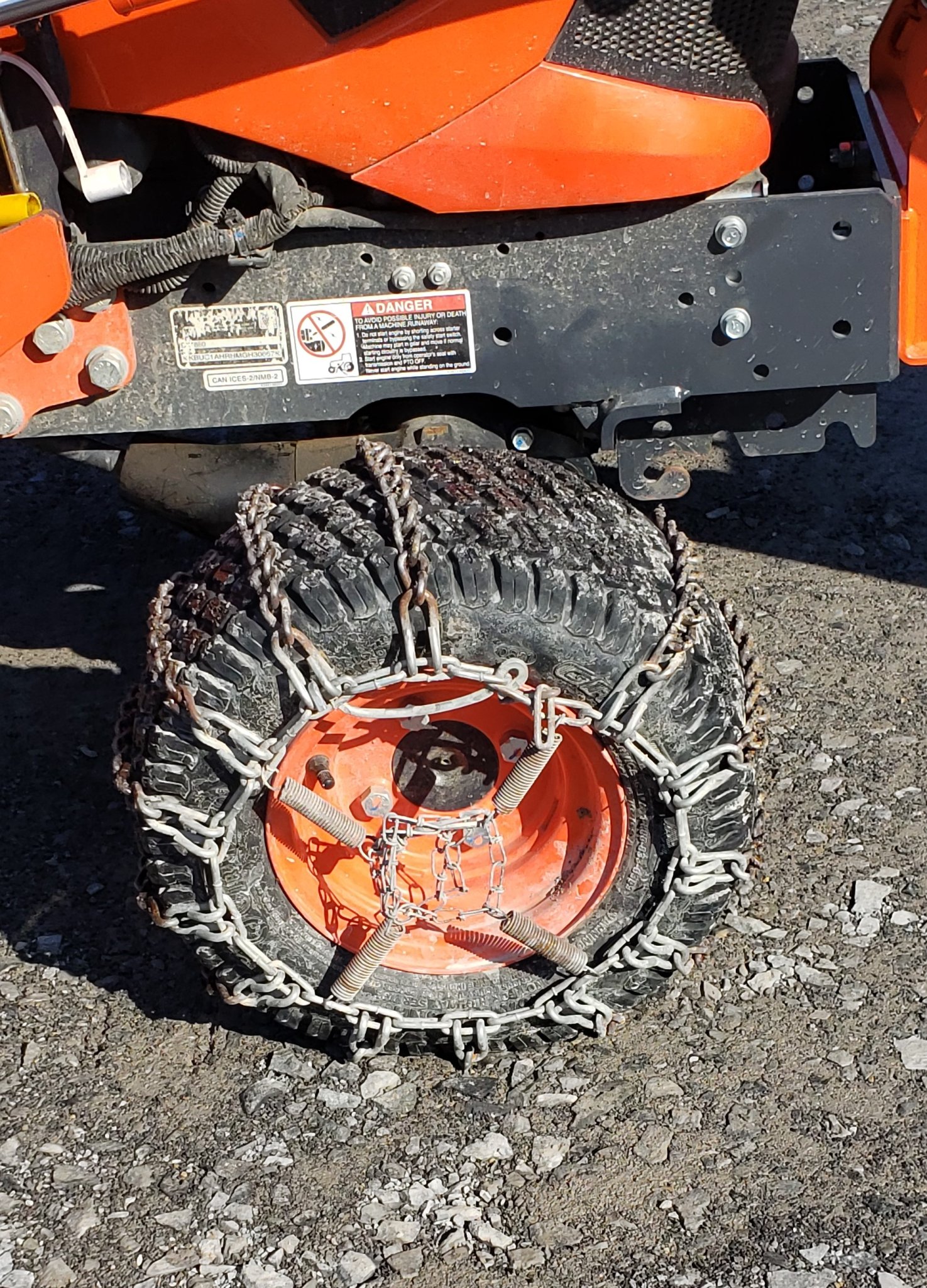

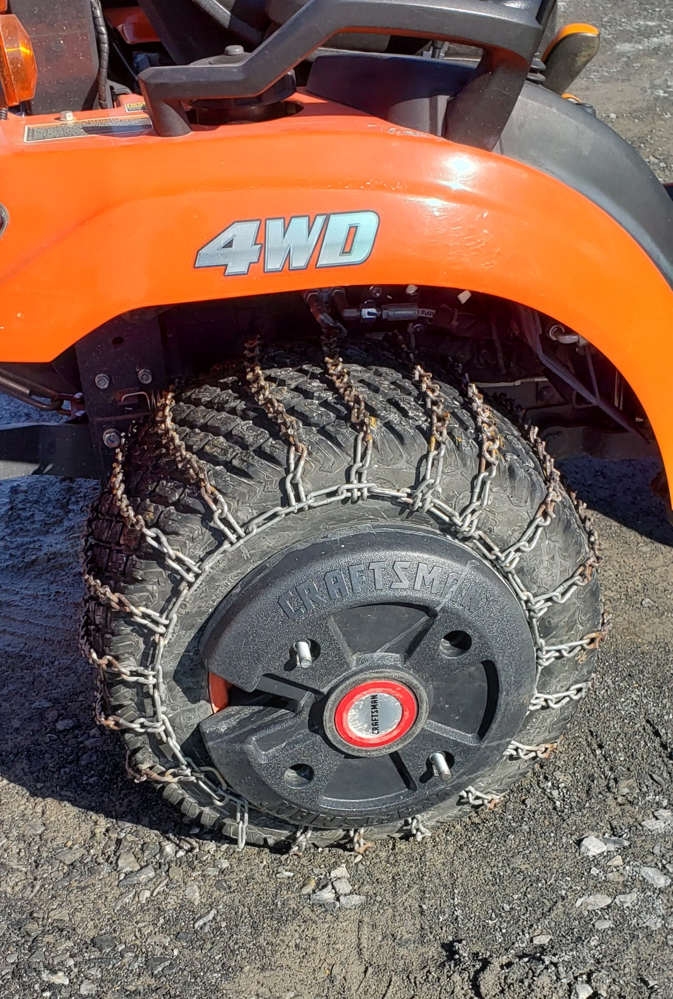

MUST HAVE CHIANS. At least for my situation, I have the smallest compact, BX1880.
Got them at chains dot com
I have turf tires and they are great in snow - but - I loose steering when pushing full loads of snow.
your tires may be a bit bigger diameter so clearance may be tight.
