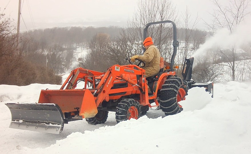

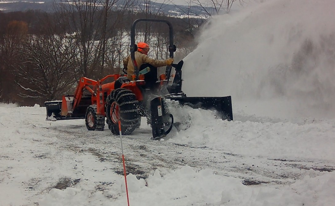

Sure they help, A must have on my steep road that is usually covered with ice when it thaws. Fortunately, my tractor has adjustable wheel spacing and they are way out wide.
