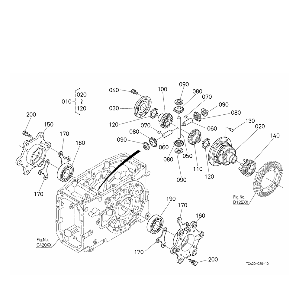

The RH side will have to be removed to repair the differential lock, as the entire differential assembly must be removed and disassembled.
The clutch pins, #140, will be damaged on the ends from rubbing against the back of #110. The pins will have torn up the back surface and smeared metal across the holes of #110, where they have to enter to provide the differential lock feature.
With the pin tips damaged, #140 can not slide freely through #20.
The entire repair could be performed through the RH side with the RH axle housing removed.
View attachment 169217 View attachment 169218
Thanks for the details. Very much apritiated. How likely is no. #110 damaged as well?

Hi guys,
I’ve run into a new issue. The mechanic can’t order part no. #140 (dogs) from the image above — it’s currently unavailable anywhere in the EU until July. The tractor is already disassembled, and it can’t remain in the workshop for that long.
Do you have any ideas on where or how this part could be sourced sooner? One option might be ordering it from the US, assuming the American L3200 and the EU L3200 use the same part in this case?
Any suggestions would be appreciated.

Hi guys,
I think I have found it on Messicks. It says it usually ships in 3-7 business days . I wonder if this needs to be checked beforehand? Just to make sure I won`t wait for months.
