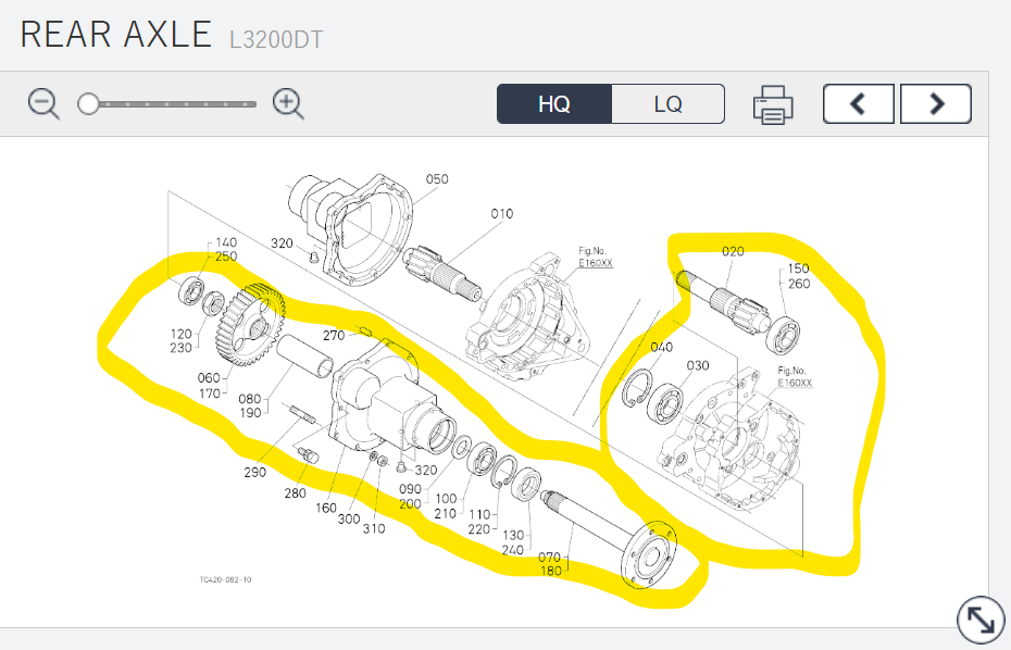

You will need to do a tear down if it's damaged, the top cover will only let you see it.
How complicated is this repair if it proves that dogs are broken? I will get a quote from the Kubota repair shop tomorrow, but I am scared of the bill, so I am already thinking of trying to fix it myself. Can it be done? So far my best mechanic achievement was repairing a bicycle 🥲. Otherwise I am handy with tools but totally different field, woodworking.
36,226
11,124
I personally think it's a rather simple repair.
But I'm probably not the best to ask as nothing on that tractor seems complicated to repair.
I would open up the top and that would let you see what your dealing with.
It might be as simple as a sheared pin.
7,948
3,105
Thanks for the hint. Indeed, I missed that detail. I will take a look as soon as I get to the tractor. Meanwhile I tried to search for the dimensions of the pin. Attached find an image. It looks like it is rather long. I guess it is around 1.375 inches and I assume shaft rod is around 0.5 inches which means pin would be sticking out on each side.
You might just take this linkage apart and see if the rod into the tractor can be rotated by hand with some locking pliers.
Taking the top off only lets you see it, not fix it (if the pins are sheared) as NIW stated. I think you may be able to pry it back if it is stuck in position and the pins are not sheared. It is just a lot less work than getting there from the sides (as I see it).
Depending on the damage you might need to get into both sides, but you would start by getting to it on the left side housing.
Left even the foot lever is on the right side? And do I need to remove the top just for the diagnosis or for repair as well? Any special tools required? Thanks in advance.

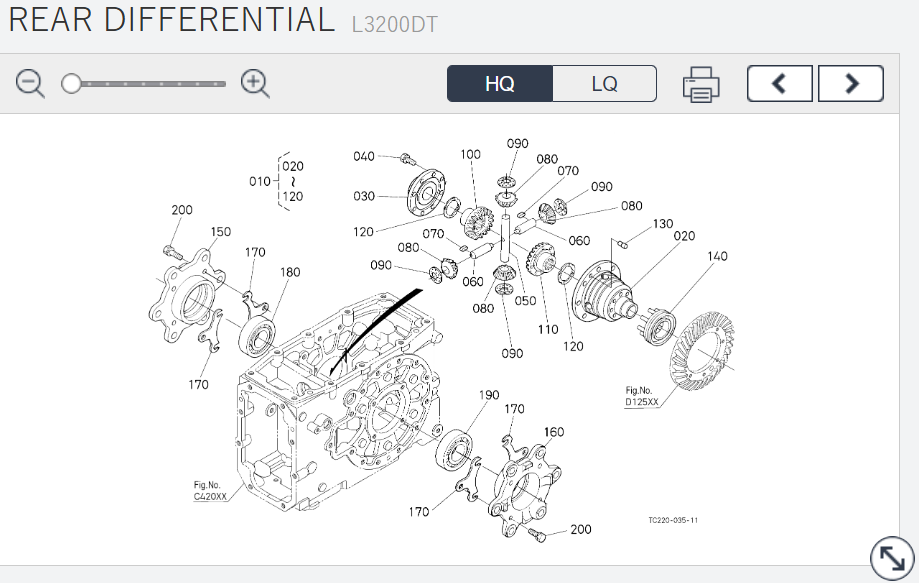

As I understand it the repair can be made with the top left on. Assuming that the pins are sheared or stuck. Other repairs like a sheared pin in the linkage will require the top to be removed if the sheared pin is internal.
The left side (sitting on tractor) is where the different pin carrier is installed.
But if you need to get the actual differential out of the tractor then both sides and the top have to be removed.
That is the way I see the assembly anyway. I have never taken one apart in my life though.
As far as difficulty level, it is all in the upper half of easy to difficult. I would guess at 6-7 out of 10. The parts may be pretty heavy and gears can certainly pinch fingers hard. But if you use a wood lathe you are likely aware of that type of danger, I am pretty sure you could do it in an enclosed shed with a solid floor. I would NOT recommend doing it in a muddy field unless you built a wooden (heavy duty) floor and some tarp (tent) over the tractor to keep rain and snow out.
I still recommend getting the top off first to see what is going on - since the locking pins seem to be substantial AND you have not said anything about a loud popping sound when you applied the differential lock.

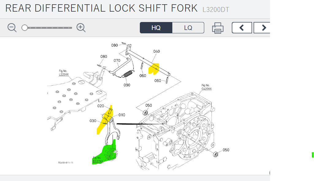

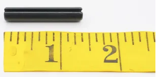

You need to pull the top cover first as your repair could be as simple as replacing pin 020 and keeper 030. (yellow).
Pin number 020 goes through shaft 040 and if that pin is broken or missing then the diff lock fork will not move to disengage the locking collar (green part).
The likelihood that you have broken the engagement pins on the locking collar is really rare!

@North Idaho Wolfman
How does the differential lock pin plate get moved into and away from the holes? I just see the pedal rotating shaft #40 which moves the fork in rotation? I think I may see a slot at the top of part #10 that may allow pin #20 to move the fork back and forth- if that slot is a helix shaped slot.
Sorry for being so curious but I can’t locate a picture of the fork to see how the slot looks.
36,226
11,124
Yes the fork has a helical slot that when the shaft and pin is rotated pushes the lock in and out of the differential.
