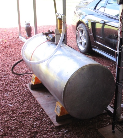

Been down this rabbit hole. Started with two 55 gallon steel drums that started to form surface rust inside. Switched to white plastic drums and had one crack on me. Fortunately it cracked above the fuel level. After that I found a 100 gallon aluminum tank off a Freighliner truck at the salvage yard. I think I paid $80 for it.
I have a $65 eBay 12V pump, hose, nozzle setup. Last year I bought a auto shutoff nozzle for another $30 and added a goldenrod filter. Plumbed it with PVC pipe.

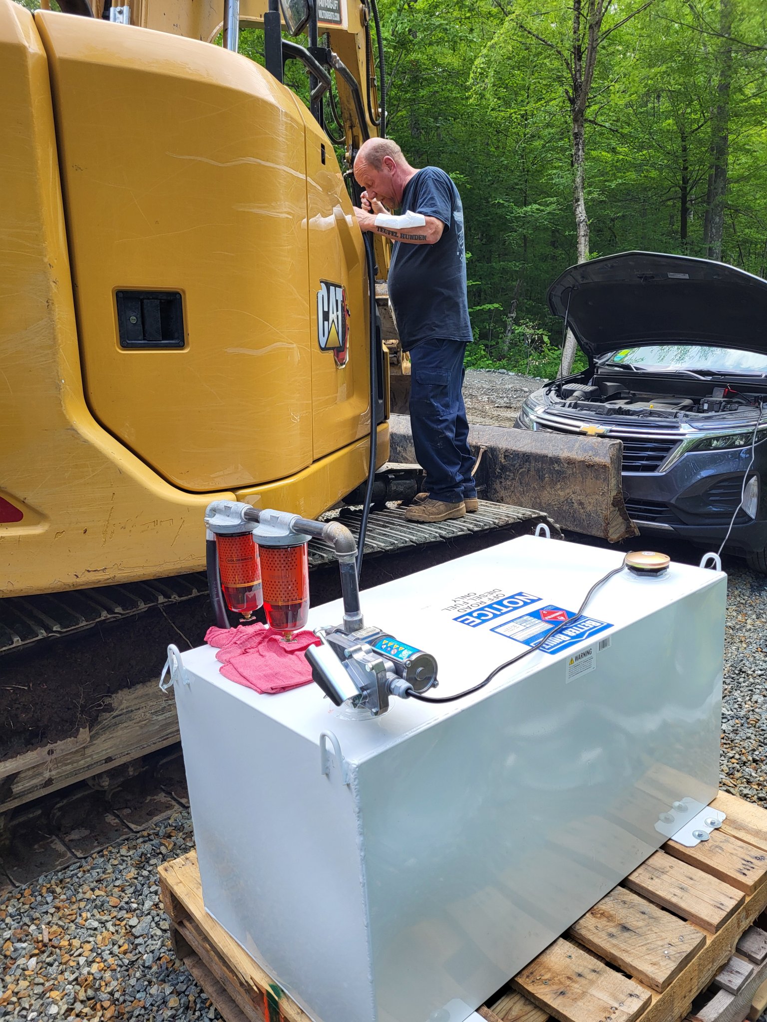

First use of the new transfer tank today to fill tractor and rented Cat 315. Fittings were dry except for a slight leak at nozzle swivel. Bit of jockeying to get hose to reach and power from my car battery but managed. Going to move tank up closer to top of hill where the action is once I level a spot and finish a shed to protect from elements.

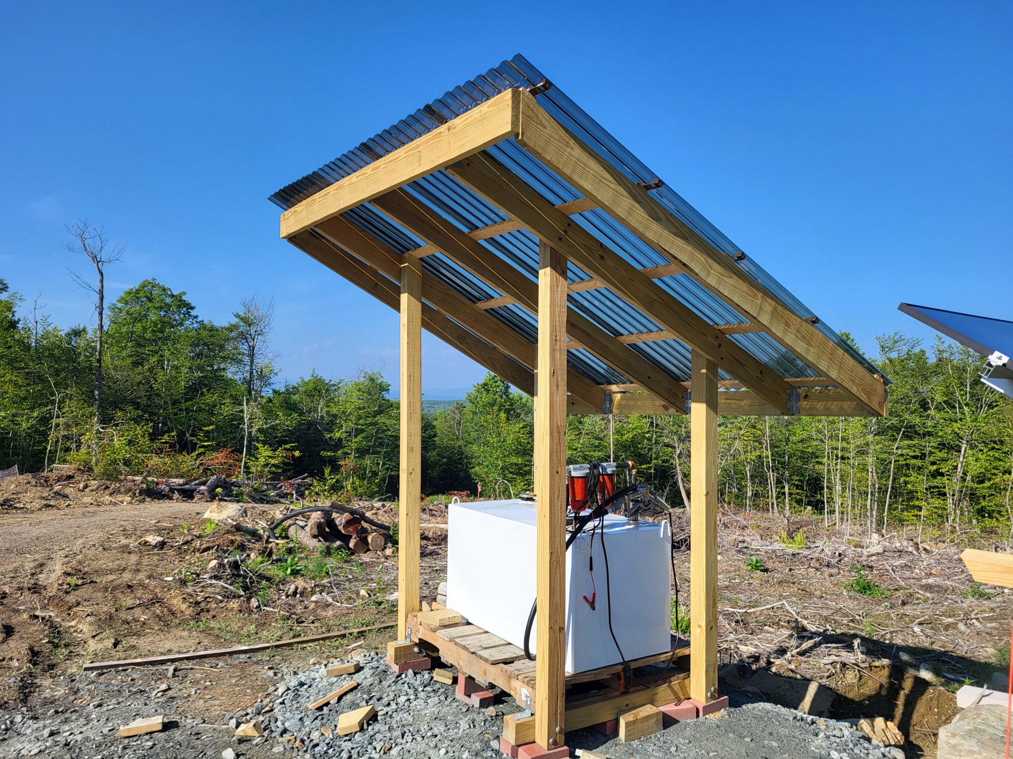

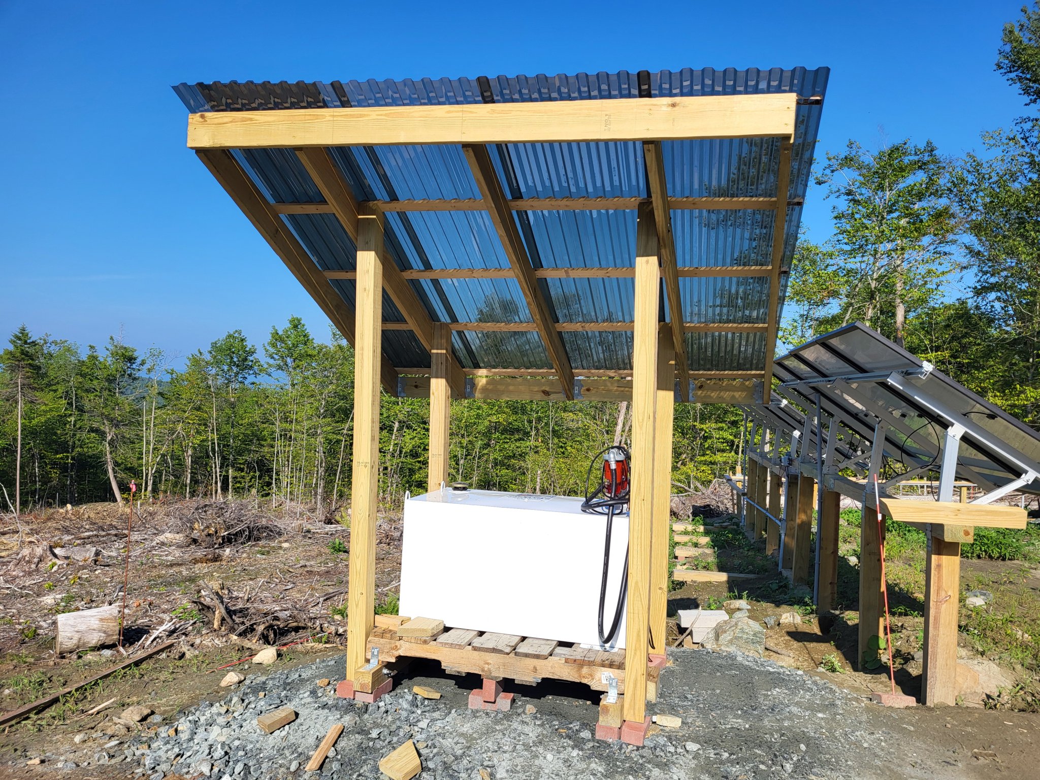

Finally got around to reviewing my posts. Never uploaded pics of "finished" pallet/shed fuel tank. Designed to be as light as possible to be movable with forks. Thanks for all the tips and advice along the way. Have the solar panel and deep cycle battery and controller yet to install Wolfman. In the interim, using tractor or mini ex battery to power pump. Did try the auto nozzle but it is not compatible with the pump I chose. So using the manual nozzle for now. Setup is a vast improvement over hauling gerry cans back and forth.
