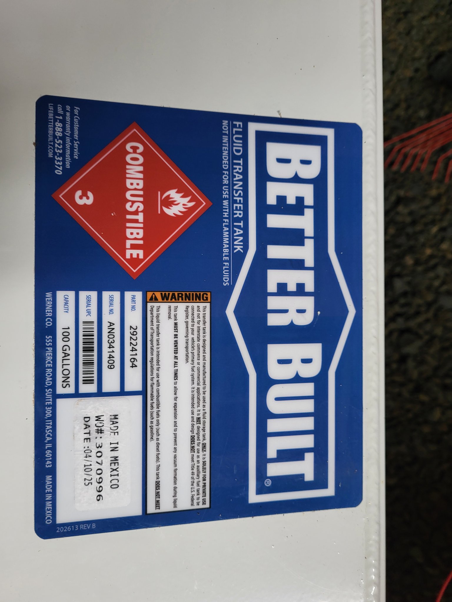

So took delivery of 100 gallon Bilt Rite steel tank (Mexico, not China), 12 v pump, auto filler nozzle, hose. Welds actually look pretty decent. Now just have to get filter assembly and associated piping. See that some folks have no filter, others one, and some others 2 in series. I was looking at Goldenrod system with 10 micron filter and water " blocking". if the one filter does both, do I really need a second filter? 2nd filter would also be 10 microns. And which order to put filters in? Pictures to follow if this #%**%@# rain ever stops.

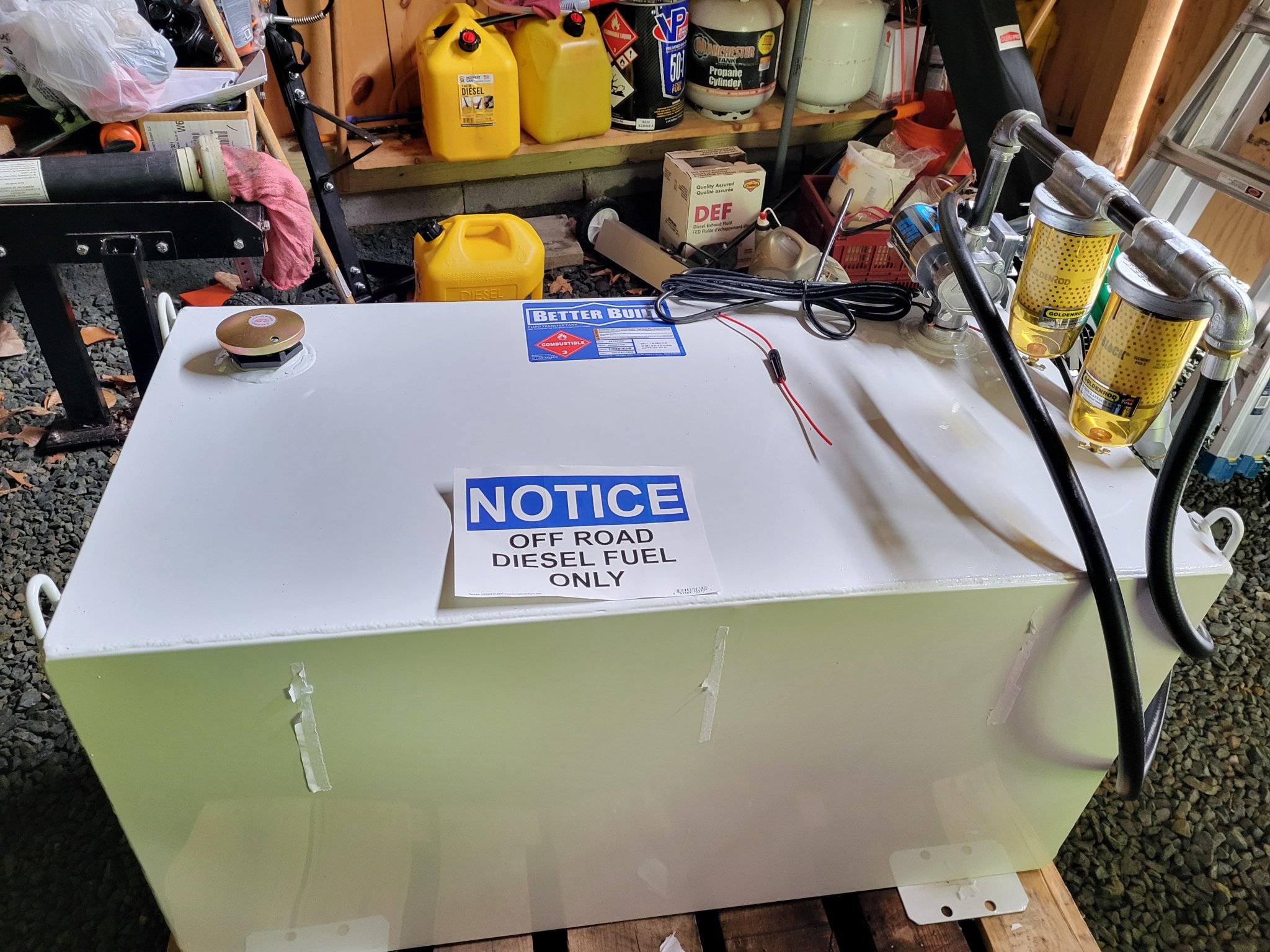

Pouring rain here so good day to work on diesel tank. Assembled pump, filters, hose and auto nozzle. Next steps will be to build a sturdy pallet with a shed style roof to repel weather. Fuel supplier will do an "inspection" prior to filling.
Question. The nut and wing nut on the filter bottoms are to drain water/particles. Are these 2 types of nuts for redundancy and to ensure that they don't come loose or is there some special technique to draining these. Pics below. Thanks gang.
8,005
3,144
That looks like a typical petcock. The “wingnut” is all you need to turn and fluid will start coming out. They were used on radiators in the past. You may have one to drain the tank on your air compressor.
They are also called drain cocks.
The hex is what is used to turn the petcock into or out of the housing.
8,005
3,144
And that set up looks like a perfect mess making arrangement when you need to drain the water or sediment out of the filter. You may want to steal an old baking pan from your wife, buy some aluminum foil pans to discard, or get a form a funnel to drain into a bucket off to the side.
Thanks Russell. Appreciated. I see your point. I can swing the array out over the side of the tank but I was concerned about hanging it out where it could be snagged or collided with. It was a bit tricky to get all joints aligned with proper tightness. Will do a leak test with minimal fuel.
8,005
3,144
I wouldn’t worry too much about it. If you’re getting good fuel hopefully there won’t be much water in it to drain out. It may take a few years between drainings if you get lucky!
