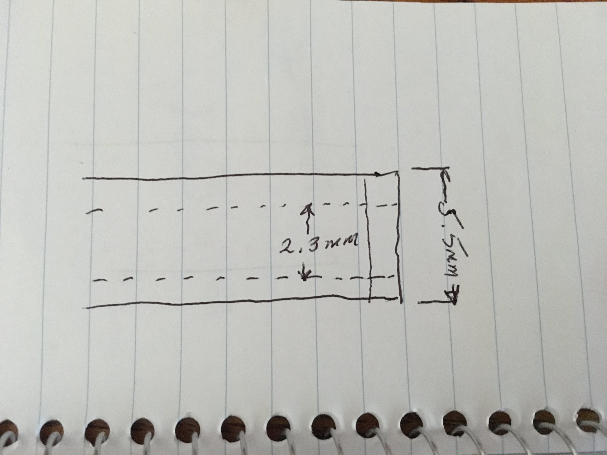

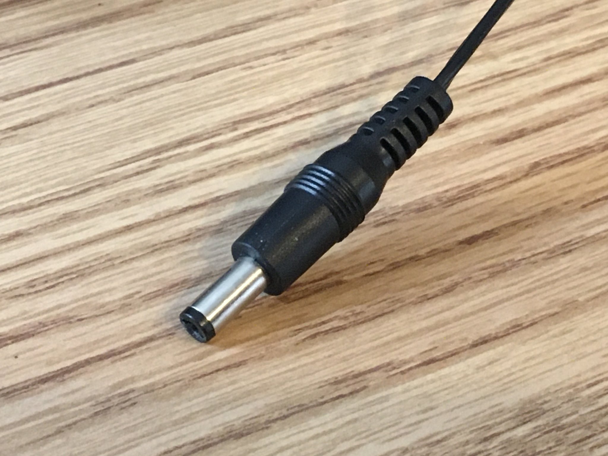

Maybe someone with DC barrel connector experience can clear things up for me.
I am wanting to order a adapter for a backup power source (12v 3amp output) that has a male barrel connector that measures 5.5 mm outside with a inside dia of 2.3 mm.
Which female adapter would I need to fit the male connector. It seems that the inside diameter of 2.3mm does match up with the adapters I am finding online. Either 2.1 or 2.5 mm is offered for the ID. Note: I do not know what the pin diameter would be.
I am including a picture of the male end on the power source and the dimensions of the OD and ID.
Not that it should matter but the device I am powering also has a input rating of 12v 3amp but has a socket/female that uses a male 6.3mm x 3mm end.

That sure looks like THESE I see that you say your inside id is different. I have used dozens of these in video camera installations in the woods here. Pretty much a standard.

That’s my problem. The outside dimension is 5.5mm and I have the choice of either a 2.1 or 2.5mm inside. Mine measures in between these at 2.3mm. I have nothing to measure to know what the pin sizes are.

What are you measuring the diameter with? If you are using calipers they are notoriously inaccurate to measure the ID of small holes.
Do you have a set of drill bits by 1/64" sizes? Find the drill bit shank that just fits in the hole and measure that OD with your calipers.

Great advice, thank you! After finding my closest drill I have( #46 .081 ) and recalculating it will be the 2.1mm ID x 5.5 OD adapter.
