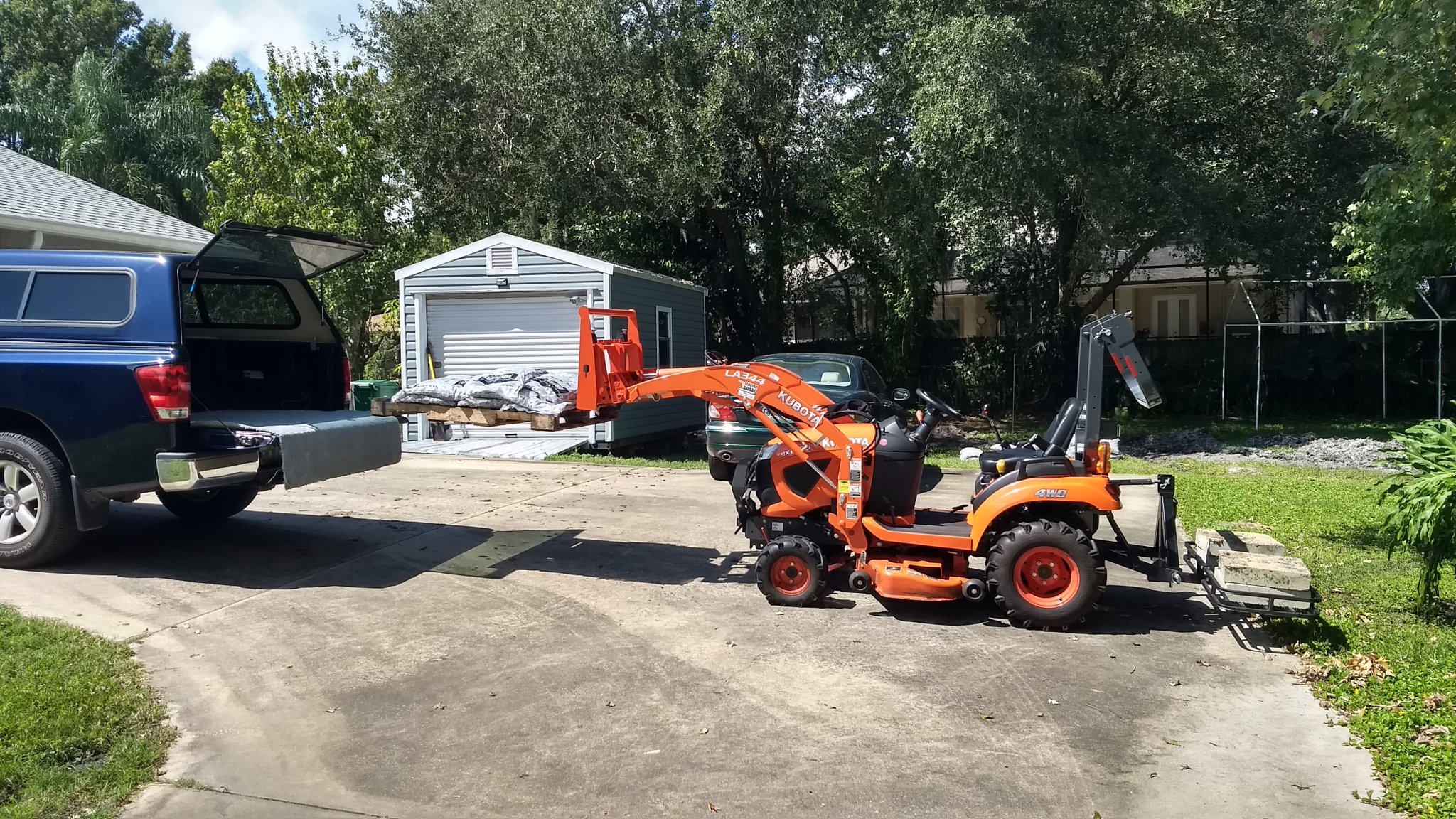

This is my cheap ballast setup:
A standard 2 inch receiver cargo carrier with 4 16X16X4 concrete blocks (about 97lbs each). These days, I secure the blocks with ratchet straps in place.
