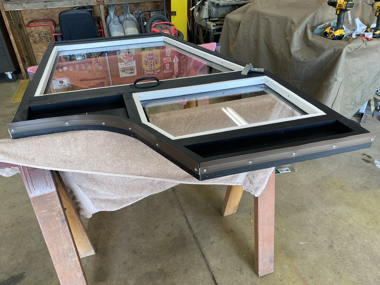

Got the door glass installed with some silicone and screwed on strips of PVC molding to retain the windows. 93030518-411E-4BD4-8633-F2A88043DA57.jpeg

Looks good. I'll bet that you can't wait to try it out to see how well it works, and then you will hope to not need it again for a while. I remember when I got a cab on my tractor, how pleased I was to be in the warm surroundings. Now I dread winter since it still takes a lot of time and effort to clean up the snow to bare pavement.

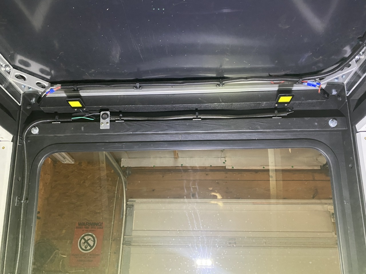

Got the weatherstripping on the back and attached the back panel. The small lower window is in and the window gasket is in for the upper window. Today, I wired the front work lights and wired a couple of LED dome lights inside.
46A303C6-562D-4C1E-8DDF-136A9384A63C.jpeg 432B533B-50C4-4635-B967-37ADFD611AB4.jpeg

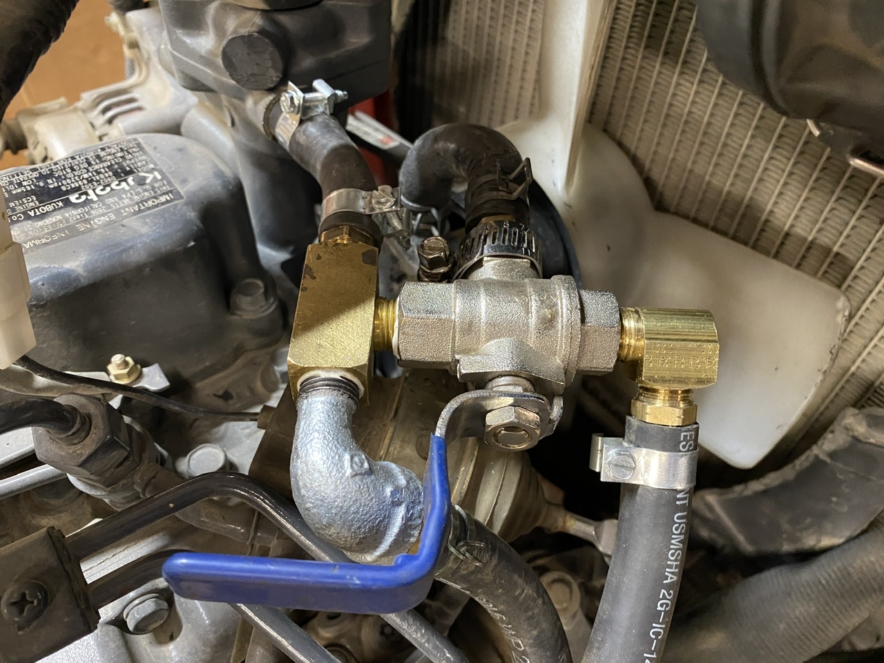

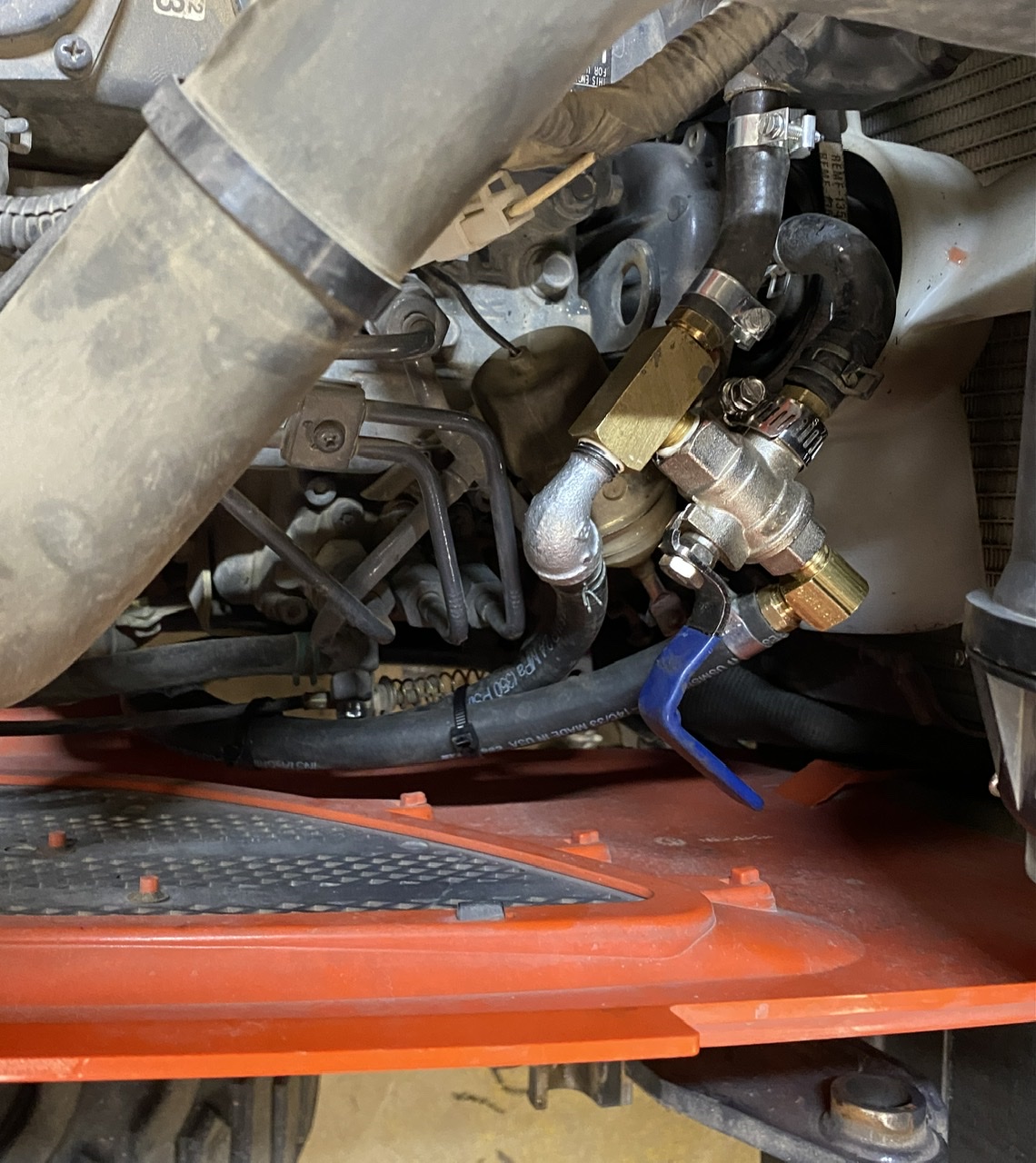

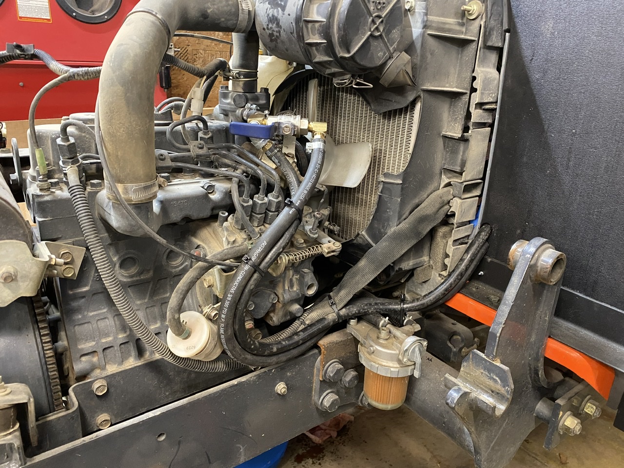

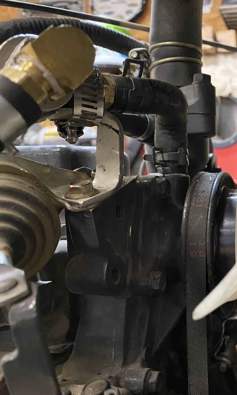

Plumbed the heater today. The 3-way valve lets me select sending coolant to the heater or bypassing it back to the engine. A simple bracket and a hose clamp holds the valve. I reused the factory bypass hose to connect the valve to the water pump. All that’s left is to refill and bleed the system.

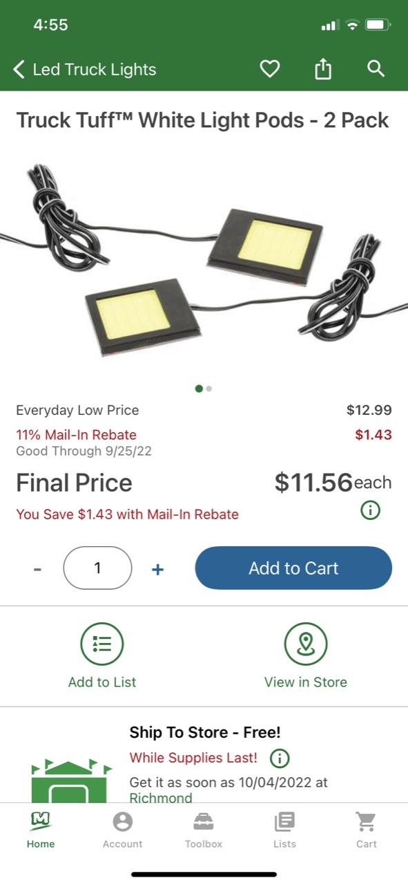

Found them at Menards. One probably would have been enough light.
Same lights I use in my home made cab. These lights are great!!
View attachment 89692 View attachment 89693 View attachment 89694 View attachment 89695
Now that's a neat installation of your 3-way valve!!

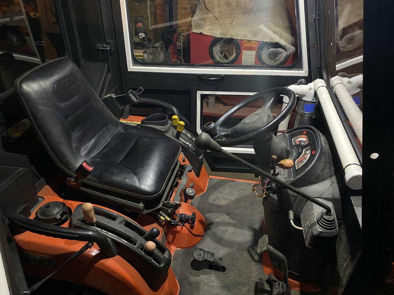

Thanks OrangeKrush. Hopefully, I get to use it some this winter but not a lot. It will definitely be nice to be out of the wind when I’m clearing the driveway at 5:00 AM.

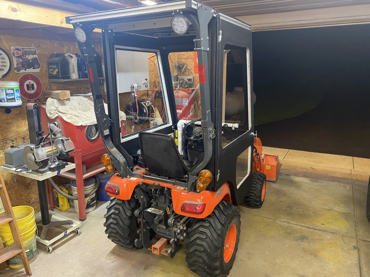

It was 32* F this morning when I pulled the tractor outside to test the heater. After running for about 30min, the temp in the cab was 62* F measured with a thermometer laying on the steering wheel. CCA16E4F-774E-4047-B190-FCD2741BA73C.jpeg

How about a pic of the back of the tractor! I see something interesting back there!
