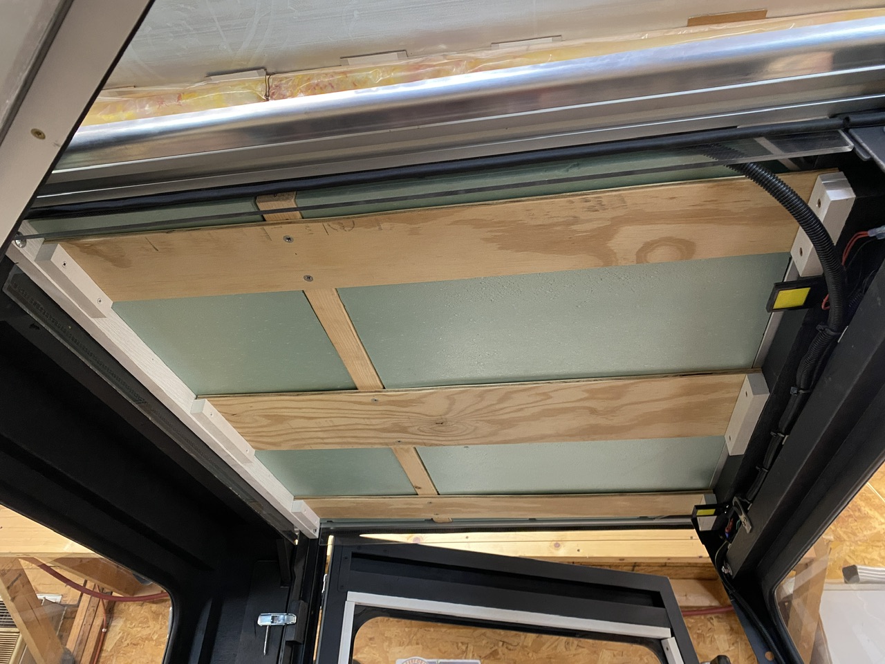

Mounted a fire extinguisher between the door and back window. I added some insulation to keep some heat in and hopefully some noise out. 351E9D27-9B38-4C7B-BB4F-A5A93E812AC3.jpeg 55369A3E-9847-4ECE-98F4-531723B373FC.jpeg B1D00C04-F790-4794-BEAC-4A98059CFCF4.jpeg

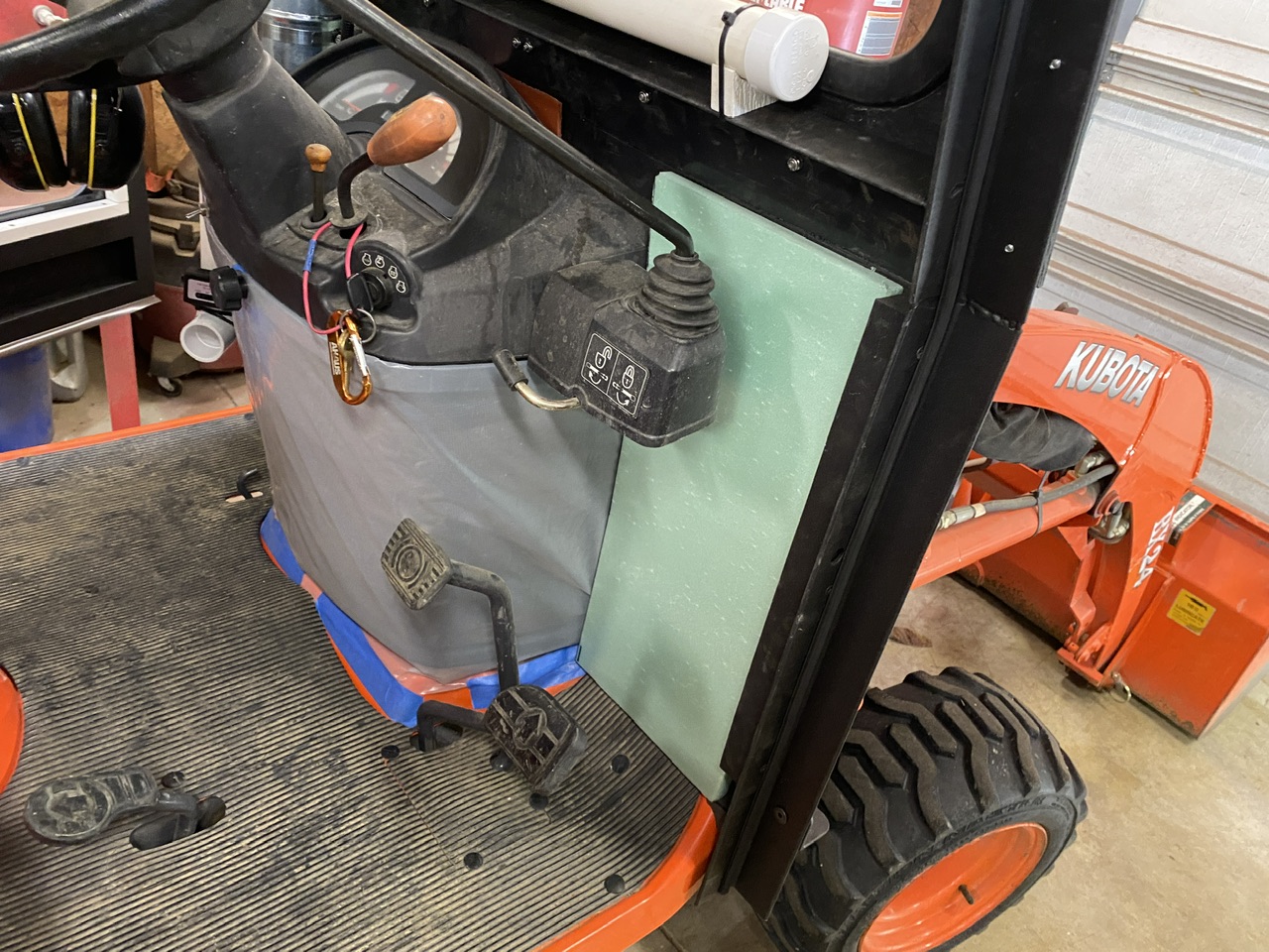

The insulation seems to have made life a little more bearable inside the cab. I think the top was reverberating and reflecting sound and the 1-1/2” of foam board has tamed it some. I’ve added some foam rubber in a few other places to seal up air leaks.
I had added magnetic latches to the back panel to hold it in place until the inside latches were secured. They worked fine until the windows and gaskets were added which added enough weight that the magnets weren’t strong enough. I found a rubber Jeep hood style hasp that I added to the top of the back panel.

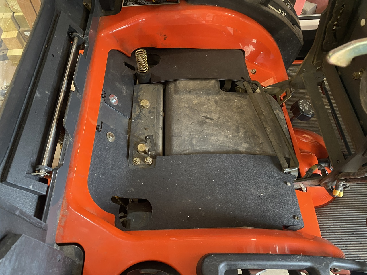

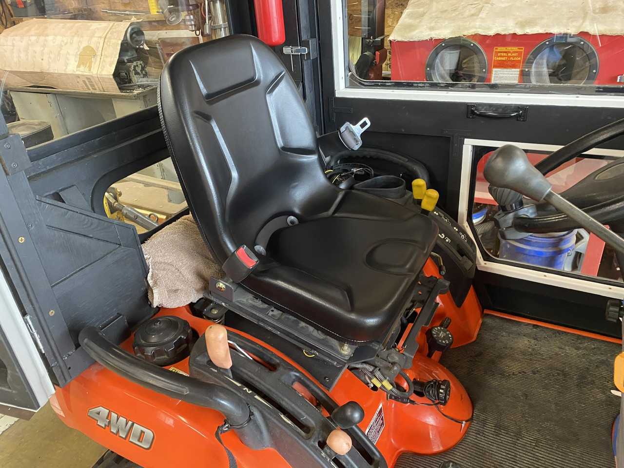

A couple more improvements for the cab. A new seat to replace the horrible, sloped factory seat and some plastic filler panels under the seat to seal off some holes. I also bent the loader joystick a little to the left so I don’t hit the window when dumping the bucket.

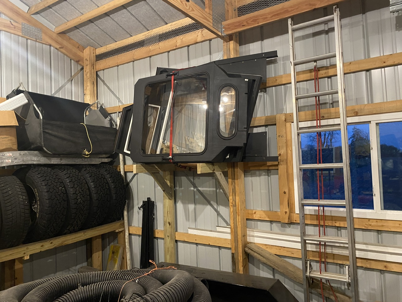

I pulled the cab off a few weeks ago and tonight I moved it to the barn for storage until next winter. To get it out of the way, I screwed and lagged some 2x4s to the wall to set the pieces up on and held them there with a ratchet strap.

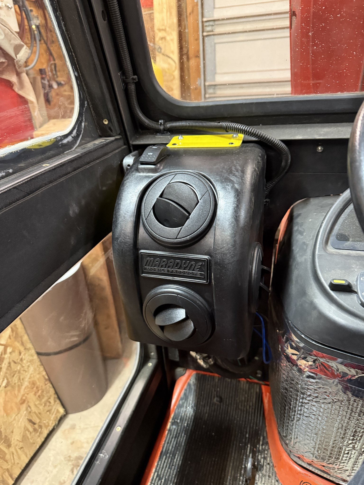

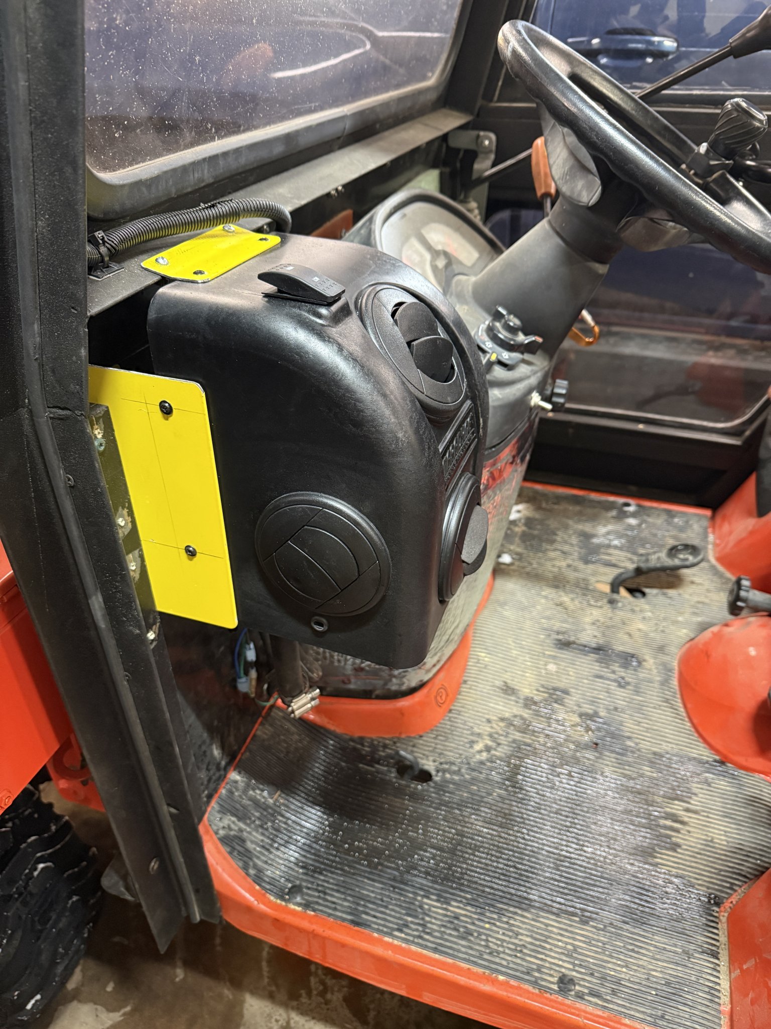

I finally upgraded the heater today. It is rated at 13,200 BTU so it should heat the cab nicely. The door latch handle needs to be reworked because it hit the heater.
You'll now need a short sleeved Hawaiin shirt to wear while moving snow!! :ROFLMAO:
It definitely puts out much more heat than my homemade contraption of a heater. I’ll hold off on the Hawaiian shirt shopping until I have done more thorough heater testing. Lol

The new heater works great. It was 15* F and with the fan on low I was moving snow with just a flannel shirt on. No hat or gloves.
