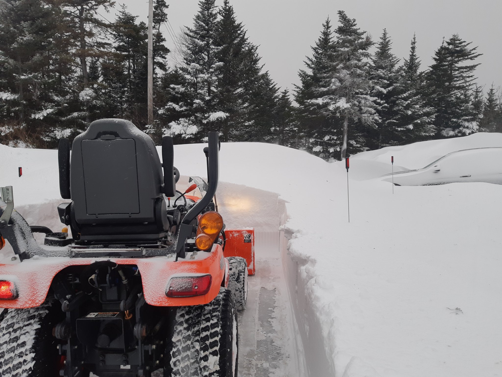

I have a BX25D with a BX2750D front blower, back in January 2020, we had Snowmageddon.....3' of snow with hurricane force winds. That left over 6' of drifted snow in my 350 foot driveway.. The Kubota tackled it with no problems, lots of knocking down the snow, but 4 hrs later, all was done.
