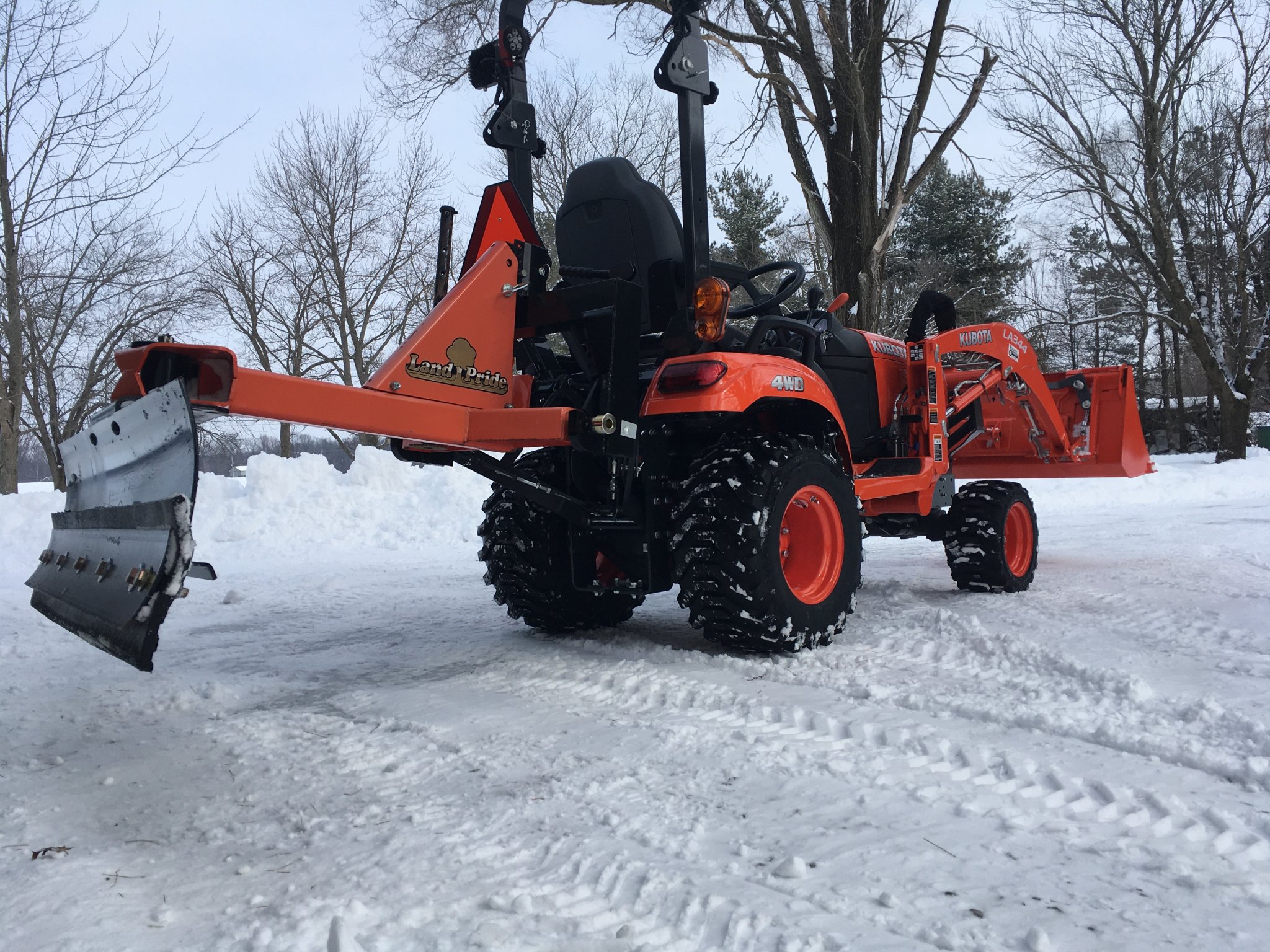

No experience with a blower as our snowfalls haven’t warranted the expenditure. I used a rear blade with rubber edge on my BX for several years until I found a used BX2767 front blade. Now, I don’t bother turning around.

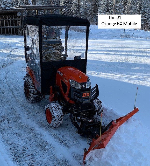

I use my plow on the lighter storms and the blower when we get bigger storms or wet and heavy. Plow is a lot faster. Just put the soft cab on 2 weeks ago
