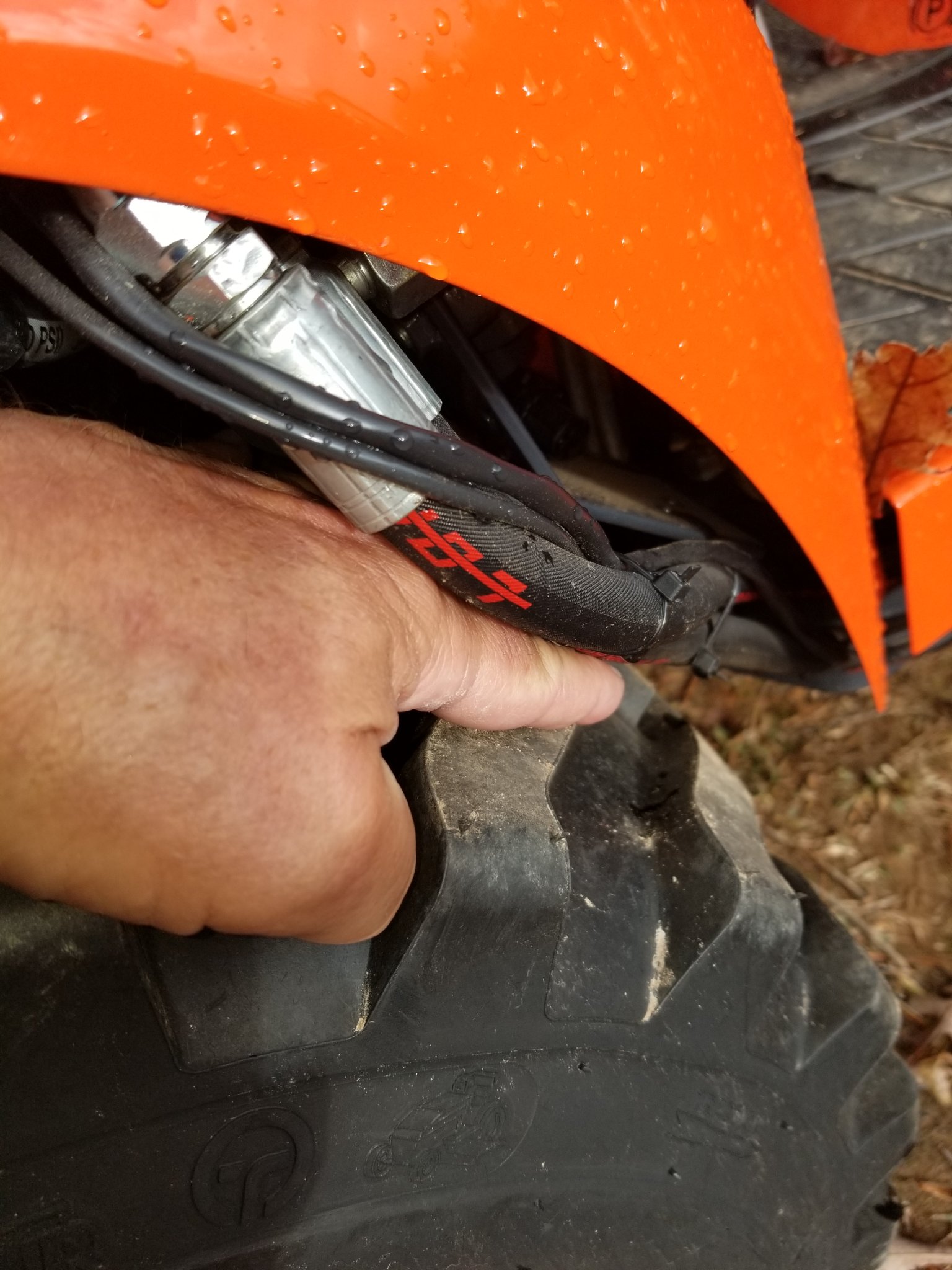

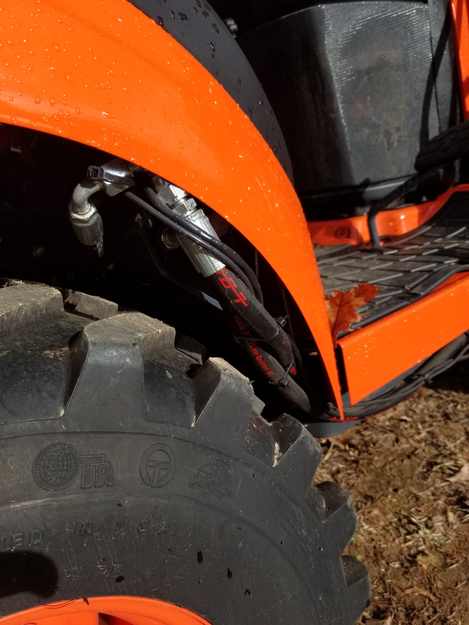

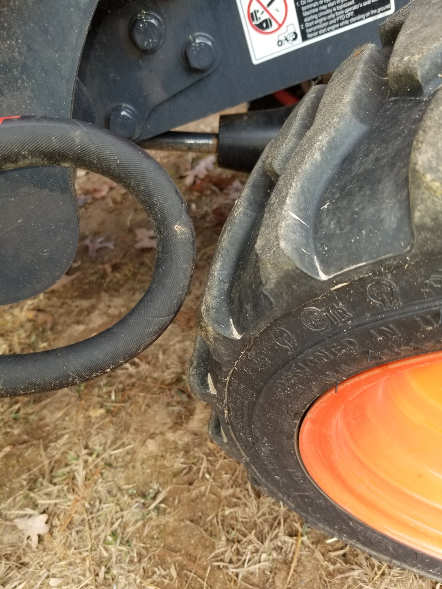

New here. And, have a new BX23S. I had the Dealer install a Third-Function unit on the tractor. I'm thinking he did a very poor job of it. But, before I interface with them I thought it would be a good idea to ask those with experience first.
First of all he installed a W.R. Long unit. Going to their webpage the LA340 loader is not specified as being compatible. But, it does function. The problem is that he routed the unprotected hydraulic hoses between the wheel and fender on the rear. There's only about a 1/2" of clearance between tire and hose. When I stick my index finger between the tire and hose the finger hits on both sides of the gap. It's just a failure waiting to happen. If I get mud built up on the tire or a stick in there and it's going to get impinged and leak. Then, there's a loop on the front that gets the unprotected hose within an inch of the front wheel when it's turned hard. I have pics attached.
Just looking for confirmation that this is No Good. Other than calling and complaining, which I intend to do, I'm open for suggestions.

Yep! That's the worst installation I've ever seen on anything tractor related. What a disgrace! :mad:

I have never been around that model tractor but I would never accept that installation of that valve. The first muddy day on this farm and that valve would be finished. Its crazy someone thought that was a good way to mount a valve.

I agree. Thanks. I did find that there is a specific kit for this tractor. And, that's what's on the Bill of Sale. But, I can't verify that the correct unit was installed. And, it's certainly not installed properly. Unfortunately I can't find the installation instructions. I'll contact WR Long on Monday to see if I can find what it supposed to look like. Their installation video is of a different unit and tractor.

sigh...... Has to be in the top 3 for the WORST installation of the CENTURY !!
Tire gap is 'miserable' and the bent hose looks a lot tighter than the minimum 6x the hose radius I was taught.
Bet you can't mount the MMM either !!

Thanks. You're probably right about the Mid Mower Mount. I don't have any intention of using it. But, still, that's not the point. Thanks for pointing that out.

That looks terrible.
Is the control valve mounted to the outside right of the tractor by the loader arm?
You should have gone with the Land Pride kit.
I wonder if the tech was irritated you didn't get the LP kit. Deliberately installed it half assed.
I would take that back and get it correctly installed.
