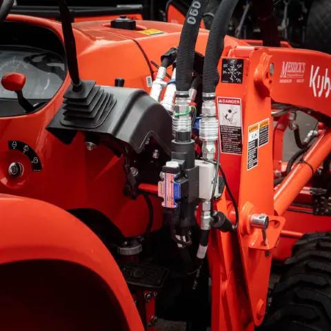

Landpride makes at least two different "OEM" kits for the BX80/LA340.
Here is one that is for all practical purposes identical to the $700 Summit kit. Messicks wants $1150 plus shipping.
That's for an older BX, not the 80 series. Or even the 70 series?
See where the joystick is mounted? It's on the right fender for the 80 and I think 70 series.
I stand corrected.
That's a 70 series I think.
Either way that kit won't work for an 80 series. The loader valve is in a different location and the quick disconnect for the loader hydraulic lines would be in the way.

Messicks thinks differently because they explicitly state its for the BX80.
Here is their other BX80 kit - presumably the one you have. It lists for $895 plus shipping.

Those are Land Pride kits? What are the part numbers?
Unless the loader valve is under the right fender and not under the joystick that first kit wouldn't work for an 80 series.
That second kit looks nothing like mine.

There's a Kubota diverter valve kit. That's cheaper I think.
That's not that picture either though.
Like I said - lots of different Landpride kits.
I assumed the second one I pictured (380-289A) was the one you have. Messicks lists it is for use on multuple BX80 series tractors including the BX23S-1
The only 3rd function diverter kits I have seen are used in conjunction with a 3rd function valve and allow the joystick 3rd function to control an addituonal cylinder for hydraulic latching/unlatching of the SSQA.
Bottom line is either the WR Long kit used by that dealer is wrong, the installation was botched, or both.

I see what happened.
Someone at Messicks wasn't paying attention.
Quick search for "Messicks BX23s third function kit" brings this up.
First hit takes you to a page with all their Kubota third function kits.
Scroll to the LA340/344 and you get this.
Lists 4 options in a row
Starting from the left, first 2 are the correct part numbers but wrong pictures.
Third is the Kubota diverter valve kit. Wrong picture again. 4th is the WR Long kit, not sure if it's the correct picture or not.
