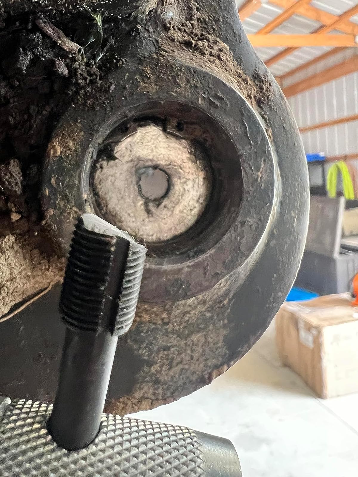

I've been searching six months for utubes showing how to remove broke zerks from tie rods. Will the same method(s) work?

Look up "easy out" and buy a good quality set, not a HF cheap one. (You don't need anything else to break)

Only the grease nipple broke off, the hex head is still intact
Easy. Unscrew it and put a new one in. The little nipple’s thread will be fouled up within the body. Don’t try to replace just the nipple.
Broken zerk fittings are easy to get out since the hole's already there for a screw extractor.

Haven't seen one of those tools in a few decades. They used to sell for a couple of dollars in the old days. I would bet that if I searched in my old toolbox I might even have one.
I almost always check reviews of tools and look at the lowest stars first. Most times it is some lame reason that the person gave it a 1 star, however, this is the exception.
[QUOTE}1.0 out of 5 stars Broke my first use
Reviewed in the United States on July 26, 2023
No, I wasn’t cranking super hard on it. I assumed the tool could handle. Now to get this out…Super disappointing View attachment 117878 ]
[/QUOTE]
But people always point out "Harbor Freight has a lifetime warranty". :confused:
5,262
3,889
That was the one from Amazon. In defense of the tool, I doubt that he did that with just his fingers on the tool. Those types of "easy out" tools often crack since they keep trying to go deeper if the part doesn't start coming out. I never use those any longer. I have a set of Snap-On removers that work 1,000 times better and don't break. They also cost a lot more than $29 and they do have a lifetime guarantee..
