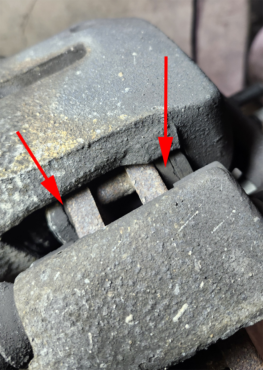

About a week ago I started to hear and feel a grinding sound from what I thought was the front left brake rotor. I took a quick look at both front rotors (outside only) and they appeared to be pristine. I had installed Brakemotive cross-drilled and slotted rotors along with Brakemotive pads almost 56,000 miles ago. I did that because the front OE rotors were warped when I bought the truck from a friend.

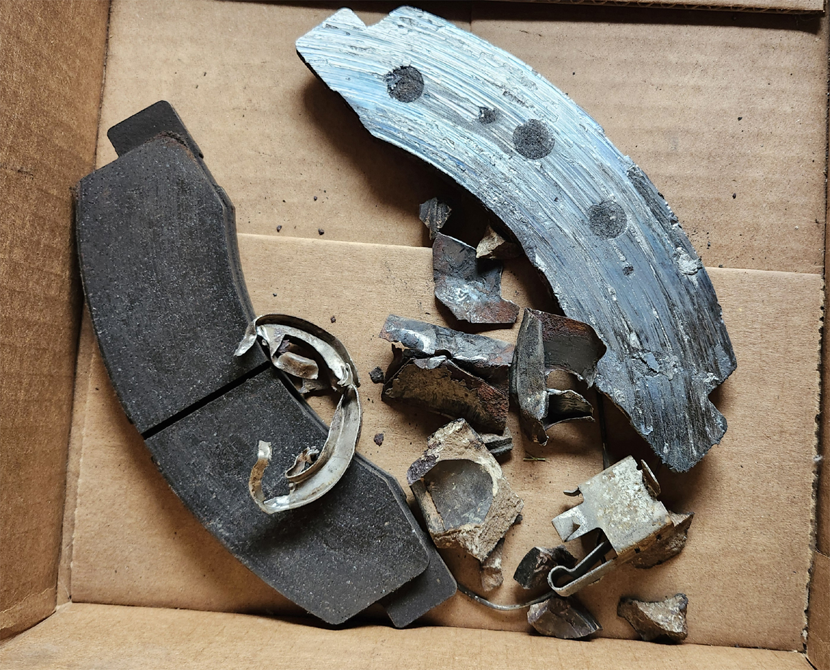

I was going to do a thorough inspection this coming weekend, but on the way back from meeting friends for dinner last night, my luck almost ran out. I came to a stop at a traffic light at the bottom of a hill about 15 miles from home and the grinding up front was bad, and when I stopped it felt like the front left wheel had locked up. Foolishly or not, when the light went green I had to put the foot into it a bit to get going and made it home without further trouble.
This morning I jacked up the front of the truck and spun the front left wheel which turned freely and without any odd grinding noise so my first thought was "well that's weird!". I went to the right front and tried to rotate the wheel and it wouldn't budge. When I pulled off the wheel and removed the caliper I soon saw what the problem was!
In all my years of owning and driving vehicles I've never seen such carnage! The oddest thing is that the inside pads on all four calipers have worn down to next to nothing whereas the outside pads have plenty of material on them. Needless to say, I placed an order for new front and rear rotors and pads, and called NAPA to see if they have Ford F250 calipers in stock since no one has a complete caliper rebuild kit that includes pistons.
The first two photos show the front right caliper and pads, and the third photo shows the difference in outer to inner pad thickness on the front left brake system. The rears are very similar to the front left.

That happens when the calipers don't float properly.
De-icer is the major culprit.
Pull the pins, clean and grease very well!
Helps if you clean up the slide surfaces too.
I always clean and grease the caliper pins when replacing pads and rotors but I admit that I don't reapply grease on any kind of schedule. That's going to change based on this experience.
The most surprising thing to me is how quickly it went from all is good to moderate grinding to catastrophic failure. I honestly thought that the grinding was wear indicators or something.

Yeah the pins are stuck. I’ve seen much worse, there is still life in those, put em back on 🤣
heck you ain’t even started grinding on the pistons, you can still go until you grind them down enough they come out the bores or the rotor is a pizza cutter or it breaks off the hub.

When I think about the fact that I have a heavy truck and do a lot of towing, almost 60,000 miles on a set of pads and rotors isn't too bad. The only additional cost that's come out of this is the need to repair or replace the right front caliper which is $83 for a rebuilt Ford caliper from NAPA. But I definitely need to up my game when it comes to caliper pin and sliding surface maintenance. This is a learning opportunity for sure.
I've had good experience with Power Stop rotors and pads in the past so ordered a heavy duty "truck and tow" drilled and slotted set for the front and back. The truck should be good to go in a week or so depending on how fast UPS can get the parts to me.

You could have had a pin binding, pad binding, or both. Uneven pressure will crack a piston. The pad backing plate can get hung up when there is rust between its "ears" and the caliper.
