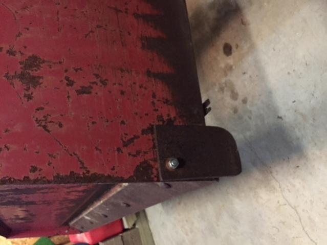

Here's a front shot. I don't have any sides shots atm. What do you think?
Still a nice setup to have. The best of both on the front quick attach. It's fun owning a tractor once all the kinks are worked out.

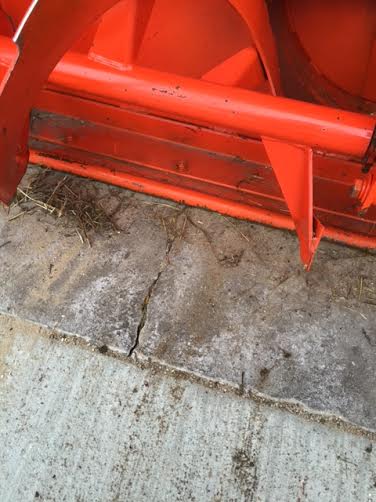

I use my front snowblower with a pipe on the cutting edge along with the
factory shoes to keep it from gouging in and skinning up the yard. I use a 5 foot
box blade with a pipe attached between the front and rear blades to again be
able to move snow without gouging the yard up.
I bought a piece of flat stock the same size at the snowblower cutting edge
then welded a piece of 3/4 black iron pipe to the edge. On the box blade I used a piece of 2 inch pipe and welded the "ears" brackets on the ends and drilled a
hole thru the bracket and box blade size using a 3/8 bolt to hold it on. I have
the blade adjusted forward so that it holds it not quite a 1/4 inch off the surface to start the winter with then using the top link adjust it more forward once I have some build up like Grouse suggested he does that cleans it down good once that layer is built up that protects the lawn from getting gouged up. Works really slick for me as I use the box blade to pull the snow away from the front of the garage etc then get behind it blowing it where I want it to go. I use the box blade when backing up if I simply want to push a bank back or when we get that wet packy snow that has a tendency to plug up the blower for moving the snow. I do my driveway a side driveway that's 16x125 along the house where the propane tank is and clear at least that much out back to keep it open for the dogs to do their business and to be able to access the car hauling trailer and get to some of my various parts collections.
