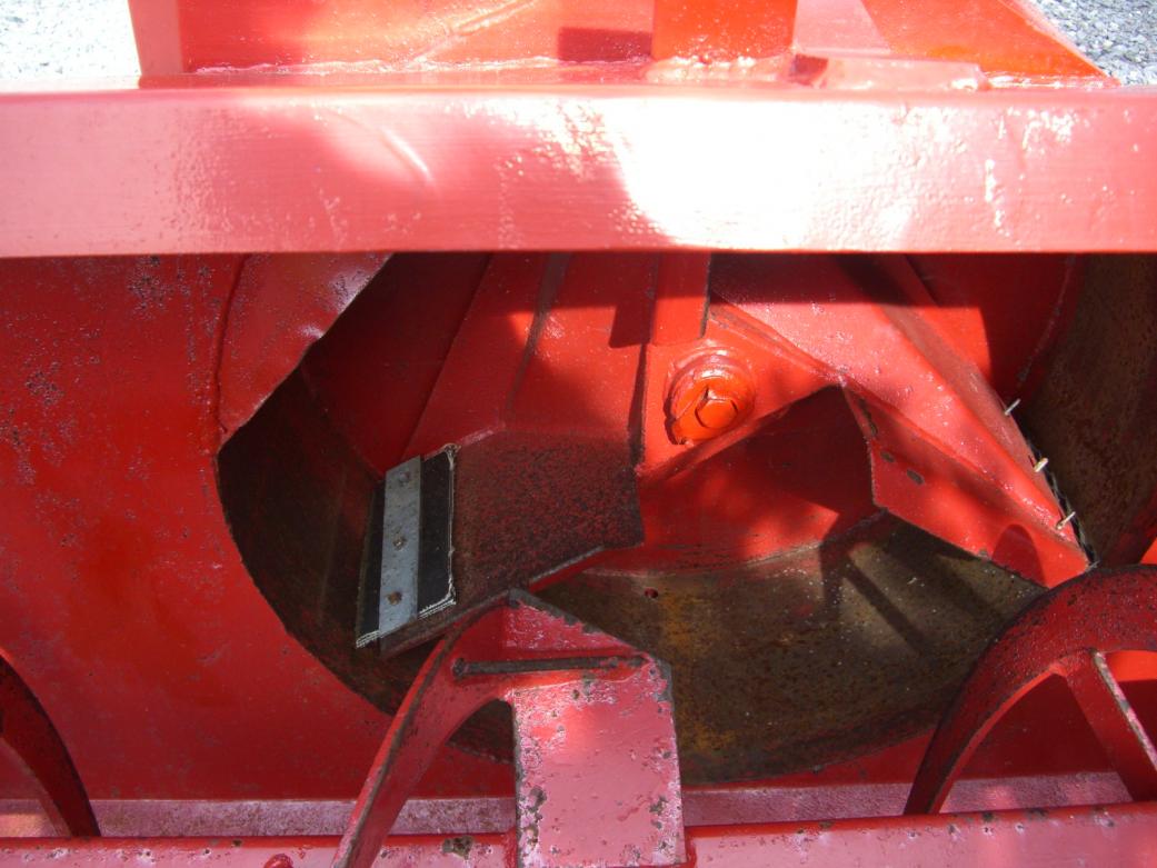

I have just recently invested in a Kubota with front blower, previously an Allied rear blower.
I fit rubber conveyor belt to the edge of the auger, leaving a small gap between the housing and blade edge. If you ar a little tight on install it wears off quickly. That has made a vast improvement to any blower it was installed on. No more clogs and stops any stones - gravel drive - from binding the auger.
Picture of the ones on my Allied blower.I have yet to install them on the Kubota as the clearances seemed quite tight.
I have the same on a walk behind and it works both to stop clogs but also extends throw distance.
Not my idea - posted on the web, look at youtube
I had been looking online and found some of the fitment kits people will throw on, mostly guys using the push blowers. I'll have to measure my gap, and see if it applies. I'll look into it thanks!
I wonder why Kubota wouldnt build those in there if they do in fact work? Seems like a great money maker for them replacing worn rubber pieces with KUBOTA BRAND at $50 a pop. :D

Thats a good idea, Would a thin piece of pvc hold up or would this have to be screwed in?
The pipe is split on one side so it looks like a nearly closed "C" from the ends. You then drive the pipe on the cutting edge. There are threads here where PVC has been used on the cutting edges of rear blades. I think most of the snowblowers have used iron pipe. I tried plastic pipe on my snowblower last year, but the second time out the blower ate the PVC. I probably will not put pipe, PVC or iron, back on my snowblower as I don't have a problem when there is a good snow base.

When I did my first try, not using a kit but self-build. The ribbed rubber mat was too thin and weak and it shredded in no time, the advantage was it did no damage to the blower. It was a walk behind one.
I went to my tractor shop- actually a JD dealer and got some belt. It is thick with webbing and about 3/8 - 1/2 inch thick, mounted using small plates and self-drilling bolts. I made them wide enough they could be reversed.
Another advantage is that it cleans the auger housing so you seldom get any ice build up after use.
As I type I am wondering why I am sitting here and not out making a set for the Kubota.

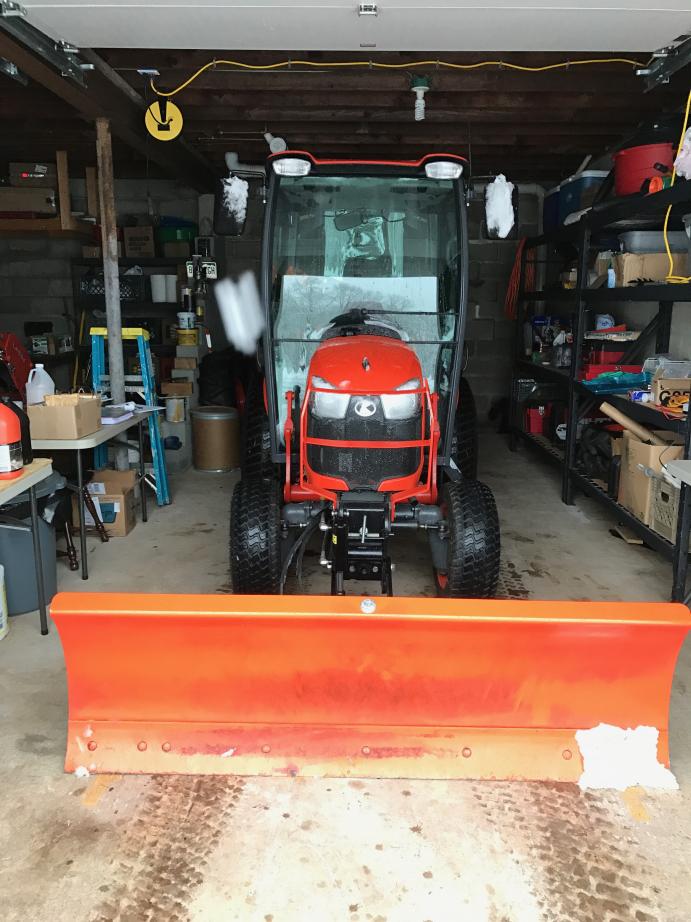

Here's a front shot. I don't have any sides shots atm. What do you think?
Still a nice setup to have. The best of both on the front quick attach. It's fun owning a tractor once all the kinks are worked out.
