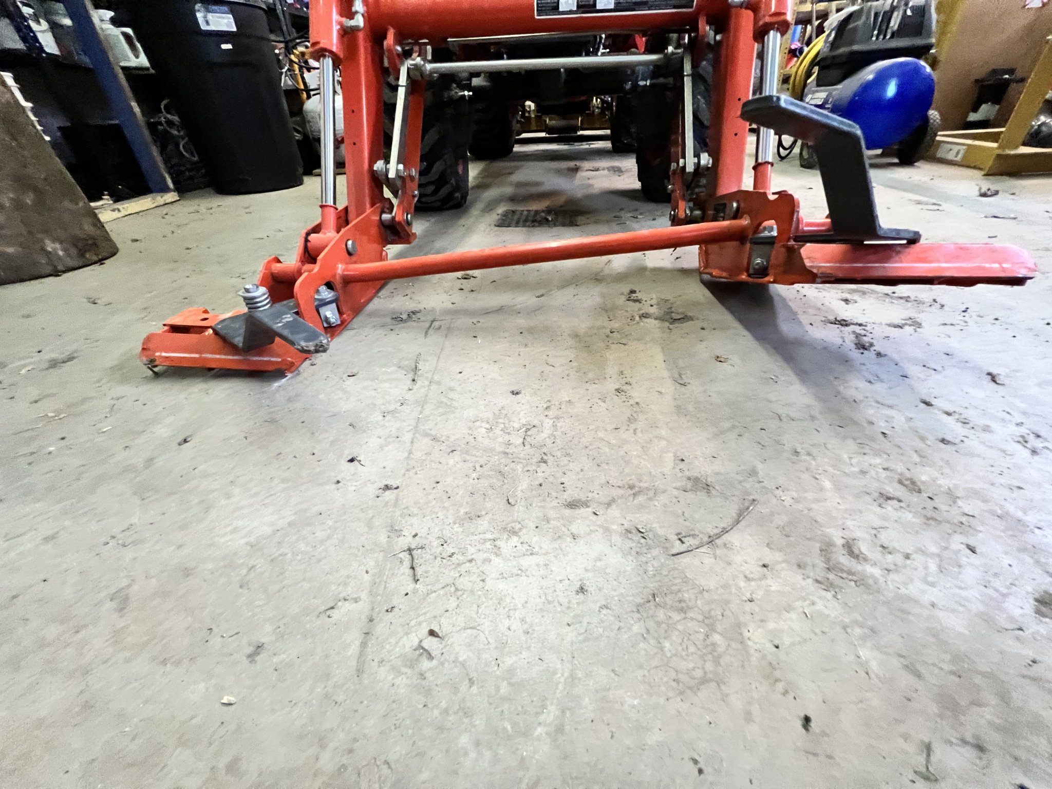

I have straightened at least 6 of these, a couple were even this twisted. Just block the right side and roll quick attach back. Bring it back slow, let the pressure off and measure the distance on each side. If you do go too far on the left, move the block from the right side to the left side and try again.
Thank you for sharing your experience. This worked perfectly. IMG_2208.jpeg IMG_2211.jpeg

If it was me, I would try putting a two by four in that shortest ram to stop it from returning and see if the hydraulics can pull the other back in line. If it does then you can reassess whatever welding or gussets etc you may add to strengthen it. You are correct in assuming the latch released I believe. It is designed to work as a unit with the bucket in place.

@highcountrybarry -- This was brilliant. Was using my SA20 auger the other day when, unbeknownst to me, one of the hoses (which are very long to allow the auger to go deep) caught and flipped up one of the QA latches. By the time I realized, the left plate was completely disengaged and the connecting bar bent. Went back to the barn, stuck a 4x4 exactly where it appears in the photos above, and curled the loader function. Couldn't believe how well it worked! A few quick bursts, and the plates are now (almost perfectly) flat against the floor. Saved me mucho $$$ on a new QA assembly (and the down time waiting to receive it). SUPER HELPFUL -- THANK YOU!!

Pushed on one part and then on the second when I noticed the bucket was not level. Apparently when I pushed the first tree near our box stand into the woods one of the locking handles released and then when I pushed on the smaller tree that was in the plot it tweaked the quick attach,
See pics attached, one is of the big tree that we cut and pushed into the woods no problem and the other of my bent quick attach for the bucket.
Thoughts on what to do, try and repair or replace? I don't have the means to try and bend back in place but plenty of welding shops around I could carry it to.

I bent mine at least as bad as the OP's pics. I used a block of wood to keep it at 90 degrees so the hydraulic cylinder has the most leverage. It wouldn't pull it back. I then used the hydraulics and pushed up against a tree and fixed it in about 5 minutes. Simple easy fix and other then the paint being cracked you can't tell it ever happened. I'll make sure both sides are latched from now on!
