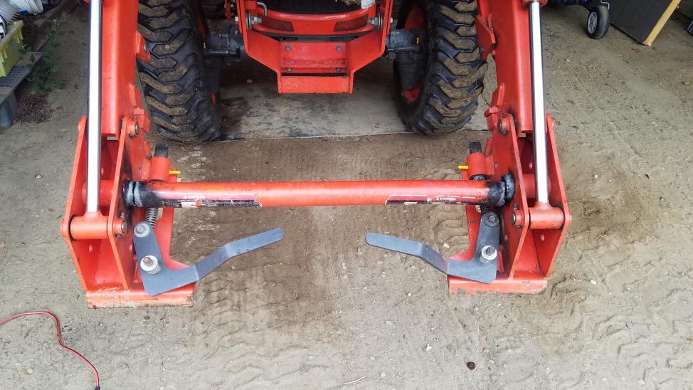

I would cut the tube off flush with the mounting plates on each end. Then attach the bucket to get the plates lined up properly and then weld a new piece of tube in place.
This is plan B, if it will not bend back close to perfect will do exactly this.

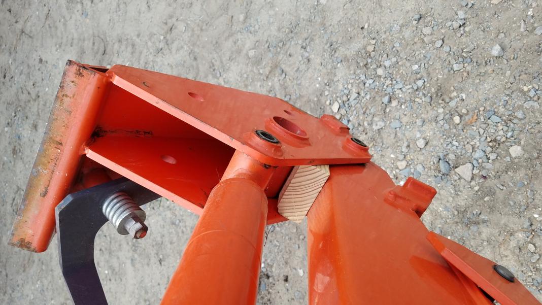

I've had to fix a bunch of them, 2 different ways. One, run it into a tree and use the hydraulics to re-bend it back to correct position. The other method is to block one side; as mentioned.
Cutting/re-welding is the hardest possible way. Tried it on my own tractor; waste of time. Bending it back is the easiest way by far.

Thanks for the many responses and ideas on how to resolve/repair my bent quick attach.
I plan to try and block one side and use the hydraulics to bend the tube back to it's intended position which should realign quick attach.
Question, for those who have performed this on your tractor or someone else's how does it hold up over time? I plan to lock the handles in place after I fix her to prevent premature unlocking.
Some say cut out and replace the twisted tube. I can go this route for under $100.00.
If it were you and could have it repaired for under $100.00 would you go the vs. bending back or if it bends just move on and address later if it reoccurs because it is weaker from the stress of bending it twice?
Just don't want to be revisiting this over and over.

If your going to block it make sure you do it safely. wood blocks, etc tend to break and send fragments everywhere when they break.
I think you have two good options i would try and bend it first. If that is a no go then take it off and have it repaired.

Back to the drawing board OTT, 2x4 wood blocks did not work, crashed them or split them.
So, do I use steel blocks or aluminum ones? This route something has to give!
Or, cut out tube and have new one welded in place?

I have plenty of rough cut oak planks I can cut some pieces from so I'll give that a try tonight after work.
Machine shop where I work so some aluminum blocks are easy to come by.
Any better ideas on where to place the oak block tonight? i felt that this was a strong place and on the tube that is bent where it attaches to the loader arms.
35,788
10,843
The place you picked should be fine, but block it out farther so there will be plenty of ram movement on the other side ram. ;)

Failed attempts last night..........
I replaced the pine blocks with oak blocks to no avail, had plenty of room to work with but the tractor would not bend the left side up.
Took out blocks and used big chain to a tree to hold in place the unbent side. Placed blocks in front of tires so tractor would not move. Increased rpm's and still the hydraulics would not bend her back.
tomorrow will remove quick attach and carry to a friend and have him either cut in half and weld back or replace tube.
Thanks for all the ideas but I guess she is just bent to bad for Katie to self correct using the hydraulics.

Update to bent quick attach.
Finally was able to carry tractor over to the welding shop my friend has last night, work has been getting in the way......
We cut left side nearly threw to relieve stress all attempts to realign for welding failed. We used all means, in Wes's opinion it was just twisted and bent to badly to ever be right.
Moving on, we agreed that replacement would fix it the right way so we cut out the tube and I began grinding off the welds and removing the tube that goes through the loader arm.
Wes is picking up a piece of tube today and hopefully Thursday we can slide new tube into place and weld.
