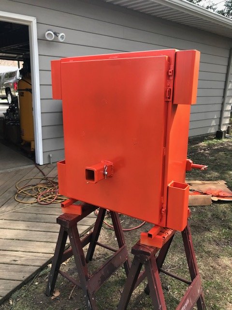

Made mine last year from a slightly used 10x24x30 electrical panel, TSC draw bar, some angle iron, and a 2" receiver. The draw bar is bolted thru the back of the panel with long bolts so the heads would be well burried in the concrete. Calculates out to about 550 lbs and works great. Zero issues with the rear end getting light on my LX2610.

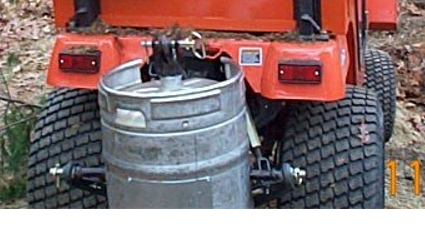

I should run a hose from mine into the cab. Get people wondering if I'm sober. A beer keg with 600# of lead

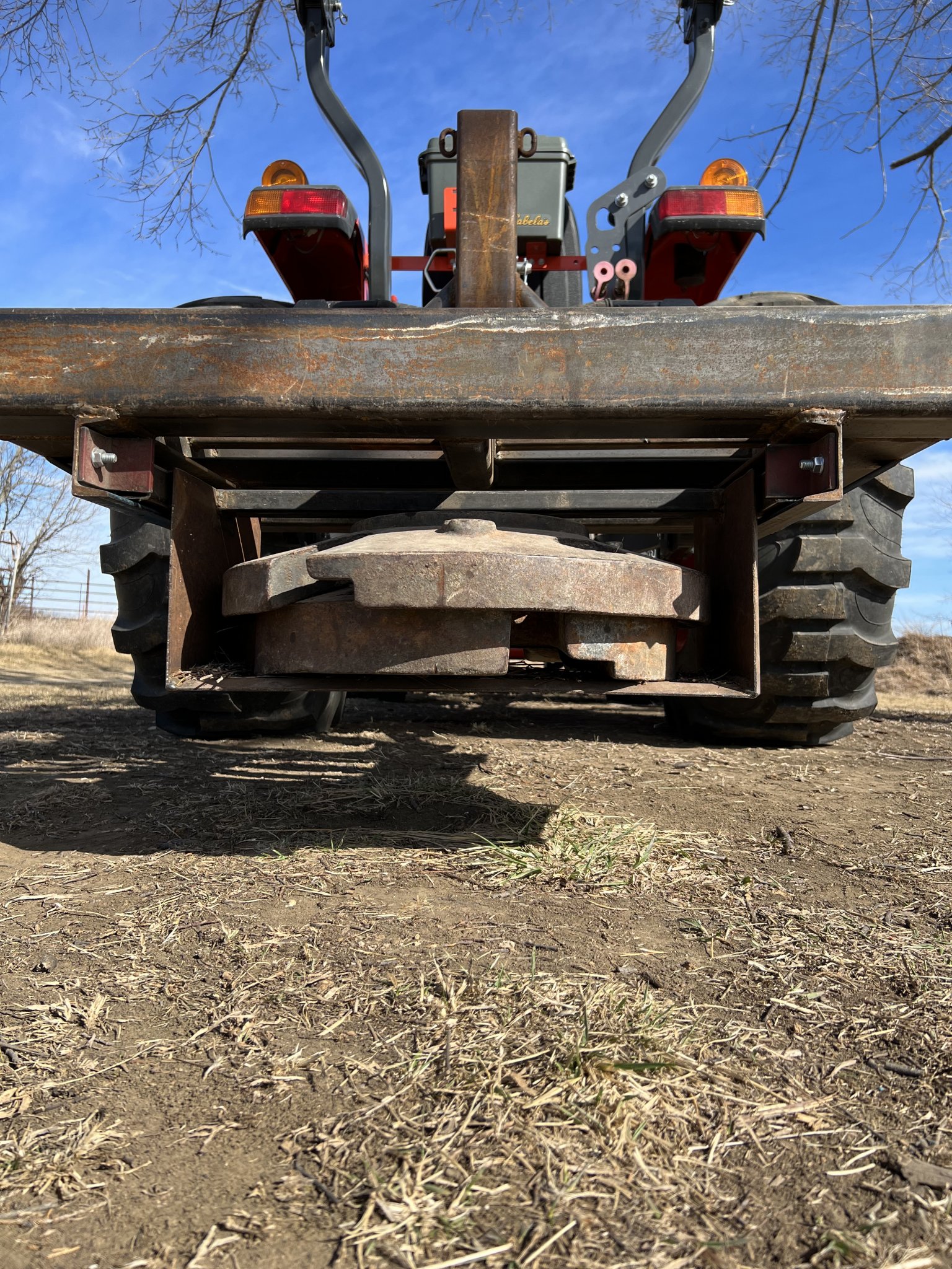

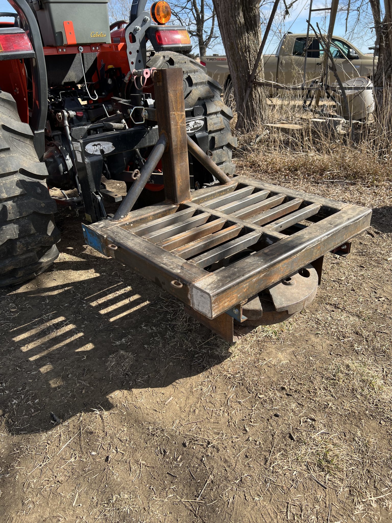

I needed some ballast for a grapple. I also wanted a carry-all/work platform, so I combined the 2. The 4x4 box steel is filled with concrete. I had a couple mis-matched wheel weights that I made a cradle for to carry under the plat form. I can removed the wheel weights fairly easy by removing 2 bolts, setting on the ground, & driving away. I have about 650lbs or 350lbs or nothing as needed.
I’ll paint it when I’m done adding to it.
