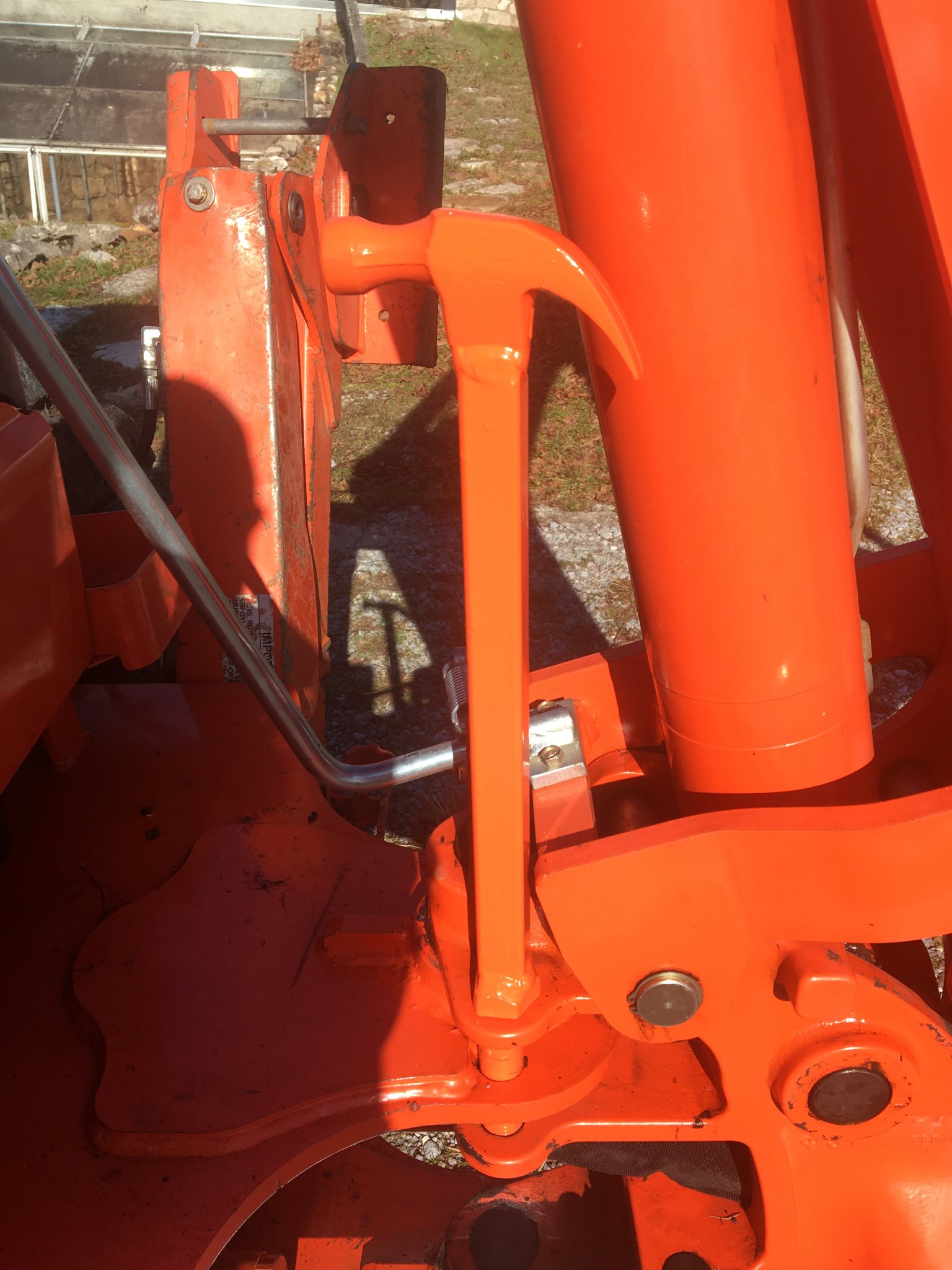

Bought the M59 backhoe separately, used, missing swing lock pin. Made one from scrap pile parts. Handle length sufficiently long enough to easily reach from operator station.
Handy when tapping the mounting pins in or out.

Bought the M59 backhoe separately, used, missing swing lock pin. Made one from scrap pile parts. Handle length sufficiently long enough to easily reach from operator station. View attachment 139594
Great idea !
A hammer is always useful!
Come on man, a claw hammer, the least you could have done was a Mini Sledge or a Ball Pein hammer head.
HAHAHA, Excellent Idea!
