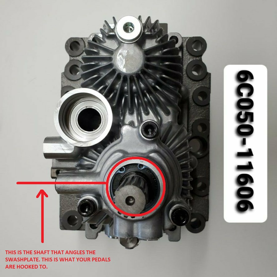

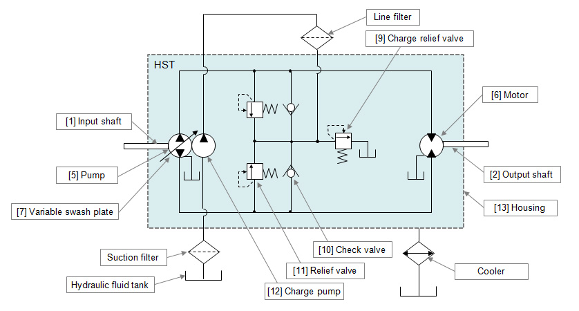

Here's a hydraulic circuit diagram of an HST if anyone is interested.

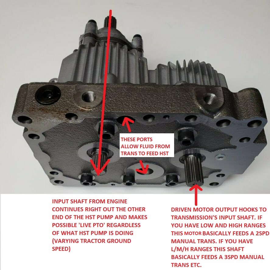

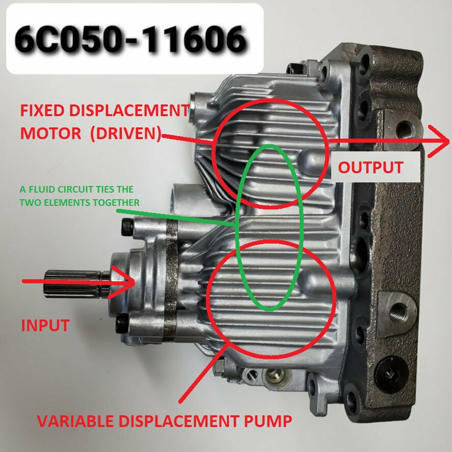

Here are some pictures of a Kubota HST that i labeled for another thread.
Although between then and now I have realized the part about those ports allowing fluid from trans sump into HST is wrong, so ignore that..:rolleyes:
Here is the thread those came from on TBN where i talked a lot more about HSTs:
HST discussion
HST discussion
This is why I suggested in my previous post the hst needs tested. There is a procedure but I don't know it with this model of tractor. I do like the case drain being overwhelmed idea. At any rate it's time for a functional test of the hst and possibly a tear down. Oh there's a suction screen and a bypass filter for the hydro, so no it won't/shouldn't blow the filter out being a bypass style of filter.
HST discussion
Just a fun question, as I don’t have a clue. BUT what would happen if the suction filter and line filter were reversed?
The OP is obviously a competent mechanic. Not arguing that. But if the filters were reversed, would we expect the tractor to operate normally?

The HST is essentially a closed loop. It does leak a bit (deliberately -- the leaks lubricate the moving components within the case) so the charge pump is there to keep things topped up, as it where. But otherwise, the high-pressure variable displacement pump and the hydraulic motor form a loop.
The spin-on filter is between the charge pump and the charge pump relief valve. It doesn't see high pressure, just charge pressure. It cannot restrict the flow to or from the high pressure VD pump. It just ensures that the make-up fluid reaching the HST loop is filtered.
The seepage past the pistons fills the case with lubricant, but the case relief valve ensures minimal pressure build-up. If the case relief valve failed to open, I believe the shaft seals would blow out long before pressure could rise high enough to bog the engine down.
That said, it might be worthwhile hooking a pressure gauge up to the various test points and confirm the pressures are as indicated in the factory service manual.
