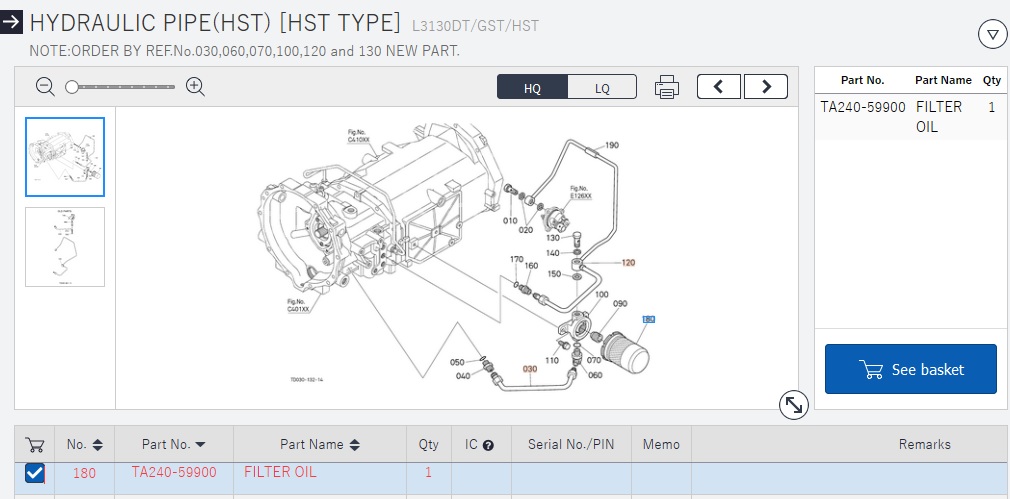

The filter that protects the HST is part 180 on this diagram (under left floorboard). Has that one been inspected?

Both filters changed sitting on tractor right filter (with magnet) has bron
sitting on tractor right side filter (with magnet) has the bronze in it/ left side clean / IMG 2602 right side 2603 left

Both filters changed sitting on tractor right filter (with magnet) has bronze in it/ left side clean / IMG 2602 right side 2603 left
To Ferguson: The LEFT side filter (your pic 2603) is the crucial one for the HST - if its clean that is GOOD NEWS.
