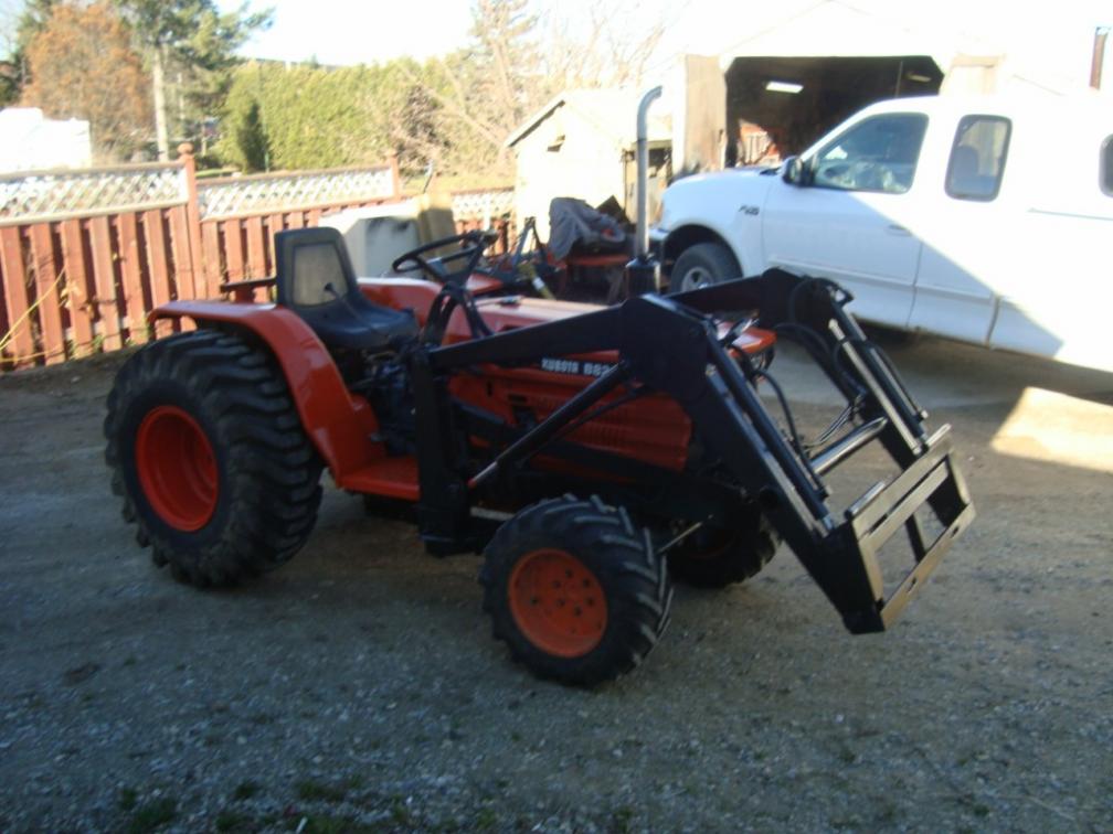

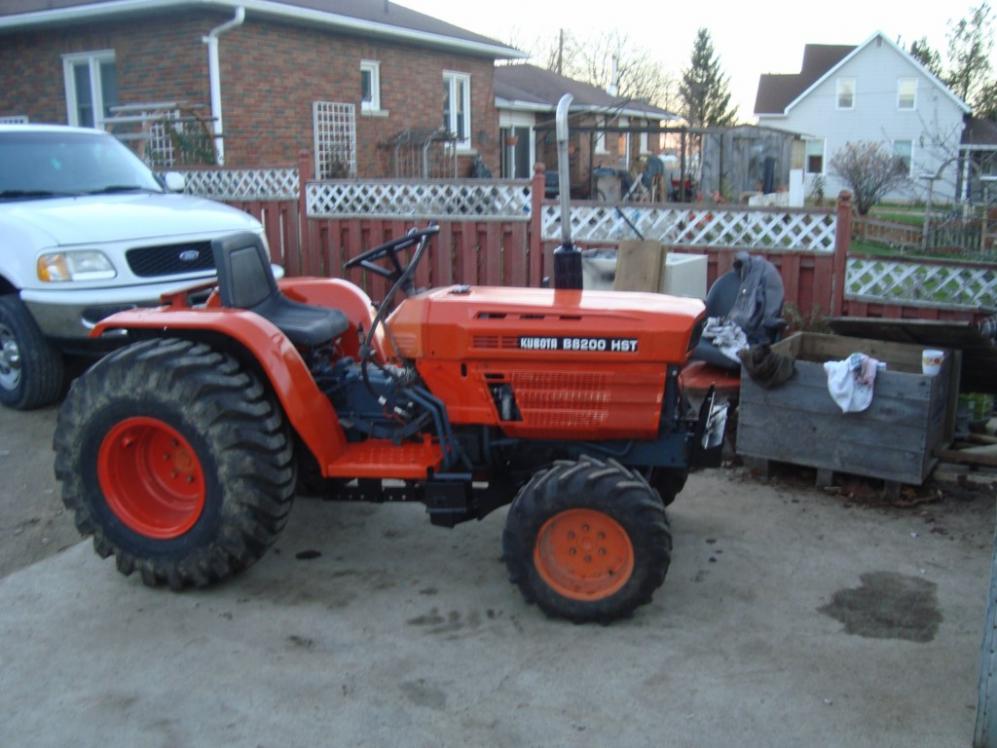

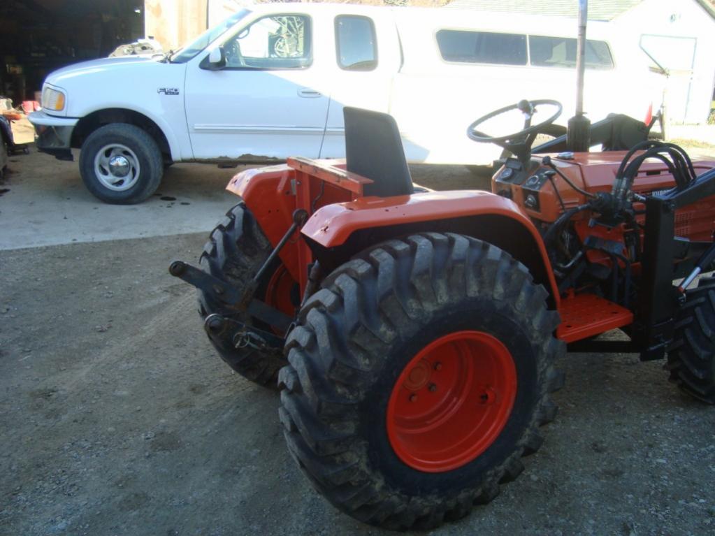

Well I replaced the oil sending unit ( Thanx to Ideal Supply ). No more leaky leaky. The leak on the exhaust manifold may be over fueling. I think I have new exhaust gaskets. I put the rear fenders and steps and such on the tractor, and at least they look like fenders and steps and such. I will take some pics tomorrow.:D Dusty

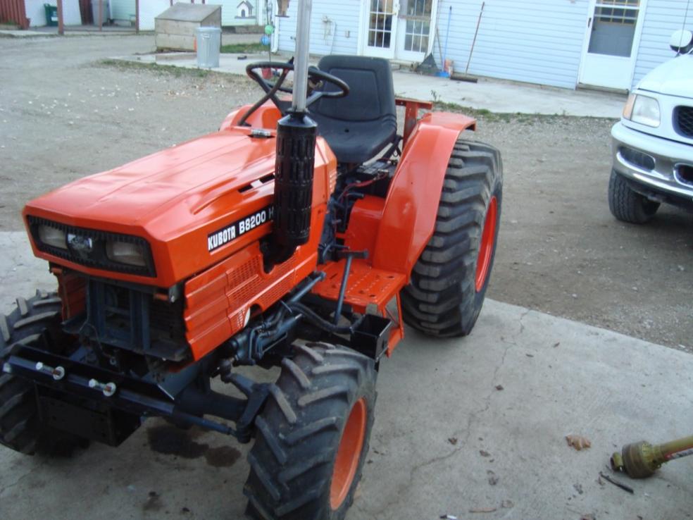

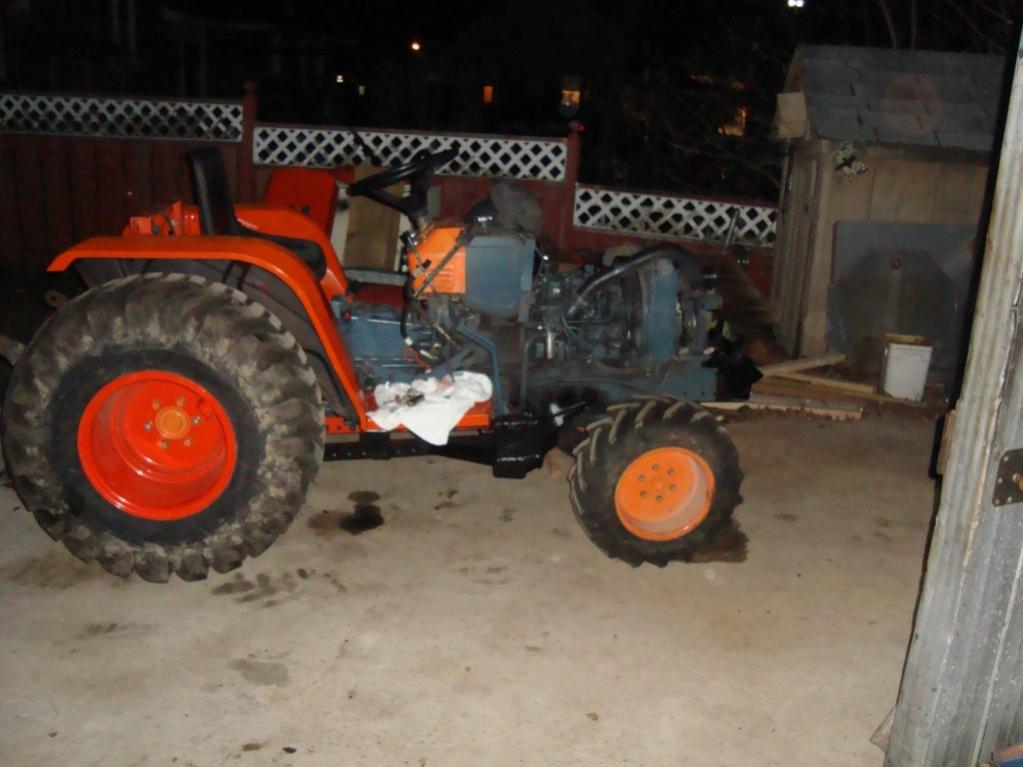

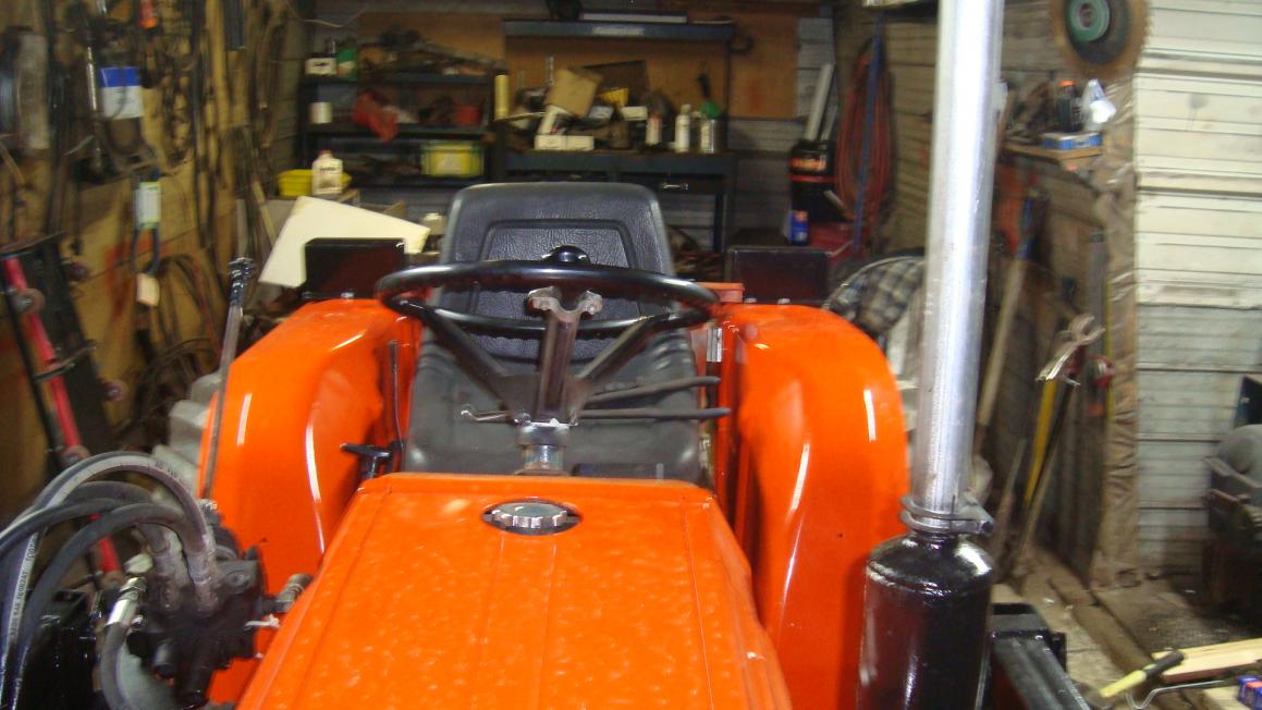

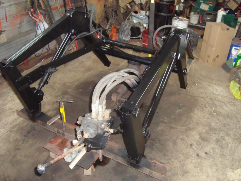

Well I took the exhaust off and installed new exhaust gaskets. My son came over and we checked the valve clearance. One was a little tight, the rest of them were right on the money. I was surprised at how much junk was built up in the exhaust manifold and head. My son (Ben) suggested valve seals. I can't believe that the rings are bad. This tractor starts at -25 with no block heater. Any way no more leaks cept one. I screwed up. When I pulled the screen on the hydro I left it open overnight. The next morning I went in and the banjo fitting had sagged about an inch. I just pushed it back into place and zipped her up. I should have cleaned behind the banjo fitting again. It is not leaking much but it is leaking. So as soon as I get the loader painted I will drain the hydro , pull the screen and clean things up properly. A couple of pics.:D Dusty

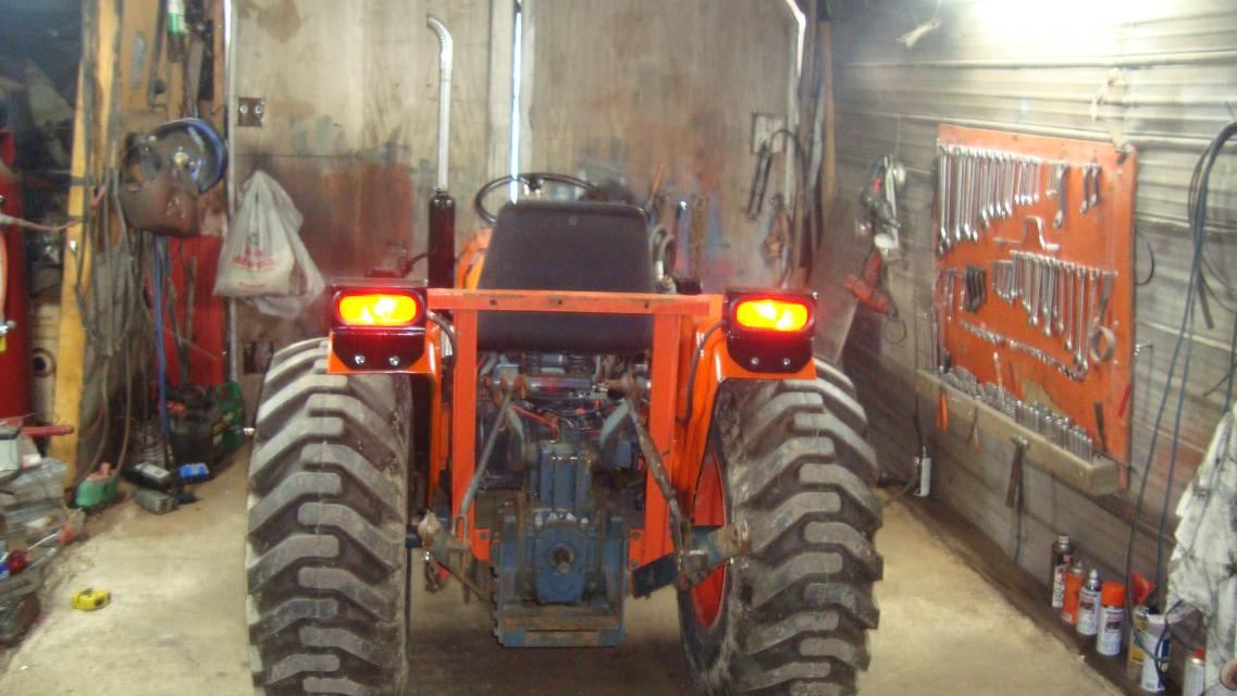

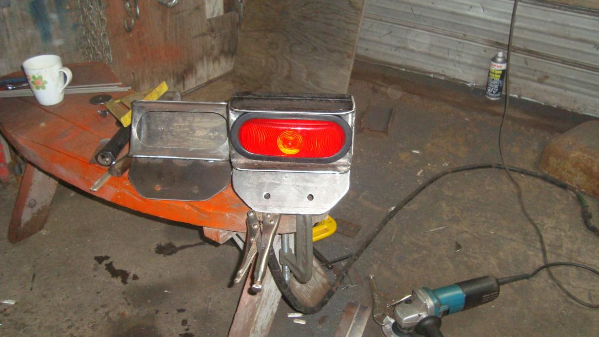

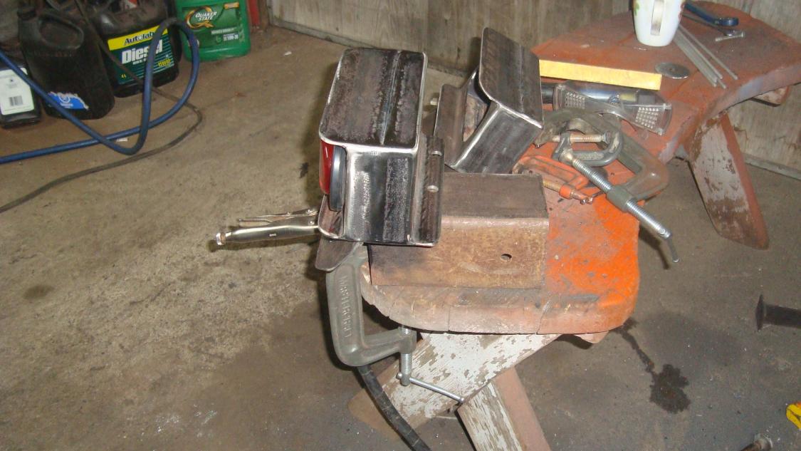

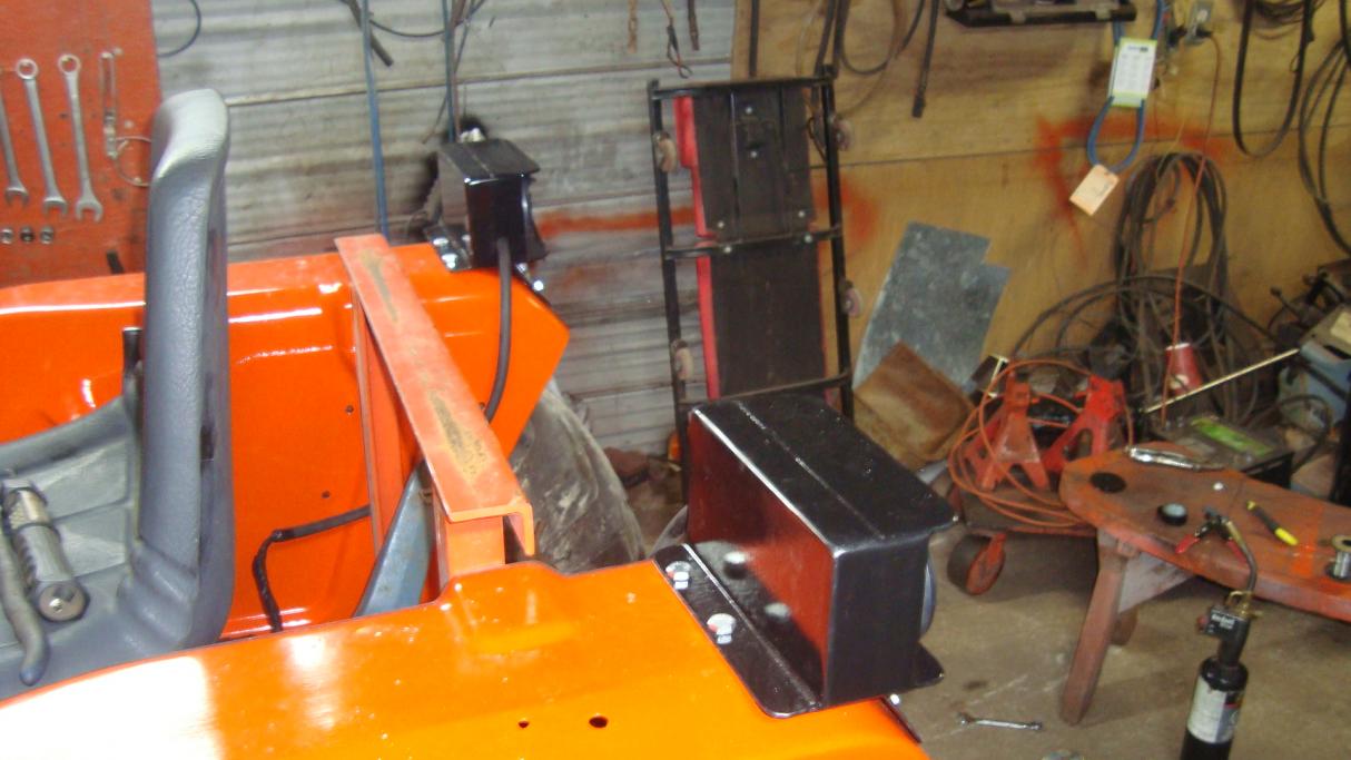

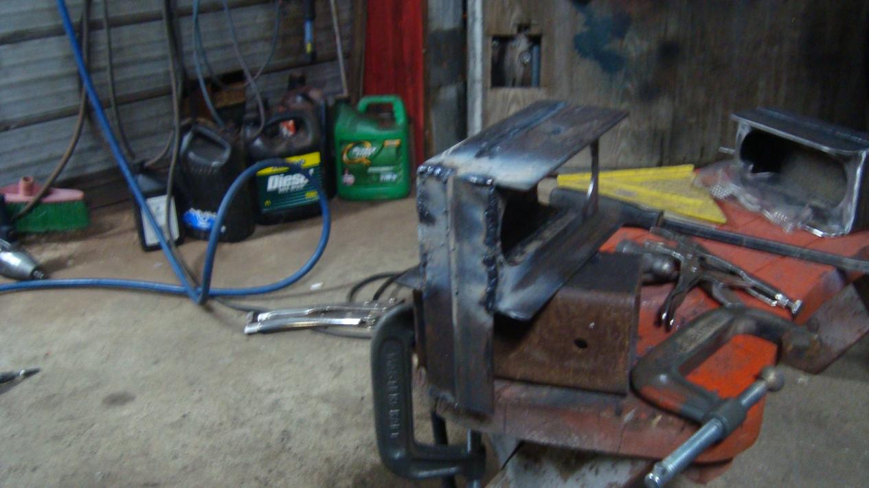

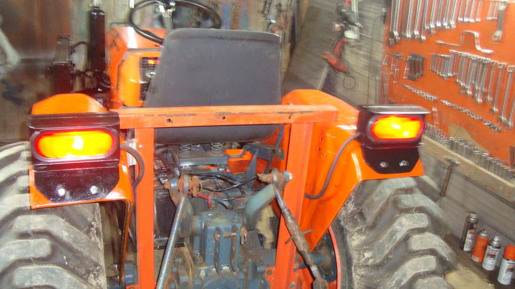

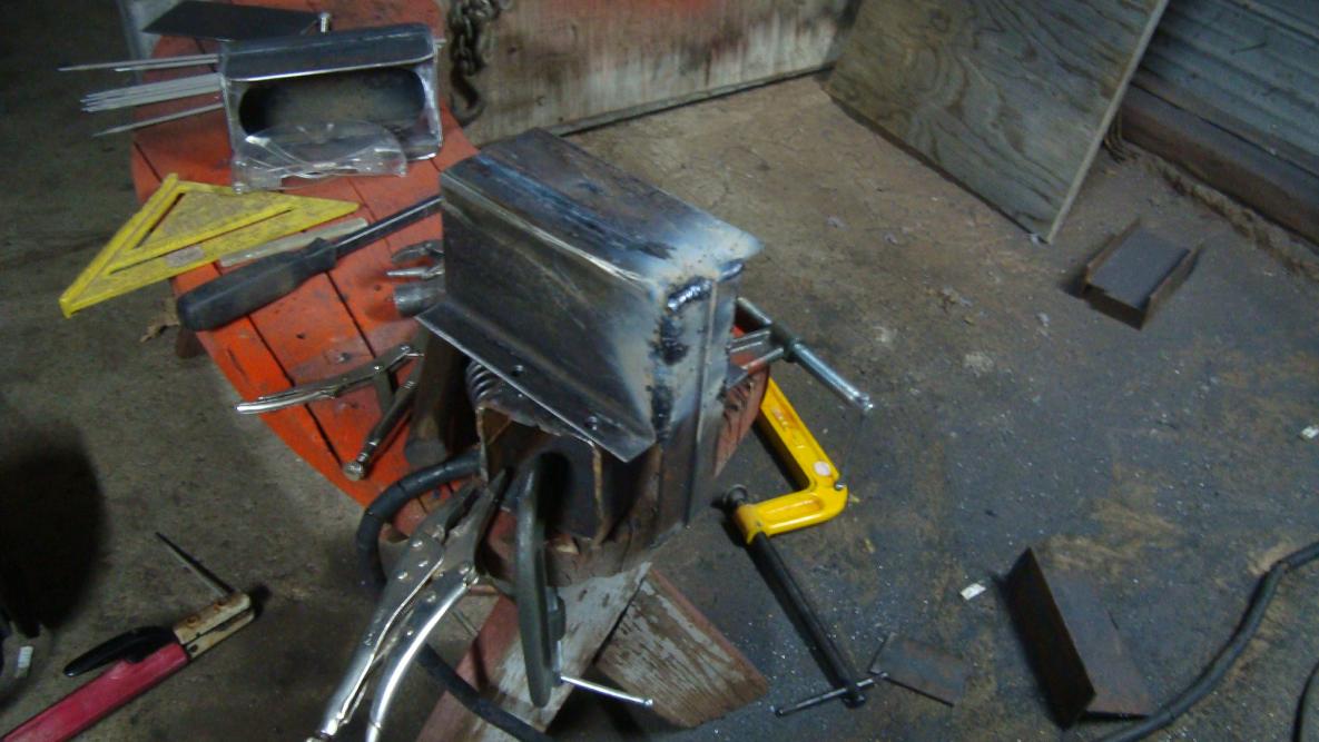

Wow long day. Just came in the house 10 min ago. Tail lights are done jus need to be painted. Oh except for a hole to run wires in. Two days on these things. But I am happy with them. Wildfire thanks for the compliment. But I would be really :eek::eek: to do work for you. I would do it in a heartbeat but ya I would feel pretty foolish. SOME PICS:D Dusty. Bedtime

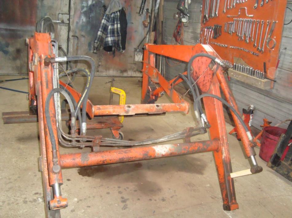

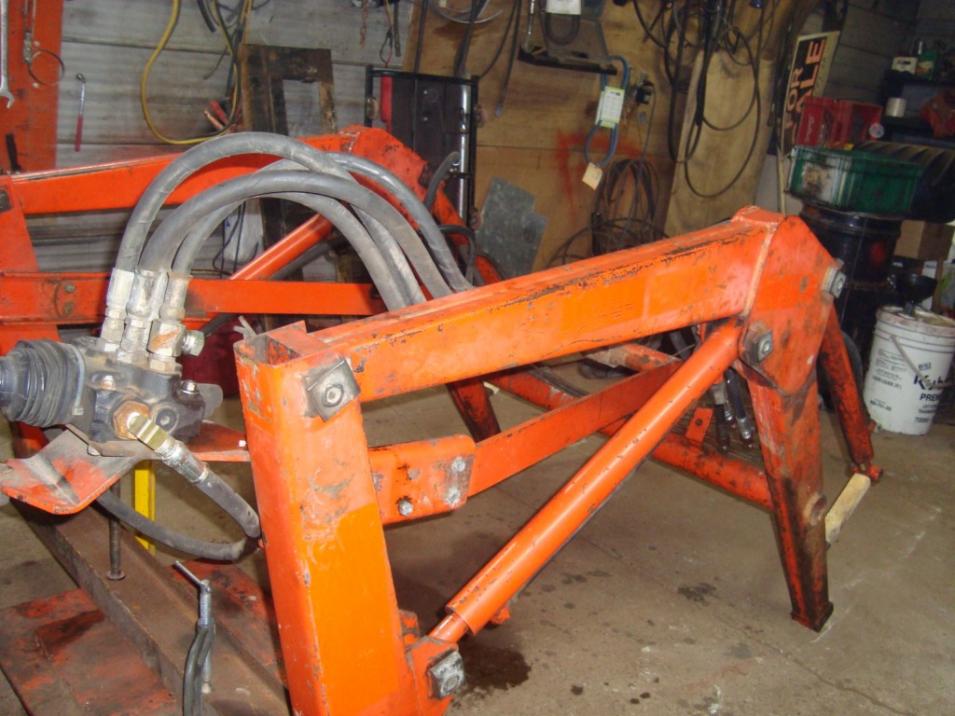

Dusty, Good luck with your repairs, especially the loader lift cylinder rebuilds. The rebuilds are fairly easy as I just did one but you may want to watch the price of the rebuild kits. Kubota wanted $180 each for mine on a B7200 and a B1640 loader. That's big bucks if your doing all four cylinders. After market kits a very rare, at least in my neck of the woods. If you know where I can find some I'd be greatfull. Nice photos
