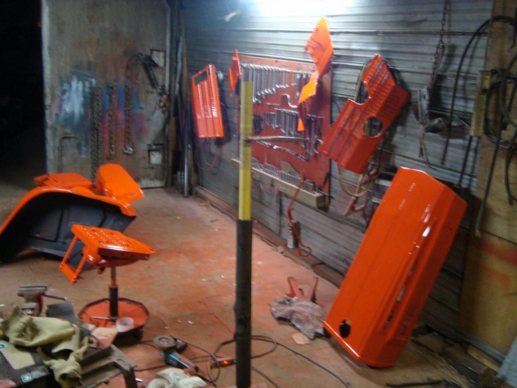

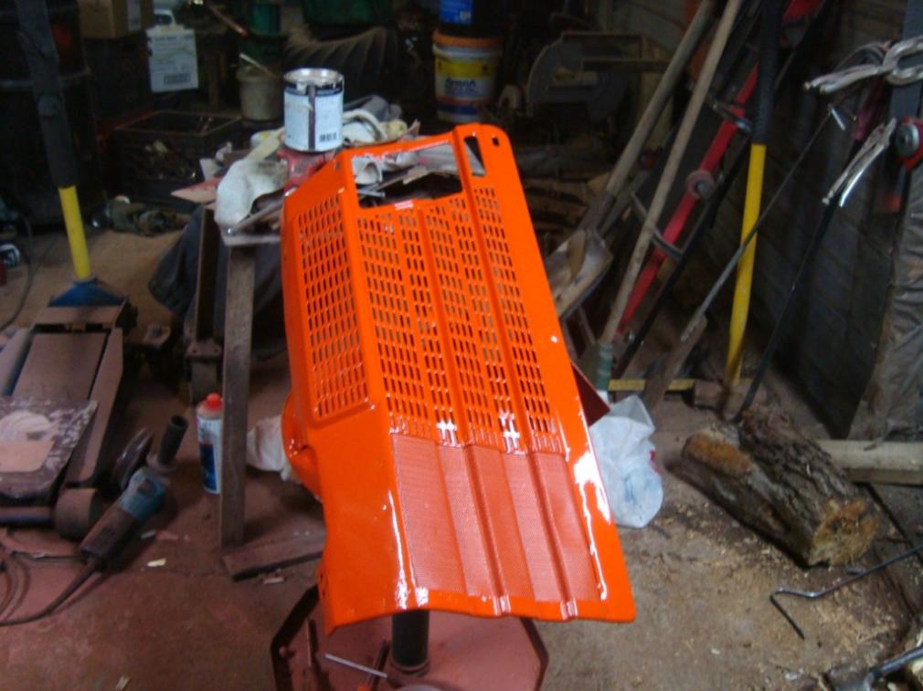

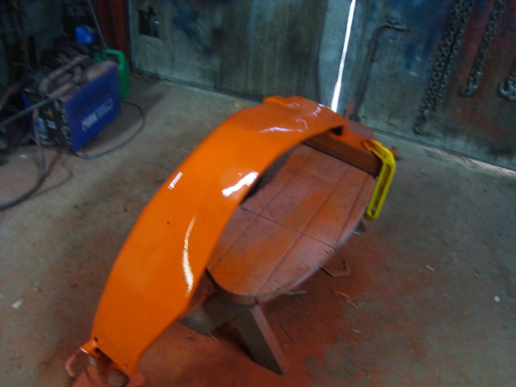

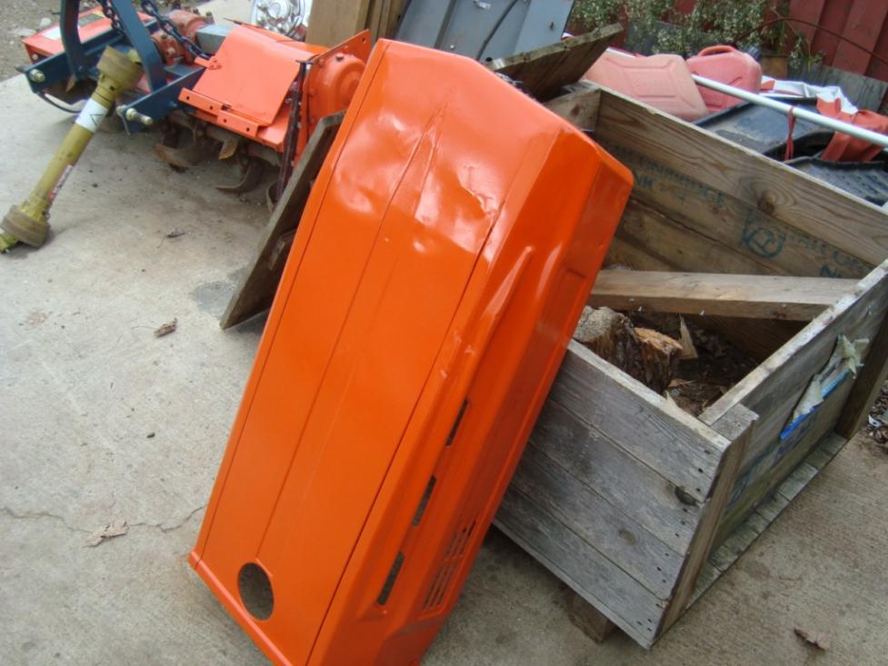

Well Vic this is another of my projects that you can show as HOW NOT TO DO THIS. Got a nice shine on most of the parts but not all. I got 6 cans of the plasticoat T-31 and followed directions. I didnt get a very good shine on the hood. So for the rest I did it the way I would with any other paint. Got a good shine. So the shine is good the body work and all the dust isn't. Some pics--:D Dusty

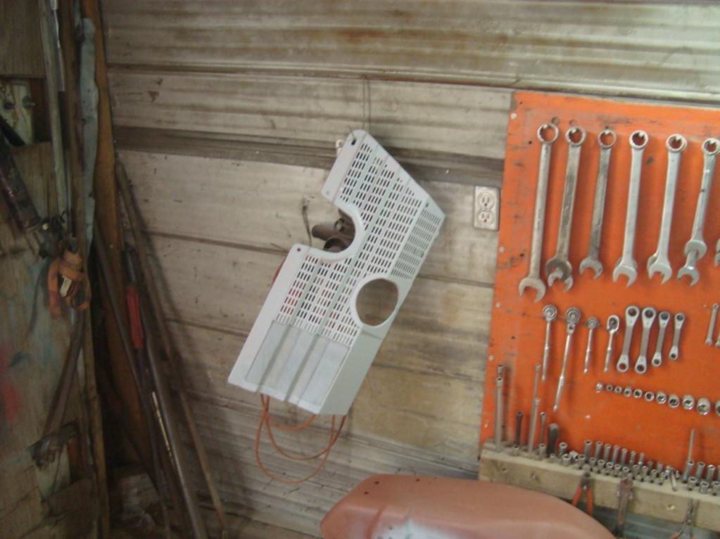

I think it looks good Dusty. Don't forget what it looked like to begin with. Is that mesh stock on the side engine cover? Are you keeping the inner fenders black? If so that would make it easy to touch up any chips you may get. Two years ago I painted my hood with the paint from the dealer. I don't know where I went wrong but it was totally flat. Of all the pieces! I hated it. Spent $50 on stickers that I ripped off a month ago to repaint it. Thats why I spent so much time on it this time to get it to where I would be happy.

Ya I remember what it looked like Ds. I guess I spent so many years around body shops and I know what it could look like. I should just be glad that it is getting some straightening out and some paint. Yes that that mesh is stock. My b7200 had it too. I am leaving the inner fenders black partially to save orange paint plus it hides some serious nasty welding pretty good. I have tried to use Kubota spray cans and have no luck with them. I got a litre of the blue for my B7200 and just brushed it on parts of the frame and axles . It worked really well. As a rule I don't use a spray gun, just too much hassle when I am not painting very often or very much. Thanks Ds.:D Dusty

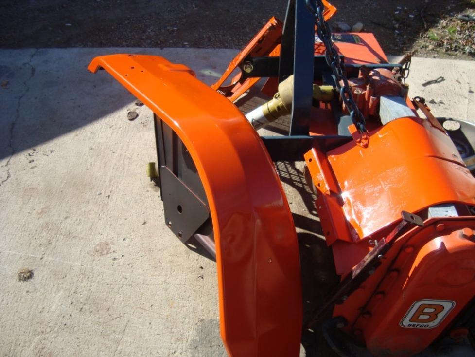

The tin work is done and painted except for the dash and making the grill. They will get done if I get time. The Kubota will look great from 50 ft. I will clean up a bit, then start on the mechanical. Rule of thumb, mechanical first body second. So much for that rule.:eek: Is there anything tricky with replacing the bearings and seal in the mid pto. My wsm doesn't seem to show anything. I am going to drain the trani and let it sit and drain while I pull the valve cover and check valve clearance. .008? There is also some oil leaking from the decompressor seal. There is a big bolt under the bell housing. I will remove this and see if any oil comes out, which I think would indicate a rear main leak. Last pics of the body. I took my little step that was hanging over the tractor step and put it underneath so I can put the cab on without taking the step off:D Dusty

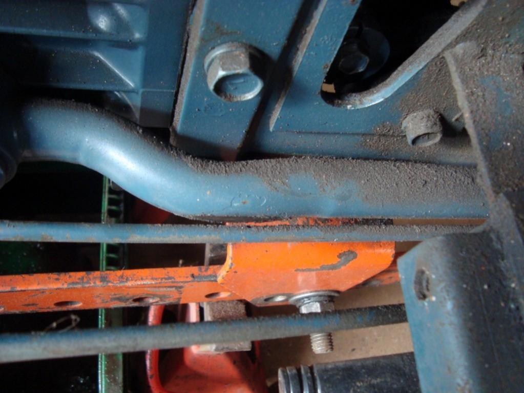

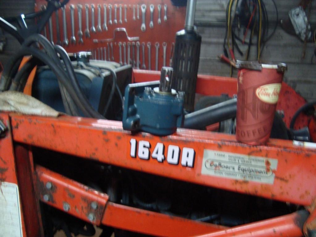

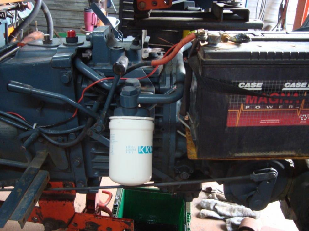

Cleaned up a little bit. Tractor is in, hydro fluid is drained.Somewhere around 17 litres. New hydro filter. Pulled the screen and found a wee bit on the screen. It had dextron in it. I am thinking of changing it to udt. Any thoughts on whether I should do this or not. The dif lock rod was rubbing on the steel hydraulic line. It actually wore a groove in the line. Not nice. And my stool broke. Nasty.:D Some pics. Dusty

Your frame seems to be in good shape from the pictures you just showed. Has it been previously painted? When the fenders and floor boards are off it's the best time to change the tranny fluid. Makes things a lot easier.

The frame looks pretty good and I don't think it has been painted. The tin work had been painted before. Pulled the mid pto off , bearings were good , seal was pooched. Still have to fix that little leak where the transmission was punched in.It looks like it was patched with bondo and the leak is very small. I think I am going to try to cover it with fibre glass resin. I don't want to remove the bondo because for the most part it is doing the job. And I doubt if I can do as good. Some pics.
