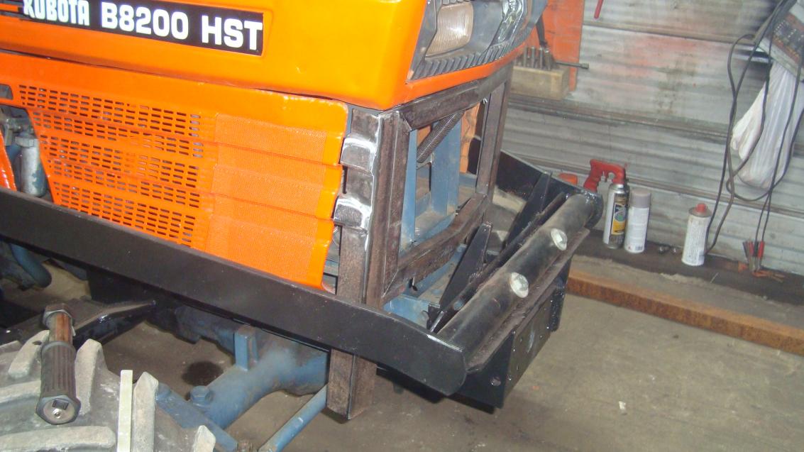

Thanks for all the comments guys. I am afraid my projects seem to drag out. Ds, My son and I were just discussing the lights today. I have to change the signal stat.The tractor has turn signals but no hazards. Also discussed putting turn signals on the front. Talked about brake lights then realized I only use them to park the tractor. Any way I did some work on the grill today. The tail lights were made from 2x4x1/8 I beam. The grill is being made with 2x2 square tubing. Yup I hear that bird goin cheap cheap too. Couple pics:D Dusty

Looks good Dusty. Is turn signals stock because my wiring diagram doesn't show them? Is that tremclad real orange I see in the back ground in the third picture?

Ya that is tremclad. I find the tremclad covers really well. Then I give a final2 coats with the plasticote. At least that is the plan. I tried it out on a scrap piece and it worked well. The turn signals are stock. Thanks Vic, I do try, but I feel bad for taking so long. Most people could have built a tractor from scrap metal in the time it takes me to do a project like this. I appreciate everyones patience and encouragment.:D Dusty

Thanks Dion, my grill will take a beating better. But I will have to add a couple more pounds of air to support the extra weight. Spudhauler that is a rechargeable trouble light.:D Dusty

Got the light from Napa. Ideal Supply in my part of the country.Some where around $40. The centre is removable 4 bolts. I may make one out of expanded metal for summer. The grill was not built to look original but does attach to the tractor with a single spring just like original. It is painted but did not turn out that well. No big deal to pull it off and redo. But it is not going to happen for a while. I still have fix my screw up with the hydro screen and banjo fitting. I should have done it as soon as I noticed it. But by that time I was into the body. Plus I have to install the cab, get the blower out and freshen it, and if time permits I want to box the front blade. Really running out of time. Thanks for the comments guys. Sorry no pics tonight. Pics tomorrow for sure.:D Dusty

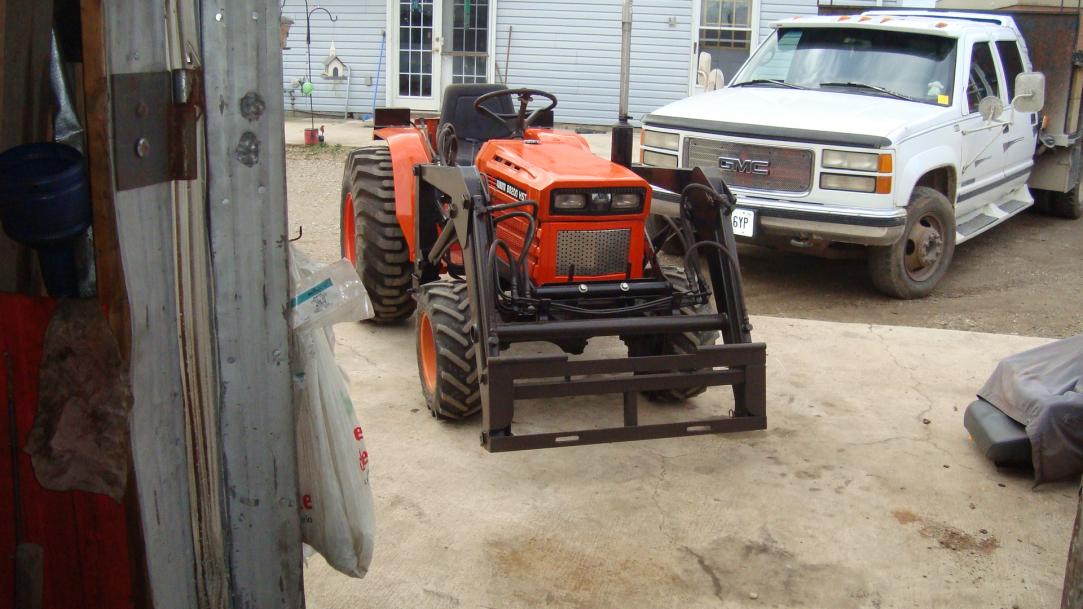

Thanks Guys. The tractor is done. I replaced the O rings on the banjo fitting and that fixed the leak. The oil that came out still did not look that great, so I put new fluid in again. I got the headlights working but have not tackled the turn signals. Found the problem though, the back of the switch fell off. It will be an easy fix but I am not sure how expensive it will be. Thanks for all the comments, advice and encouraging comments.:D Dusty

Thanks Paul. I guess it turned out OK. Pictures lie! But it looks alot better than it did, and it got some much needed repairs. But I plan on keeping the tractor ( God and the money tree willing ). So the other repairs I can do as time and money allow.:D Dusty
