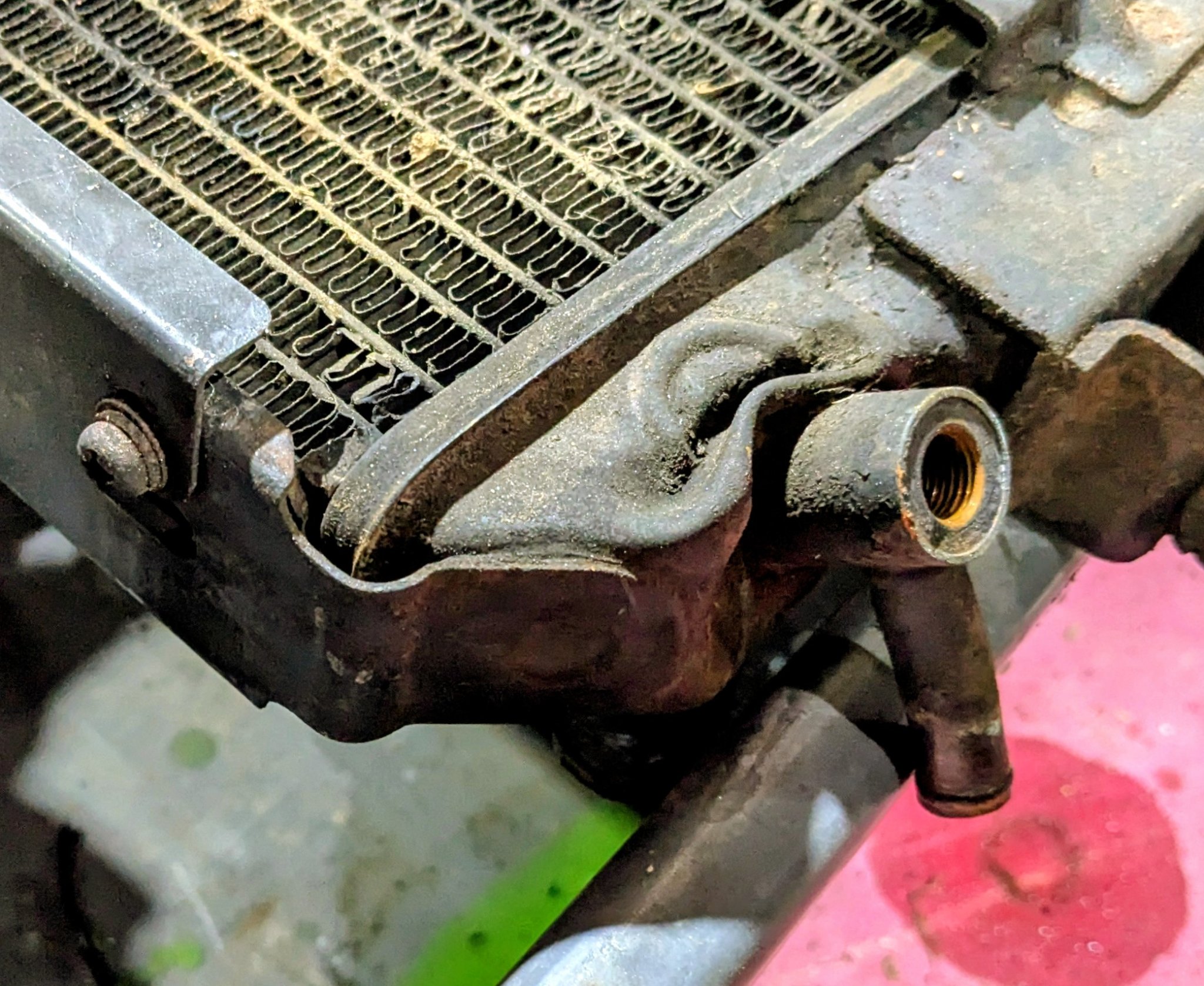

A new radiator arrived yesterday so I made a start on flushing and reassembly. A temperature sensor and gauge also arrived so I'll make an adaptor to fit it into the top radiator tube so I can monitor the temperature.
I flushed with tap water until the rusty water became clear.
The burp tube was almost completely blocked with rusty sludge. I initially couldn't get any flow through it with the hose but it cleaned out ok after I removed it. I have no way of knowing how long it's been like this or how many hours the previous owner ran it in this condition.
What could this do to the engine ?
Could it be the contribute to overheating and steam coming from the radiator overflow tube, or is that more likely a blocked radiator ?
I fitted a new thermostat to replace the old rusty one. The water pump looked like new so I re-fitted it. Hopefully tomorrow I'll get brackets transferred from the old radiator to the new and get the new one in.
What's everyone's thoughts about adding an overflow bottle ?

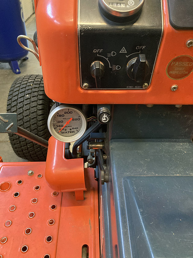

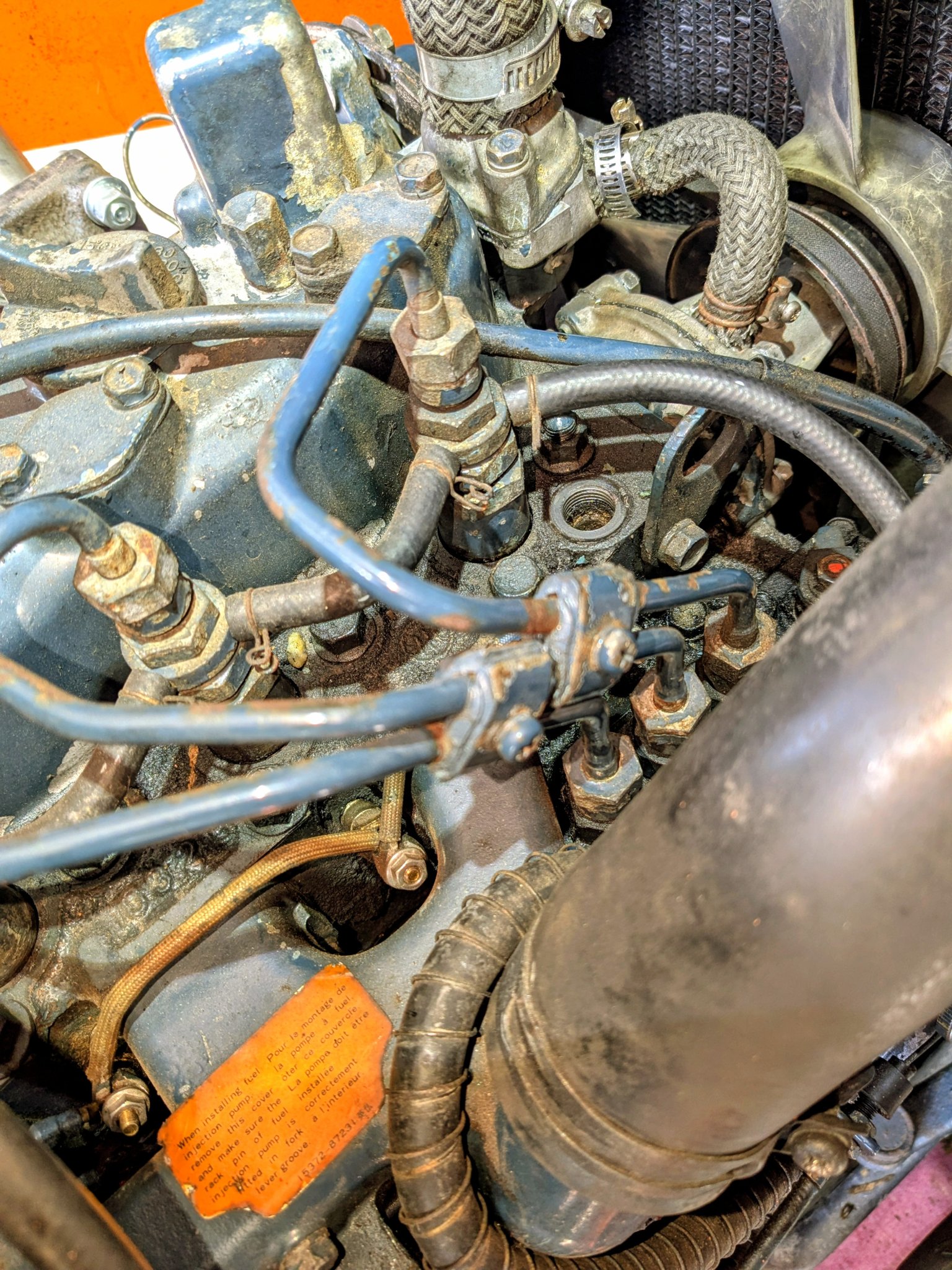

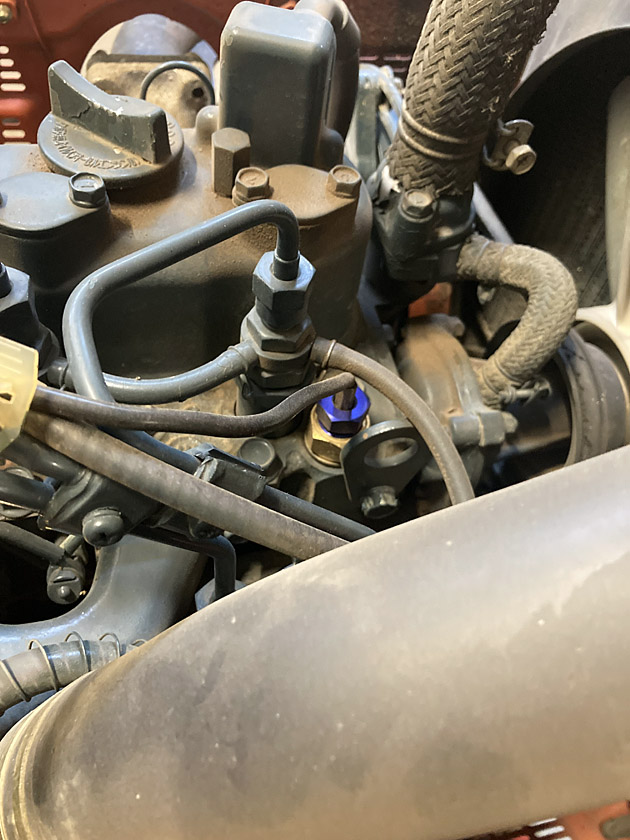

I'm curious to hear what your temp readings are, so please report those back. I installed the temp sensor in a port plug on top of the cylinder head. The gauge got mounted under the dash. It's not an ideal location due to poor visibility, plus I had to remove the cruse control lever. But I couldn't find a better spot where it isn't in the way of something.
I like where you've mounted the sensor - thanks for the info. Think I'll try to do mine the same way instead of making a fitting for the top radiator hose. I'll let you know how this goes and what temps I get one I can give it a good run.

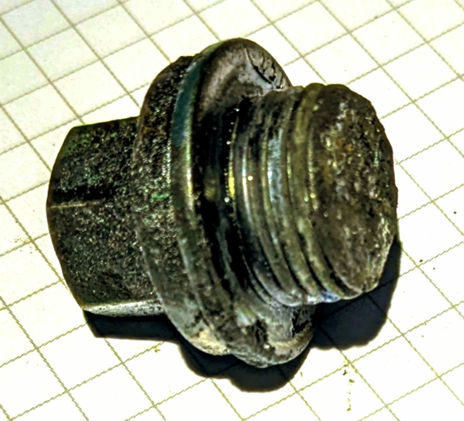

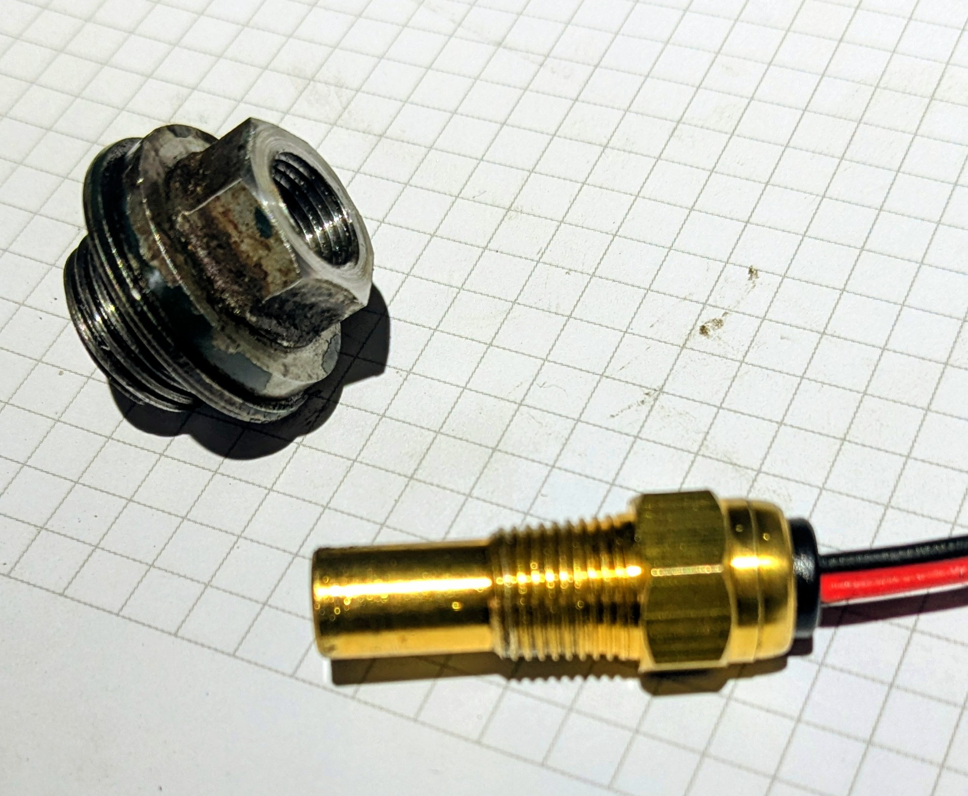

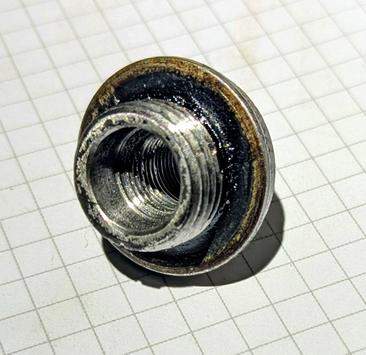

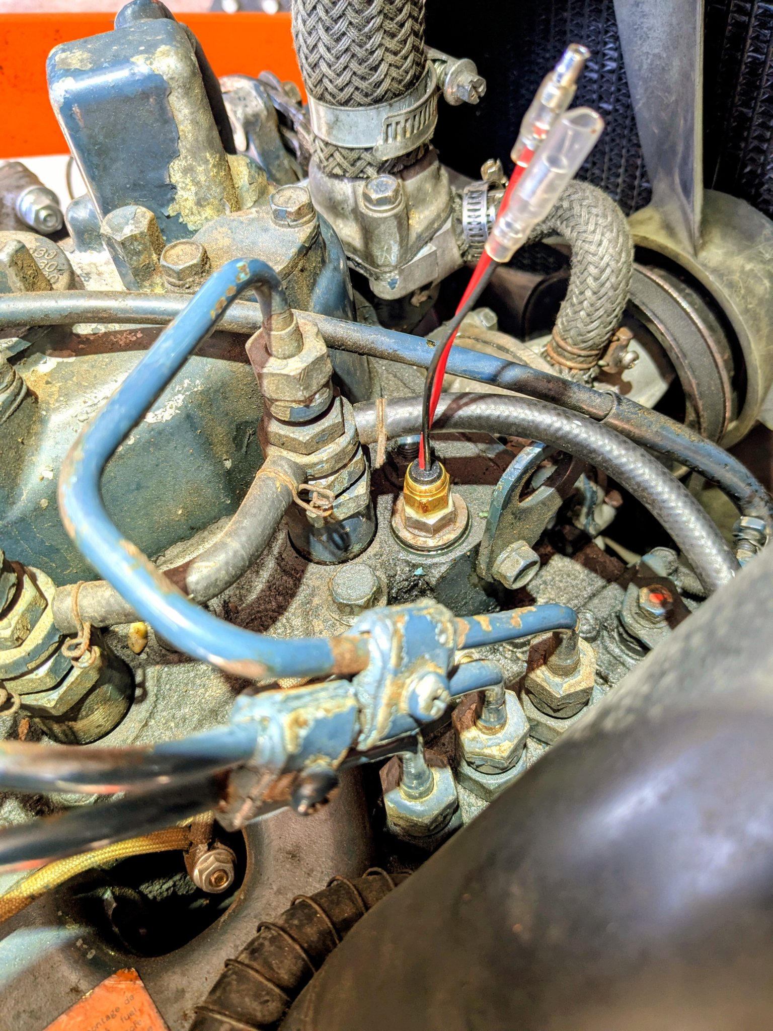

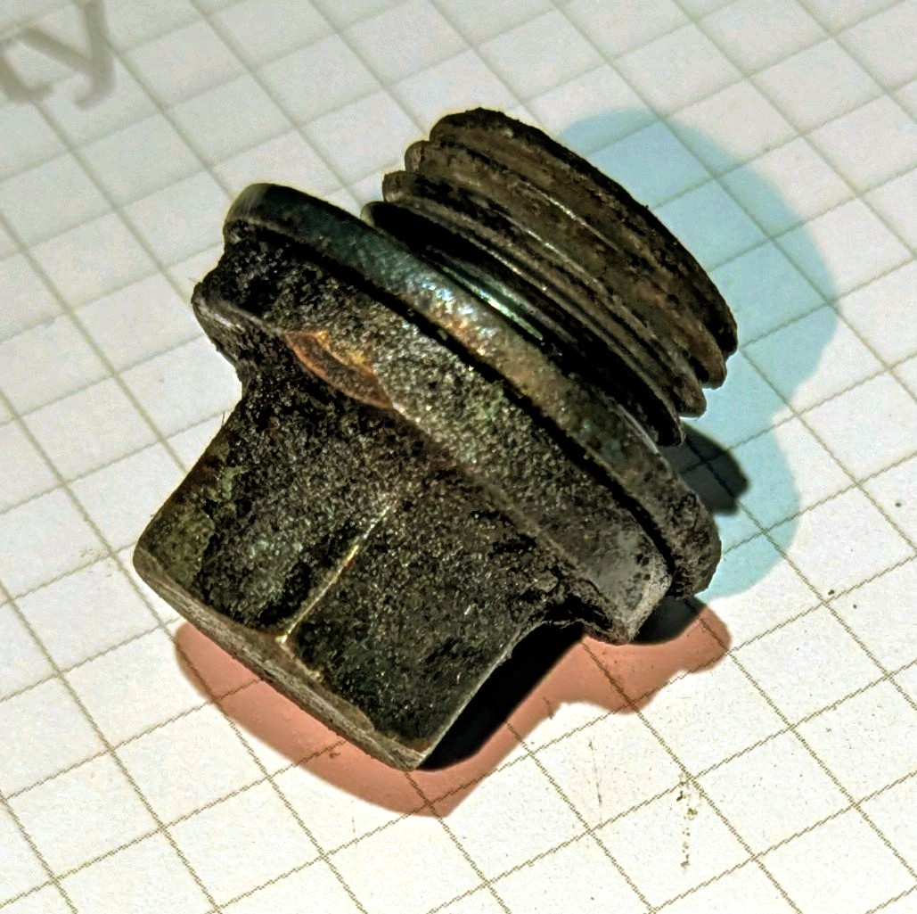

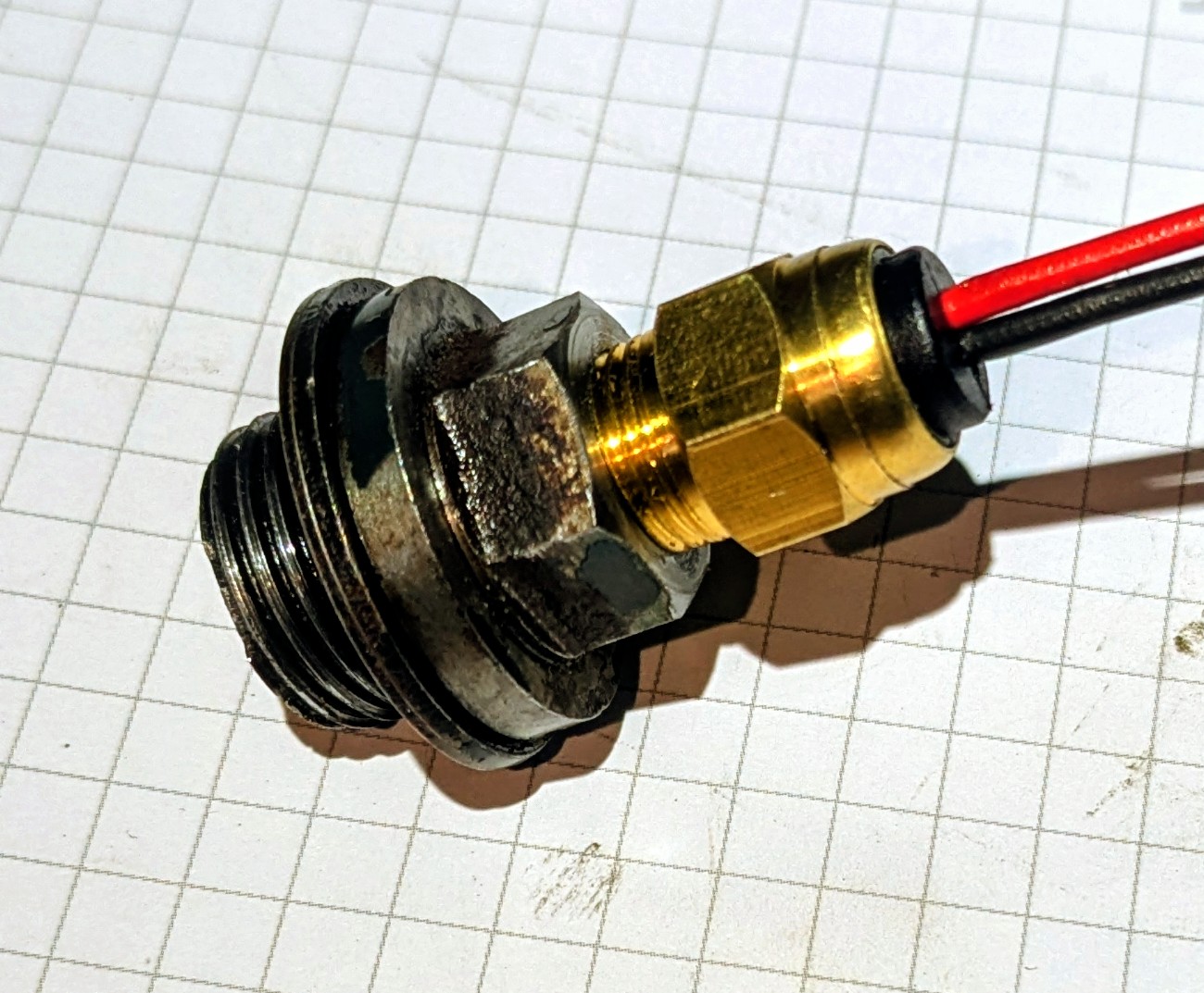

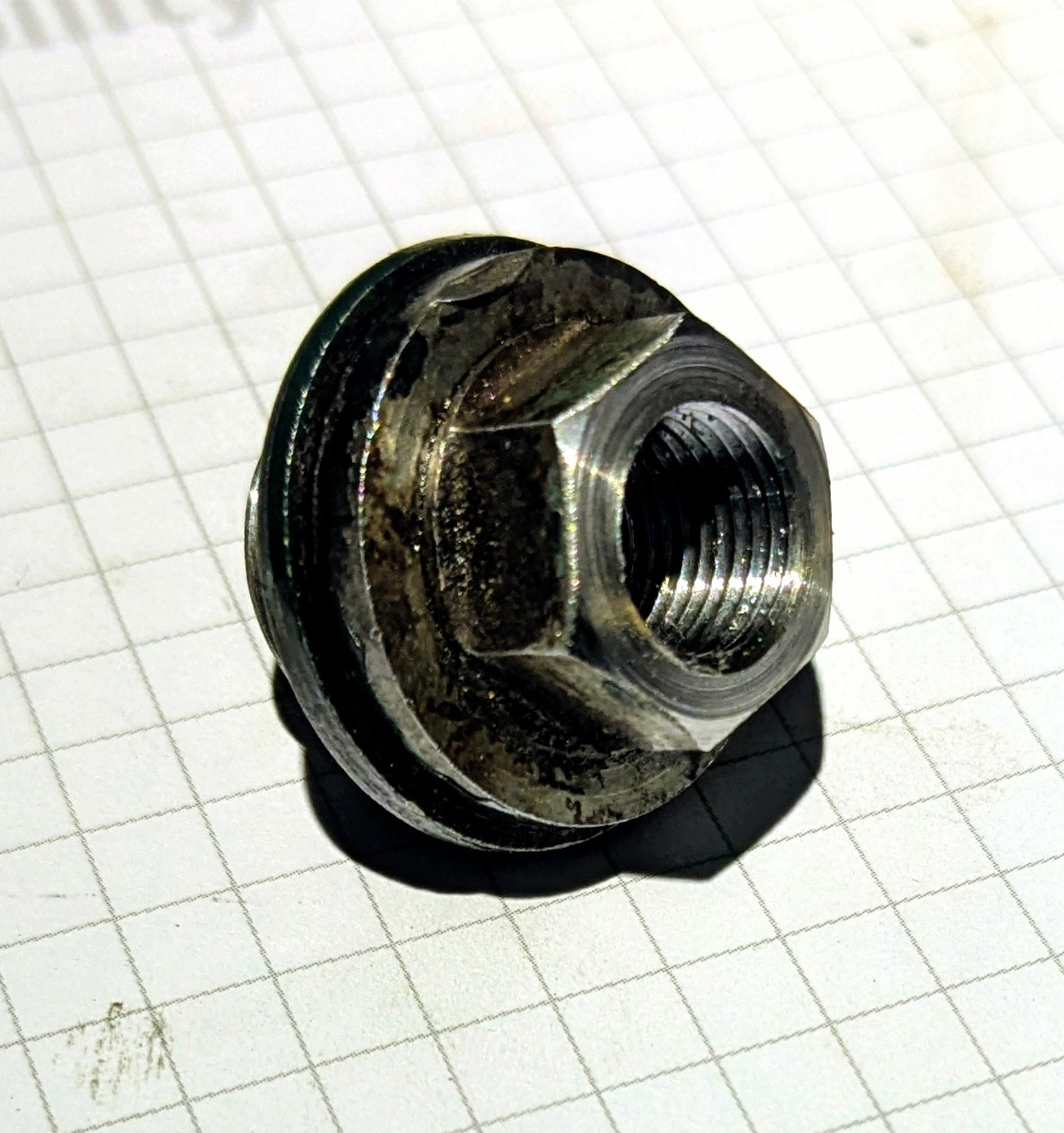

Don't have temp readings yet, but I got the sensor mounted in the same spot that you used alongside the first injector. I used the existing plug and drilled and tapped it to 1/8" NPT to match the sensor in the kit.
Thanks again - I would never have looked at this spot.

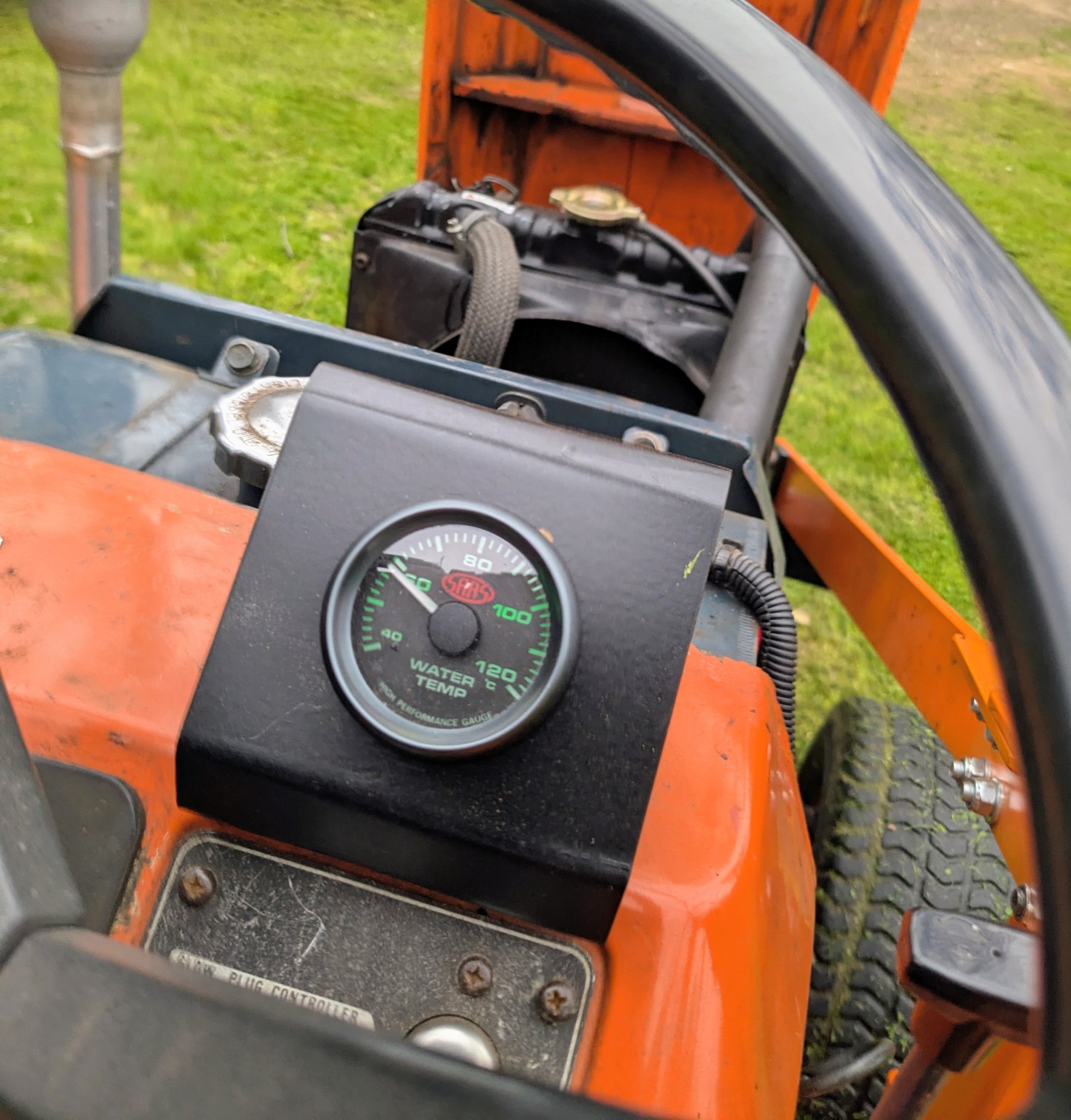

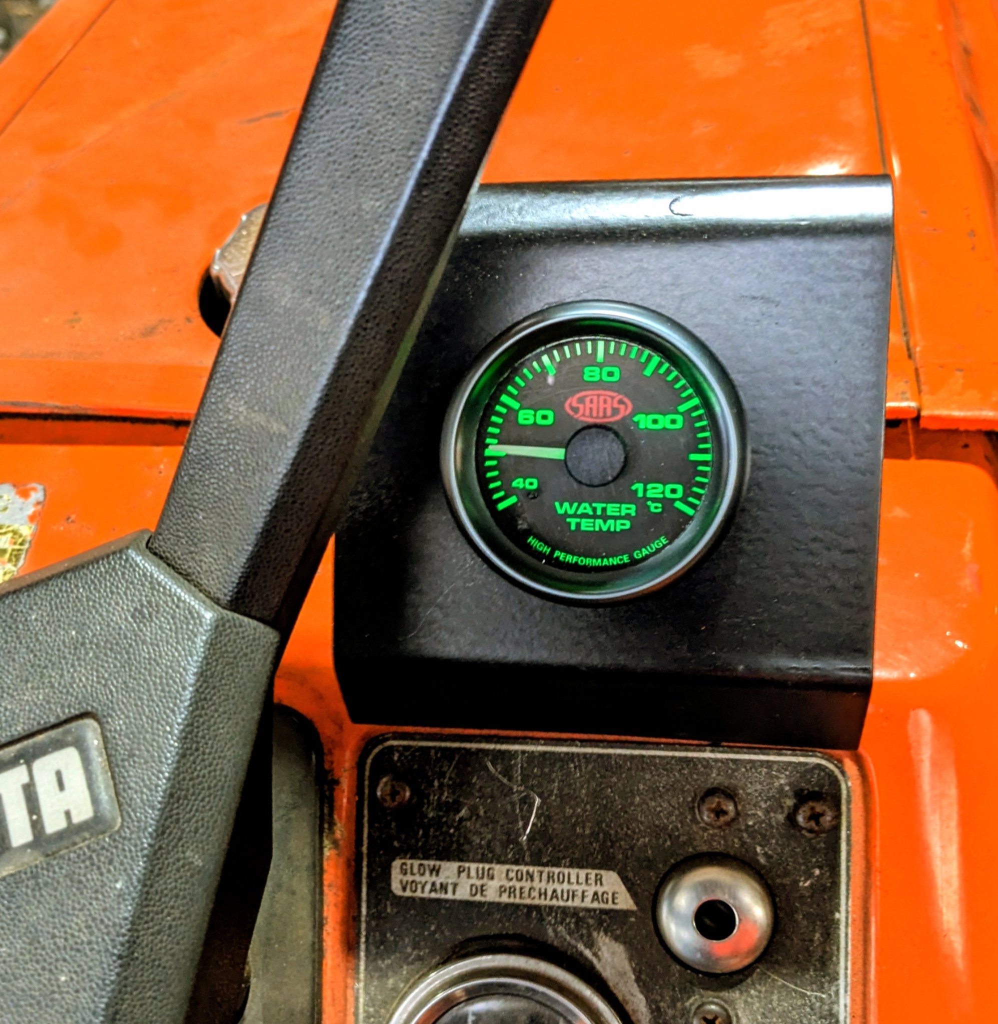

I always seem to struggle with wiring, but managed to get the temperature gauge mounted and wires connected. And it seems to be working. Up to about 50 deg C after 5 minutes idling at 1500 rpm.
Have to head inside to watch the footy now so giving it a good run will have to wait
3,943
5,314
Thats a nice looking gauge. (y)

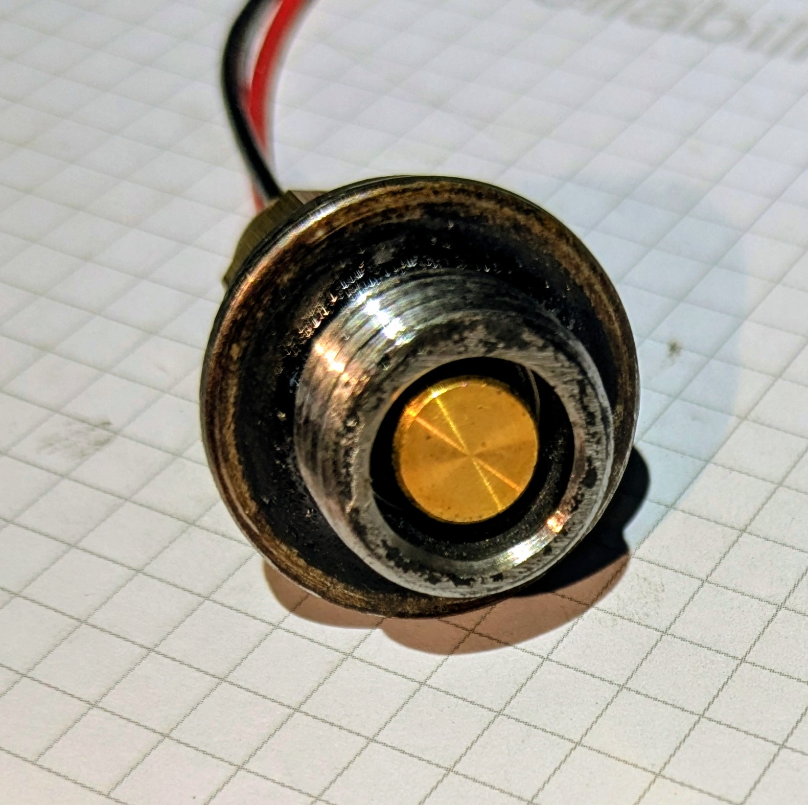

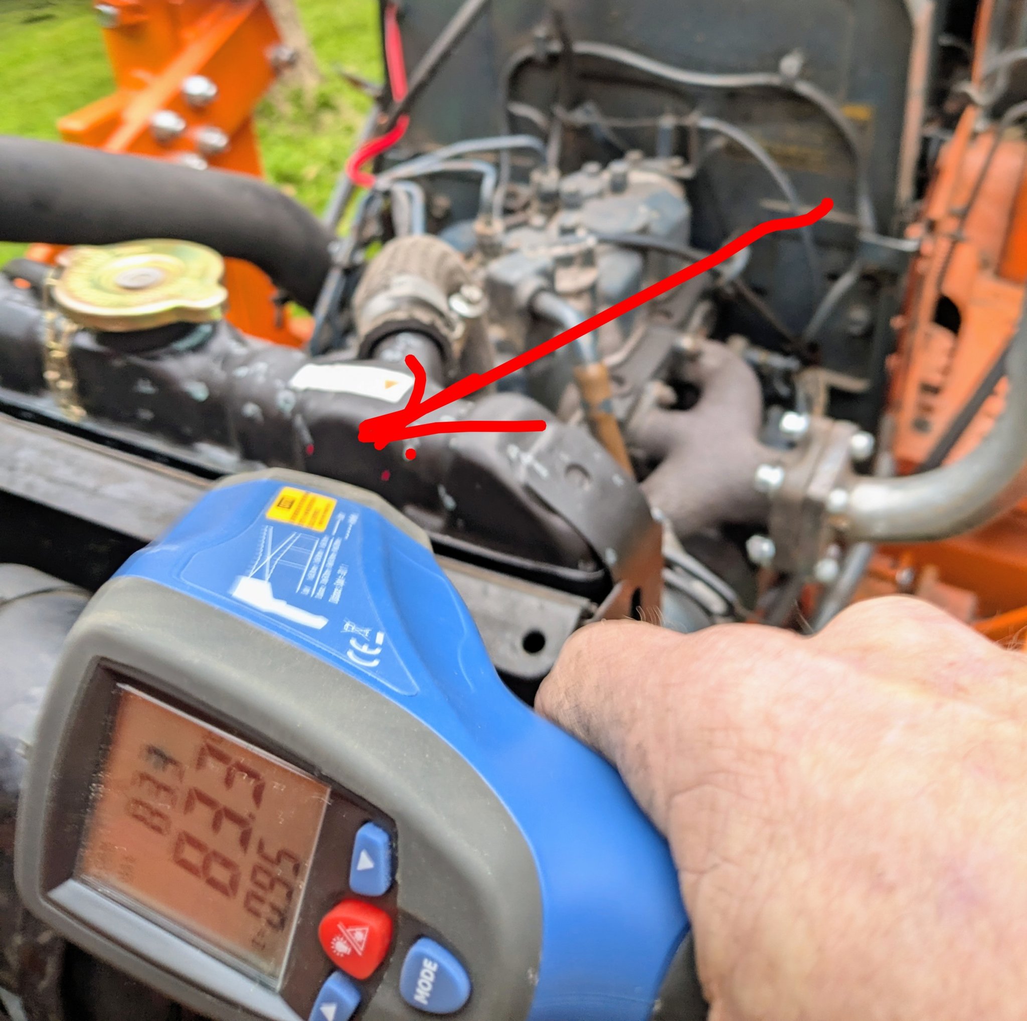

No longer running hot šŸ˜€
10 days ago after mowing for about 20 minutes I had steam coming out of the radiator overflow.
After mowing for about 90 minutes today, it ran well with no steam. I got the following temps from my new gauge with the sensor mounted in the head next to the first injector:
- Mowing at 2500 rpm 60 deg C [140 F]
- Stopped for a couple of minutes at idle 65 deg C [149 F]
- Max temp about 10 minutes after stopping 73 deg C [163 F]
When the temp in my new gauge read 60 deg C [140 F] the temp in the front of the top radiator tank in line with the inlet read 83 deg C [181 F] using a non-contact IR thermometer
Looks like the new gauge/sensor/sensor location is reading about 23 deg C [41 F] lower than the radiator top tank temp.
This shouldn't bother me as it will still give an indication of something changing if the gauge temp changes significantly, and this was the original intention. But there's this little voice inside wanting it to read right, at least a bit righter.
36,070
11,035
The radiator top of tank will always read higher as it's steam and not coolant.
It could also be that you don't have the senso far enough down into the head.
