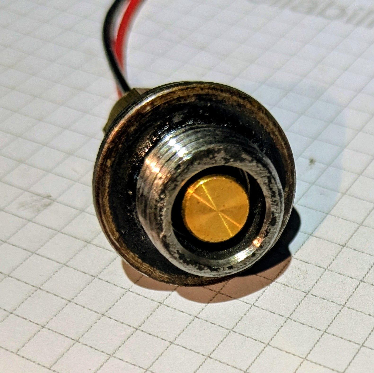

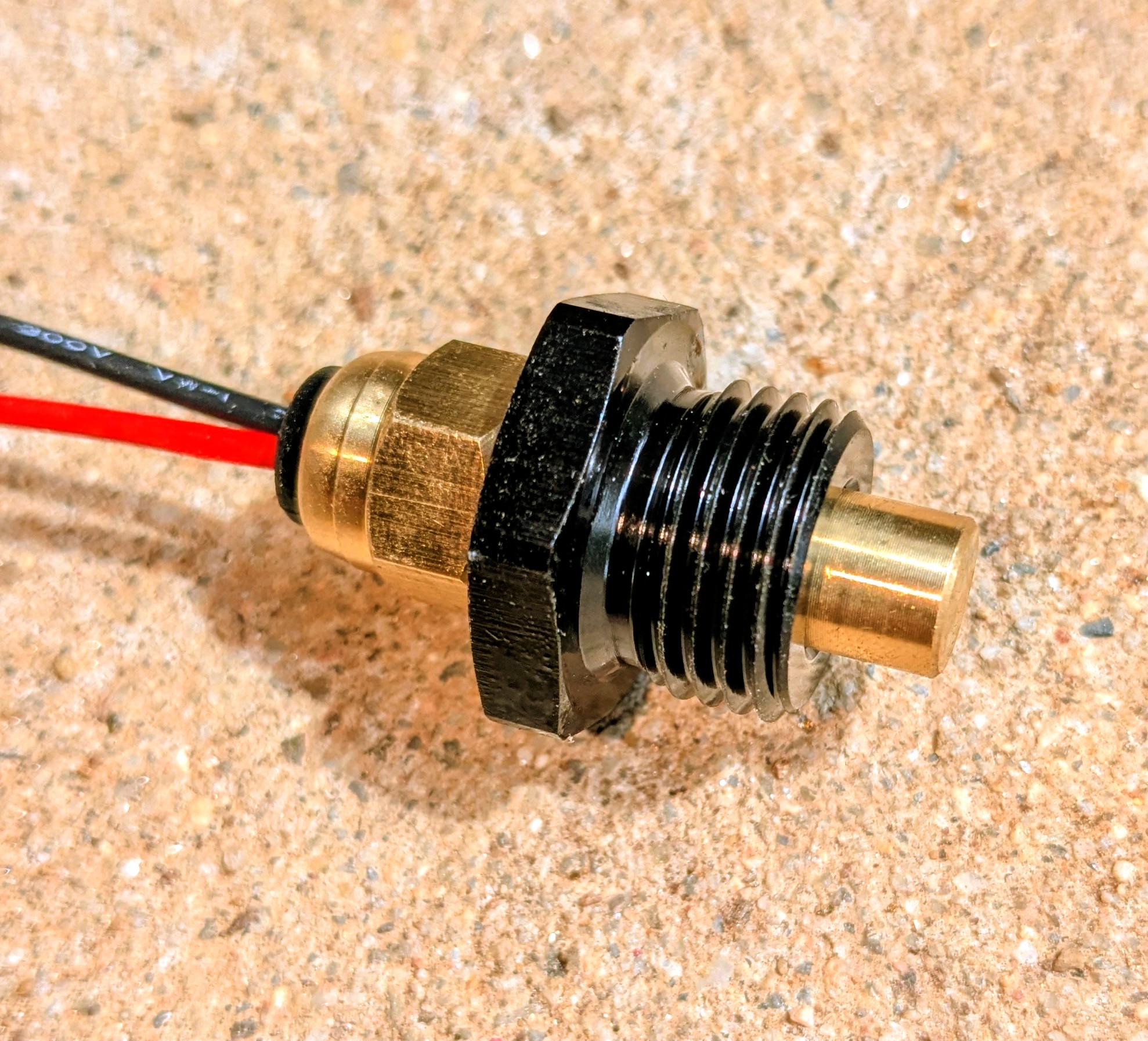

I fitted the temp sensor into a new bush today that got the sensor further out of the bush into the water. The Bush is a M16 x 1.5 - 1/8 NPT. After mowing for about an hour the temperature was steady at 64 deg C (147 deg F). Before changing the bush it sat at 60 deg C, so not much difference.
The attached pics show the sensor in line with the end of the first bush (made from the plug), and the sensor protruding from the new bush.
I think I'll be happy that it's running without overheating and leave it at that for now.

I've used the tractor to mow and spray weeds a couple of times since fitting the temp sensor into the new bush so it protrudes further into the water. The new normal temperature in this spot seems to be about 70 deg C (158 deg F) with an ambient temp of about 15 deg C (59 deg F).
