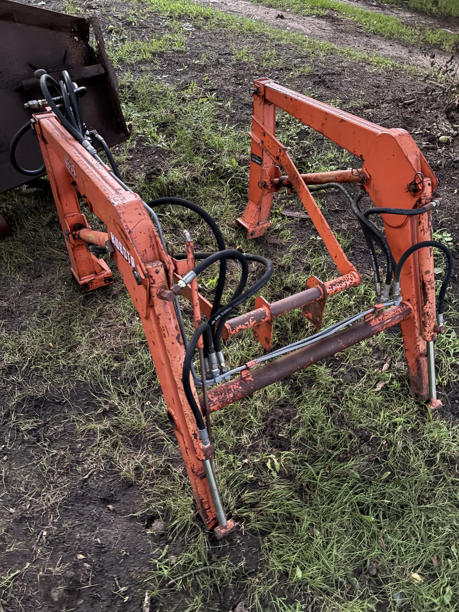

Has anyone converted there 4pt pin style loader to a mini skid steer Quick Connect attachment on their 7100 or 7200? (not the full size conversion as that won't work on these small kubotas. It hangs the implement out to far.) I have not seen it done and want to know why it couldn't or shouldn't be. With the smaller mount you can keep it close to the pivots not losing much lift capacity. There are a plethora of attachments for the miniskid that I think would be the perfect size for my small B7200. Mainly just want the quick connect for bucket and forks to start with. My bucket is shot and I want to use the brackets to make the miniskid quick connect. Then I have access to all the cheaper implements out there. Including a new or used bucket.
Any issues that may outweigh the good with using these small miniskid implements on this FEL?
I have not seen any conversion hook ups or kits online for what I'm proposing here.
