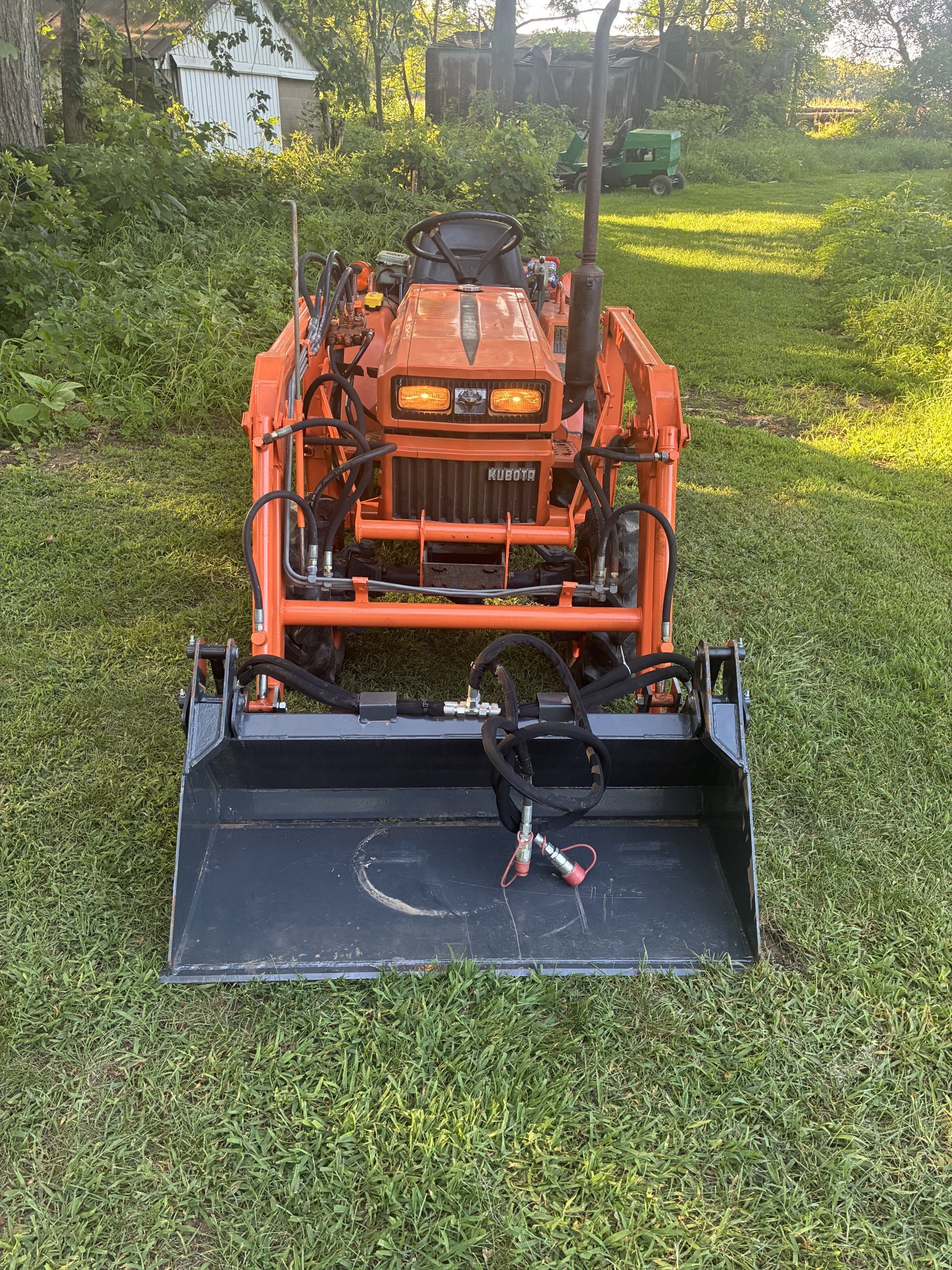

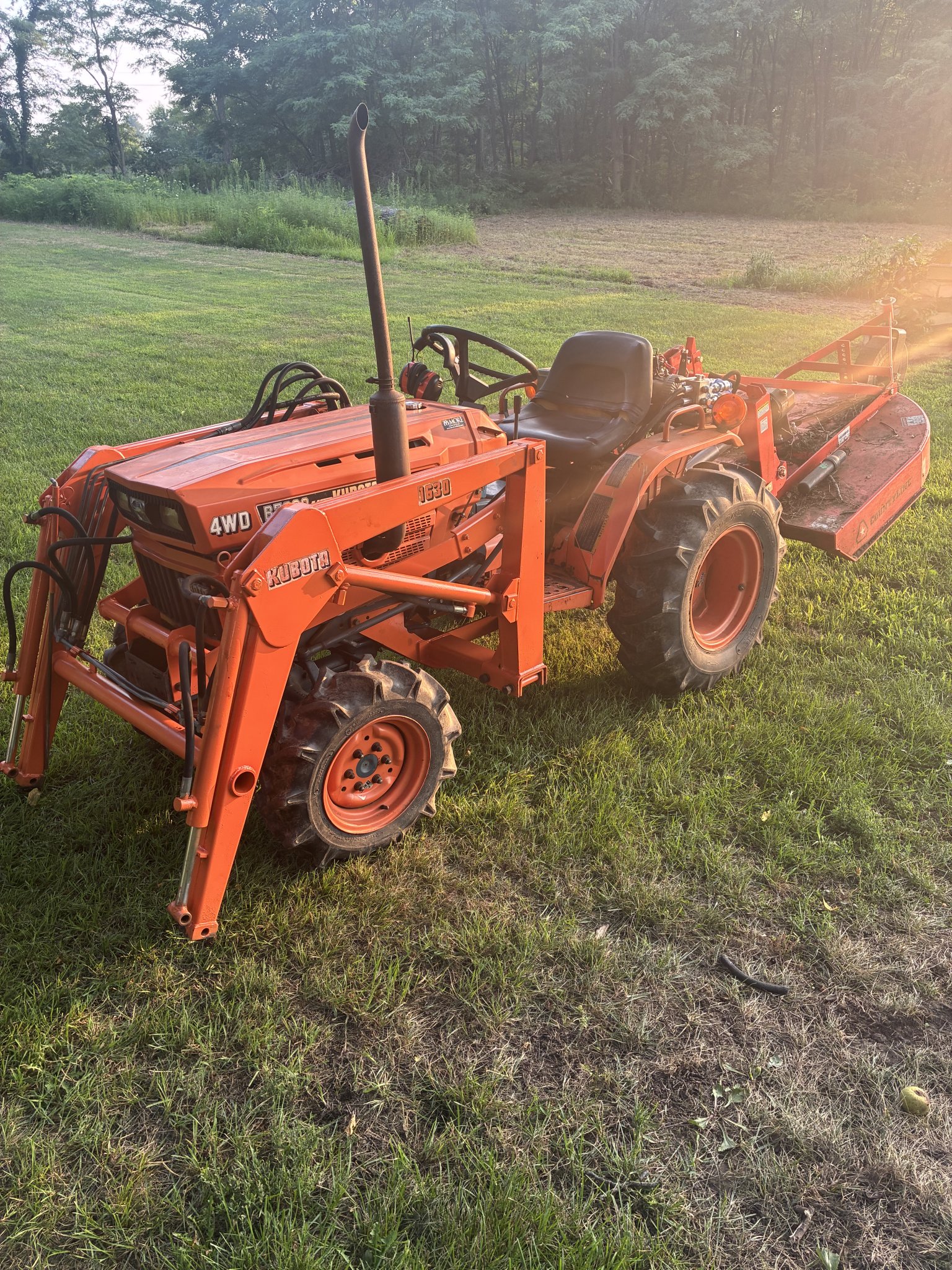

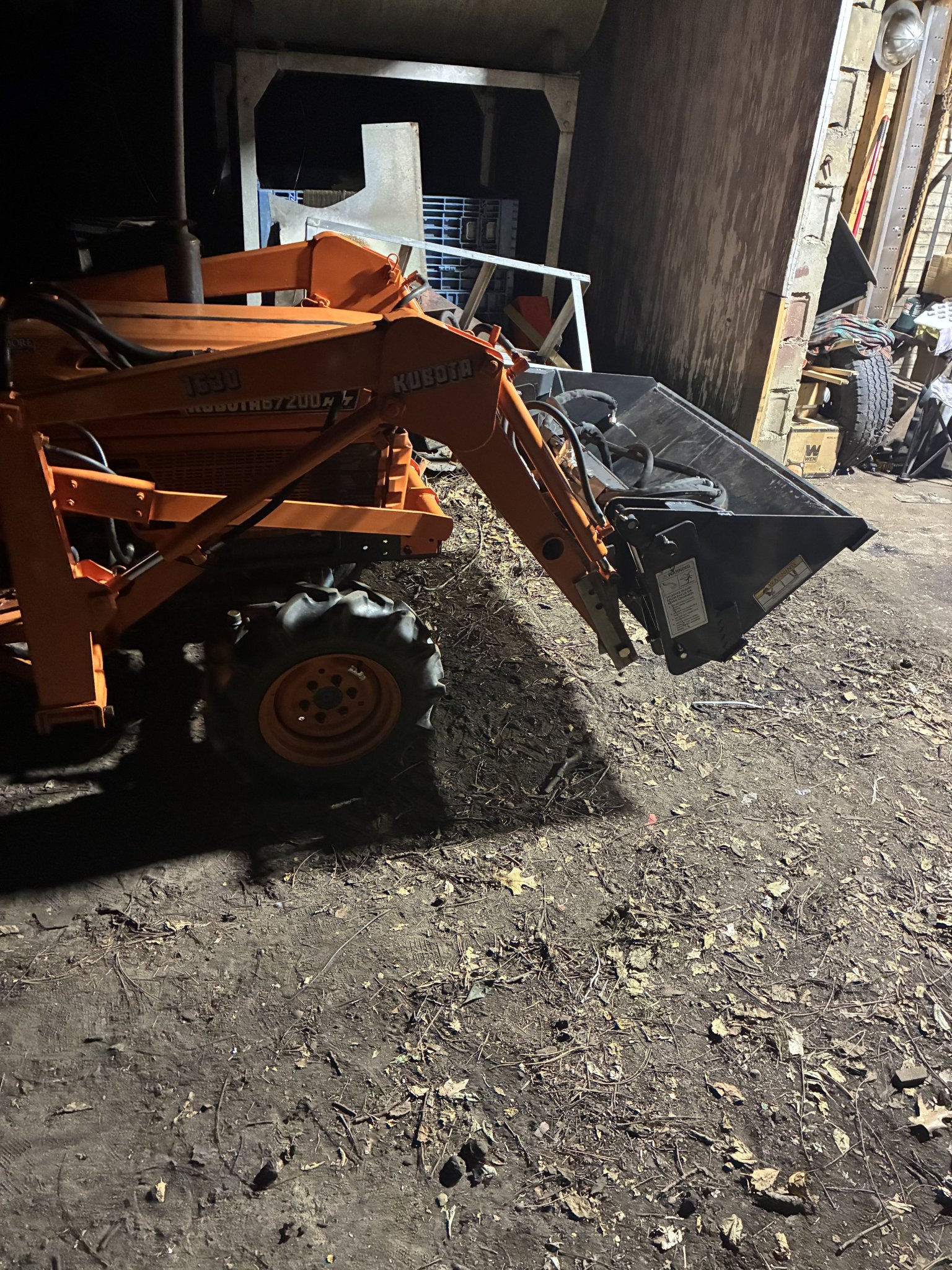

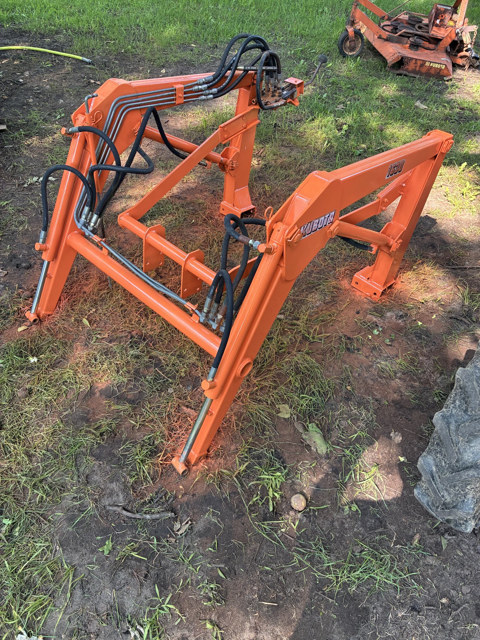

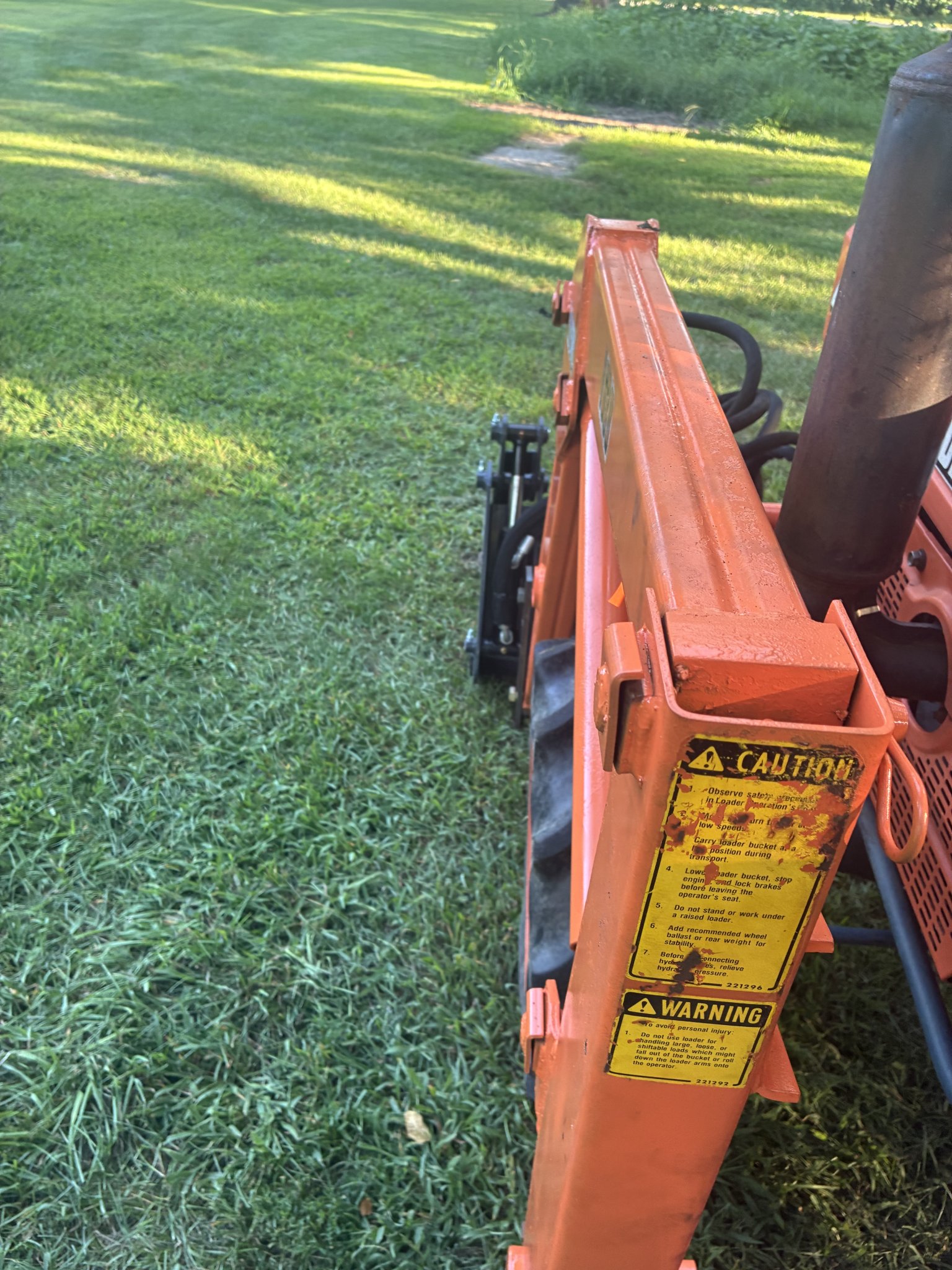

IMG_5060.jpeg Got the loader done and all the tape off. The krylon "old kubota orange" i tried first. Still just a hair to much red in it. The popsicle orange may be a hair light but i think it matches my original faded paint better or good enough.

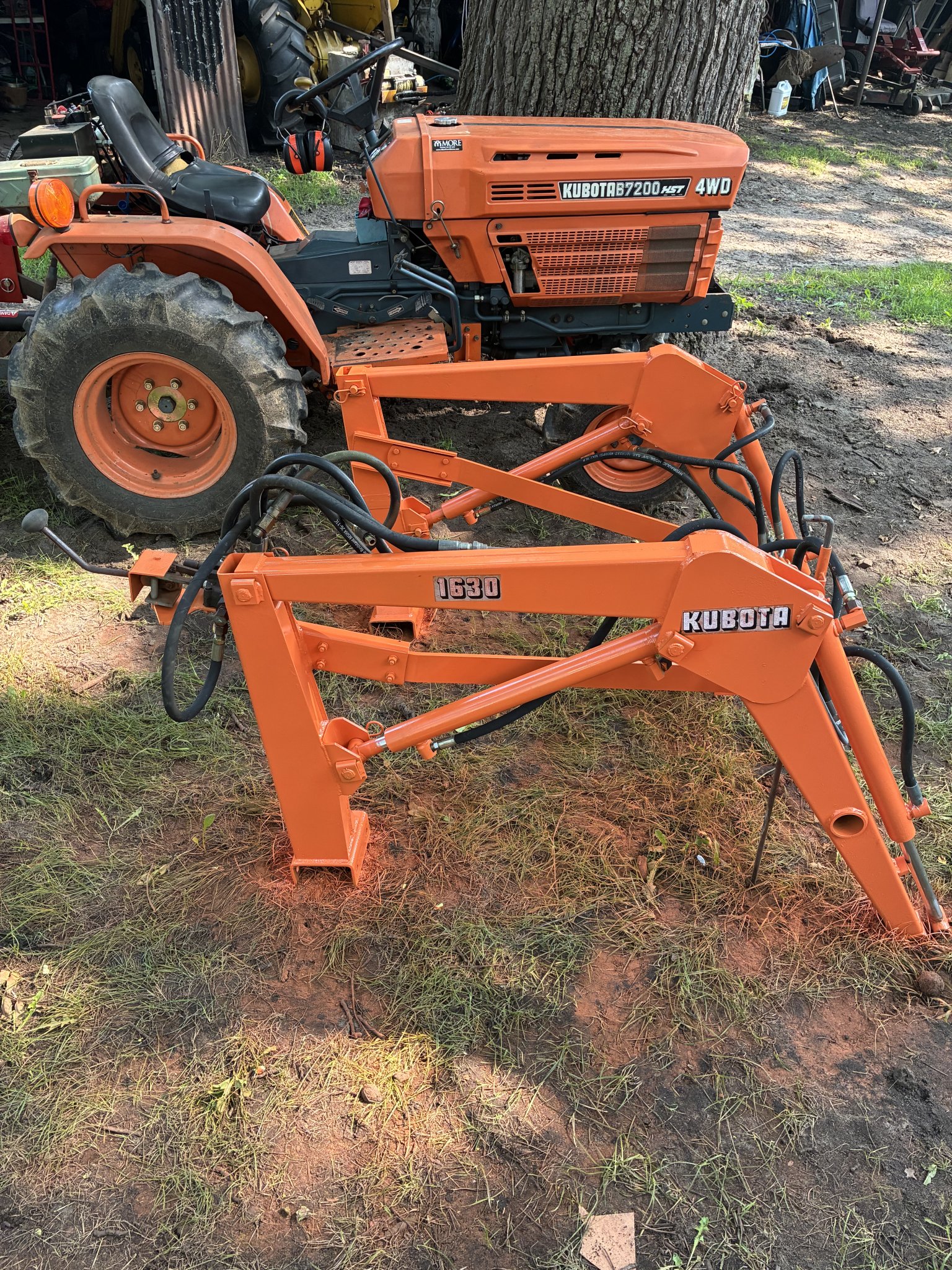

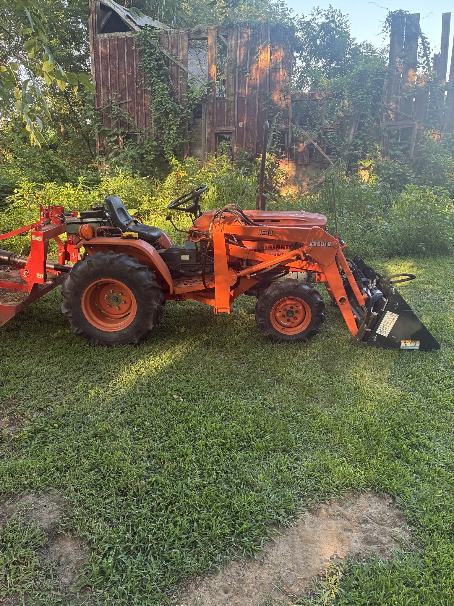

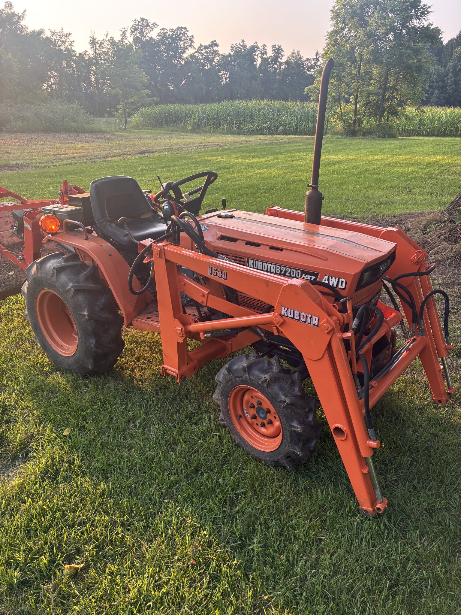

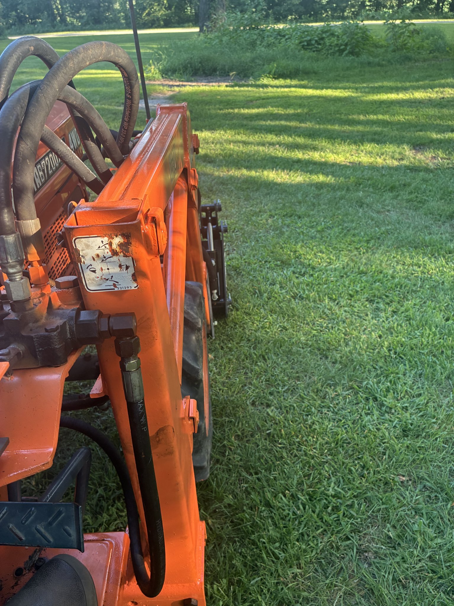

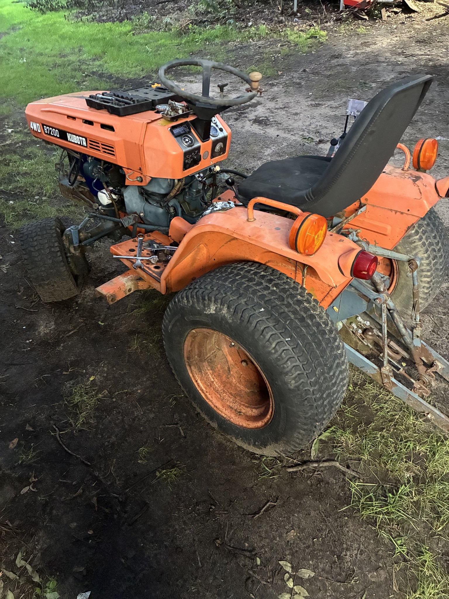

Got the loader on. Found out the b7200 gear 4wd the FEL bottom middle bracket will not work on the b7200 HST 4wd. But i can get the mower brackets that were on it to work with a little modification. Got to hook up the hydraulics too. IMG_5064.jpeg IMG_5065.jpeg IMG_5066.jpeg
can start on the mini skid attachments now.

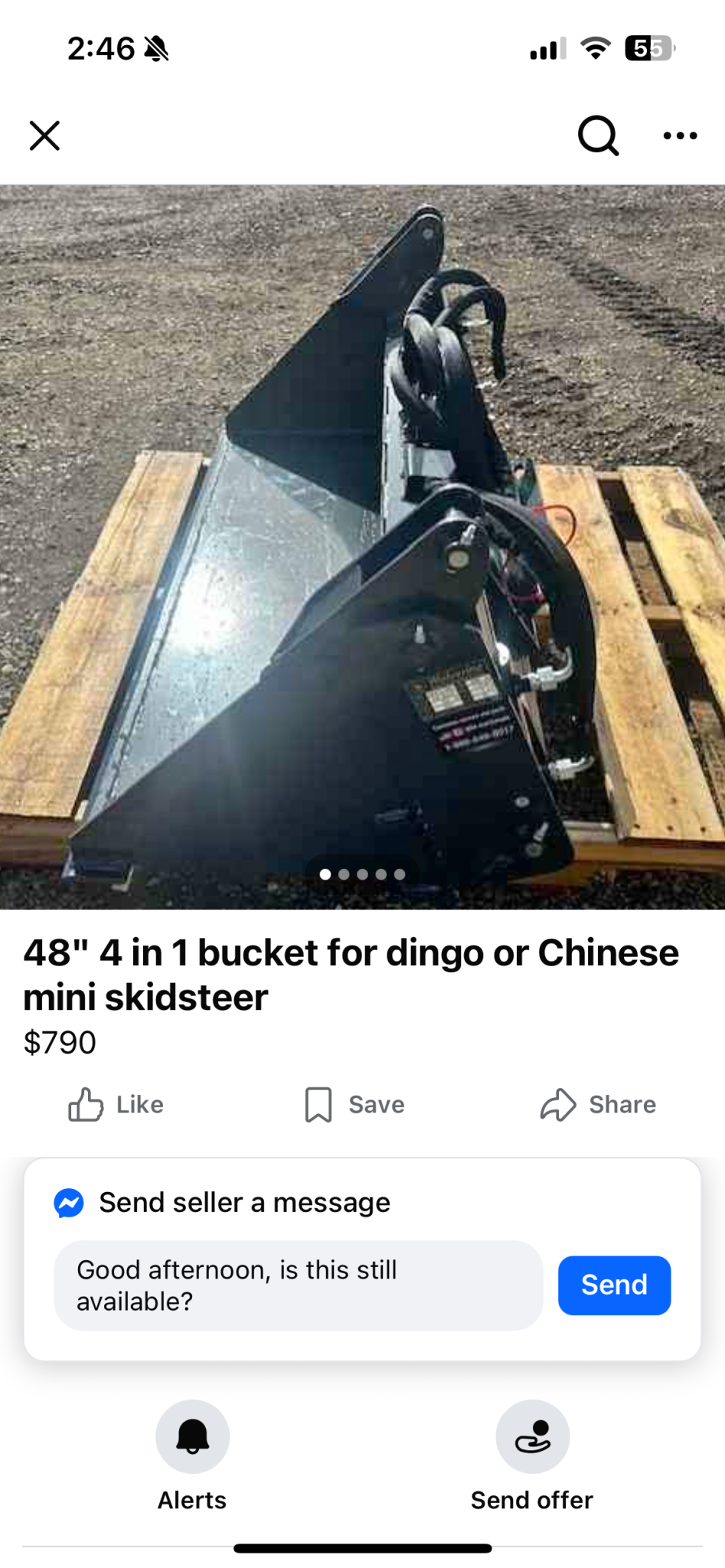

Found a 4 in 1 48" new miniskid bucket for a good price. Looks like the perfect size for my 7200. Ive read a lot of comments on 4 in 1 buckets. People Love or hate them seems appropriate. Depends on what you are doing with them.
I have grapple and forks on a bigger unit already so wanted to try 4 in 1. Just a bit more money than a regular bucket.
Any thoughts on why i shouldnt use a 4 in 1 mini on a b7200?
Picking up some steel i need for the fab work today.
This bucket looks more heavy duty than the original beat up bucket i have. 900$ not a steal but im going with it.

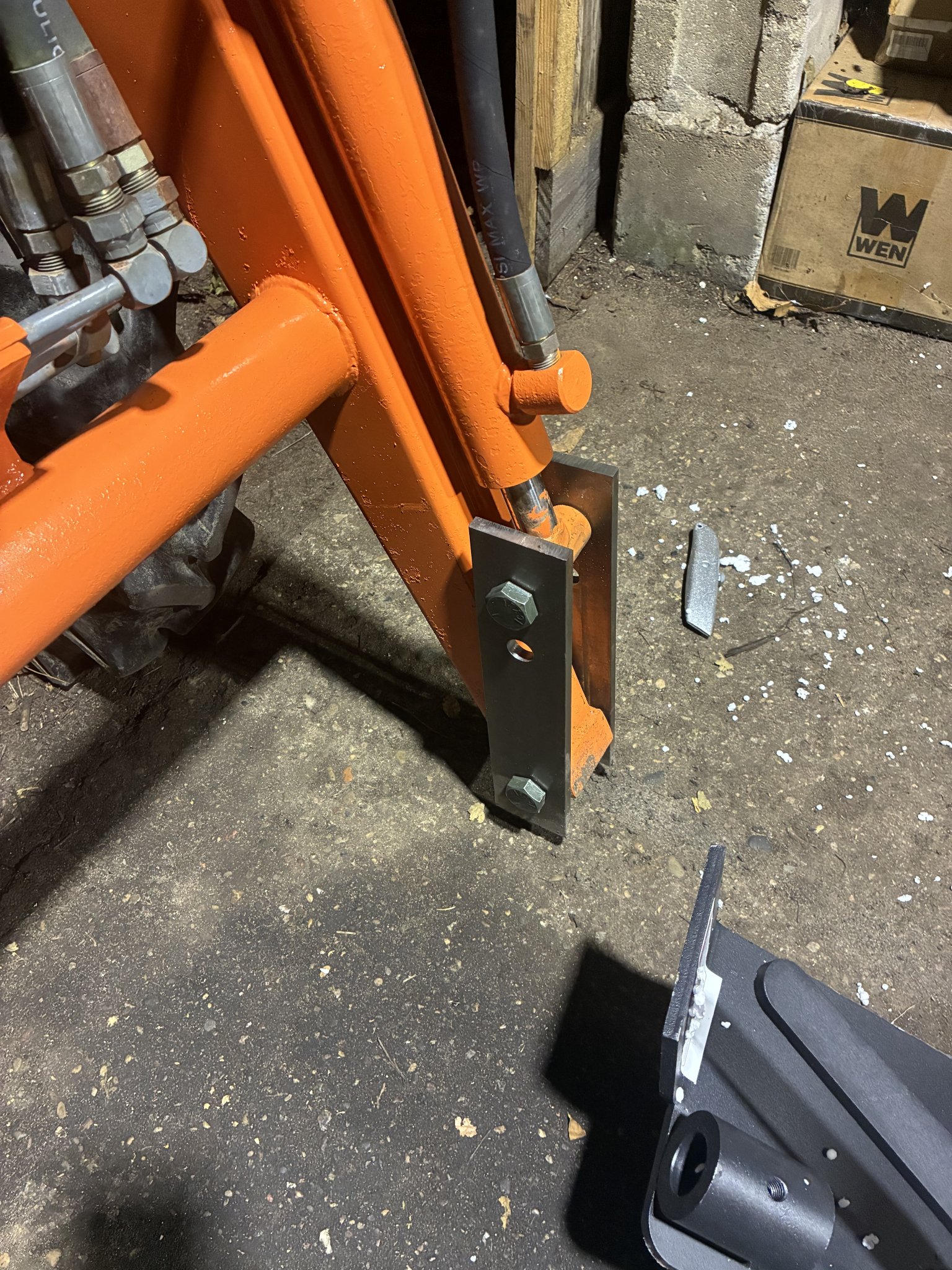

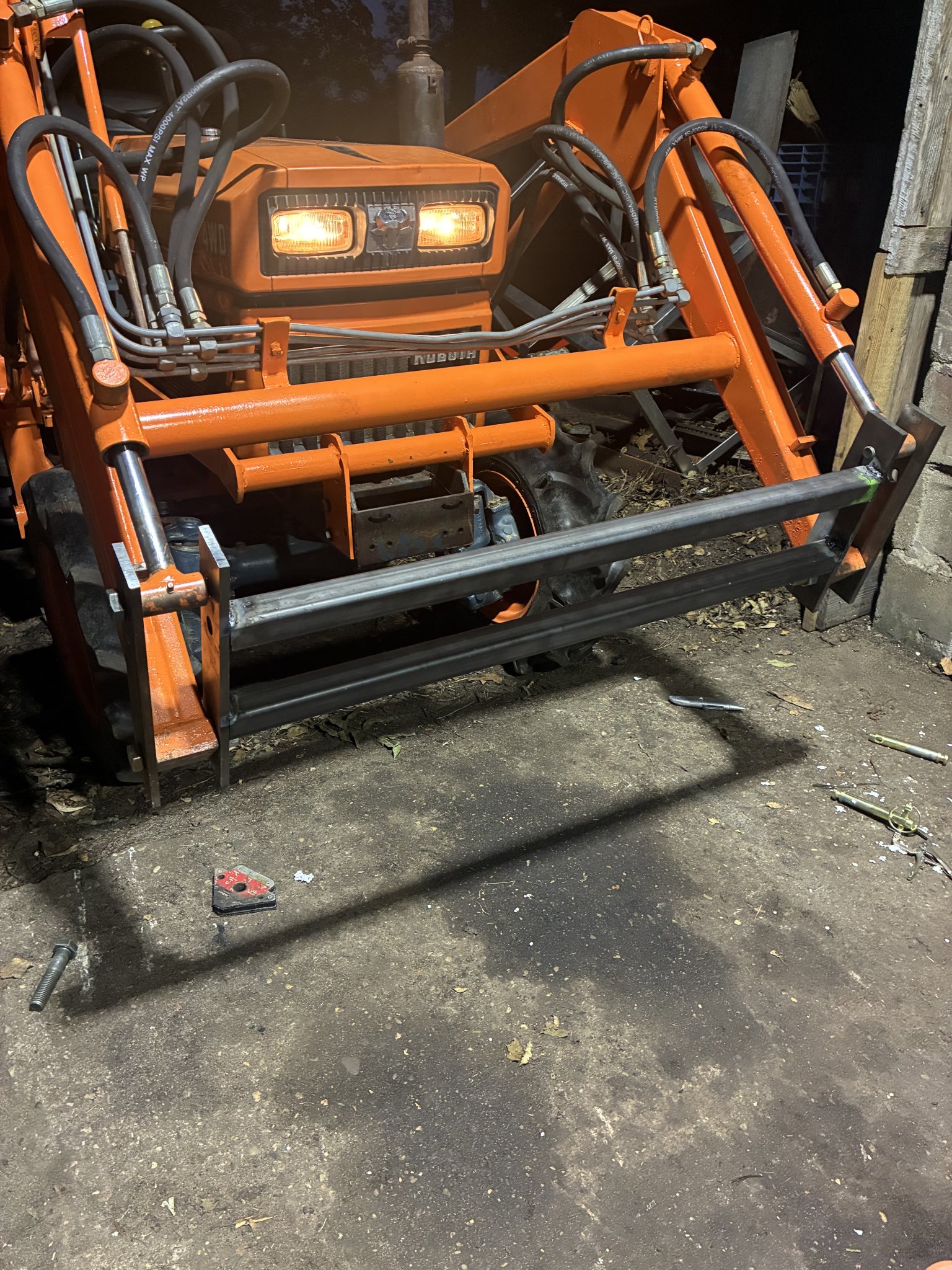

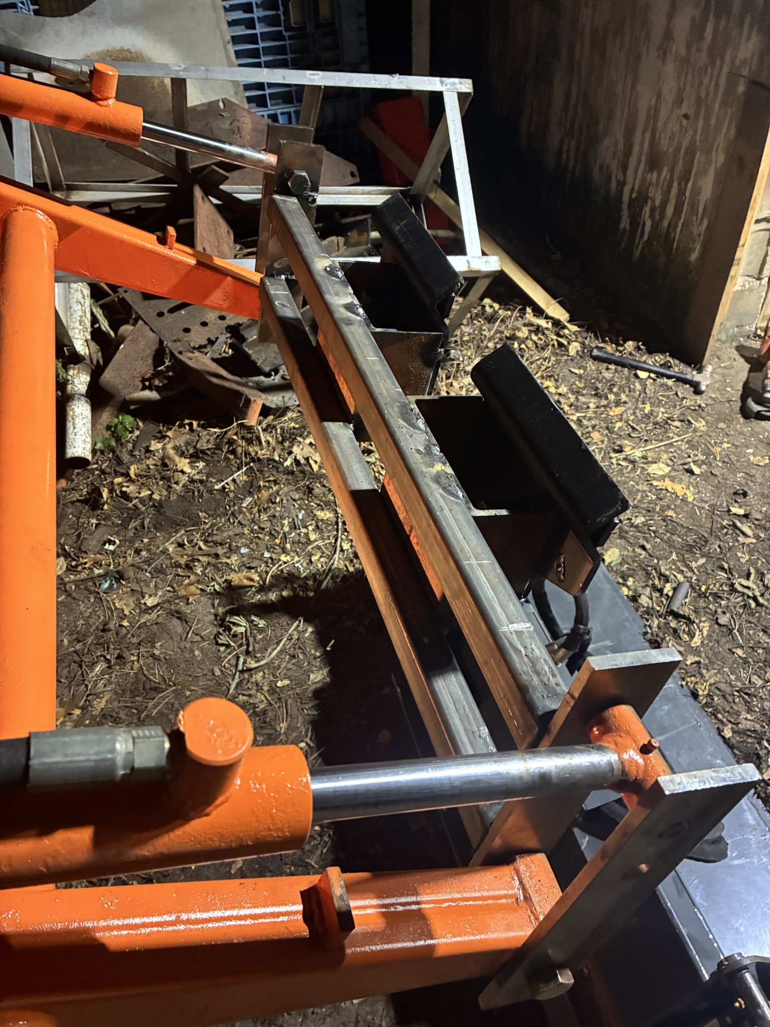

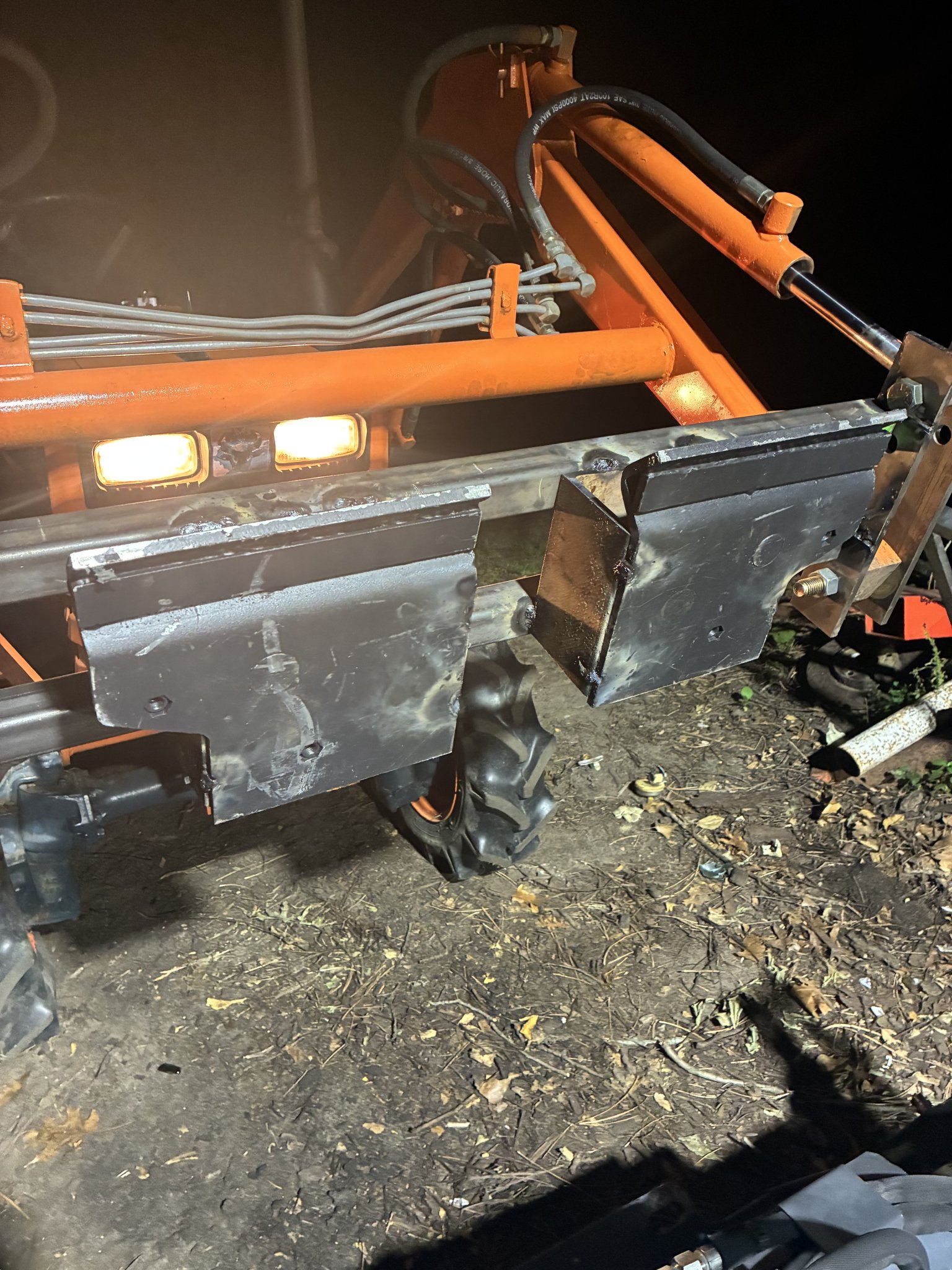

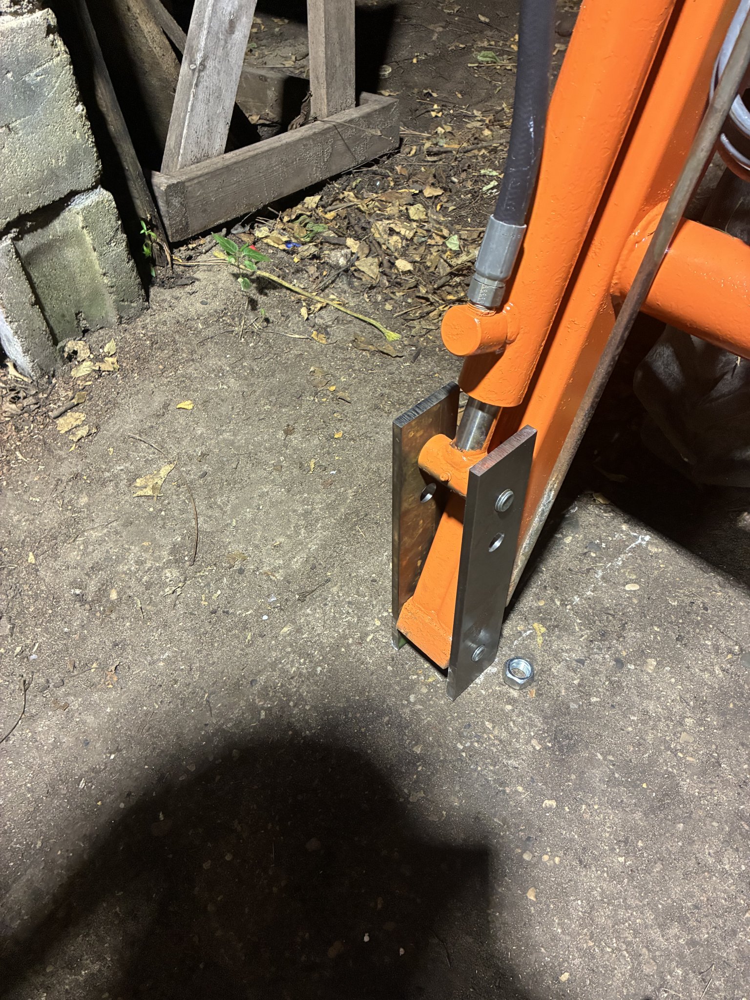

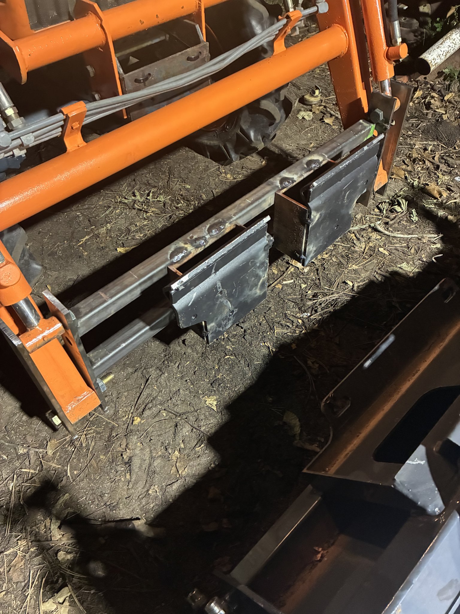

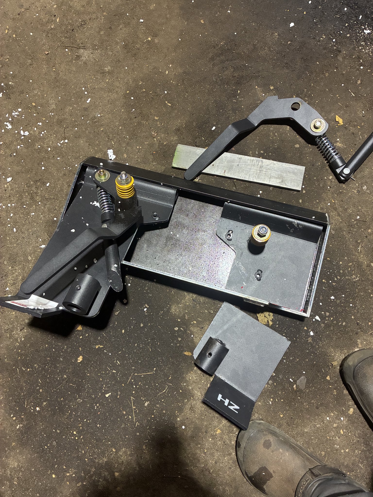

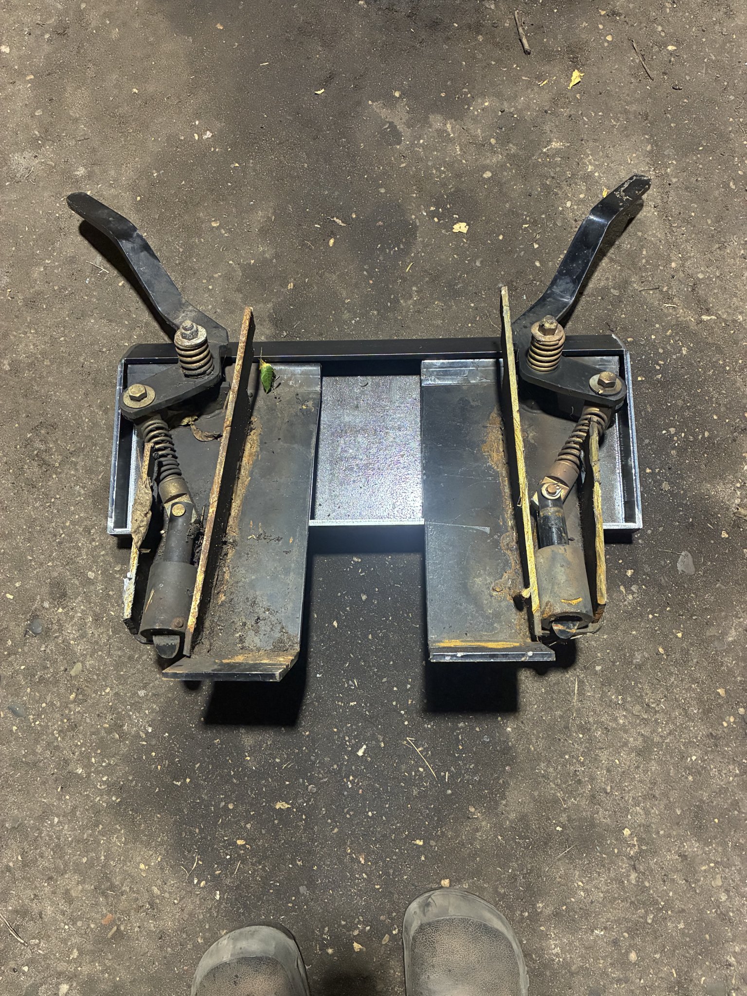

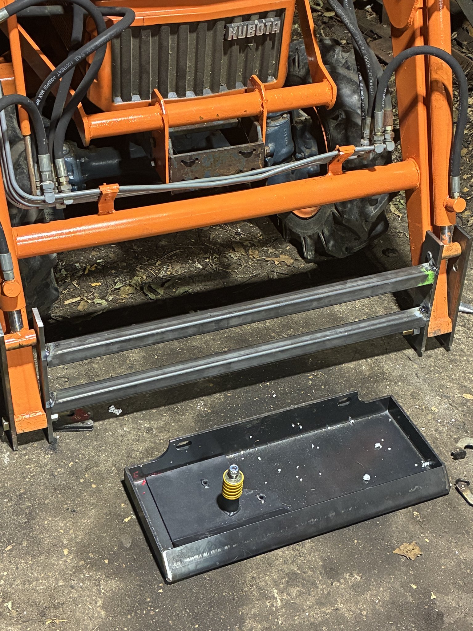

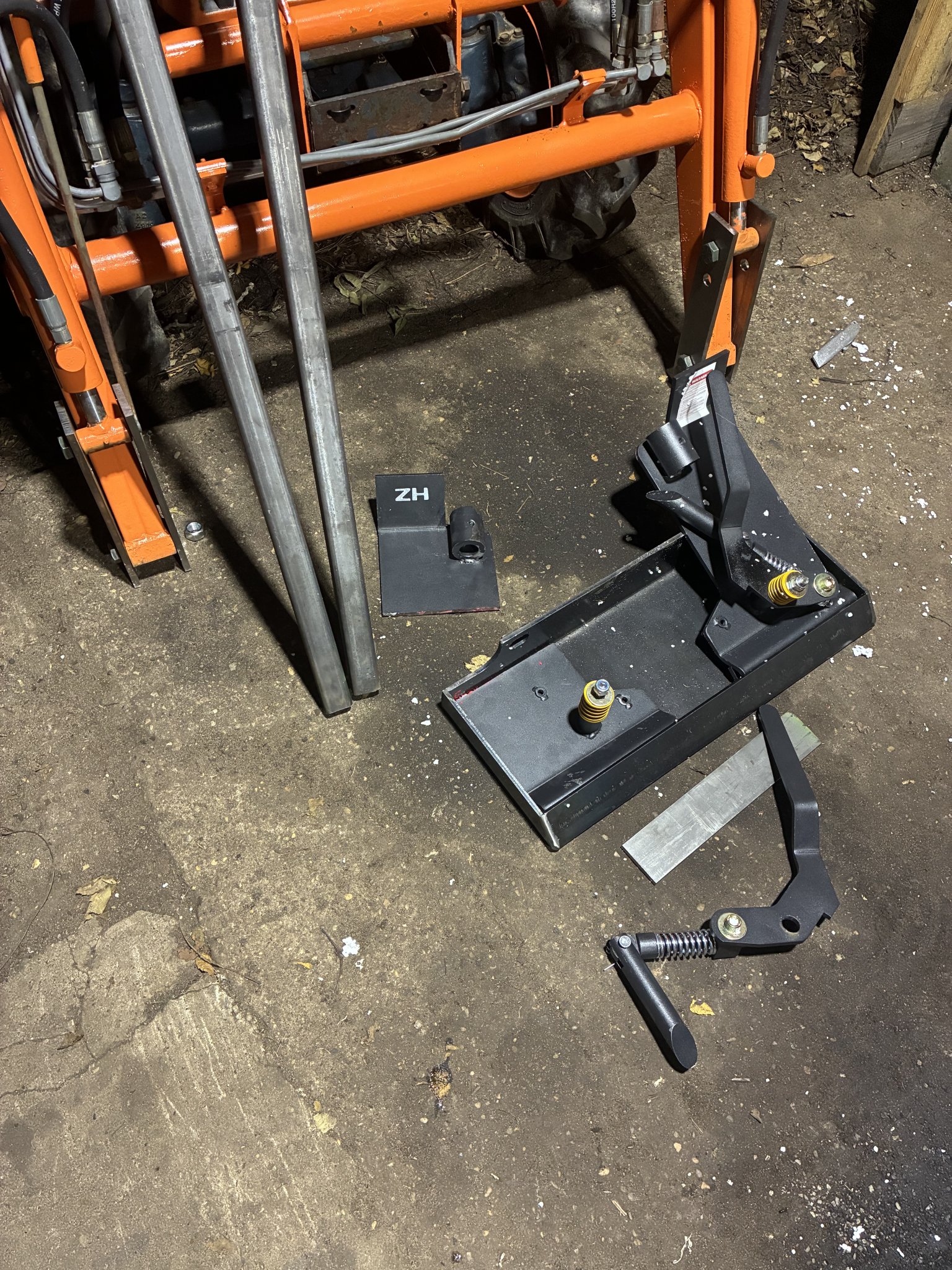

Got the new full size skid plates. Will take all the hardware off. Cut one down to fit in mini skid plates already. u can see in the pic. May be able to use pin side too.

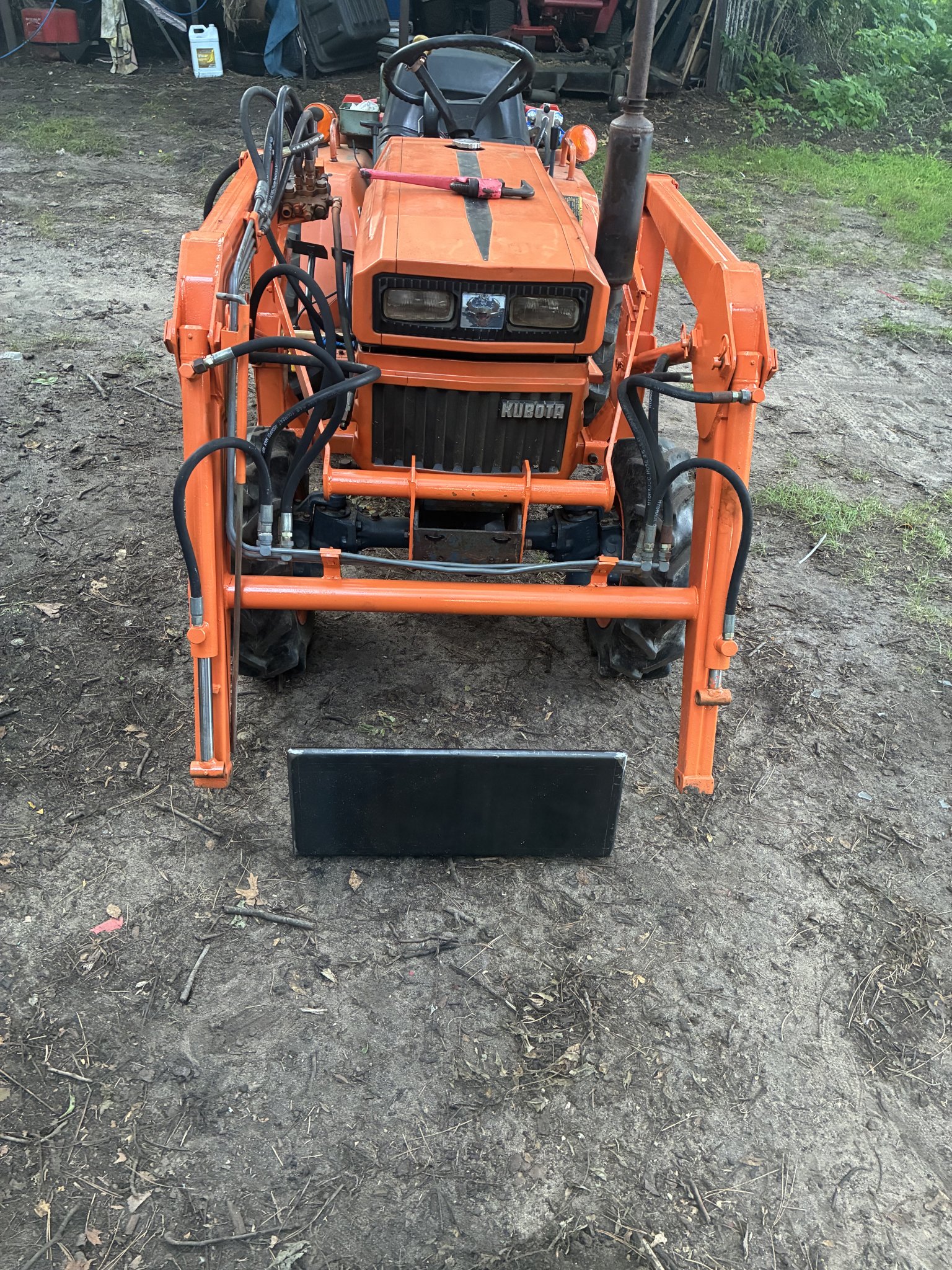

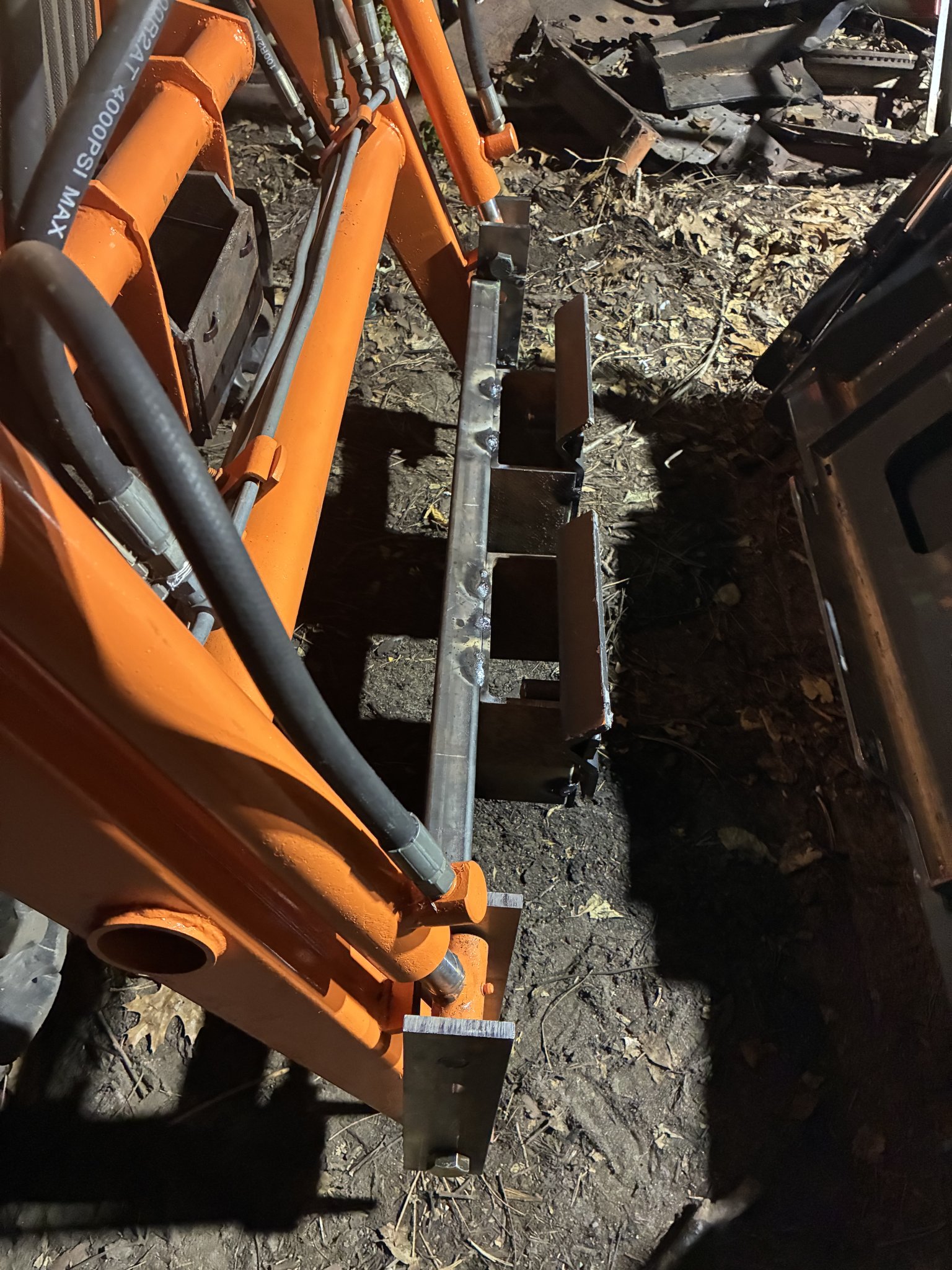

Got some brackets made up to the loader mounts. Drilled 12 holes total with 4 in the wrong location lol. 2 square tubing will be welded on and between. Then miniskid mounts welded on to these. Then all kinds of support pieces where needed.
4,091
5,525
View attachment 160060 View attachment 160061 View attachment 160062 View attachment 160063
I'm jealous.
That looks like a fun project!

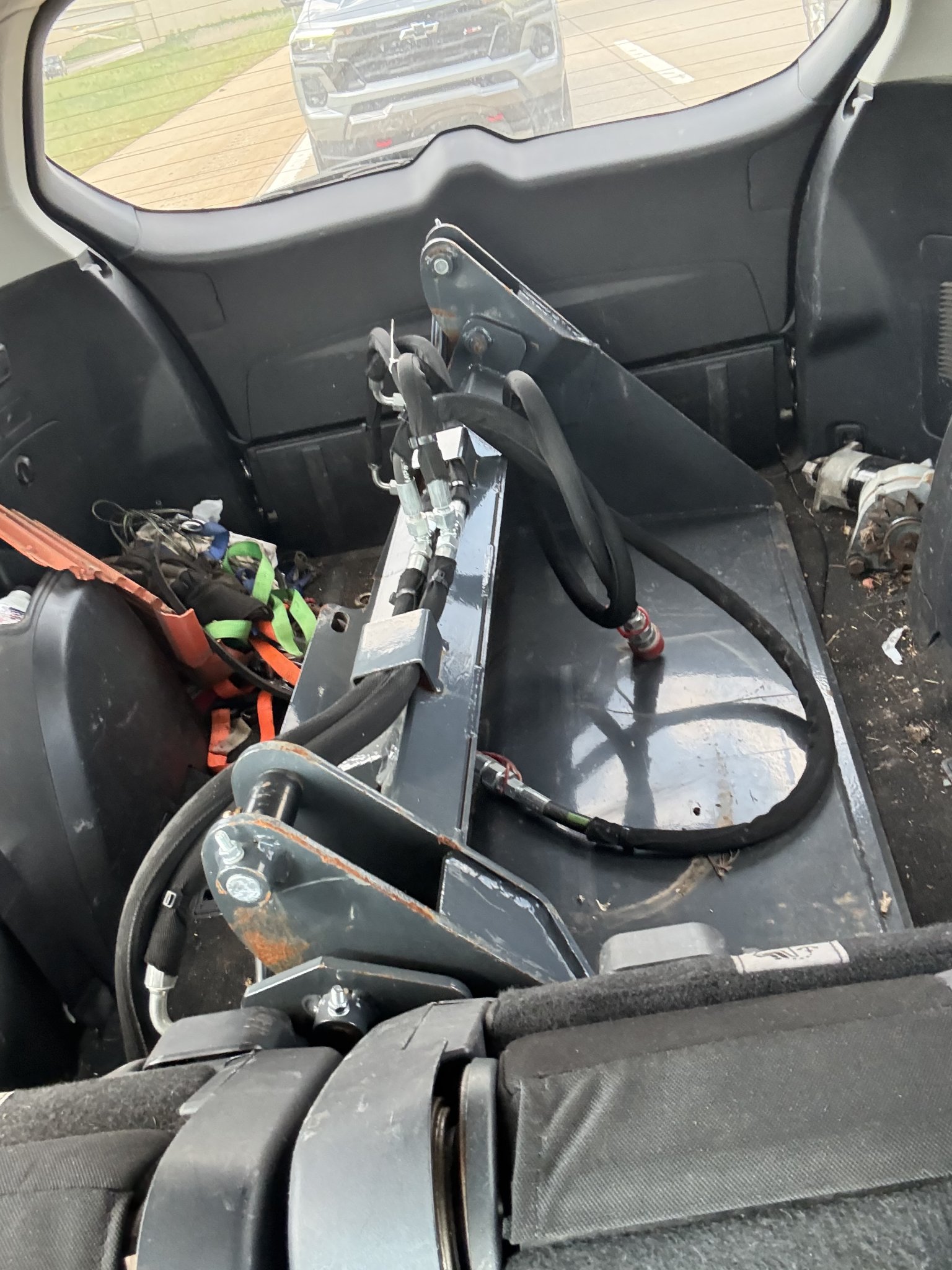

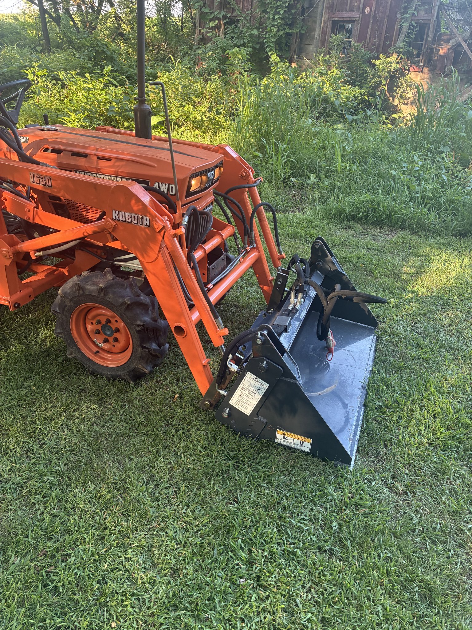

Picked up the 4 in 1 bucket. 310lbs makes the original 60" kubota bucket look like a tin can. Some may still be too big for this tractor. Fit very nicely in my mitsubishi outlander
Ill put it in front of loader later to see how it looks size wise and post a pic... IMG_5090.jpeg

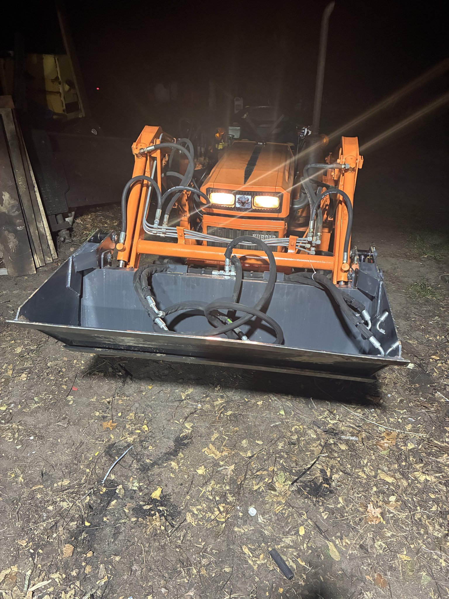

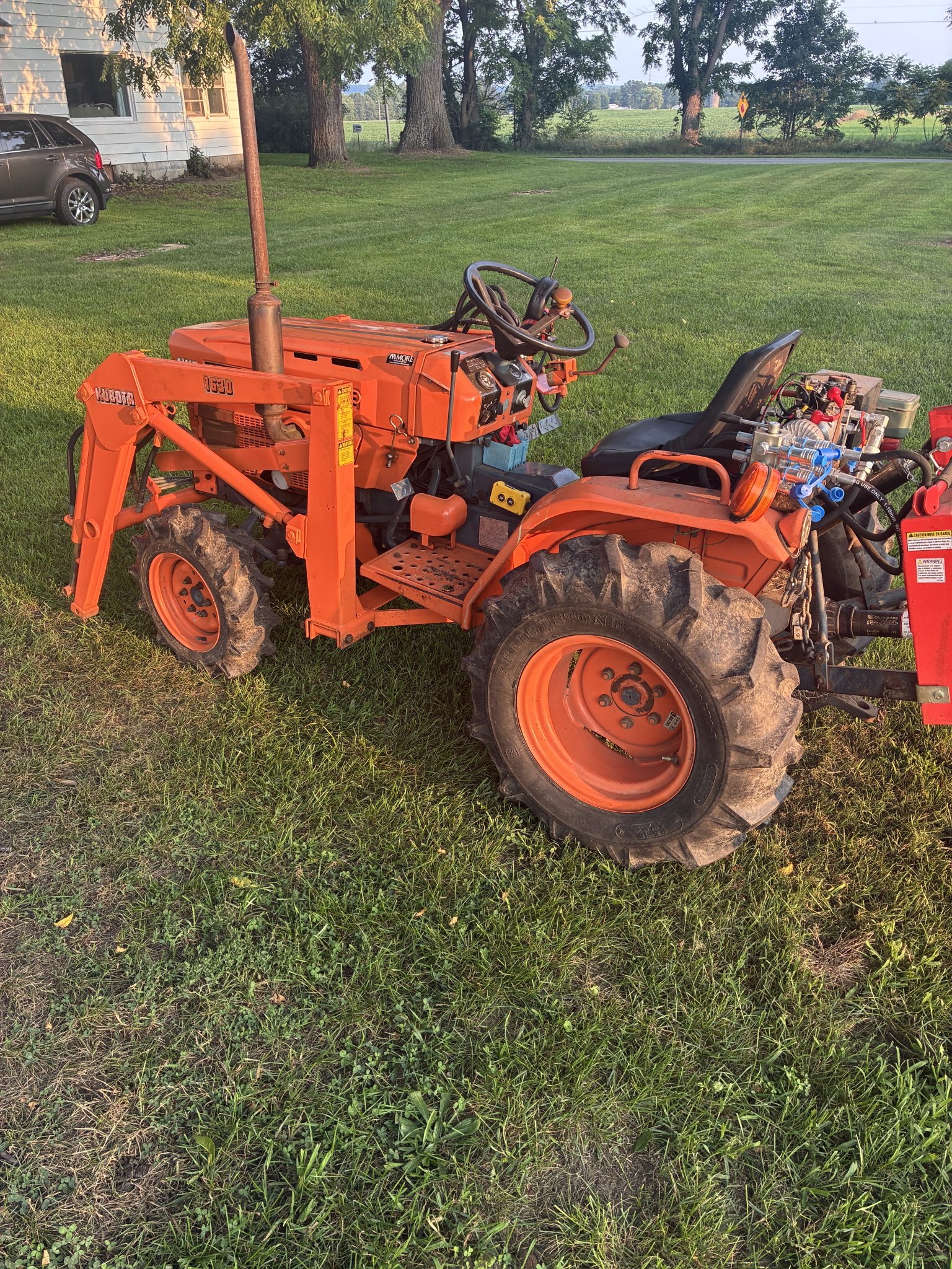

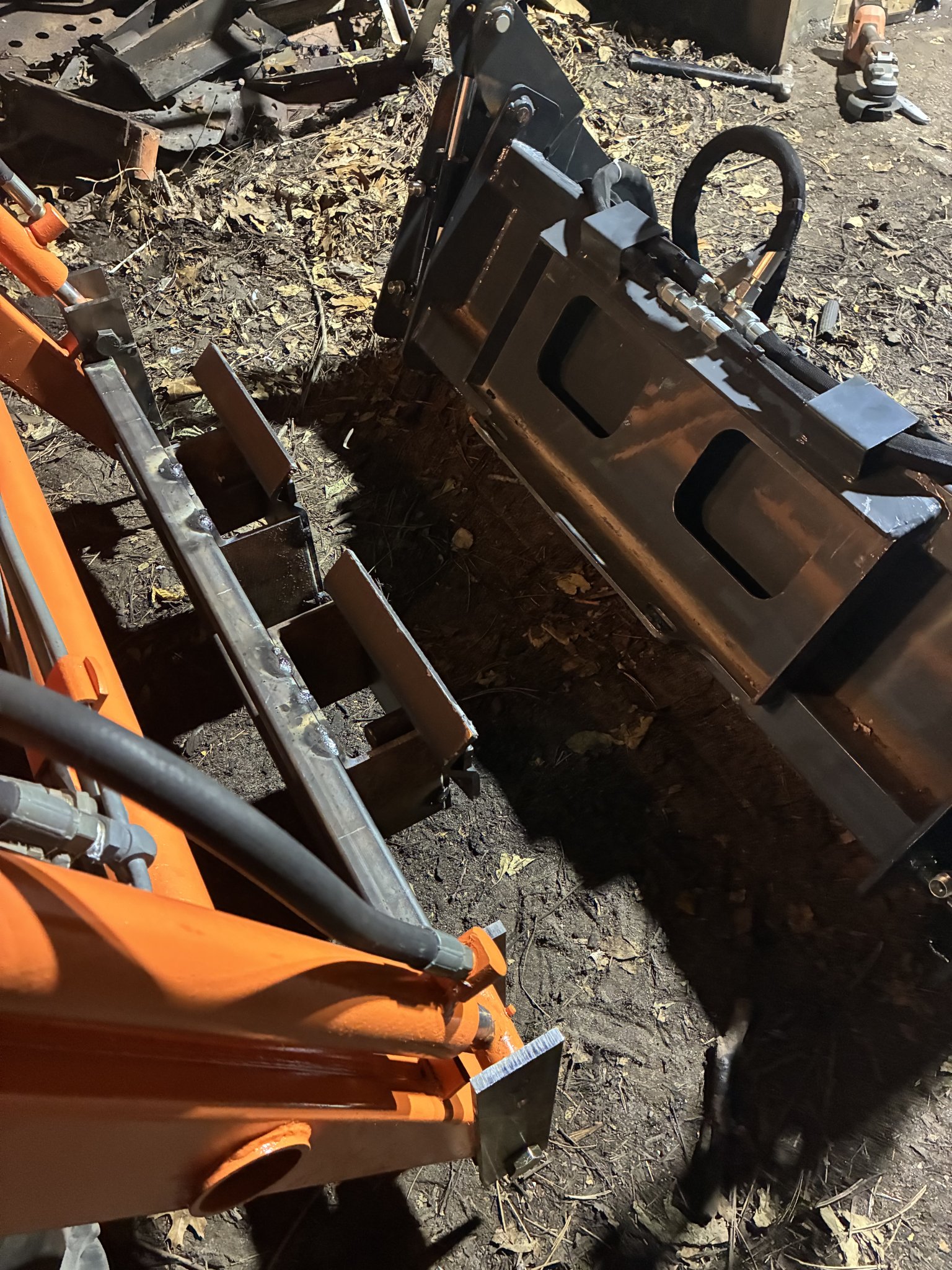

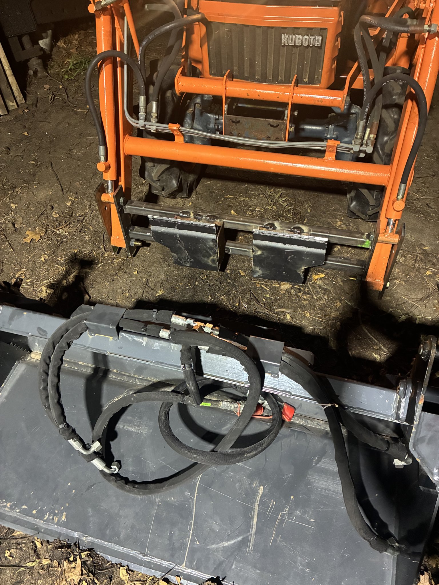

Late night. All tacked up ready for trial fit. Turns out i have one kind of bad issue. See next post and pics for that. Might be a show stopper for this bucket. IMG_5116.jpeg IMG_5117.jpeg IMG_5120.jpeg IMG_5121.jpeg IMG_5122.jpeg IMG_5123.jpeg IMG_5126.jpeg IMG_5125.jpeg IMG_5124.jpeg Everything else fit pretty good. My pivots did end up being couple inches in front of the pivot. Very difficult to see hooking up. No practice either

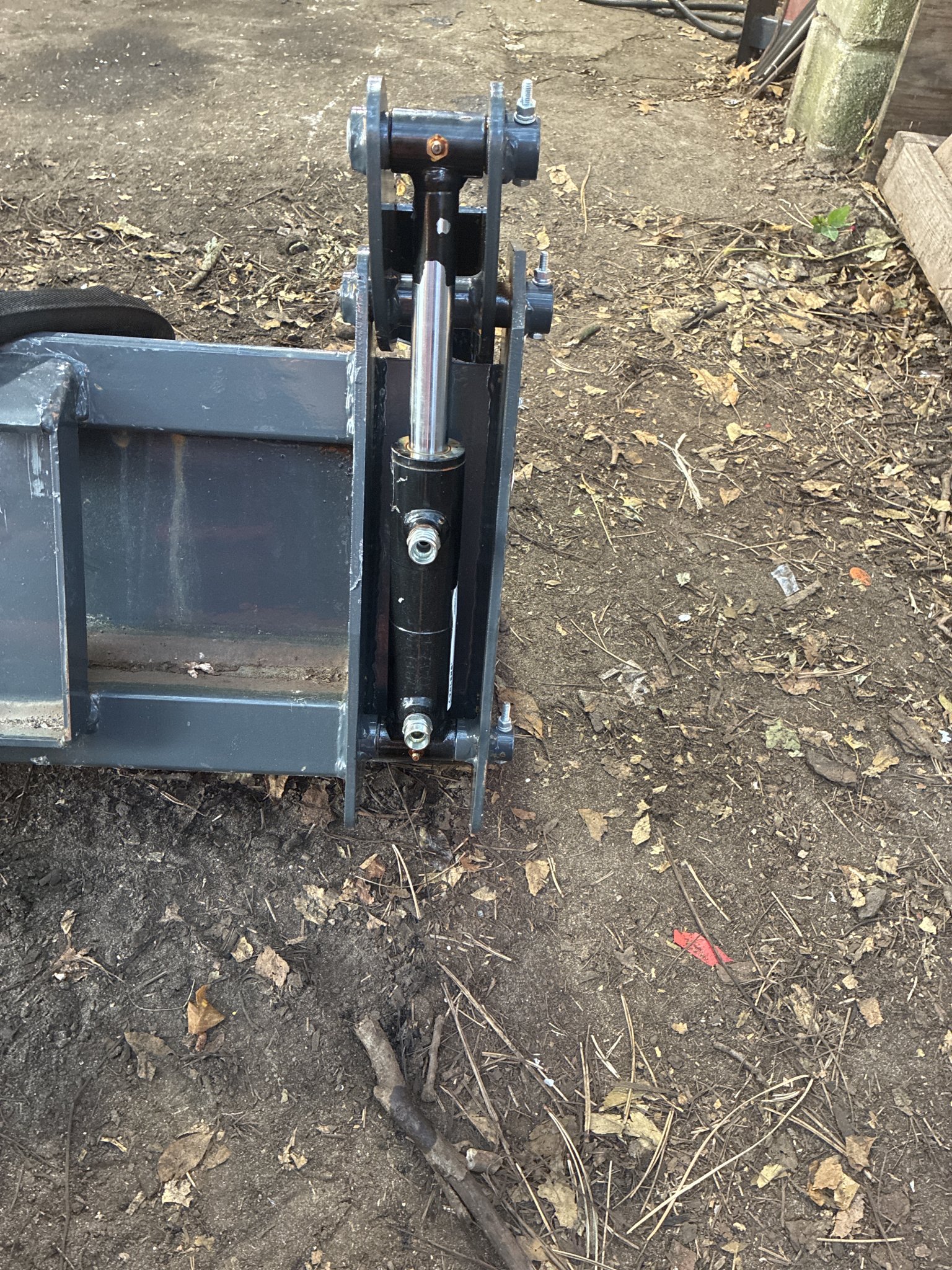

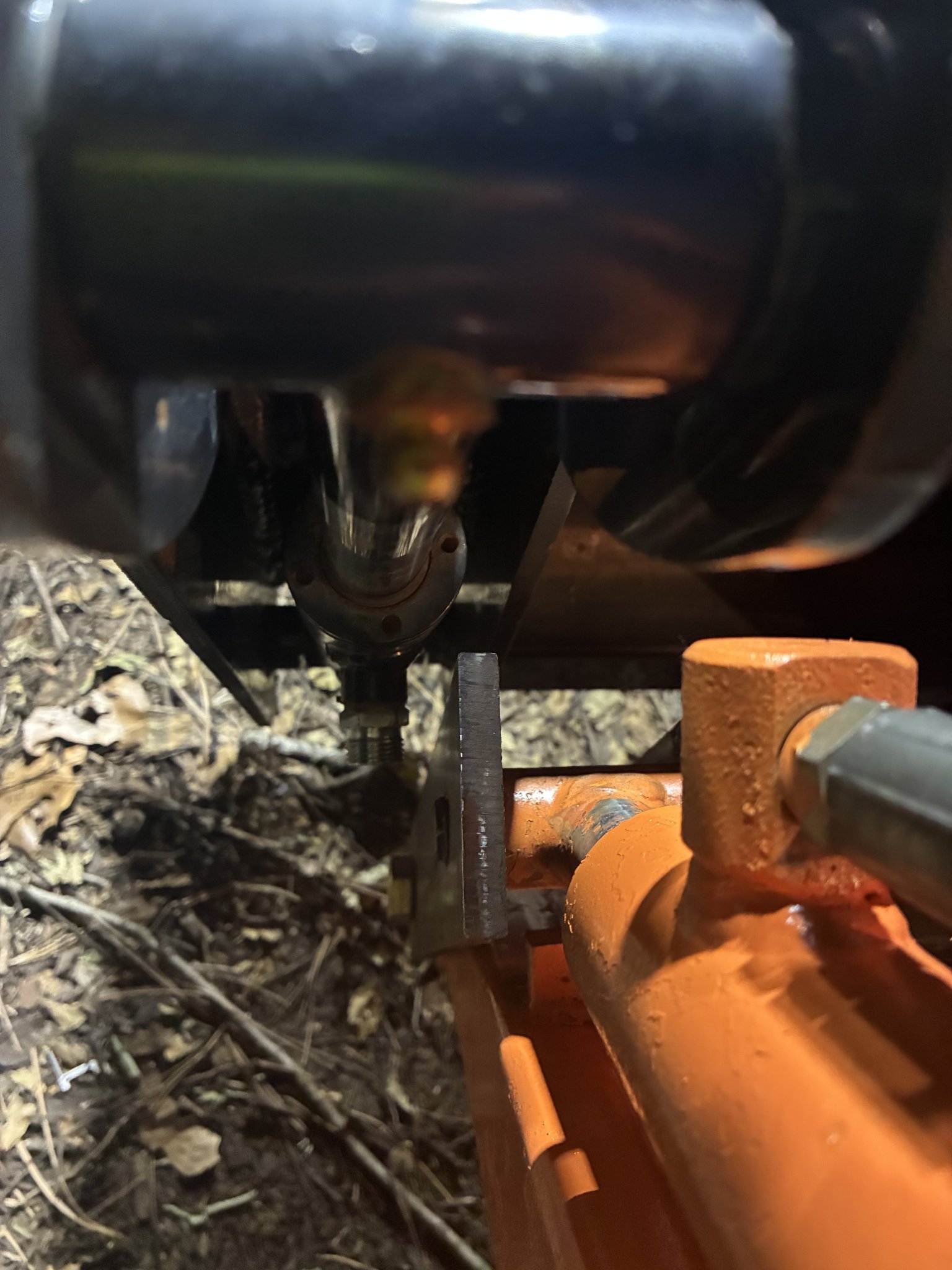

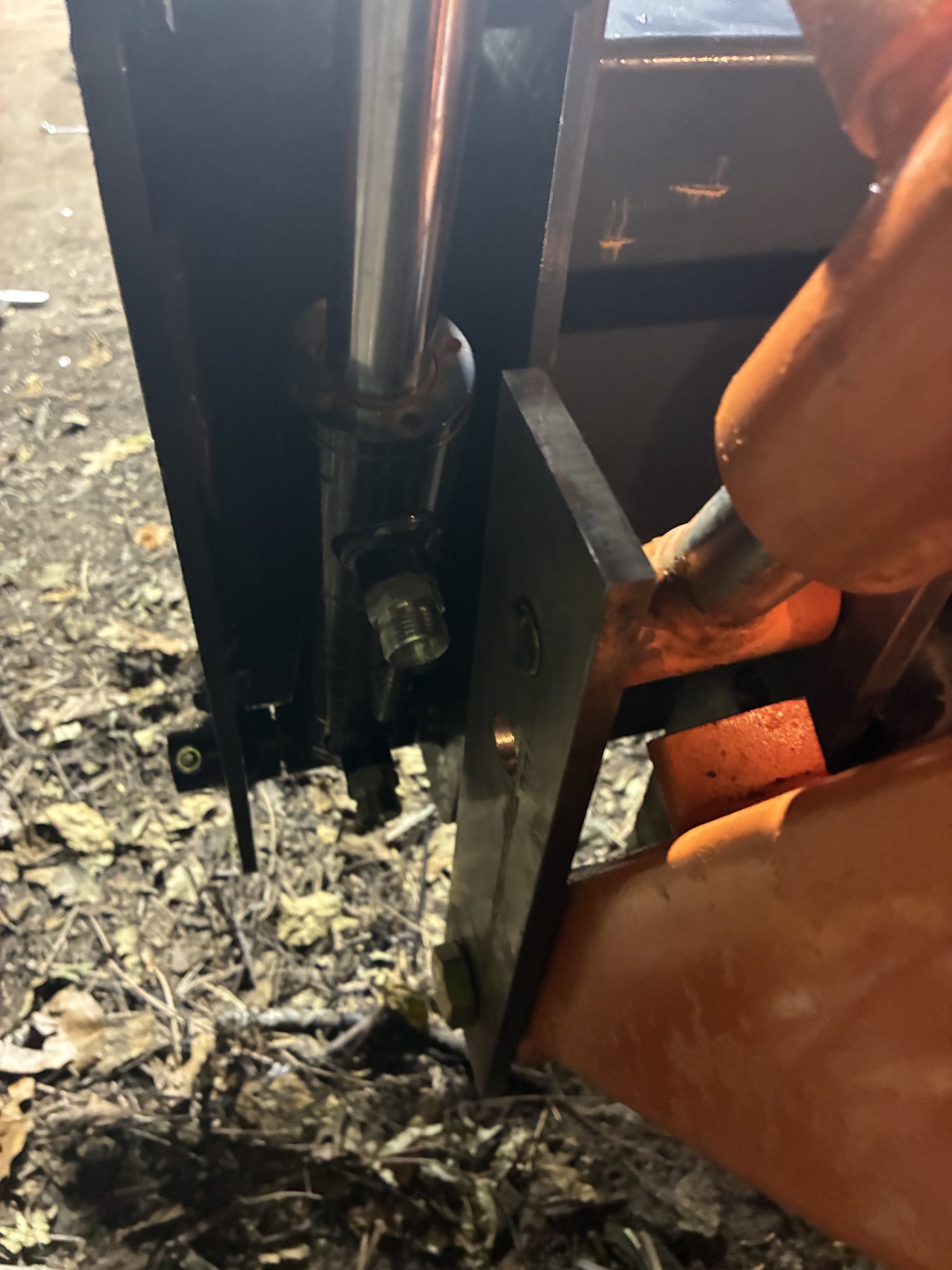

Here is the issue. My brackets only havr about a 1/2 inch clearance to the bucket hydraulic cylinders. I had to take the hoses off because they were mounted in the way and hose too short to move. Y
U can see in these pics... not sure what to do here. Any suggestions? Anyone following this thread even lol? IMG_5119.jpeg IMG_5118.jpeg
MOOTS
MX6000
Jun 27, 2019
2,232
2,850
Canton, Georgia
I’m following. Those cross bars may have to come back forward to give that hydraulic fitting room.
I never thought about the cylinders interfering with loader.

Yea didnt ser that coming either. Just have to work around it somehow. Can i turn this cylinder clockwise as you are looking at this pic 180 degrees? Should work the same i thThat might help me image.jpg
MOOTS
MX6000
Jun 27, 2019
2,232
2,850
Canton, Georgia
Yea didnt ser that coming either. Just have to work around it somehow. Can i turn this cylinder clockwise as you are looking at this pic 180 degrees? Should work the same i thThat might help me View attachment 160254
Yes you can flip the cylinder. Just be aware the hoses will be moving as cylinder is opened/closed. Hopefully there is enough slack in them.
