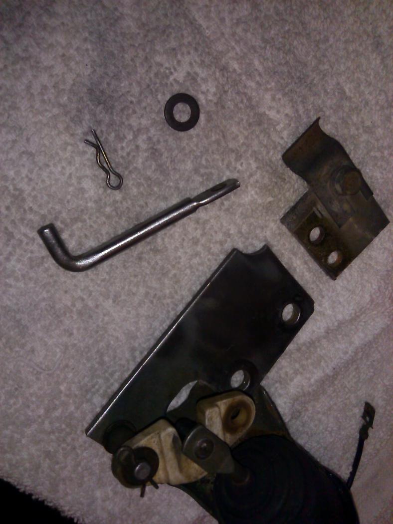

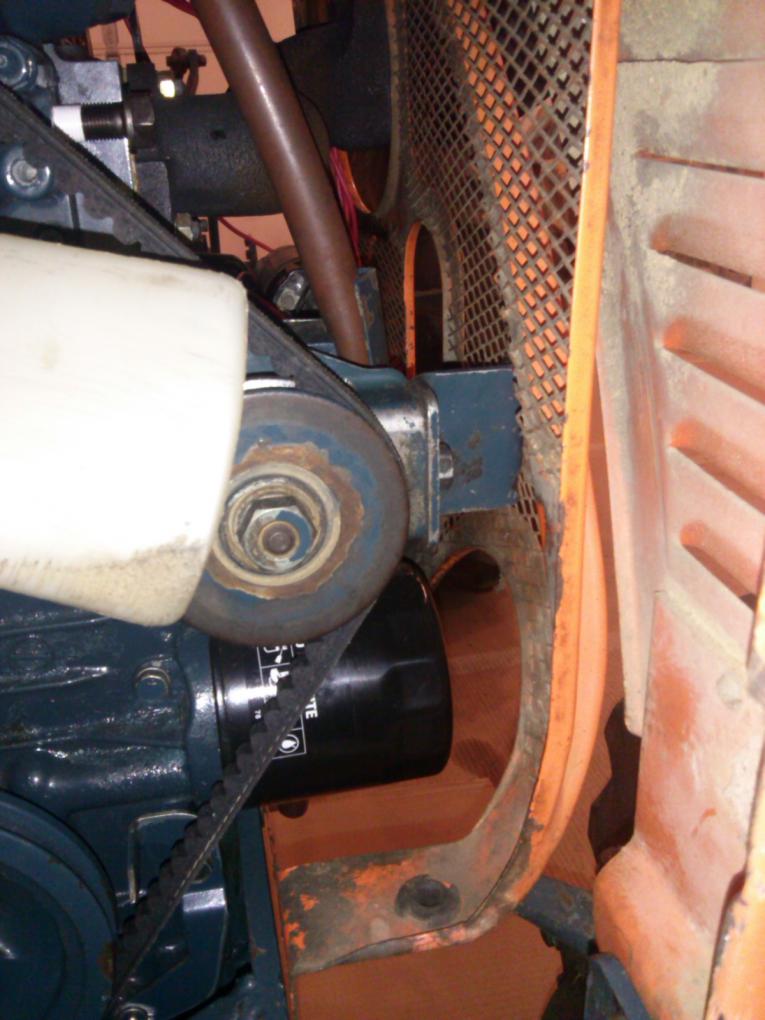

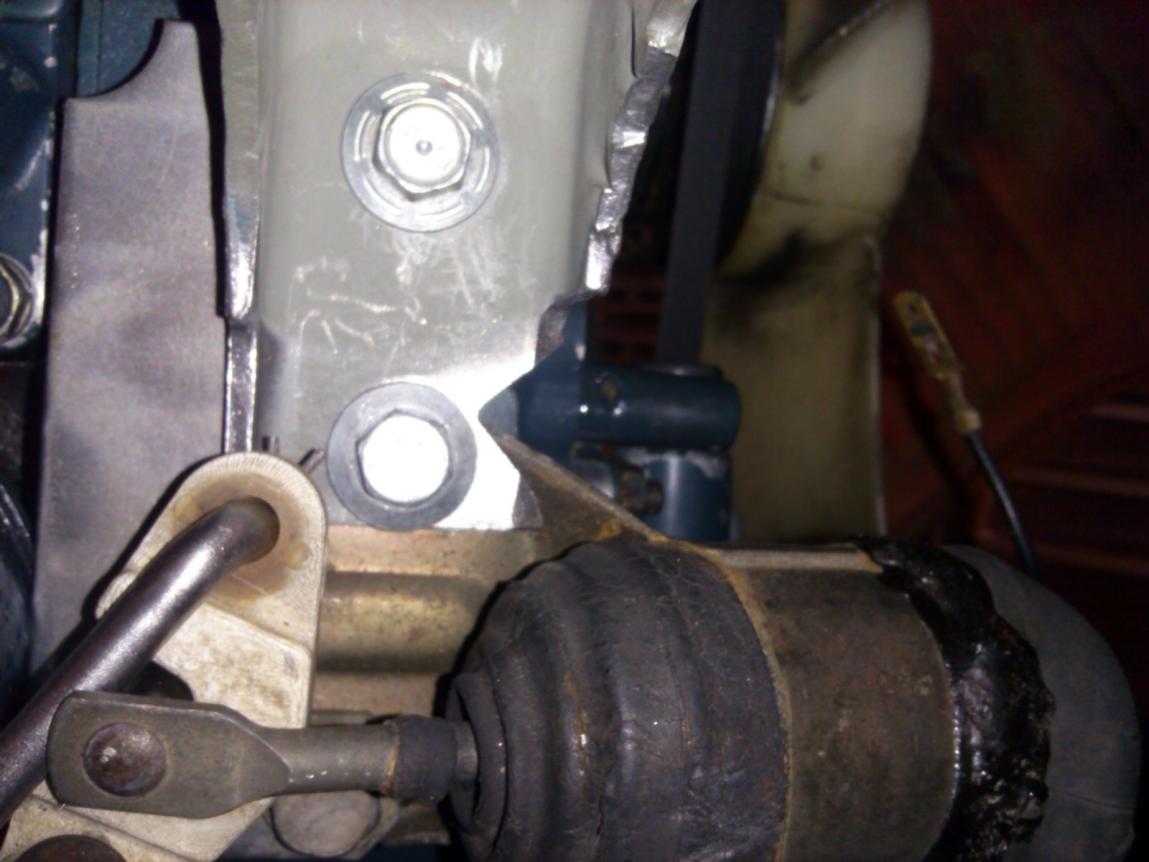

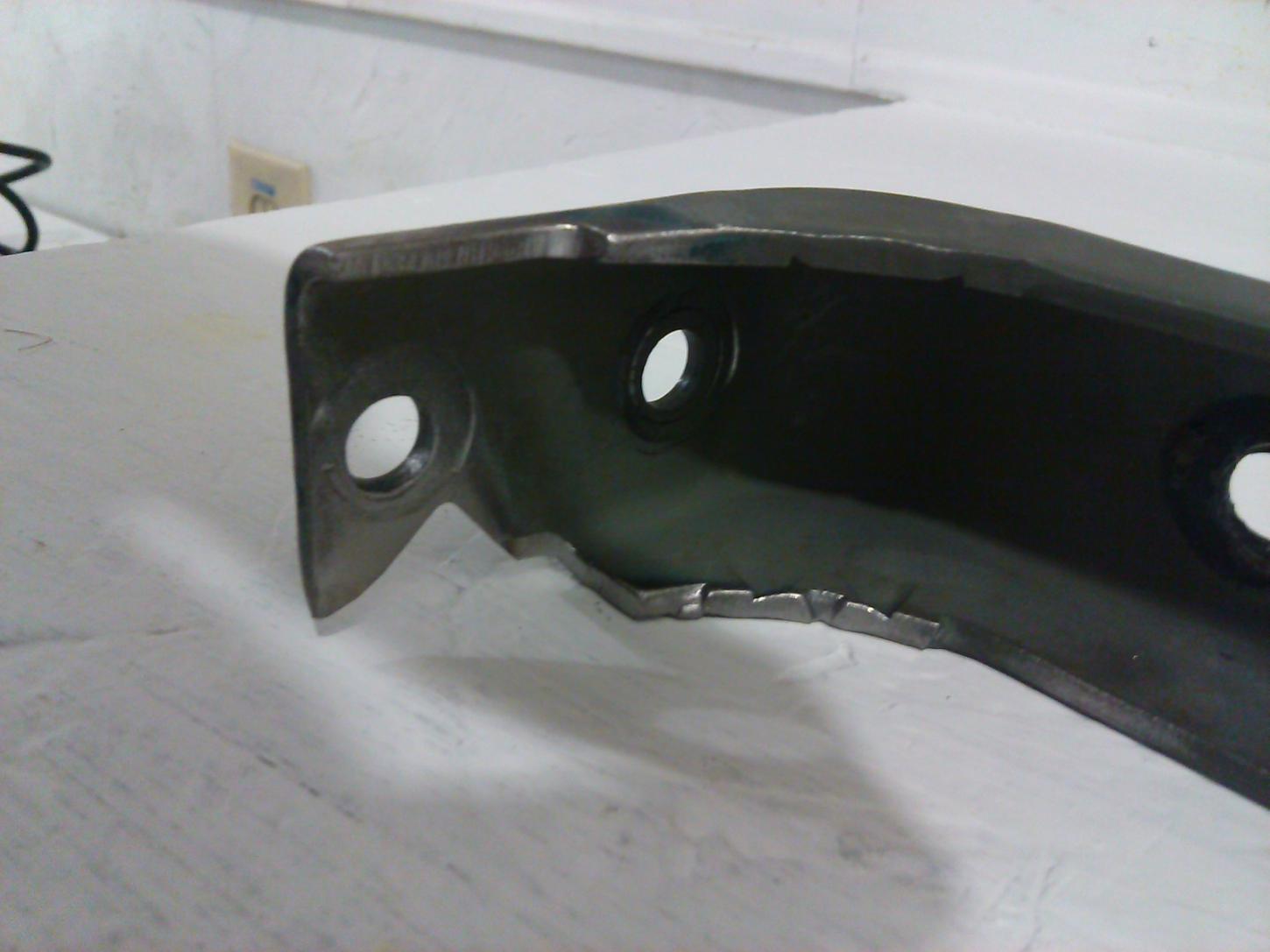

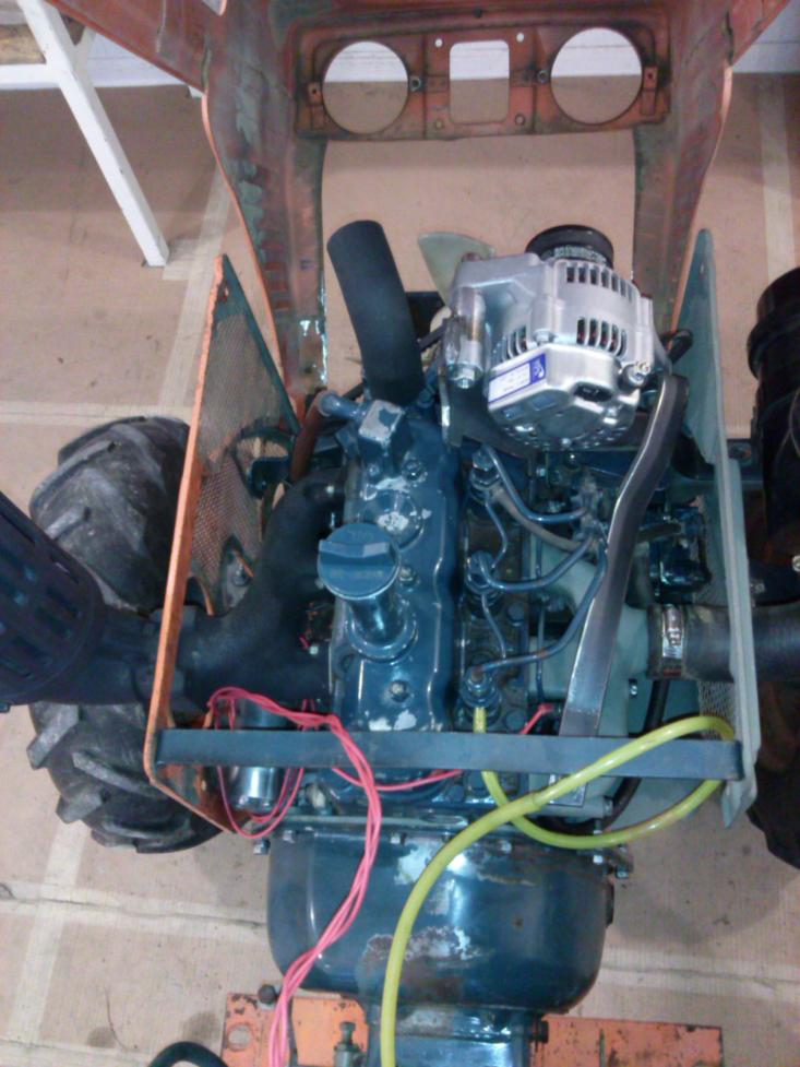

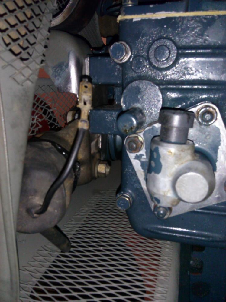

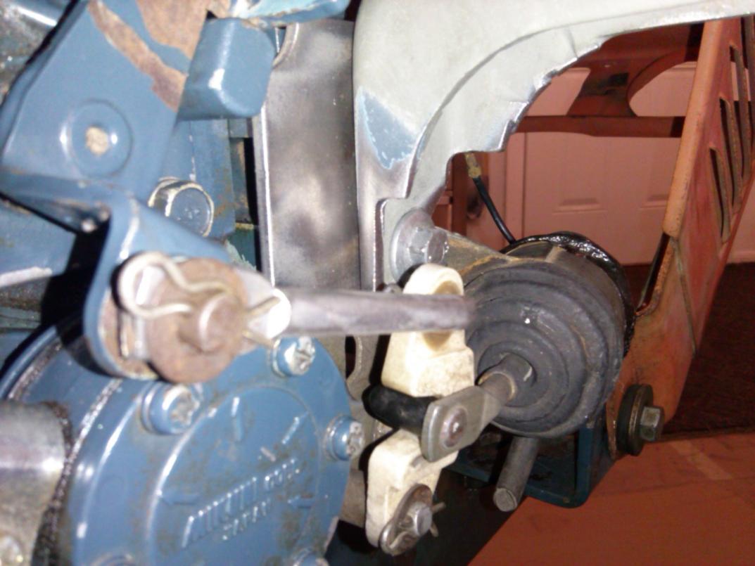

Got it, I removed the F2100 stop solenoid and bracket because of fitment issues, it just wouldn't allow the side panel to be installed without it being cut up and I was not about to do that.
I found one from a B1550 that could work with a few simple modifications and I was right.
All I had to do was shorten the B1550 bracket about 1-3/4 inches. I had to modify the air cleaner bracket so the stop solenoid could slide in behind it on the right side.
I put everything back together once again and put 12V to the solenoid. After a few minor adjustments the stop solenoid was working perfectly. The engine side panel went on without any issue at all.

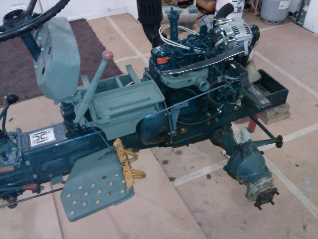

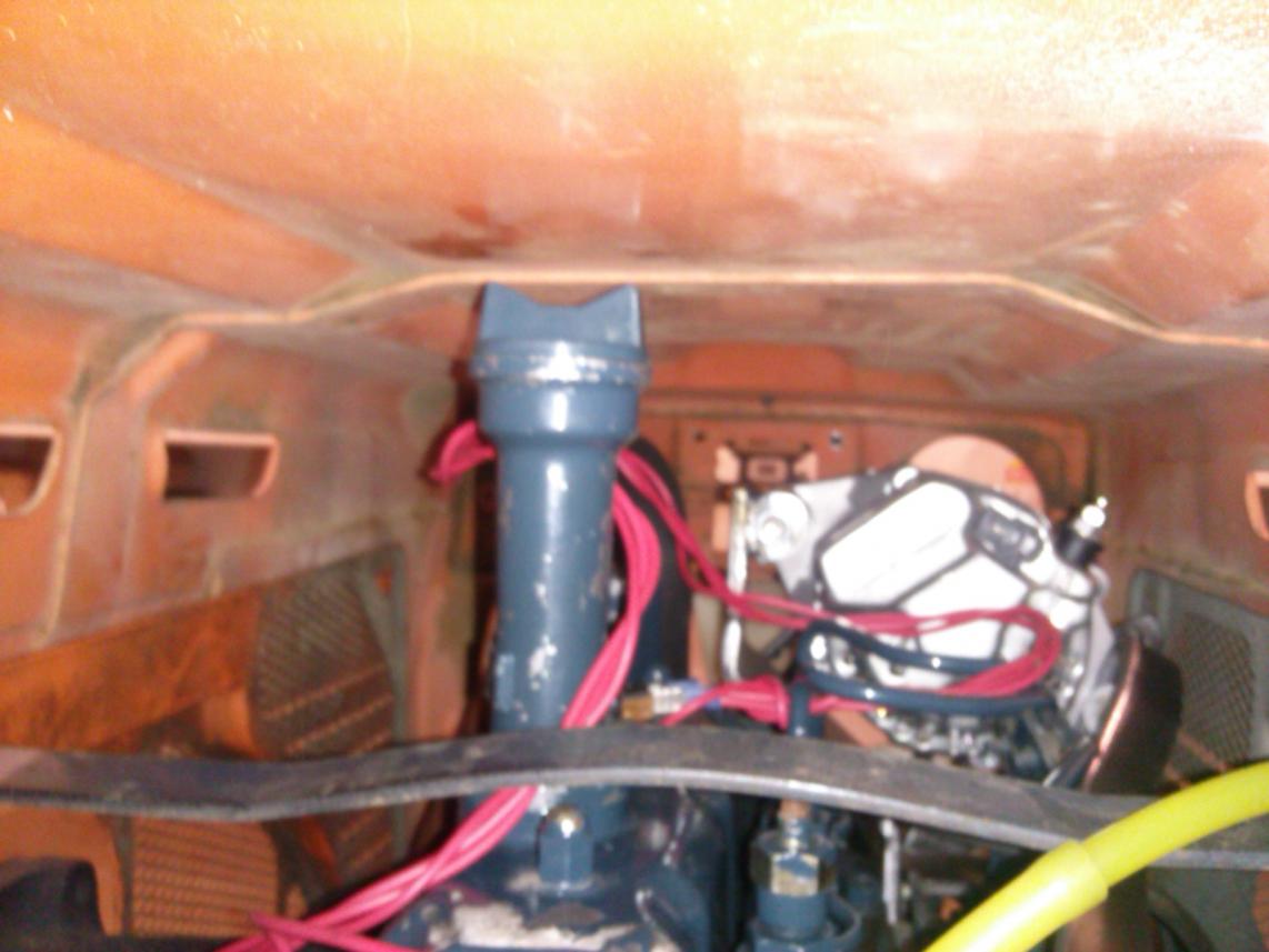

Got going on the new wiring harness over the weekend. Since I'm adding additional gauges and some extra LED lighting I decided to go with a fuse box instead of the single inline fuses. I'll have to find one that's weather resistant. Not much I can do on that part for now.

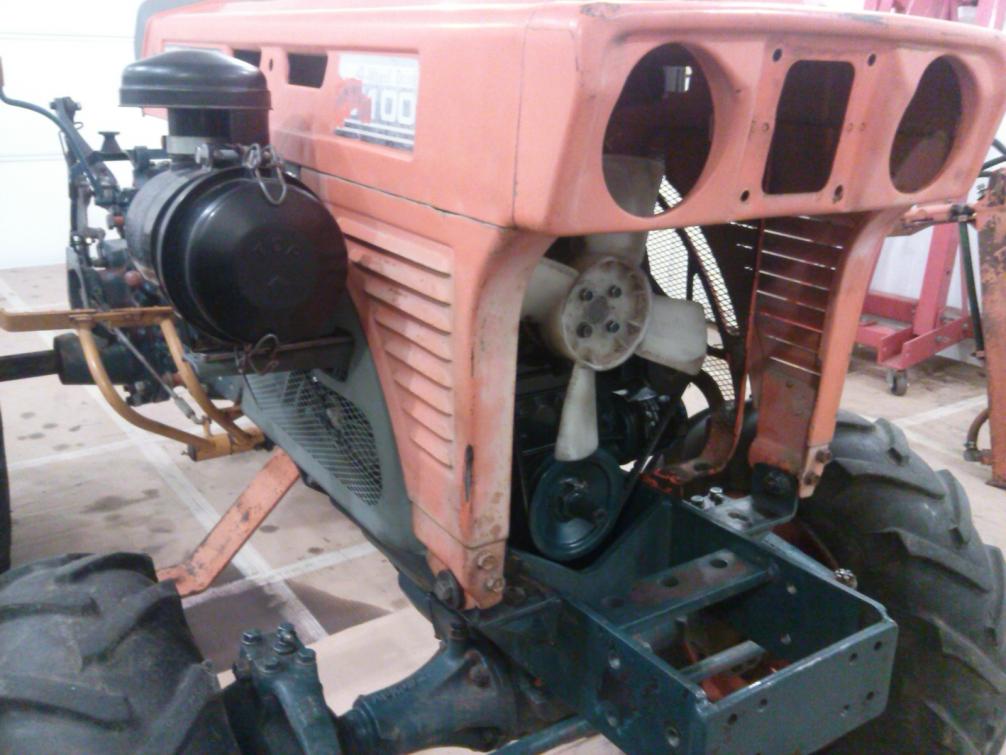

I've got the wheels off so I can begin prep work on the chassis. I hope to have it painted and some parts back on within the next couple of weeks. Since this is not going to be a show piece I've decided to use Rustoleum night tide gloss on the chassis. My dad will use the spray gun on the fenders, hood and all other sheet metal that gets painted orange.
Here's where I'm at right now and a long way to go.....................................

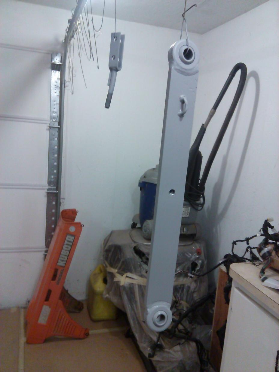

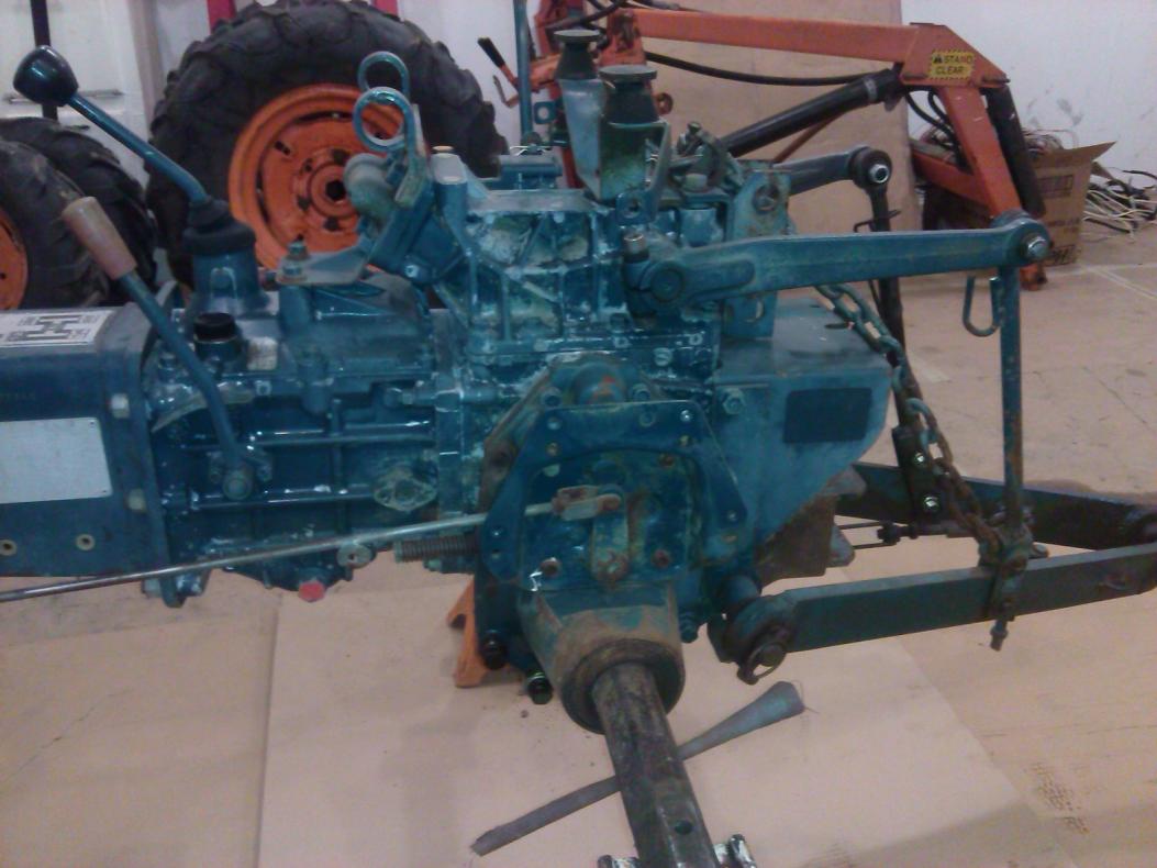

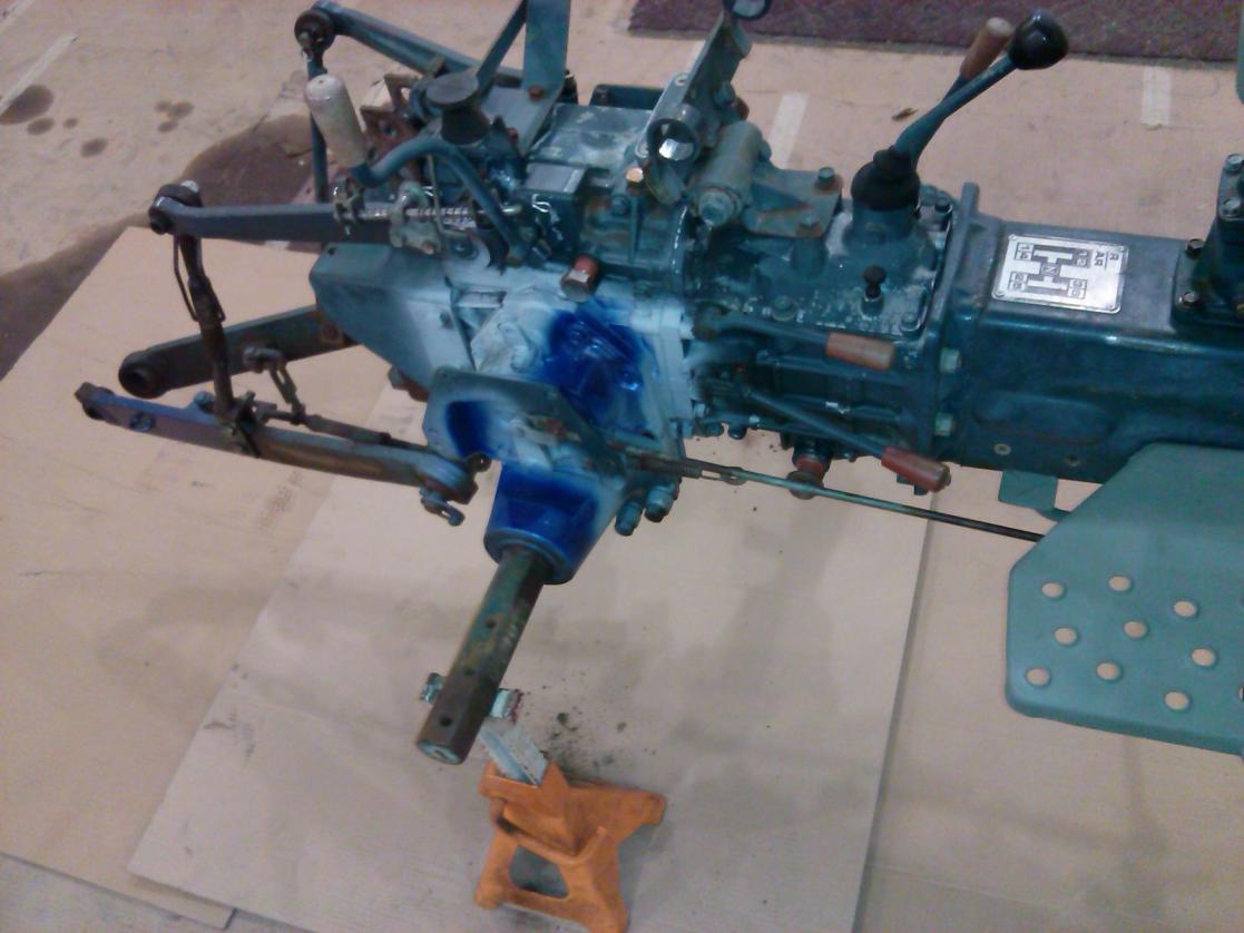

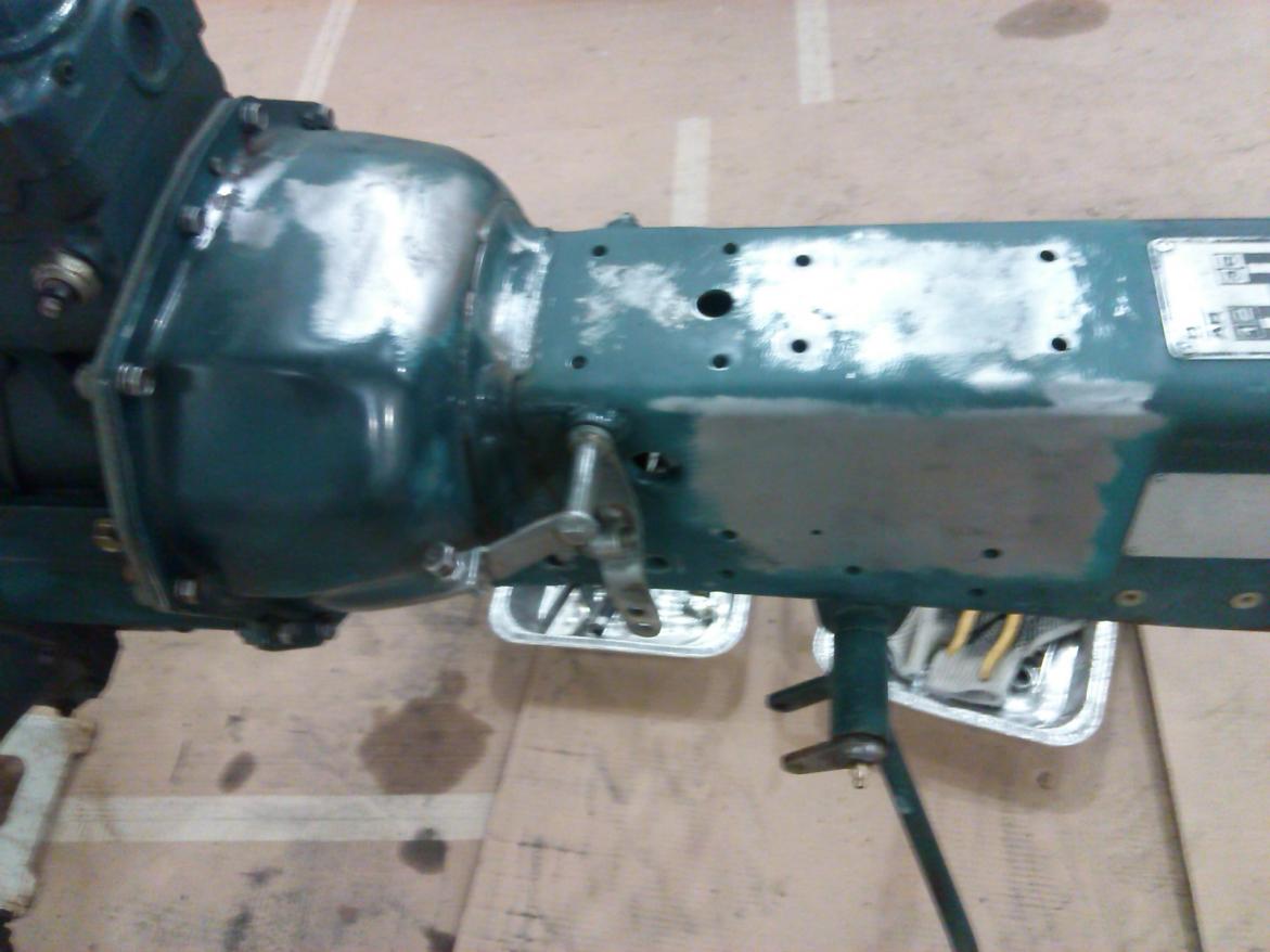

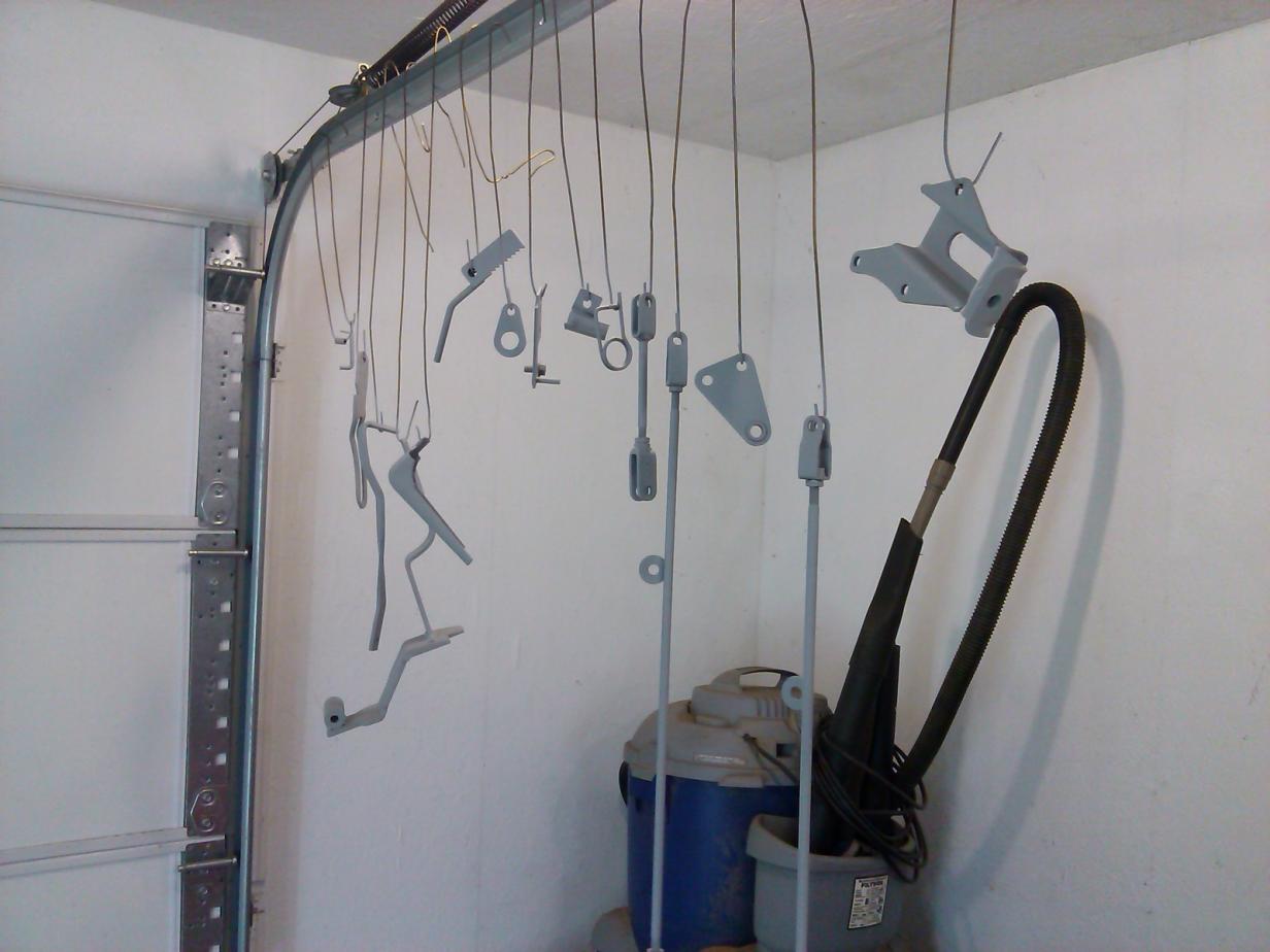

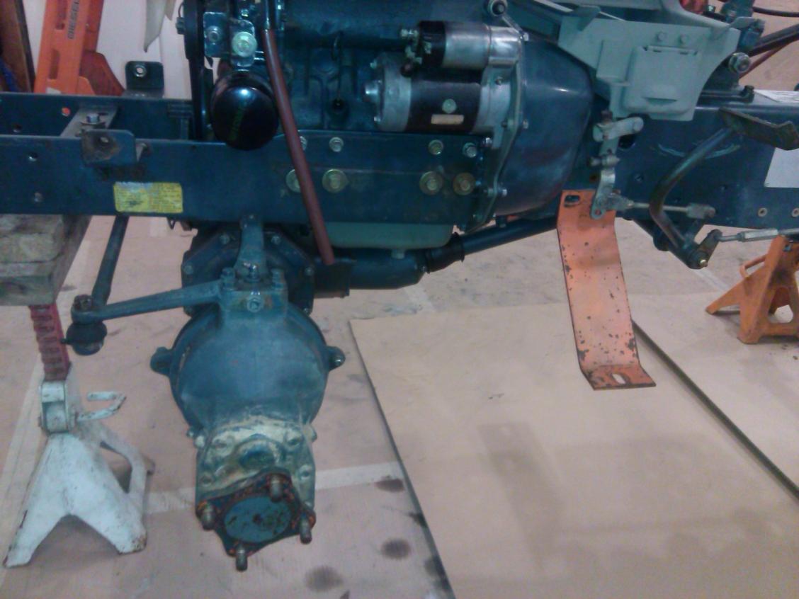

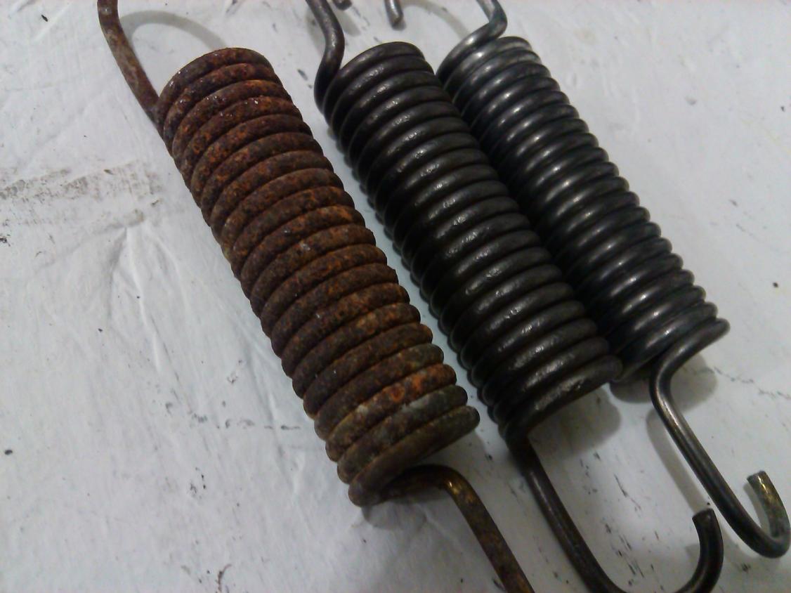

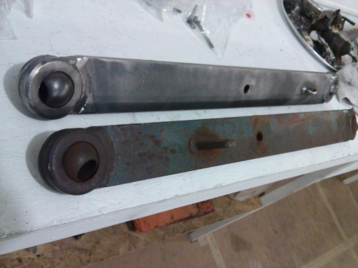

This so called prep work sure is time consuming. I've sanded, cleaned and primed for 11 hours today and only got 9 parts done. I spent a few hours last night doing prep work on the chassis.
I removed the brake and clutch rods to give me more space to work with. There was too much surface rust on the rear PTO arms so I removed them. Tomorrow I'll remove the clutch and brake pedals a long with the rear PTO shield.
I've got a friend who is going to help me out with prep work on the chassis tomorrow while I continue working on the smaller parts that have already been removed.
Im appreciative of all the replies and suggestions concerning the painting process. I know that a rattle can paint job will not be as good or last as long as the dealer supplied paint would but I also know that this tractor is going to get a ton of scratches the first time I drive it out in the back forty to push down small trees and large amounts of under brush. In fact, I have absolutely no intent to put any of my new decals on this time because I know I'm gonna work the heck out of this thing once its up and going so why not save those hard to find decals and good paint till next time.
The only reason I've gone this far with prep work is to get rid of the heavy surface rust, in the end its still going to look and run a thousand times better than it did when I bought it.
Here's today's progress.............................
