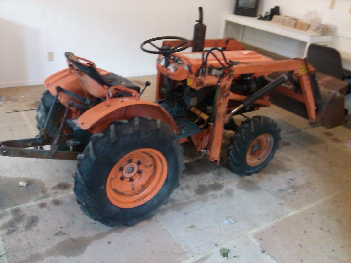

I've had the B7100 for about 6 days now and this is what i know about it.
It has the d750 3 cylinder and it has the flu. I bought the tractor knowing first hand that the engine would most likely need a complete rebuild but now I'm not so certain a rebuild is needed. The engine fires right up cold or at normal operating temp. However the problem I have is heavy white smoke when the engine is cold but after running for 15 minutes or more the smoke is less but not gone and its making a knocking sound that it shouldn't be doing.
The knocking sound is from the top end so i removed the valve cover to inspect. All valves are moving freely and the rockers feel fine but I'll check with a feeler guage anyway, nothing binding up there that I can see for now.
The middle injector is leaking, not too bad but bad enough to make me believe that all 3 injectors need to be rebuilt and are most likely causing the heavy smoke and i am currently working on getting them removed.
There's hardly any blow-by and I mean very minimal. I did turn the engine over with the valve cover off kind of expecting smoke to come up through the valves or crankcase but to my surprise there was none, nothing at all.
When I get the injectors out I will do a compression test on all 3 cylinders to rule out worn rings and of course a cracked head/head gasket.
Am I kind of heading in the right direction thinking that the injectors are my problem?

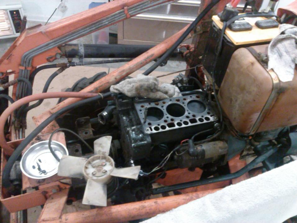

Just a quick update and a sigh of relief. The compression test I did last night was incorrect and it was completely my fault. Its kind of embarrassing to mention what I did but I'm going to anyway.
I dropped off the injectors at our local diesel shop. The guy will call me when he finds out the condition of the injectors. I told him if they are rebuildable to go ahead and do the job and I left.
While at work today I called a Kubota dealer and ordered a new head gasket and shim, new valve cover gasket, 12 copper crush washers and a new cable for the decompression control. Parts should be here mid next week.
Now back to the compression test results. Its kind of hard to get accurate readings with the intake completely blocked off wouldn't you think?.
Well as I was preparing to clean up around the engine so I could pull the head off this evening there it was hiding in the intake manifold, a rag that I had stuffed in the intake and taped up to prevent any debris from getting in there while I removed the side panel that was full of junk.
So I thought I'd do one more compression test just to see if the numbers would change after I removed the rag i had stuffed in there. And here are the results,
#1) 400
#2) 390
#3). 395
Going to cover the engine, wait for my injectors to be rebuilt and just clean up the tractor in the mean time. Old fuel is drained and the tank looks clean so I'm not going to take it off.

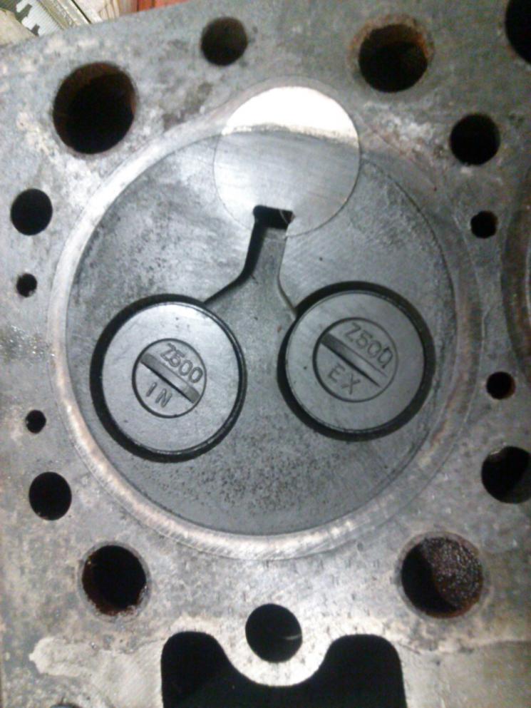

I had a bad feeling something was wrong internally and its not good. I installed the rebuilt injectors this afternoon, bled the lines and fired up the engine. It was running about the same as before and the knock or light tapping I could hear was still present.
So long story short I pulled everything apart again and removed the cylinder head. What I found was not good but I kind of expected something was amiss in there.
# 1 cylinder is OK.
# 3 cylinder is OK.
Cylinder head looks very good, kind of dirty but I can't find any traces of cracks between valves on any cylinder. Push rods are perfect, no sticky valves and none seem to be bent and they operate smoothly.
Now # 2 cylinder is where I believe the problem is. I think this is called piston slap. The piston is actually hitting the cylinder head. This would be the tap I hear and not an injector as I hoped it would be.
While I was cleaning up the piston top on cylinder # 2 it moved down, not by much but enough for me to notice though. The oil pan is coming off and there's no way around it.
when you say it moved down.......you are saying that the crank DID not move.........connecting rod bearings shot?????:( as you said - pulling the pan and then a rod cap.............tell us what you find

Hopin its not serious,not sure if its called piston slap-usually is from a wall to skirt thing. Best case is no damage to crank. Even a piston/rod cant be all that bad to replace

No, crank did not move, only the piston moved down.
Pistons are tight in the cylinders so its got to be the rod bearing.

I'm with Tooljunkie, I always thought piston slap was side contact. Sounds like a bad bearing or other slop on one end of the rod or the other.

could be in the piston pin, hope not. Damn - that bites having to remove all of that to get the pan off.:mad:

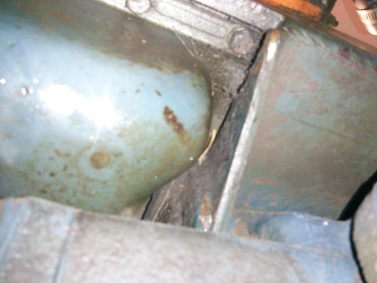

The tractor is up on jack stands for now. I think the oil pan can be removed without taking the front loader and sub frame off. My service manual is not here yet and I don't know if there are hidden pan bolts at the front of the engine.
Even if I did remove the front loader it wouldn't help getting at the front pan bolts as they are hidden by a steel plate surrounding the engine.
I hope the engine does NOT need to be removed to get the oil pan off or is that why the front loader needs to be removed so the front sub frame can be removed as well?
