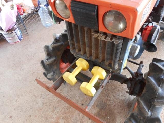

I'm in serious need of some weight on the front after doing some wheelies trying to test my tiller. What is a good price for suitcase weights? I found these at the MIL's house but don't think they'll work:rolleyes:

How about a square 2x6 form, drill through holes, couple pieces of rebar and a few sacks of premix...trowel it off pretty, maybe some orange cement die

Sounds too permanent to me.....and too heavy to easily remove. Whatever I do it will of course be ORANGE!;)

I had a piece of 1" thick flat stock that was 2'x2'. had it cut in half and notched to fit in where the suitcase weights go. Added right around 150lbs to the front.

Go back to the scrap yard and look for some cast iron scrap and bolt it on. ;)
