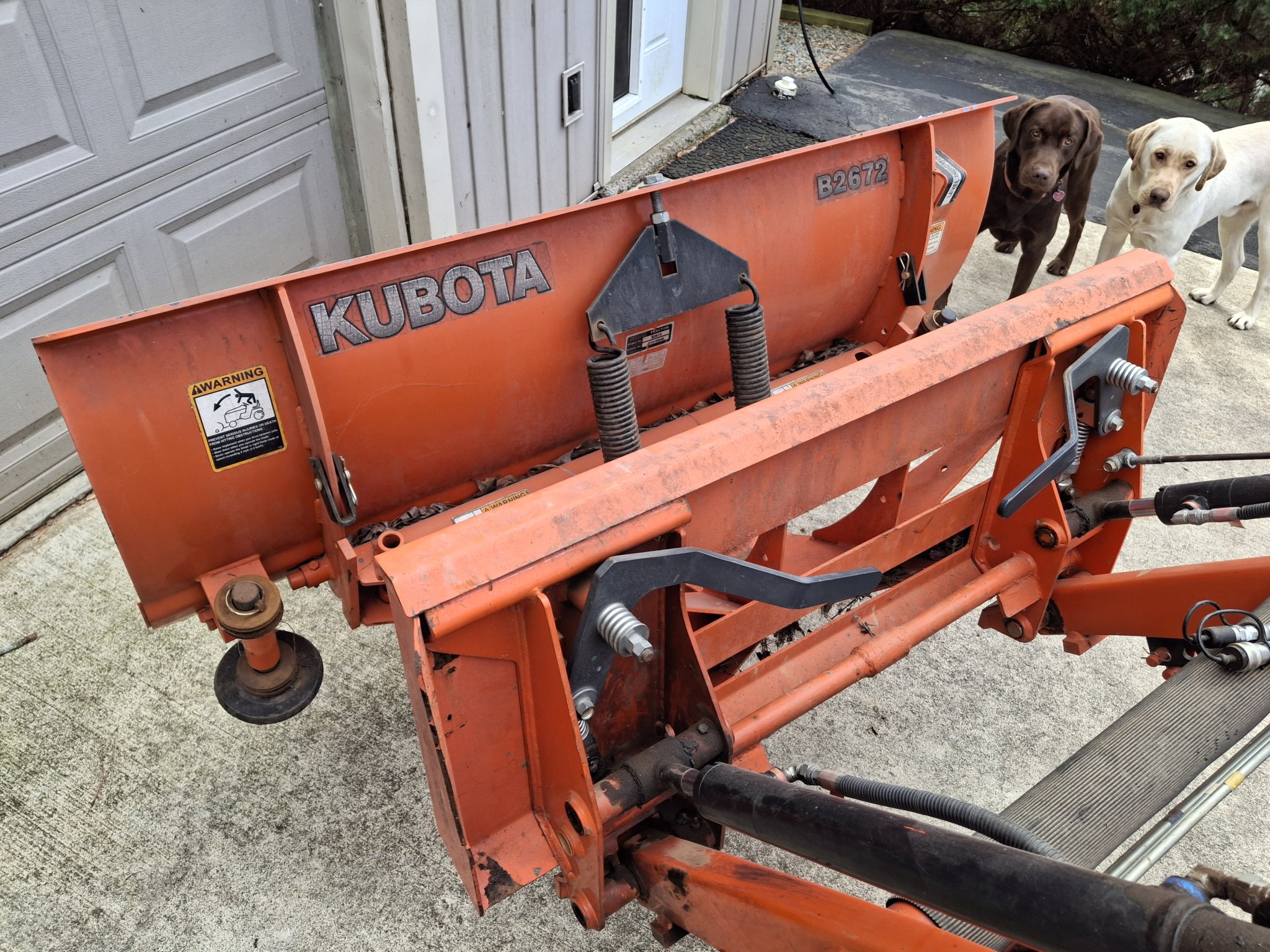

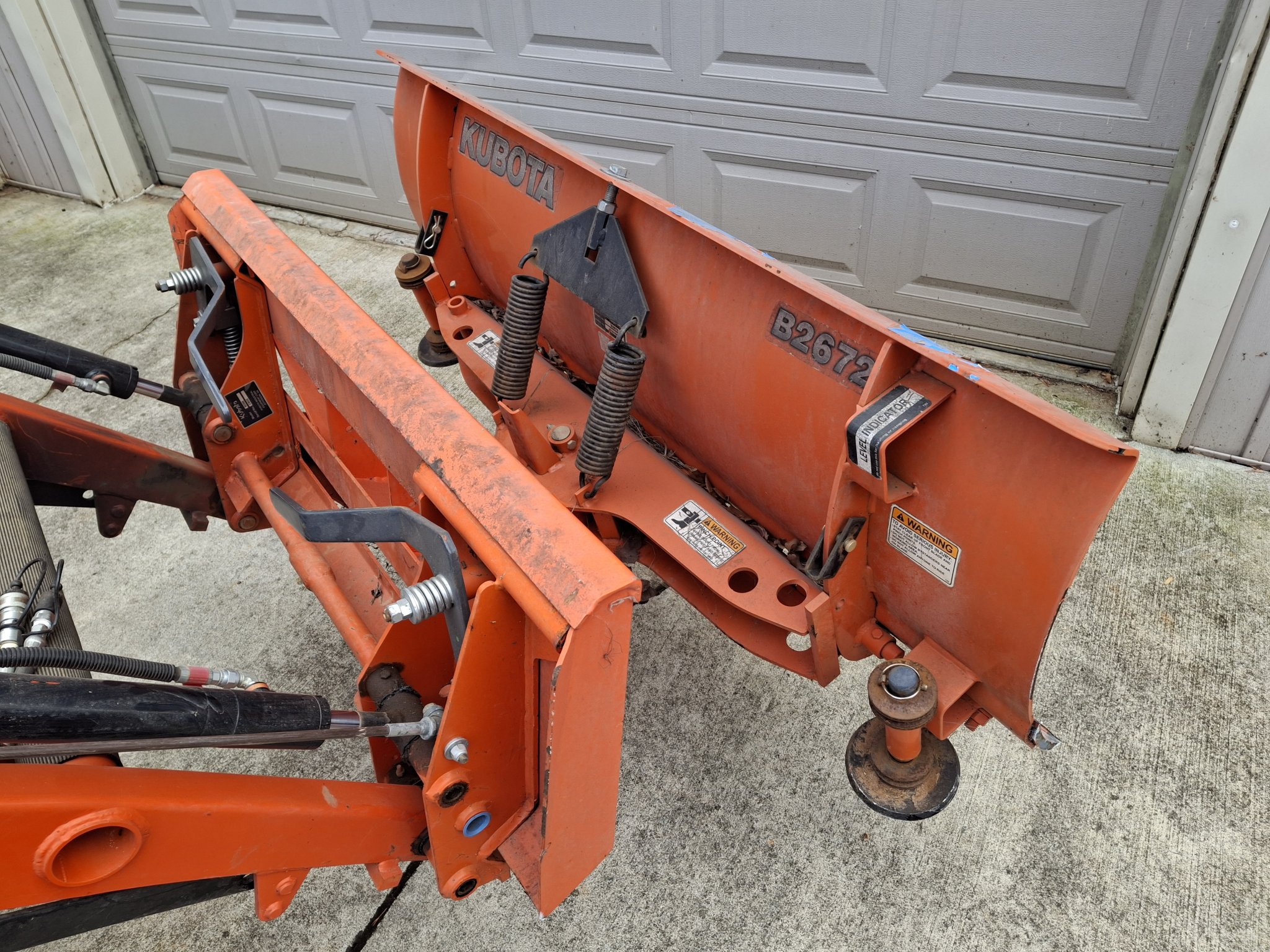

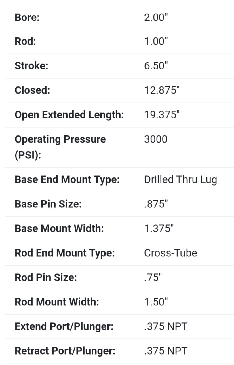

I got the B2672 front blade carted out to the farm yesterday and all hooked up.
I did all the measuring and calculating for the addition of hydraulics and with a close match on retracted/extended lengths and stroke on a Magister cylinder, I am thinking I can get this done for under $300 DIY style.

Magister got back to me with answers to all my questions on that cylinder so I decided to go ahead and pull the trigger. Orders were placed. now, I wait...
The cylinder from magister is $132 and the hoses and fittings from DHH are $110. I will still need some 3/4-to-7/8 bushings for the blade-side pin, but these are under $20 at Amazon. I got two long 3/4in diameter steel pins at Tractor Supply yesterday for $25.
So for right under $300, I should have front hydraulics added to this B2672 blade plus I'll have fun with my metal fab and welding tools in the process. I will document and post a bit of the process here when I am done in case others later on are searching the forum to find a similar solution.

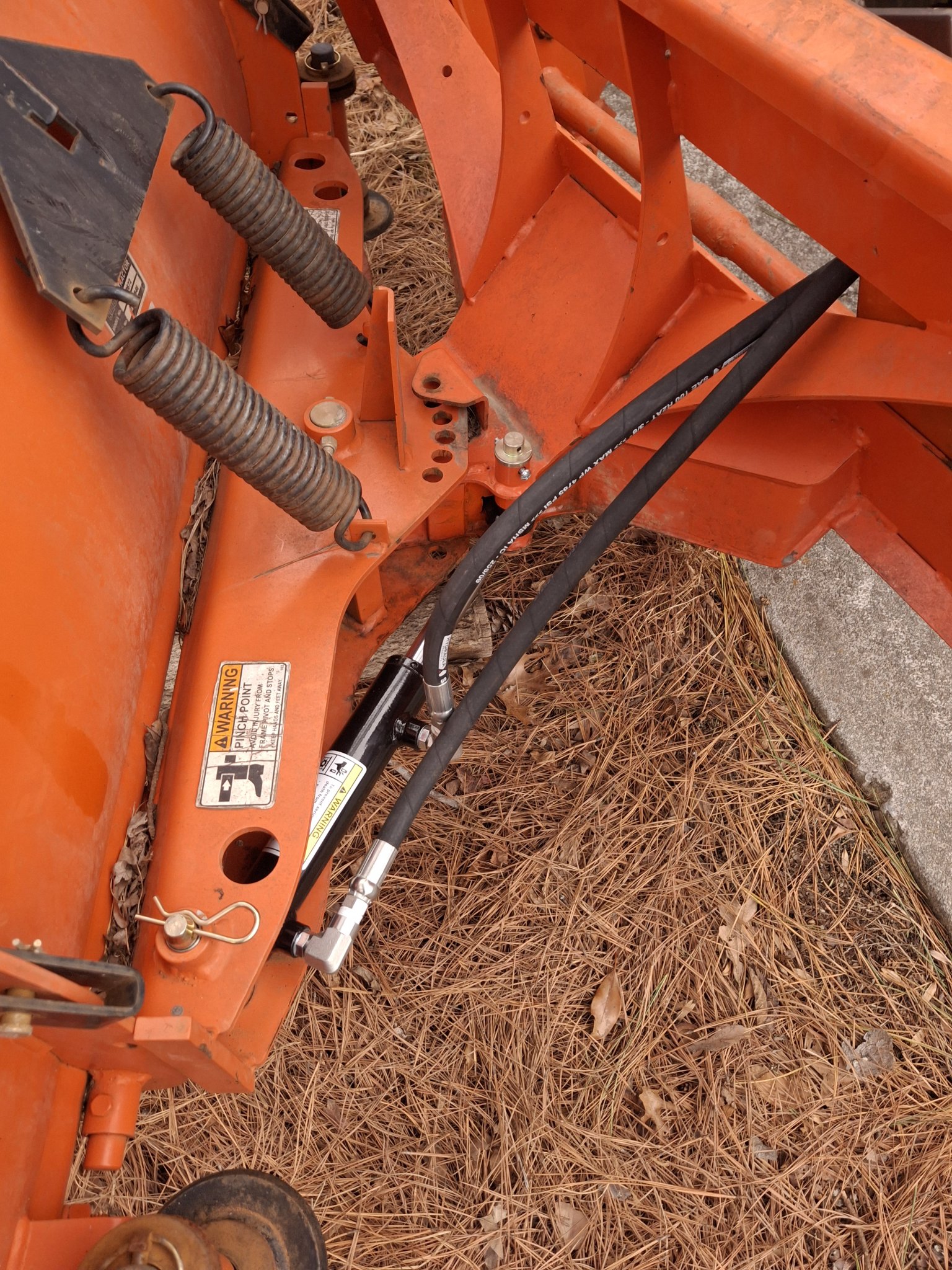

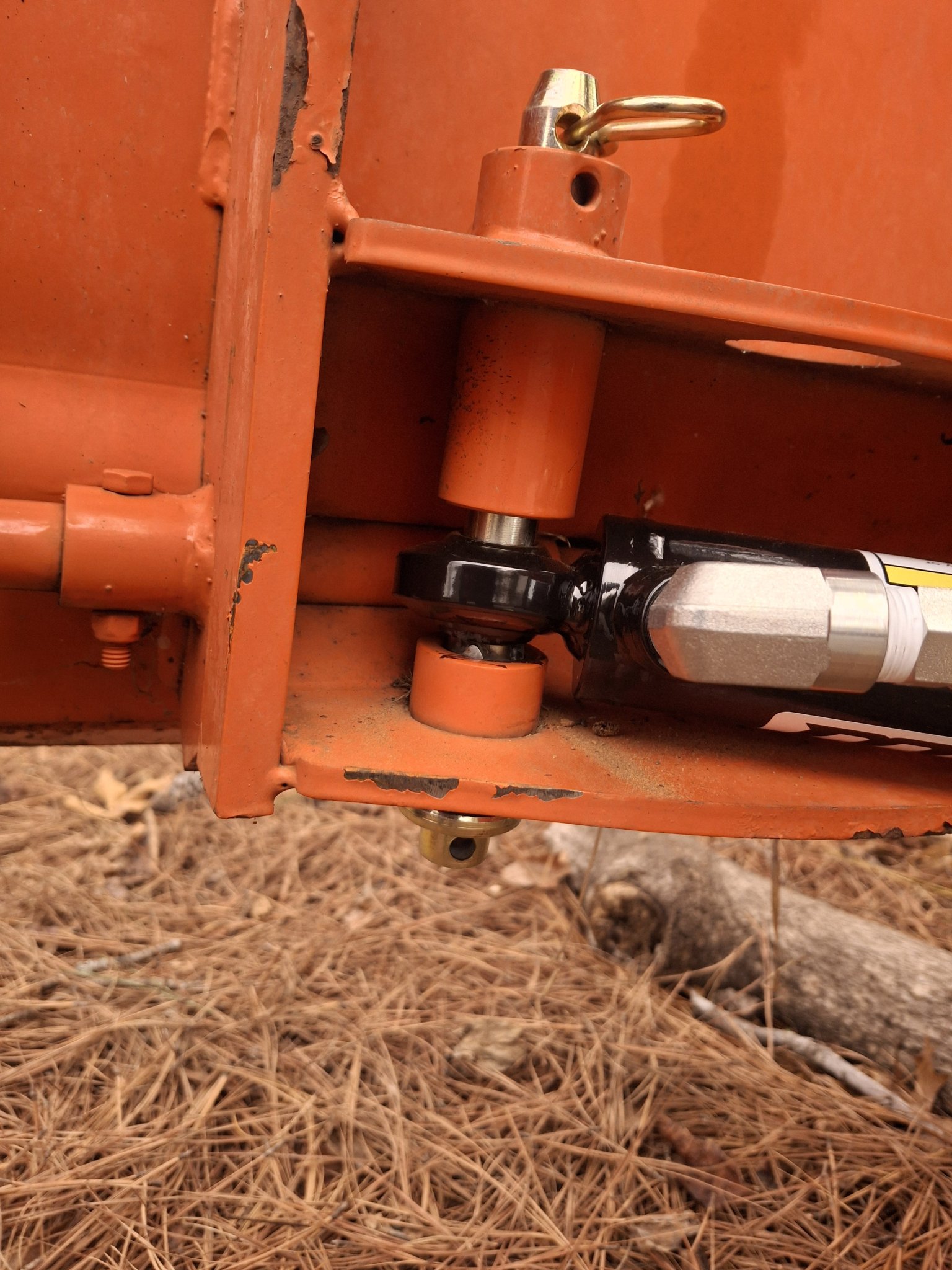

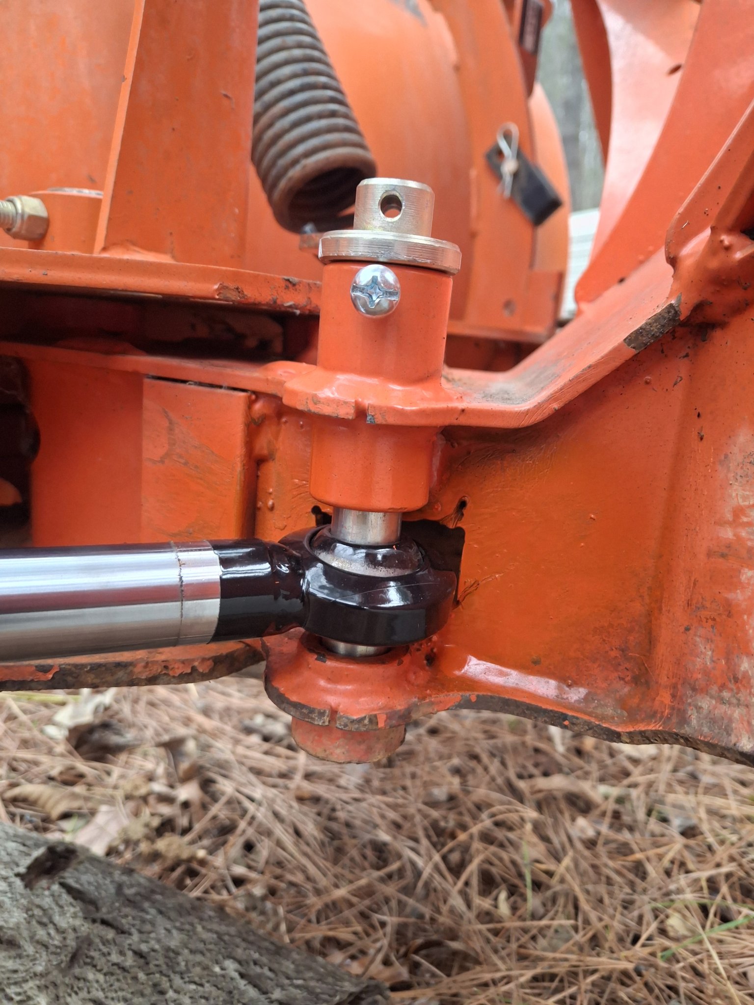

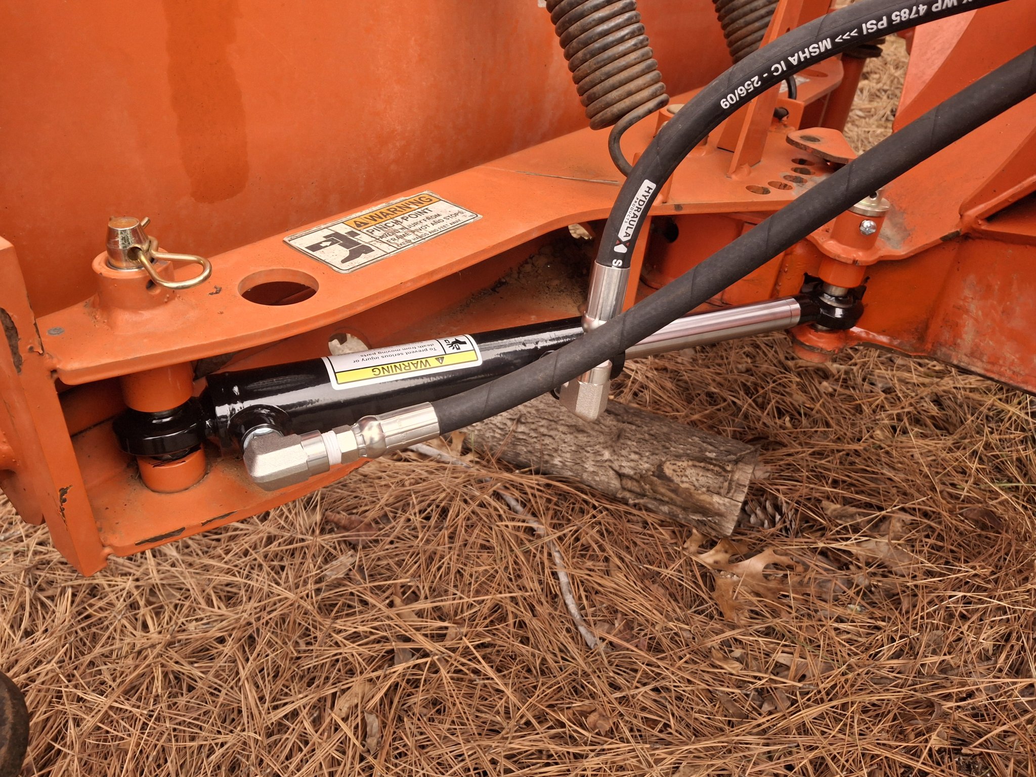

About two hours of work. Went way easier than expected.
20251221_124829.jpg 20251221_124836.jpg 20251221_124841.jpg 20251221_124850.jpg

Me too - that working loop is a little tight.
I wish someone would have told me that about my top link plumbing, I learned the hard way when it kept working loose and leaking (different from this plow situation). Replacement Top Link hoses just came in so those will go on shortly with the replacement for the Summit DPOCV for the side link (what a mess that "kit" has all been).

Looks good - all off the shelf parts.. I would have thought more like 30 minutes. What size cylinder?
Ha. I could have gone faster but I was going slow, measuring twice, and decidedly overthinking it all. But that's how I roll
Cylinder linked below. As stated earlier in this thread, its not an exact match but it is real close. Different rod ends forced some customization but it all worked out.
Hoses are not too tight as to allow full right/left motion with still some excess slack. I suspect the location of the ports on my cylinder and the 90deg swivel fittings allowed for simpler hose routing. Ill keep an eye on it and lengthen if needed.
To be honest... I get little snow here. The tractor and implements reside at a rural property we will retire to in the near future. So I would not even have to plow if it snowed. That may change when we live here fulltime but for now, I fell into a screaming deal on a pristine front blade that in turn provided me a fun project that made the blade even more useful.
