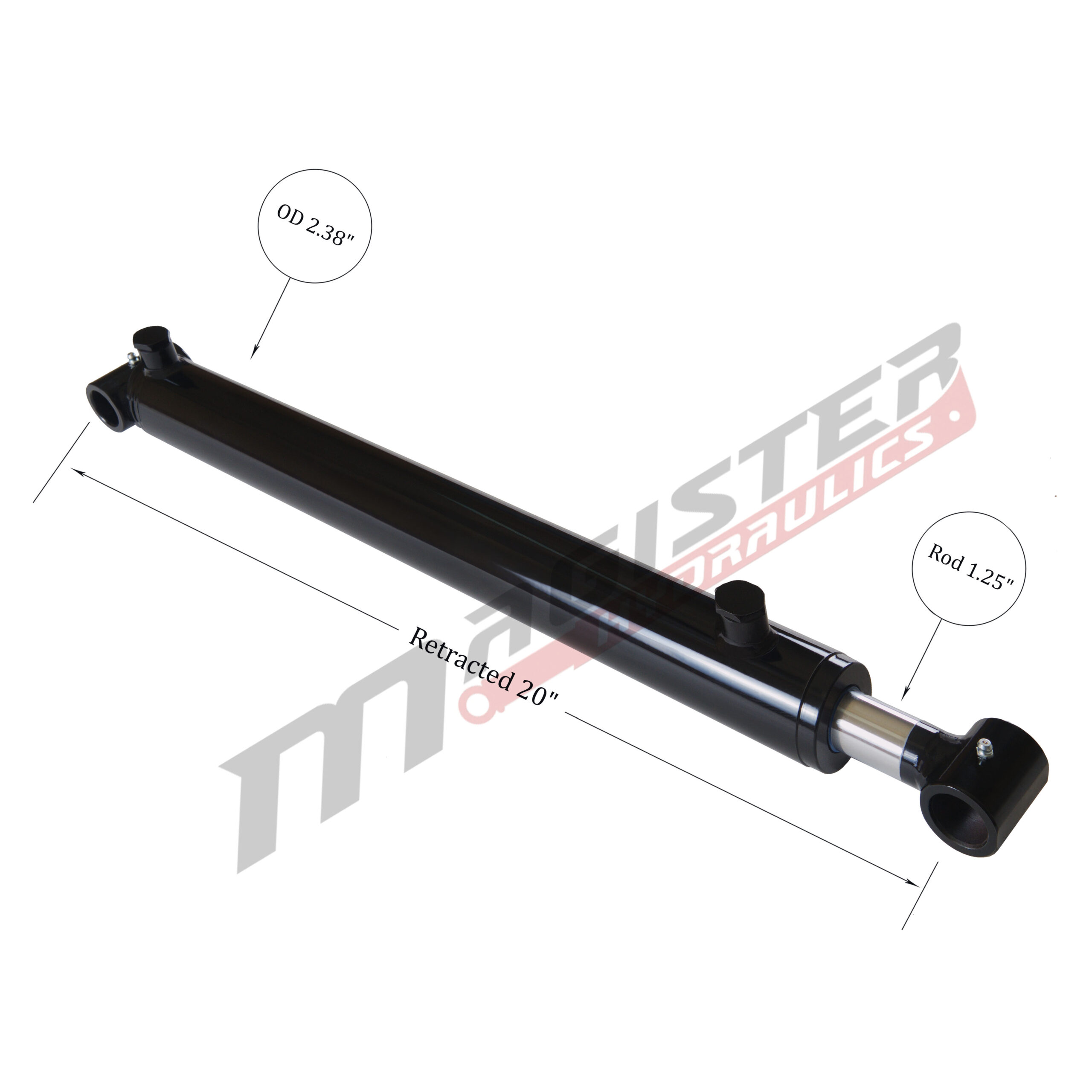

Baily Hydraulics: Nothing close in 1-3/4" bore.
Magister Hydraulics: 1.75" bore x 14" stroke loader hydraulic cylinder (2): $384
Cut/Weld/Polish rods (2): $200
Longer Hoses (2): $80 (+$20 S/H, but I need hoses for something else so I'm not counting that)
Extra Time/Travel (to get this all to happen): $100 (minimum, and it's likely 3x that nowadays to get anyone to do custom work)
Tax: $20
Total: $784 (S/H included) (maybe $984 if things go sideways)
HydrosPlus Lift+ HPBX300-BM for the Kubota BX (with longer hoses): $959
TTWT Discount: $-48
Shipping: $30
Total: $941
Difference: $941 - $783 = $158
If anything goes sideways with D-I-Y (like a weld breaking, needing bushings, spacers, or fittings, or just finding a shop who actually does the rod modification once they have the cylinders and manages to get them to the same length) I could easily burn through an additional $200 in time/parts, vs. just getting the job done in short order with HydrosPlus. I just had two plow cylinders re-ringed at $100 each, so an additional $200 in time/parts is realistic. Thinking about it, if a weld breaks and twists up the loader that would not be good (welding involves heat, heat causes stress and brittleness, with repetitive use that leads to breakage).
So, I just ordered the cylinders and hoses from HydrosPlus. I did learn a lot along the way so your and my time was invested and not wasted--thank you!

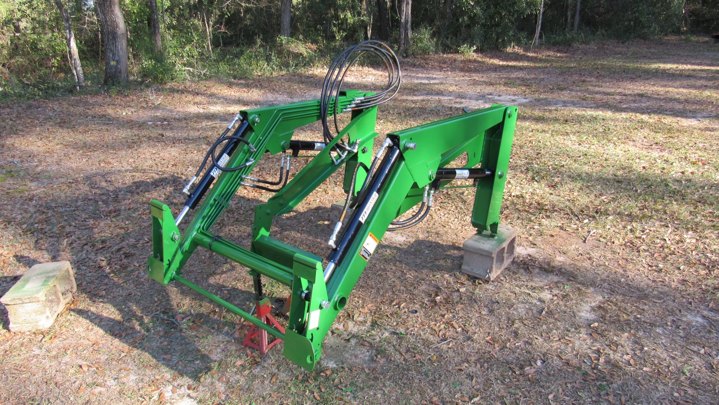

I put some 2x18 Magister cylinders on my John Deere 420 loader frame years ago. It took me to at least the weight capacity of the 430 loader which was an option for my tractor and I gained something like 20 inches if height which I am careful not to use. I had to trim a 1/8" off each side of the cross and added 1" stop collars on both sides of the rod end for spacers. The ports came out 90 degrees from the stock cylinders which was just adding some 90 degree adaptors for me but I was already having custom set of new hoses made. I bought the loader frame used and it was missing the curl cylinders so I just started from scratch on the rebuild.
Stock JD had put 1-1/2" lift cylinders and 1-3/4" curl cylinders on the 420 loaders.
My primary motive was the difference in cost being over $700 for JD cylinders vs a couple hundred for the Magister cylinders. The added lift capacity and slower response were both a plus in my book. I don't particularly care for how jerky and fast my Kubota loader is.
When deciding on using generic cylinders you need to make sure and get the same pin diameter and retracted length. You also have to consider the widths of both ends and if you have room to trim or add spacers to make up the differences. You can go a little over in cylinder bore and extended length but I would go over a 1/2" difference in bore. Practically all tractor loader cylinder ports exit to the sides and all the generic cylinders exit on top or bottom. As long as the hoses have a little extra room to reach you should be able to add 90 degree adaptors to get around that issue. Of course you can always have new hoses made and still save hundreds over factory cylinder costs.
