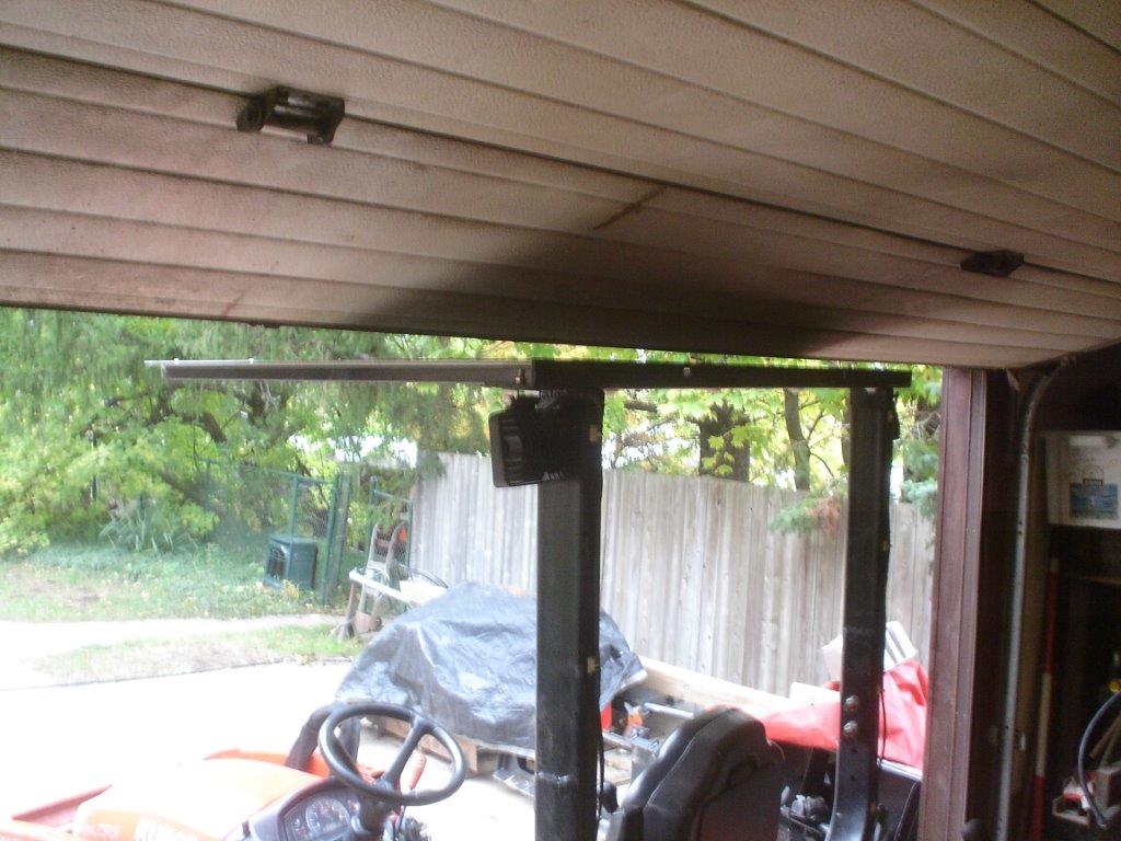

What in the way of 'customer' adaptation do you need ? So far, for my BX23S, I've built a lowered canopy for sunshade and garage access, selfpowered SSQA dual snowblower,winter windshield and a 3PH frame/rcvr.

My garage door height is low enough, I have to drop the ROP, and a roof over my head would be nice. That sounds interesting. Would you mind sharing pictures and what you used for the roof?

here's the one picture I could find... Original ROPS top section is in the garage 'annex',just in case I decide to sell. Verticals are 2x3, thick wall, 1.5x3x 3/16 for cross piece, 1x1 tubing for roof support. roof is 3/16" aluminum. LEDS are controlled with 4chnl RF relay unit(stock headlights are useless with loader). At 6'2" I can use BH no problem and yes it's about 3/4" shorter than the door.
