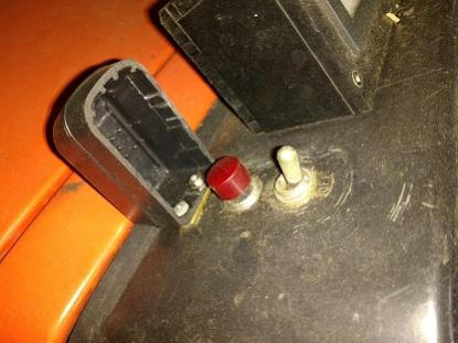

On my BX23 there are I believe, 3 safety switches, seat, pto, and treadle. Most of the time they don't interfere with whatever you are doing on with the tractor. That being said, there are times when they are a PIA and for this I have a switch that bypasses them all.
