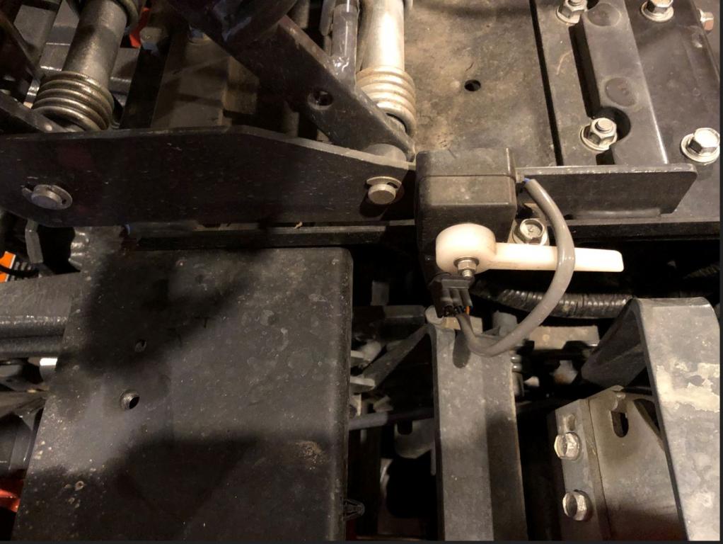

Ok. Ok. I wasn't going to do this, but you forced my hand. Here is my no cost, no rewire, one second fix. Should you choose to do this, it's on your own accord and I hope I don't get into trouble. The pics show the before/after fix (I lifted the seat into the BH position so you could see it better).
It's really quite simple!
Edit, this is on the B2650, but I think many models are the same.

dd,thanks but... I have TWO !!! switches to deal with , according to the fuzzy drawing in the PDF WSM.. A 'seat switch' and a 'seat turn switch'. The seat switch powers the OPC timer which will kill the engine if you stand up, the turn switch kills the engine if you try to drive the tractor with seat in BH position...
I'll tackle it next month when it warms up and the 'white stuff' disappears.

hmmm. not sure what you two are referring to regarding a BH safety switch??? Do you mean the engine dies if you try to move the machine with forward pedal while the seat is in BH position? I have not tried that with the B2650 as I just use the hoe to scoot me up the trench. I have used the forward pedal on the BX23 when I was in BH position, I could actually reach the pedal with my arm from the seat....then I got lazy and used a stick or short tree spade.
I can assure you that the above fix works fine when standing to try to see the tips of the forks.

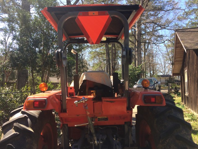

You can see the unused wiring hanging from the right side of my new seat. There was no place on the tractor to plug it in anyway.

Pair of Dykes will cure that....lol I like your 'ammo can' tool box too. Your 'operators station' is exactly the same as my open station M9 except my SMV triangle is where your ammo can is.
Yup, that is where my SMV sign bracket was. Now my SMV sign hangs upside down from the ROPS and there are two ammo can tool boxes, plus the original tool box that lost it's lid before I bought the tractor. ;)
