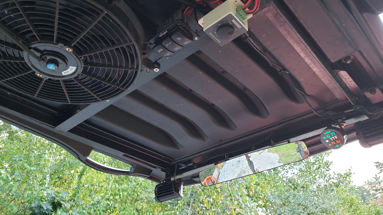

I don't usually tamper with factory wiring systems and prefer to do electrical mods to my specks. 120v 20a motor rated toggle switches have never failed yet and eliminate relays for any under 20a load. Here's one of my homebrew electrical systems

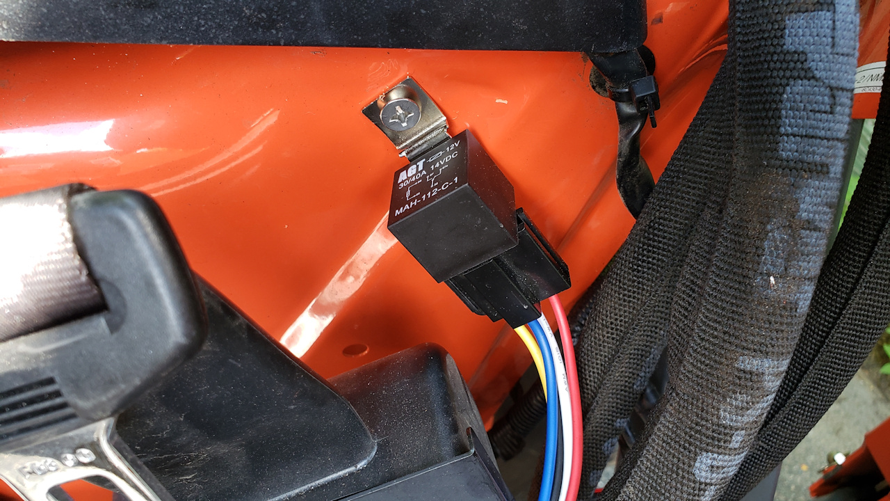

As SDT mentioned - the amp draw on LEDS is much less than typical aux lights.
However - some of us use more than one series of lights ( more than two at a time) and for this the relay becomes very important. I would say if your light are going to draw no more than 10 amps - I would use the rear hook up that are supplied and fused ( cannot remember standard fuse rating ) But if you are going to hook up say a light bar and another series of lights, it might be wise to separate those and use a relay.
A relay will bypass the stock fuses and be a separate system - if something were to go "wrong" this would able to be separated from the main electrical system. The relay will draw straight from the battery itself - all the while being fused separately.
I use a 32" LED light bar ....180 watts..... more or less 15 amps and 4 other 4 amp LED lights - each with a separate switch - but all running through relay.

When I installed front facing and rear facing LED lights on the ROPS, I put them on separate switches on their own fuse direct from the battery so that I could have them on without having to have the headlight switch on. By putting in a relay tied to a circuit that is controlled by the ignition switch, I know there is no juice going to the lights when the ignition switch is on the off position in case of my age I leave the light switches on.
Thanks for your notes and sharing. I would like to add a LED light bar and use the 12V feed to the front work lights but use a relay to avoid over drawing the circuit. I added up all the amperage from the work lights and the LED bar and it is 13.5 on a 15 amp fuse. I do not need to have it go on separately from ignition as the main use is for when I am working with tractor in the dark, so I am thinking of using the relay on the same circuit. THis would simplify the work in wiring as I have a L3560 cab and would have to pull off all the interior trim pieces and floor mats. Any input is appreciated. Best to you and yours
