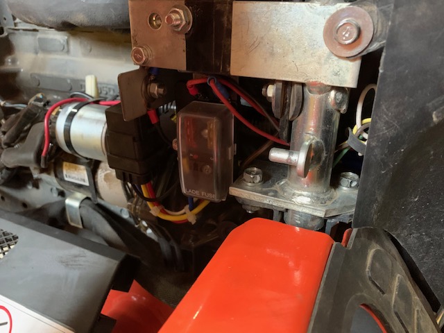

This is the relay and fuse box that I installed on my B2650 to feed power to my 3rd function and my LED lights on the ROPS. It sits behind the side cover to help protect it from the weather even though they are suppose to be water tight.
